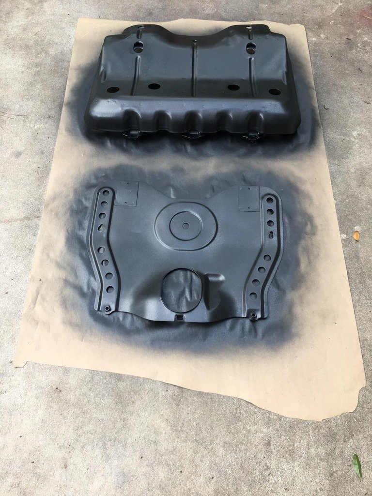

    While I'm waiting on the caliper, I figured I'd go ahead and get the truck bed liner on the skid plate, so I got that done last night. I sanded out ALL of the surface rust and got it smooth and clean.

    does the bed liner need a primer to go under it? im thinking of redoing my front skid because i sanded it and primed/painted it but the paint chips easy....thinking of maybe doing the bed liner

    Short answer- no. If you're paint is chipping, I think it might be the paint you are using. My preference for any paint like this is: Rustoleum Chassis and Roll Bar Paint. It drys really hard, has a great color, and I've had good luck with it.
    I used it on my rear "baja" bumper and it's held up great- I tow a boat every weekend during duck season and have had no issues at all. The can says it doesn't need a primer, but I used Duplicolor primer (HVLP spray gun) and then gave a couple coat top coat with the Chassis and Roll Bar Paint and it's been great.
    If you're already primed/painted it then I would probably sand the top coat off and go with the bed liner. The only thing is- the can says it needs 72 hours to fully "cure." I pretty much stick to those types of recommendations on stuff like that and really try to make sure to follow the directions. Get a couple of cans because sometimes the spray nozzle "sticks" and I don't have the patience to sit there and mess with it, so I just throw it away and write it off and go to the next can. I've only had this happen a few times, but it has happened.
    **EDIT** I didn't use any type of primer at all on the truck bed liner for my skid plates. I sanded the crap out of it, cleaned it with alcohol (spray bottle with alcohol in it) and just sprayed it on there. That's exactly what I did on the frame in the front suspension and it dries HARD. You shouldn't have any issues.

    Remember- a few light coats (5-7 min between coats) and then a good "final" coat. I do this exact same thing using the bed liner because it has a tendency to come out fast and run. Remember, it's ALWAYS easier to add more, but it's super hard to get the excess off and make it look good.
    Hold the can further away from what you're trying to paint so you can spread it out (you'll have more overspray than what you're used to), keep the can moving, and get the light coats on.
    Do it once and do it right.
    Remember, you're trying to build the coat on there, not put it all on at 1 time...

    i have a hard time doing the light coats because i always think "man that spot looks like it needs another light pass" so ill put another light spray wherever it looks like i missed. i think i put on like 4 light coats and 2 thicker coats last time. maybe next time ill put like 6 light coats and one top coat.
    i try to hold the can the recommended length away. i think its 8-12" or so, but then i always ended holding it closer. i think i rush to do things just to get to the end result and be done with it. i can be impatient sometimes

    Hold the can out a little further than that, like 16-17 inches and keep the can moving. It's honestly better to be patient now when you're doing this than it is to have to totally re-do it later... :eek:

    Here are the skid plates complete:
    Just need to get these bad boys back on now.
