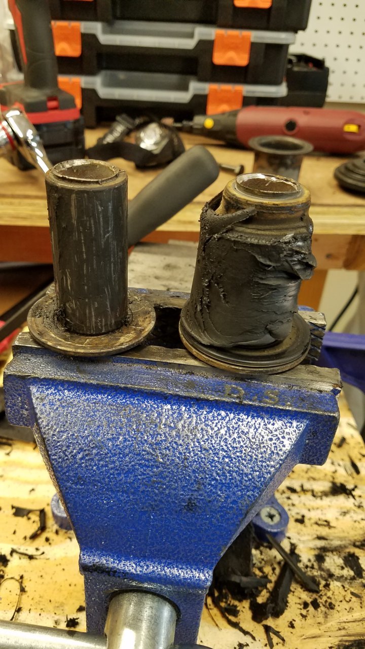

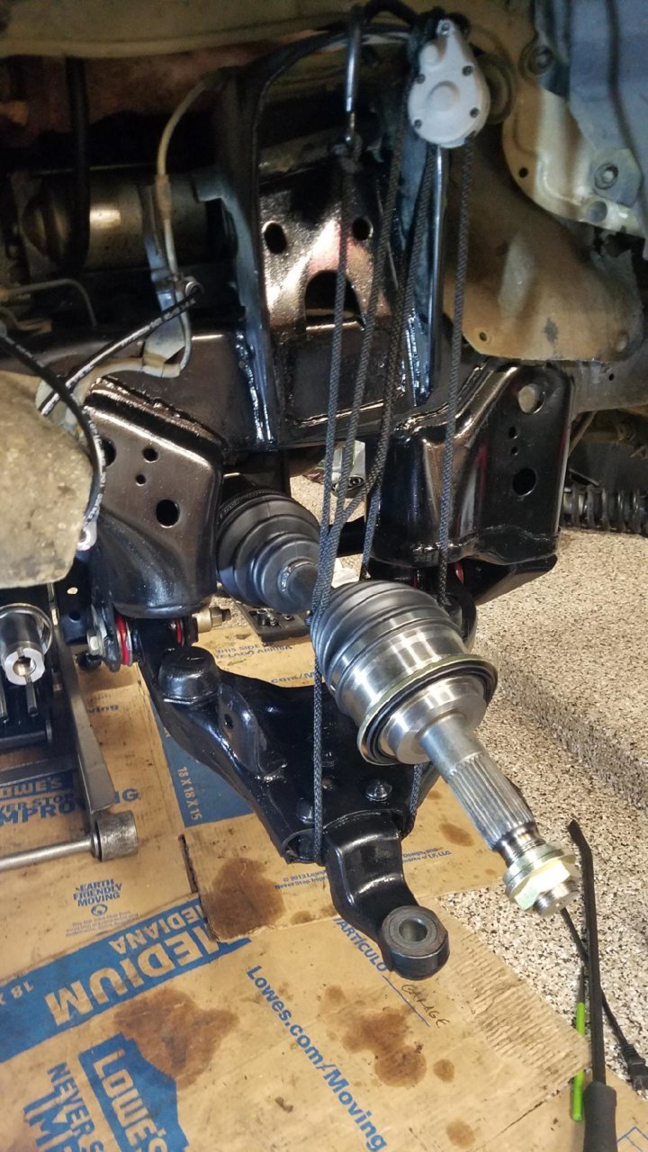

    I need some help on taking the OEM washets off to reuse them with the energy suspension bushings. I see from your pics that you ACTUALLY did it! Im tearing my hair out over here!

    I got the washers off the sleeves by grinding the crimp and hammering with a ball joint fork. Then i torched and pressed out the sleeves. Then i melted and scraped off the rubber off the sleeve. Then i took a abrasive wheel and cleaned them up. Now i have to grind down the crimp so the washer will fit up at the end of the sleeve. The end of the sleeve is flared out, thin and very sharp. Once i get these ready ill lube em up with grease and press in the ES bushings. I have some Superlube on order from Amazon so ill have to work on something else for now. I have everything taken out up front

    np. i read your older post about grinding the crimp and figured it out. the other set went super fast. i got that bushing process DOWN.

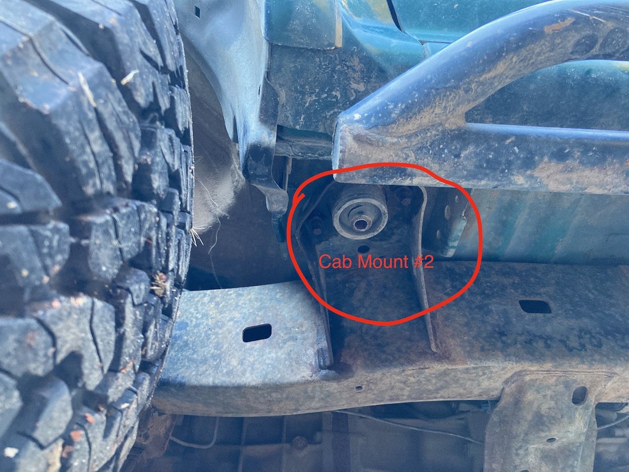

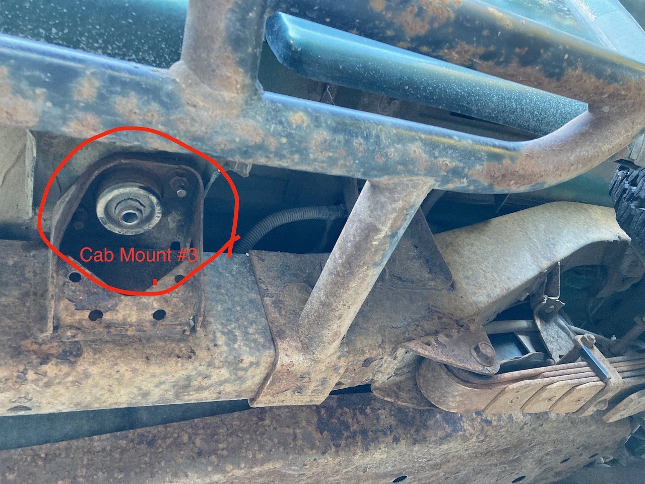

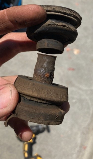

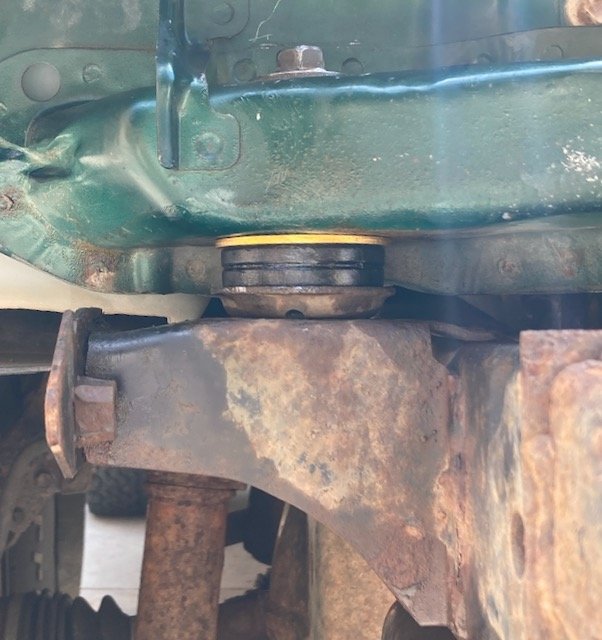

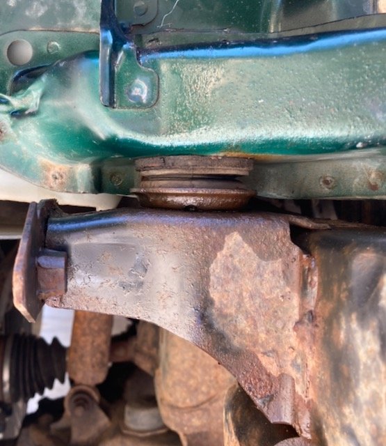

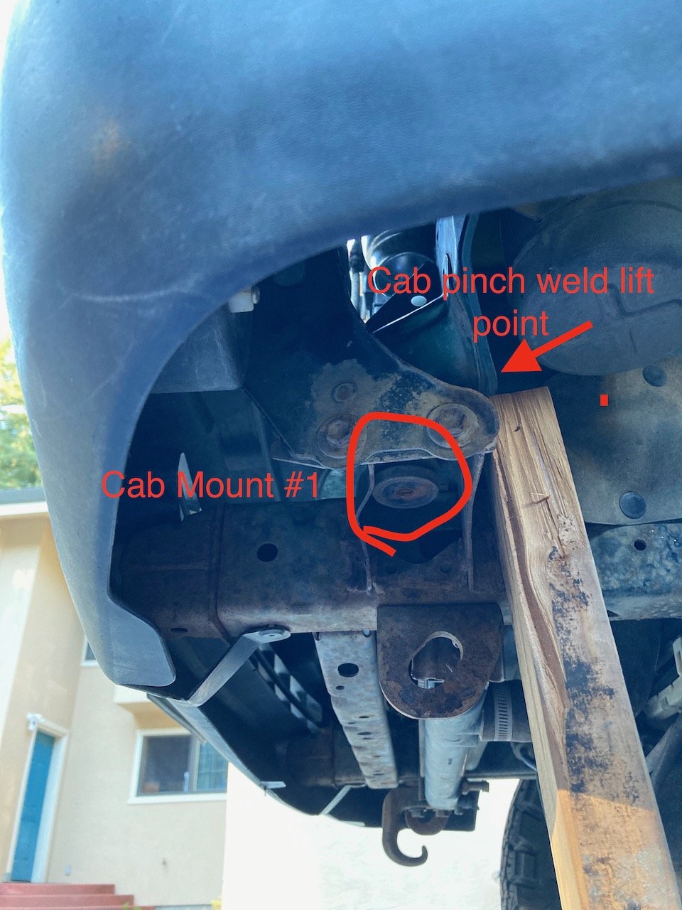

    Hello internet people. I need some help: I am trying to replace the cab mount bushings on my 99 Tacoma Xtracab Limited with 300k miles and lots of rust. I've read this post, and a number of others, before starting the job. I decided to start with the driver's side, so loosened up the 3 cab mount bolts on passenger side, and removed the 3 on the driver side.
    When I try to jack the cab up and off of the frame at various points on the driver's side, it doesn't separate from the frame at all -- the frame moves with it, very rigidly, as if it's still very strongly affixed to the cab. I've used the 2x4 method and tried lifting the cab up from various points on the cab's pinch weld near each of the three driver-side cab mount perches, as indicated in this and in other posts here, to around 2-3 inches of height, but to no avail. The cab simply does NOT want to separate from the frame, and the frame just moves up with it. With the jack in place and lifting the cab (and frame) 2-3 inches, I've wiggled the truck, I've jumped up and down on the rock sliders (bolted to the frame), I've banged on and around the three perches with a BFH and a lot of crap came out but no KA THUNK and separation.
    I am nervous to apply any more force on this without asking around to see if I'm doing something dumb. I figure I either missed some bolts, or perhaps the cab has rust-welded to the perches (the bushings are in pretty bad shape and might be totally gone in fact).
    Some ideas? Otherwise I'm just going to put the bolts back in and walk away from this one. Here are pictures of the three (well, six total) cab mounts that I've undone.
    This is what I understand to be the FRONT mount. there's on on either side of the radiator more or less:
    This one is the middle mount, approximately under the dead-pedal carpet:
    And this is the rear mount, under the utility boxes under the jump seats:

    You can't lift from that point as of yet. My guess is your bumper is somehow attached to the cab. I'm just going to state that first, just in case you are at this moment, still trying from there. Then I'll try to help further.

    @goffredo did you loosen the steering rag joint? that holds the rack(frame) to the cab

    I knew why you were having the issue & got worried you might still be trying another spot or something. It’s too bad the instructions on this thread don’t include removing those l brackets. It’s possible his were rusted out, as mine were. From the side pic of his truck, there is a bigger gap than there should be. He hasn’t been on here for a few years. One of my 1st helpers on here & I’ll not forget his patience & support.
    Anyway, it did not occur to me to ask what brand of mounts you got.
    Here are the instructions for the ‘99 energy suspension ones. Makes no difference what brand, except for if you had instructions. I imagine they’re universal.
    Your bumper must connect to the cab somewhere & that is why you are having the problem. I wonder if you actually have to remove the bumper or if wherever it connects can just be loosened. Anyway, these are the ‘99 instr. Hopefully someone with an early 1st gen can pipe in. Or you could start a thread titling it something like “early (‘99) 1st gen body mount bushings install issues”
    https://www.energysuspensionparts.com/installation_instructions/energy_suspension/17170.pdf
    Mine (‘01) connects via the brackets. Cab brackets to bumper.
    ‘01 instr
    https://www.energysuspensionparts.com/installation_instructions/energy_suspension/17478.pdf

    I did not! I will take a look at this! Thank you!
    It's funny, I saw in the Energy Suspension instructions like the very first step is to remove the front bumper and I was like, "Naaah, that's just so you have easier access the tops of the bushings, I can get to them just fine with my little Barbie wrench!" and completely disregarded it. And then an hour later I was like "why the hell isn't this damned $@ cab coming off the body?" and hitting things with a hammer and generally being irate. Yeah. Thanks. Let me try this one out and see, will post back with deets.

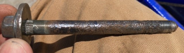

    I ended up just replacing the front bushings. The middle and rear ones were in good enough shape not to risk jacking the cab up off the frame the couple of inches necessary to swap them out. I think the reason I was having such a hard time separating the cab from the frame was because of the front bushings -- the bolts were rust-welded to the inner sleeves, and the sleeves were in turn bonded to the stock bushing material, so even with the nuts loosened, the bushing assemblies still held things together fiercely.
    Front Passenger side bushing, before: (about 300k miles on it):
    Front passenger side bushing, replaced with Energy Suspension 8.4103g kit:
    The old bushing, removed:
    The stock bolt:

    so you did not have to remove the bumper?

    Oh, yeah i totally removed the bumper. I can't say it made a difference in separating the cab from the frame, though. As far as I can tell, there are the four big bolts that hold the bumper to the frame on the front, and then some random plastic trim pieces that keep it affixed at the sides. I didn't see any part of the bumper that was attached both to the frame, and to the cab.
    But it's nice to get the bumper off, so now i have access to some parts of the frame that need a wire wheel and some anti-rust paint, while I'm at it.
