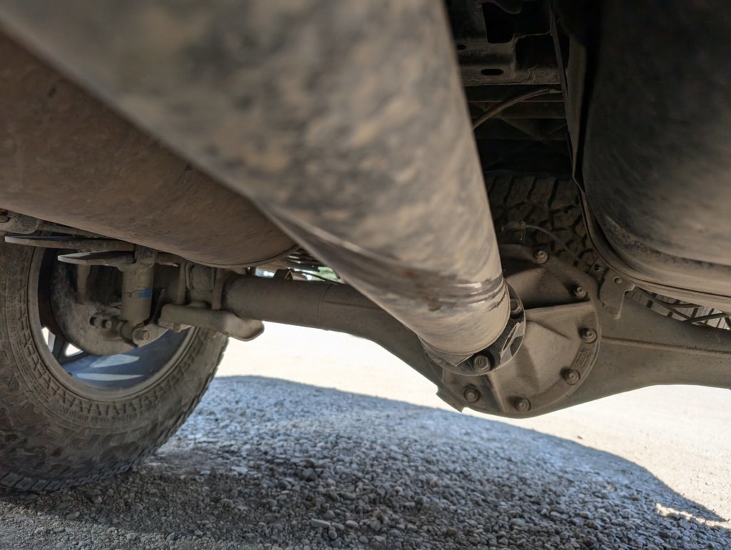

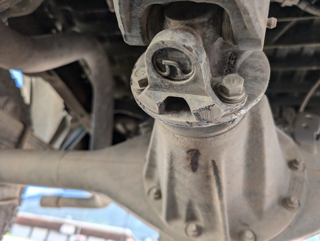

    I was an idiot and didn't notice a rock on my right. Banged up my driveshaft rod and left a massive gash. Scratched the base of the u joint too.
    Drive it back on pavement and the truck is wobbling over 40 mph, no surprise there.
    Now, my question is - is it ok to drive this as is 500+ miles back home? Is there a risk of this rod snapping off the joint?
    Thanks y'all

    Basically a way out of balance drive shaft. I'd suspect you'd wear more stuff out by driving it that way. If your truck is 4x4, do you have the means to remove the drive shaft and drive it in front-wheel drive?

    Break? Probably not unless you are real crazy. Vibrate enough to possible cause damage elsewhere in the drive train? Possibly. Severe vibrations tend to cause damage to the area that quells it because that part isn't supposed to or designed to handle that kind of movement.

    Happened to a friend of mine. He removed the rear shaft and drove in FWD, though nowhere near 500 miles. I'd be looking for a rental truck to tow it back home.

    Disconnect and drive in FWD.

    Perfectly fine to pull the driveshaft and drive it home in FWD. Just be prepared for the truck to handle differently, especially while accelerating.

    If you want a spare, have the original re-tubed once you get the replacement on. Not expensive. That yoke isn't damaged as far as being re-useable.
