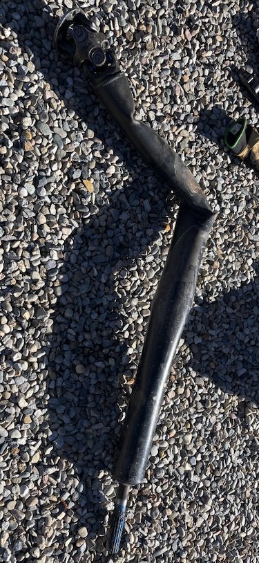

    Got the DS removed and drove it home, thanks y'all for all of your tips! Removing the bolts at rear flange was much harder than expected, in particularly lining up the bolts. Had to move the truck forward and backwards in neutral to help with this. rest of it was a breeze. Now, the one thing I failed to mention is that I went over 12k ft passes on my journey home and my front diff got very hot. Whoops ha, will change out the oil and ensure everything is alright.
    Toyota is charging $1,400, local driveline shop is charging $670, and a couple online stores are charging $300 ish.
    Does anyone here know if A premium is a well reputable company? See below:
    https://a-premium.com/product/Rear-Driveshaft-Prop-Shaft-Assembly-for-2014-Toyota-Tacoma-0s19RFA8KF
    Not sure to pay out a premium to retube it over ordering a knock off. Thanks y'all!
    EDIT: no local junkyard has it in stock
    EDIT 2: Dropped off at drive line shop. $625 + tax

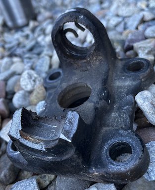

    good call removing the DS and driving in FWD. I was in a similar situation where I dented the DS wheeling but didn't have anything visible on the flange. Mild vibrations from 40-50. About 100 miles later the DS flange cracked and it raised hell underneath the truck.
    I already had a 1 piece and found another used 1 piece to replace - replaced all the ujoints and center bearing for peace of mind. All is now good. I am now tied to a one piece unless I get a new cross member because the free flying DS mangled the mounting points.

    @dk_crew did you have to buy a new driver’s seat because your butt bit a chunk out of it during the pogo?
  15. Sep 16, 2024 at 11:57 AM
    #35
    dk_crew
    dk_crew Well-Known Member
    May 20, 2019
    #293798
    858
    Dave
    Austin, TX
    2005 Tacoma 4x4
    We were amazed how uneventful the whole thing was. Driving around 45mph. 2 loud "oh sh&t" bangs with clearly something dragging / bouncing. The fuel tank was fine. I did have to cut/weld part of the exhaust that got smashed. I did have skids going back under and past the case flange which I think held the DS up a bit allowing less "wide" movement if that makes sense. But yeah ... crazy. inspect those flanges and take care of the ujoints.

    Last update: the drive line shop was great and did a full refurbishment and returned the DS on the same day. Northern Colorado drive line shop in Greeley.
    She's on and running great. Thanks once again TW for teaching me new skills and saving me boatload of money!

    Now imagine that rock being a few inches to the left. Buy a fuel tank skid. You'll "save" money compared to a punctured tank. :evil:
