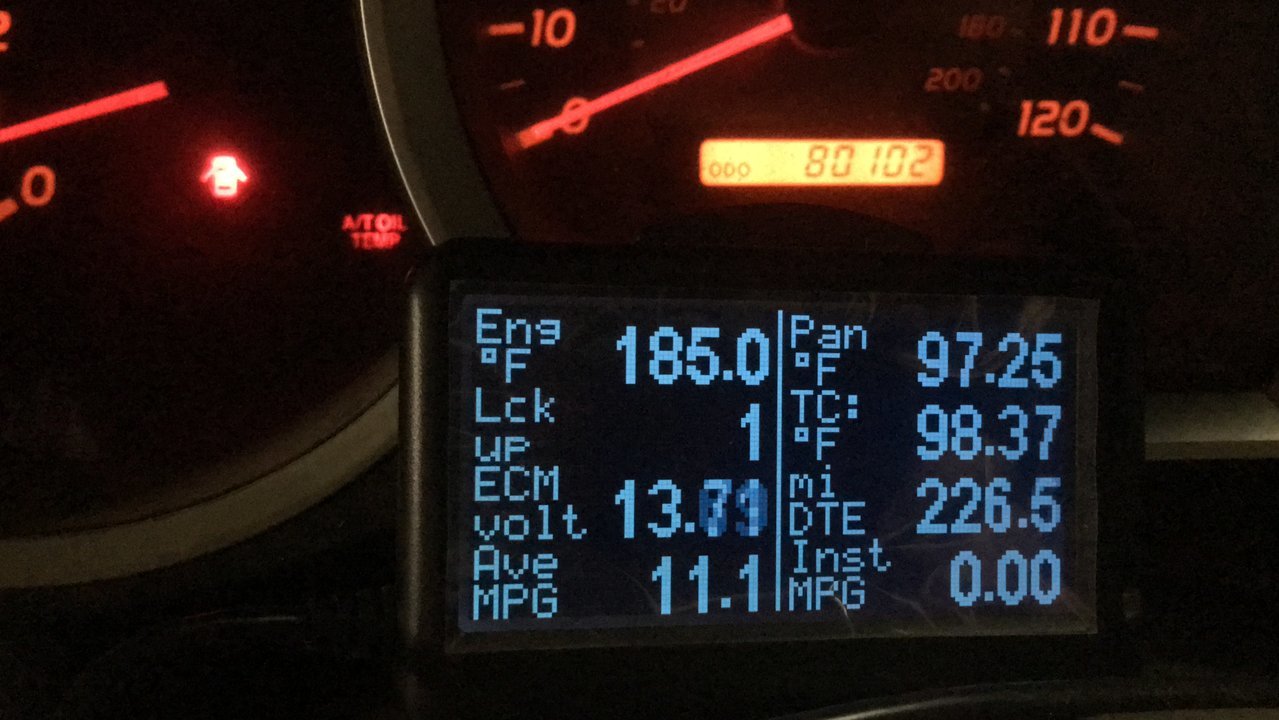

    Also, if you happen to have a scan-gauge, you can program it to read your transmission temp and double check the temperature is ok without having to fiddle with shortcutting the OBDII #4 &#13 (I believe thats correct) and then putting the truck into AT Fluid check mode.

    I use my ultragauge to check the fluid level, there are two temp sensors in the transmission. You want to use the pan temp and check the fluid between 97°F and 115°F. I verified that the temps are correct when I did a drain and fill in April.
