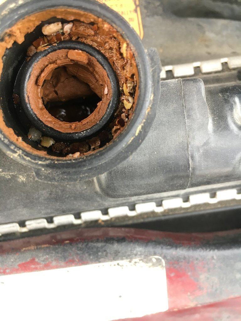

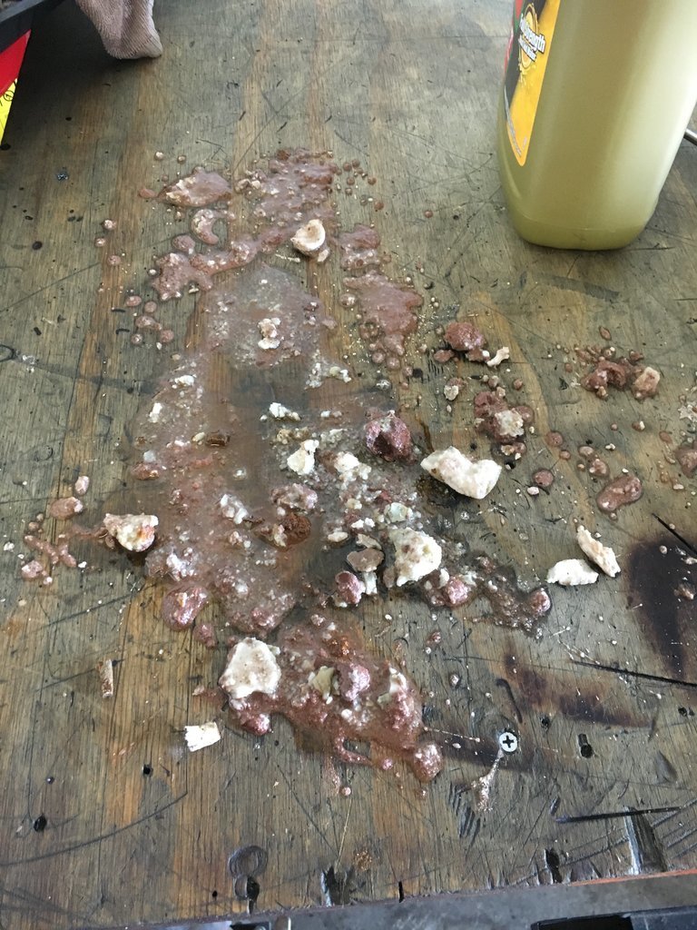

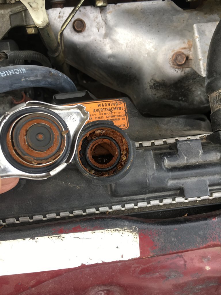

    A friend of mine owns a shop and had to replace the ENTIRE coolant system on a customers vehicle recently. Wanna see what it looked like after they ran stop leak through it?

    Point taken. That sh*t is not touching my truck. That's horrible.

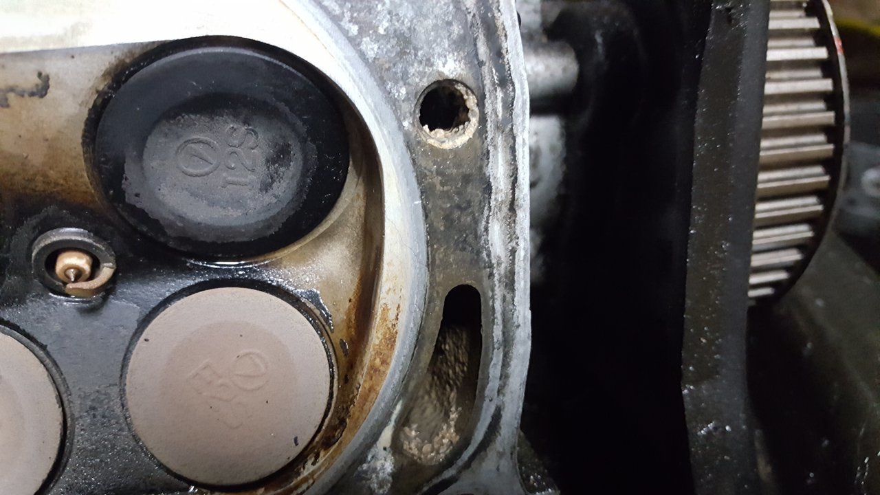

    pretty common for the early second gens to have headgasket issues. 05-early 06 i believe till they revised the headgasket.

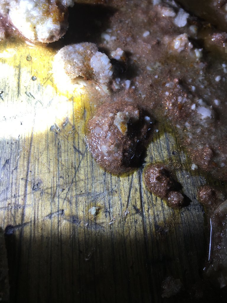

    Yup. Years of owning my used Subi. Had to replace the radiator, water pump, and then....whenI had to replace the failed headgaskets. This was during the process of chiseling out what I could reach...

    The OP has a 2.7 liter 4 banger, I haven't heard of any issues with the head gasket on those.

    ah you are right. sorry for the confusion. yeah never honestly heard of a 2.7 having headgasket issues ever.
