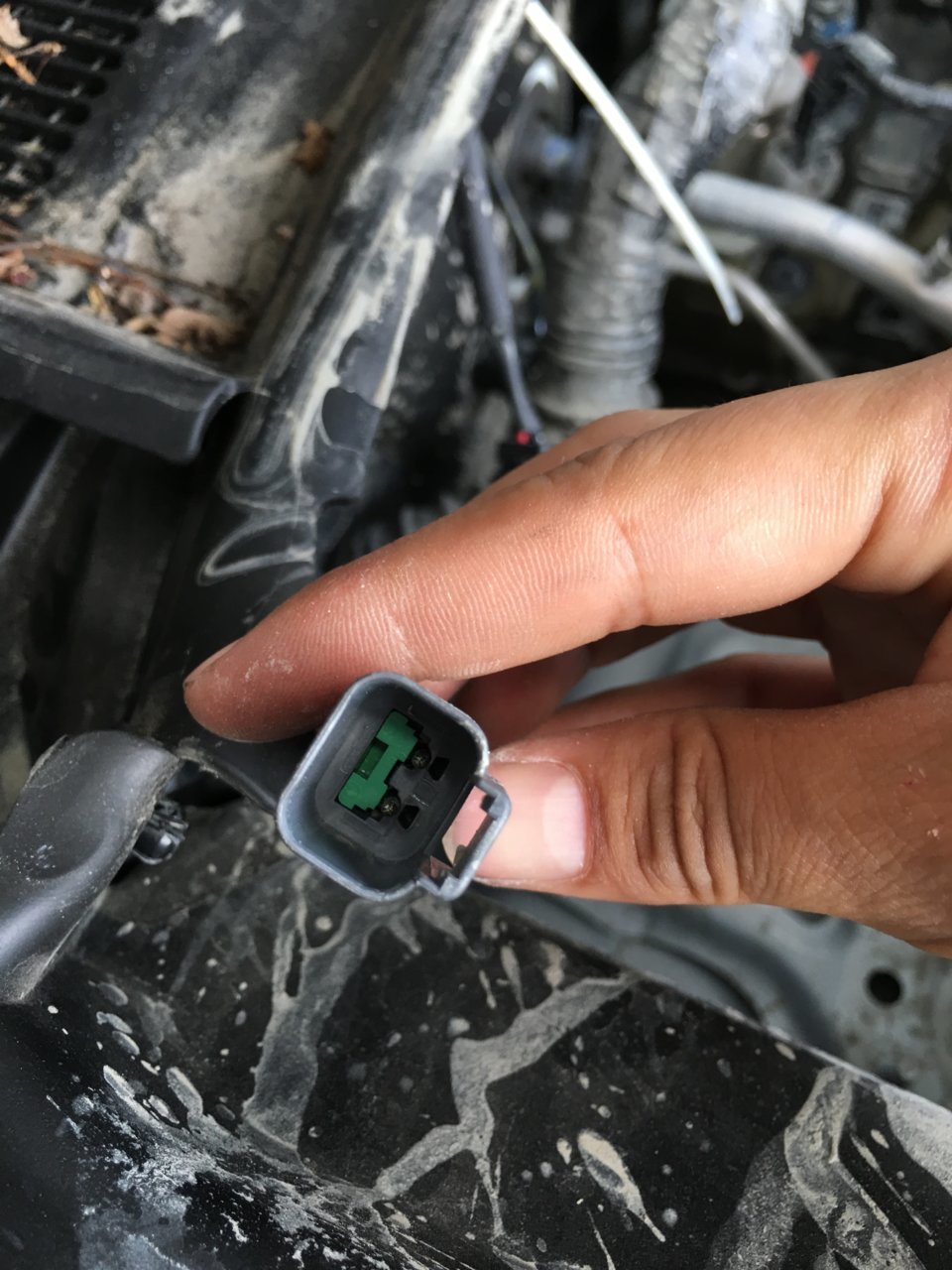

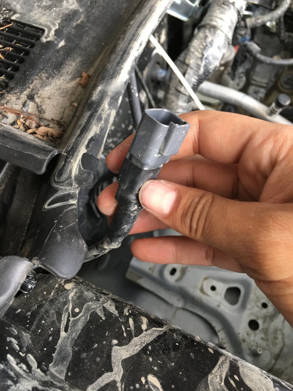

    This one comes from the lights... so I pull those little prongs out and swap them around?
    274BBECB-423F-432D-9ABE-2945CCAF961B.jpg DD9C6AF1-634B-4F25-ABED-D764C724DF11.jpg

    You should be able to do either side. If it's a sealed Deutsch connector try doing the other side. You should be able to cut off that shrink tube and do it, it looks like.

    Ok so I got the green cover off and it says to find the clips inside to release the pins.. I see the clips, but am I pushing up or down?? I can’t pull out the pins?
