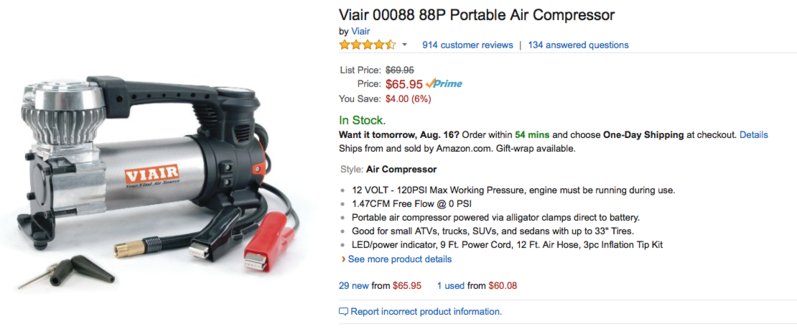

    I'm running a Viair 088p compressor when I need to air up after off-roading, works great. Takes under 10 minutes to air up all 4 tires from 15psi to 35 psi. $65 on Amazon
    Connects to the truck battery though, which I prefer anyhow
