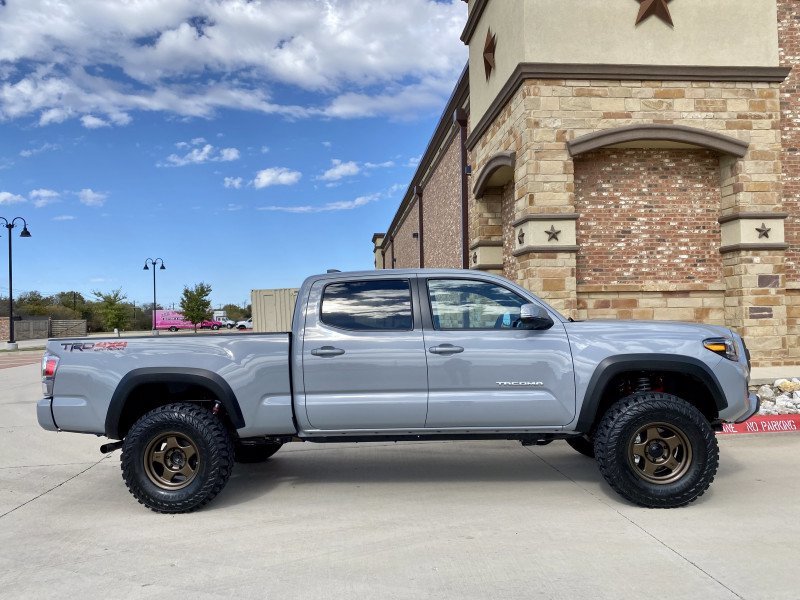

    Your right, they look a lot better and I love it. (2"-2.5" lift, Eibach Pro Truck Lift, All Dogs Off-road rear 3-pack add A-Leaf, JBA red upper control arms).

    That is BEAUTIFUL!

    Looks great, mines lifted, locked, fully skidded, and more. They are one hell of a trail toy. Your truck looks great, I love that color.

    Do what feels right. I recently traded my stock 2018 TRD off road for the truck pictured. I loved my 2018. Then I found this truck on Auto trader and it had everything I wanted to do to mine already done. so, I pulled the trigger. and I love driving it...I also loved my stock truck.
