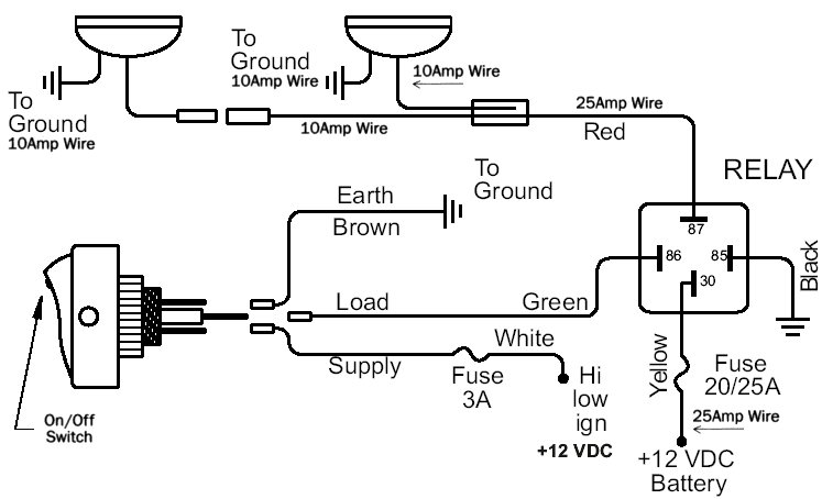

    Can anyone help me with wiring 20" dual row? Also how to switch the switch out with an OTRATTW one? First light mod dont wanna melt anything. Thank.

    Do you have a wiring harness with a relay and/or inline fuse? Also what switch is it? Single pole/ single throw, single pole/ double throw, etc .......... Or do you have a link to the one you bought? I can step you through the wiring process with that info first

    This diagram has been the easiest I have ever used when wiring off road lights. I reference it every time I do so. I have made many a harness using this. Hope it helps. It's the same concept with 1 20" light as it would be with the 2 lights they show. At one point I had as many as 6 off road lights on the front of my truck.

    white wire on my harness is power in, blue wire is power out and black is ground.
    DO NOT WIRE THE WHITE and BLUE together, you will melt the harness.

    The diagram that Jason posted is very easy to read and is perfect and then the colors that Chris said are probably the colors you will actually use. Also your switch will come with a basic wiring diagram that you can referrence with the above diagram. The only other thing you need to do is get a hot to the independent light on the switch. The dependent light will only turn on when the switch is flipped. I suggest getting a fuse splitter and finding a fuse at your panel behind the dash that you can tap into. Find one that is only hot when the ignition is on. Otherwise that light will stay on all the time
