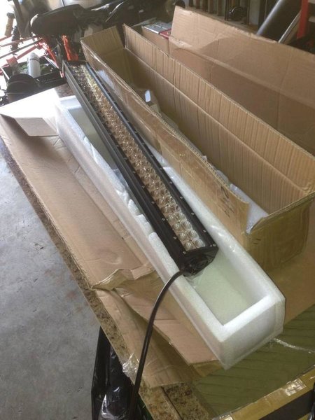

    Hey guys, just got my light bar in and man was it packed up tight! Very impressed! I am confused on one item, it looks like a small black box with a white female connector end on it...not sure where it attaches cause the wiring harness came all assembled already
    Any help would be great

    I believe it's the box for the remote. It goes in place of where you plug the switch Into. There should be a remote in there aswell that will turn the light on and off aswell as a bunch of other cool things.

    that is correct, the white box contains the remote control for controlling the flasher functions.
    YOU can do 1 of 2 things, unplug the white connector downstream from the toggle switch, and you can only use the remote control, OR you can use a 3m t-tap inline
    on the harness either before or after the white connector and cut the plug off the remote box and use a spade connector to attach the box to the t-tap inline plug, this allows you to use either the switch OR the remote control, so if you lose the remote or the battery is dead, you can still turn it on!!
    if this doesn't make sense to you please let me know and I'll do a quick write up with pics on it for you guys.

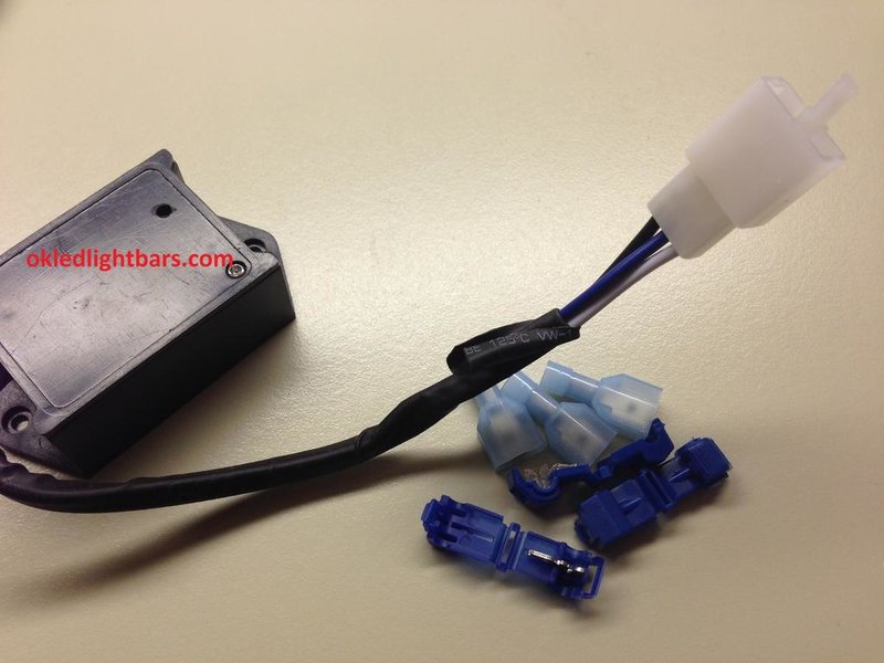

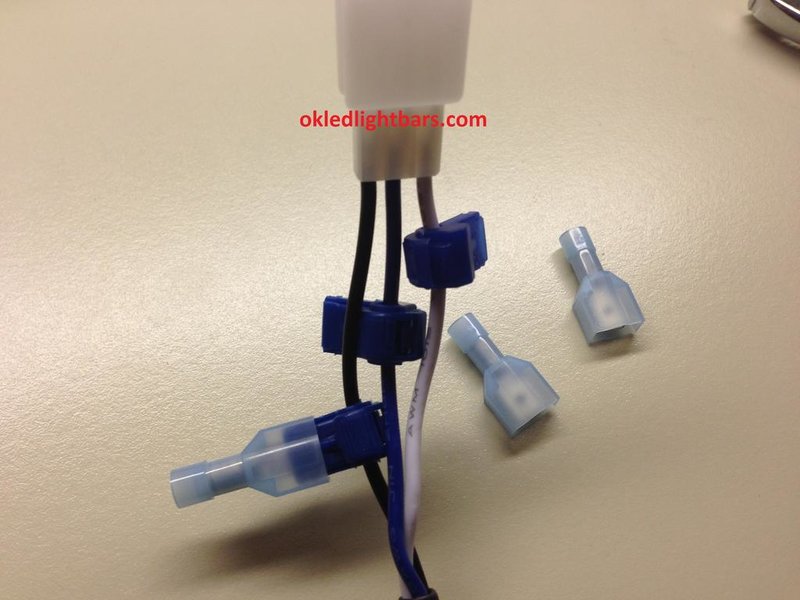

    ok, here is what you would do.
    in the pictures you will see what a t-tap is (dark blue plastic connector), its a connector that clamps to the wire itself and then you connect a connector to it.
    What you want to do is take the wiring harness that came with your group buy package and attach a t-tap (dark blue connector)to each wire, blue, white and black that is going to the switch.
    Cut off the white pigtail on the flasher module (shown in picture) and attach a wire connector (like shown in pic lite blue/clear connector) to each of the white, blue and black wires on the module wiring pigtail.
    then you just plug each corresponding (white to white, blue to blue, black to black)wire into the t=tap on the harness.
    the picture shows what your looking for at a parts store, they all carry them, blue is the color you want for the right size.
    Disregard the t-taps on the flasher module, that was for another project, but gives you an idea of how they attach for those that don't know.
    Now you can use either the switch (if you lose the remote) or the remote!

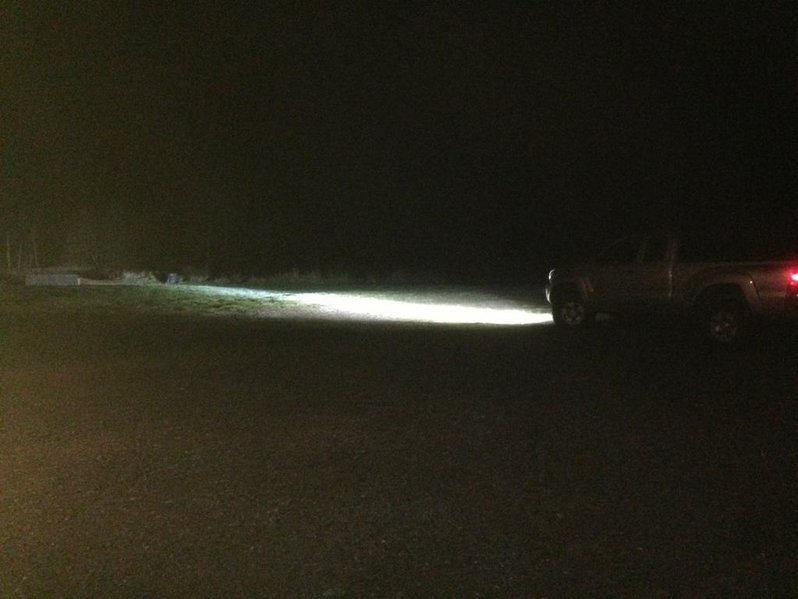

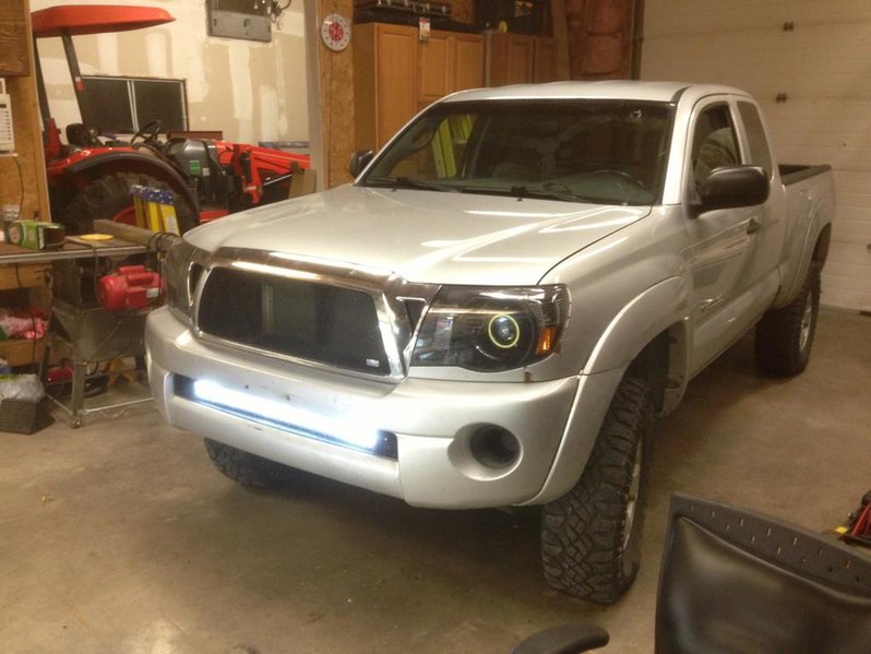

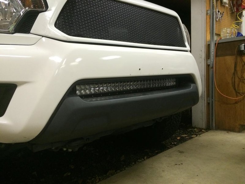

    Alright thanks Chris looks easy enough. I got
    Mine mounted tonight and I sure do like it. Was just wondering about the strobe functions. How long would the contacts in the relay hold up to this constant on and off ? Just wondering out of curiosity. Here are some pics of my install. Thanks again

    mines been on my Cherokee for about 6 months and haven't had an issue yet, I use it all the time.
