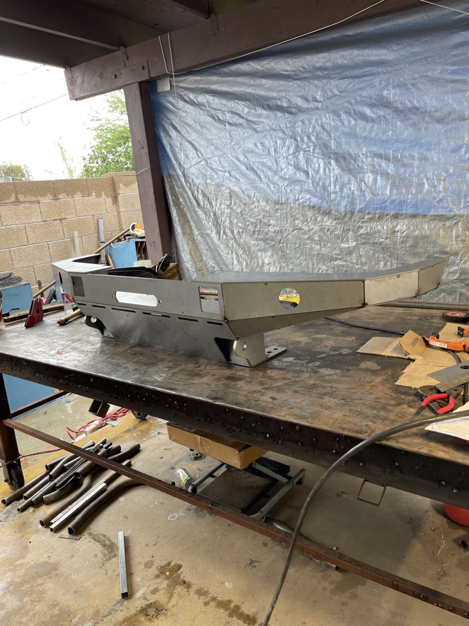

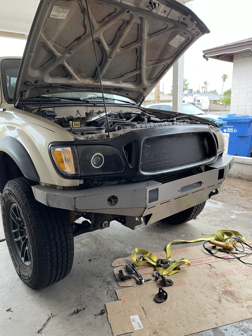

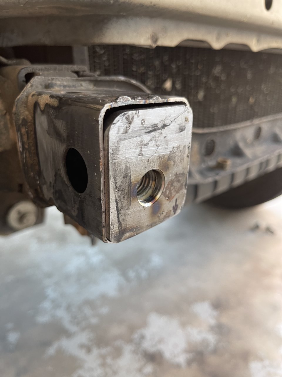

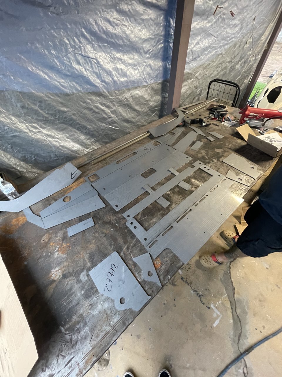

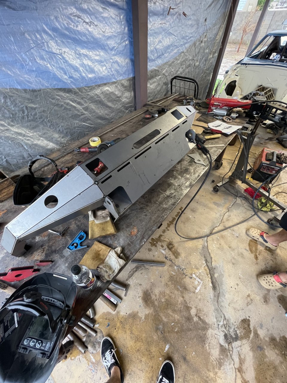

    Ended up getting it all tack welded together. This is unfinished, going to try and get more done tomorrow. :welder:
    Im going to post a time lapse on my IG if any of you are interested… username is @ azgrphx
    Also going to put a black front fender on tomorrow. In the future… maybe a month from now I’m going to have the fender repainted and have the dents taken out of the rear and side that was made from the P.O.
    Im adding more pics I took during the process that I never had time to do.

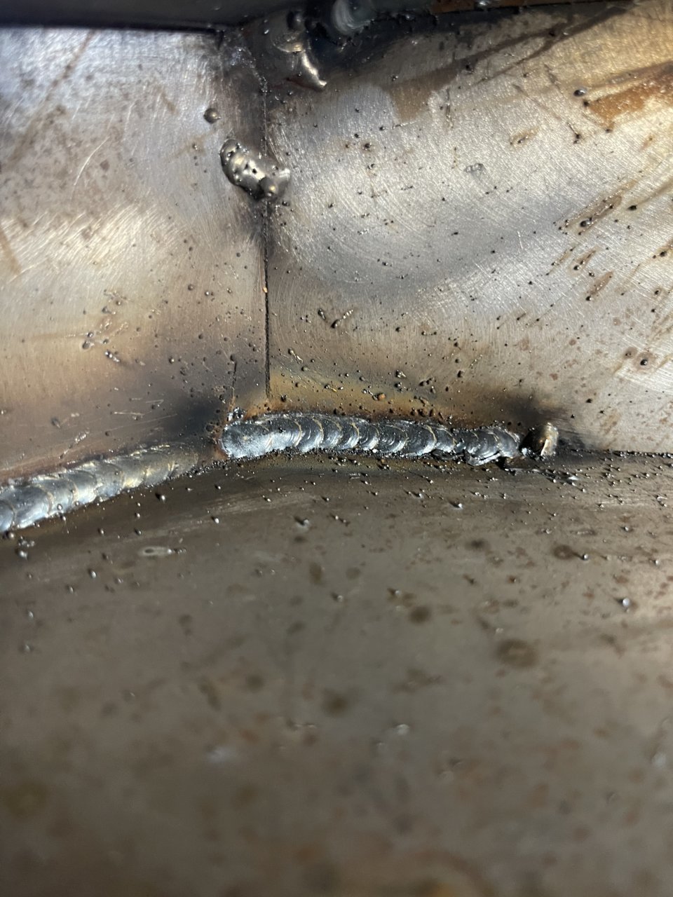

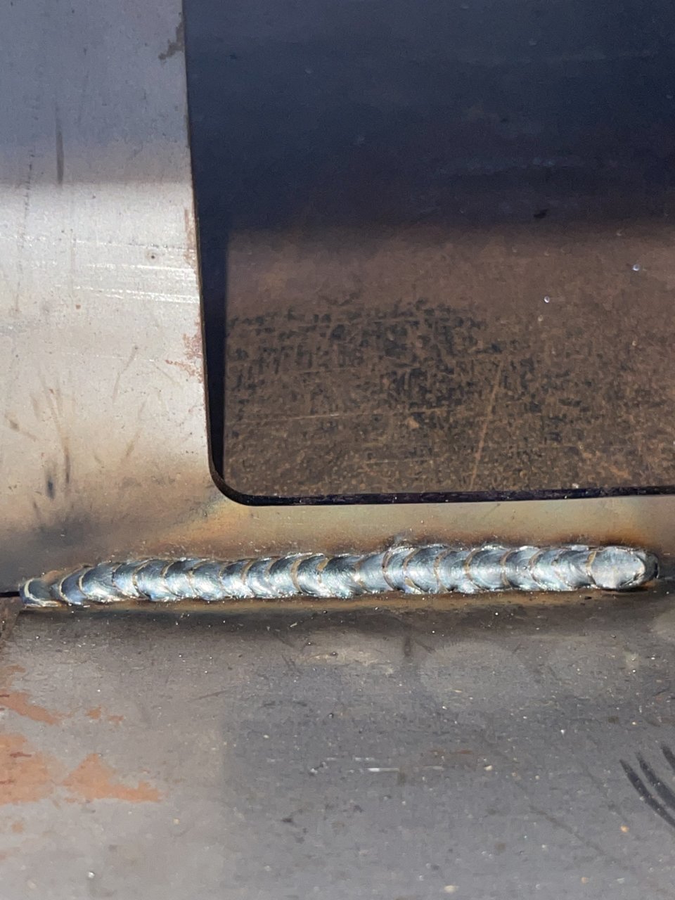

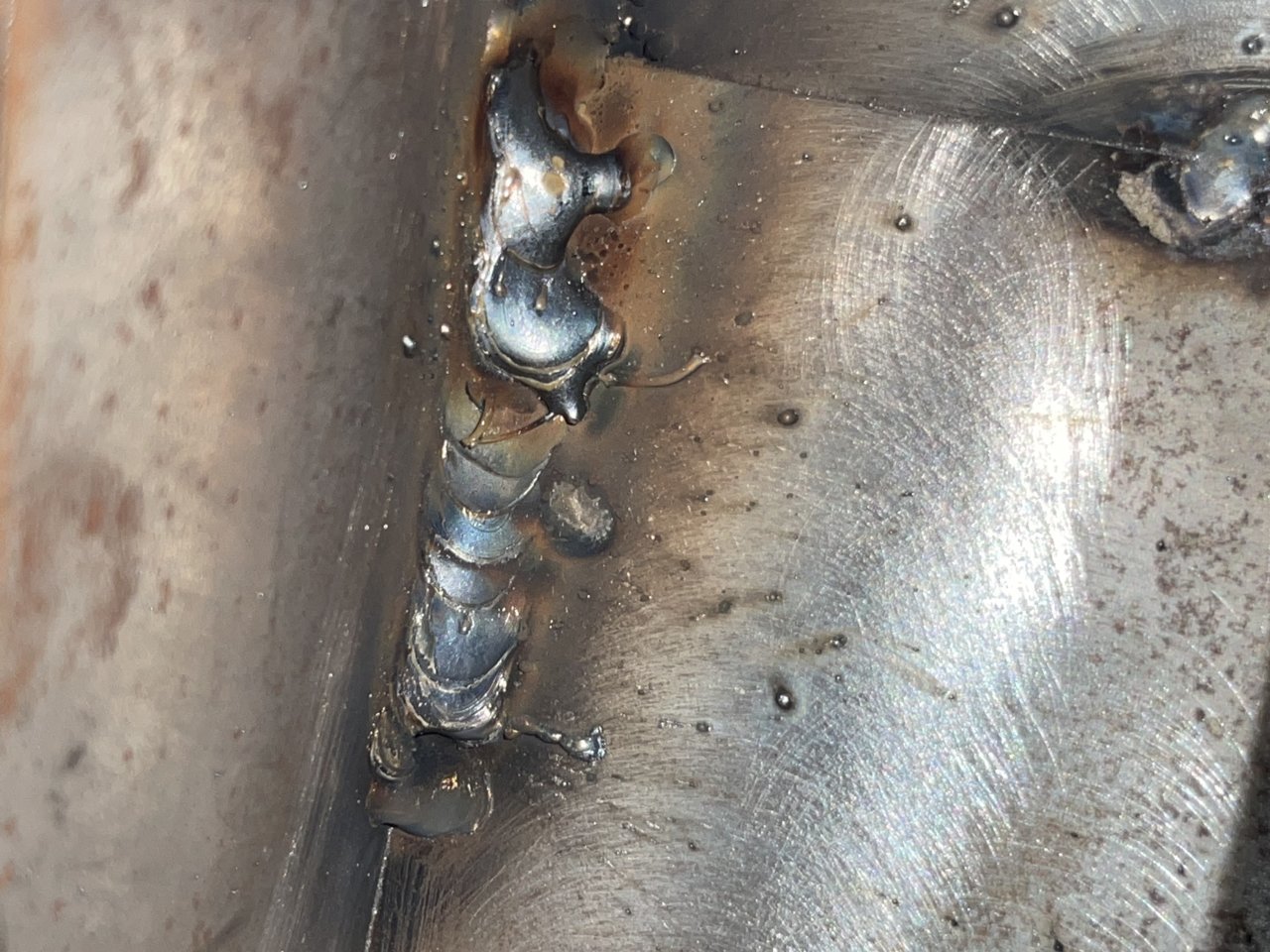

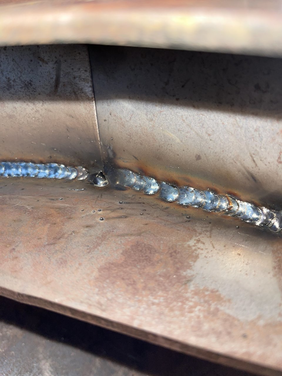

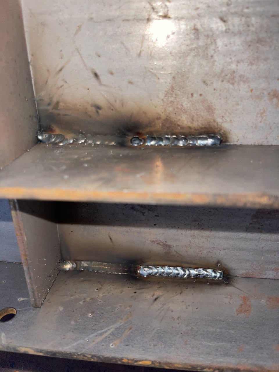

    So I actually got to weld some of the bumper. Here’s some of my first welds ever, I’m not the best but I kinda like how they came out except the first one :anonymous:

    Those ain't too shabby really, better than my first welds.
    I'm an NDT inspector, not a full CWI yet but looks like you're a fast learner.
    What machine are you using? (Looks like GMAW process.)
    Settings? Wire? Gas?
    Only advice I can lend is your welds look maybe a touch cold, try pre-heating to 200-250°F, maybe up the amps a touch, slow down your travel speed, back track a little more and widen your puddle a little bit, try and get your ripples to overlap a little tighter and touch each piece a little more. Also don't start/stop in corners and try to keep your stringers as long as possible.
    Only glaring thing I see is you need to
    CLEAN!
    Get that millscale down to bright steel where you're welding, don't weld over that nasty black stuff.
    Otherwise great work! Like I said mich better than my first welds! Maybe better than my welds now!
    :rofl:
    tymeson[QUOTED][OP] likes this.
  9. Aug 22, 2021 at 9:34 AM
    #49
    tymeson
    tymeson [OP] Let's ride
    Jun 25, 2017
    #222342
    2,921
    Steven
    In the desert
    03 Gold Prerunner
    Yeah it’s MIG, I cleaned the part I actually needed to weld the best I could. We had a lot of rain recently and just gave it some surface rust. Gonna have to do a deep clean when I take it to get powder coated. Settings were sort of pre done, my friend had it set up for me when I got to his place. I will be using TIG method to fill in the ends where there’s a gap in the metal and then grind it down for smoothness. Hopefully it all goes well. Thanks for the tips, I will definitely keep them in mind.

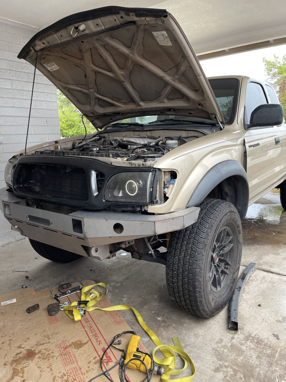

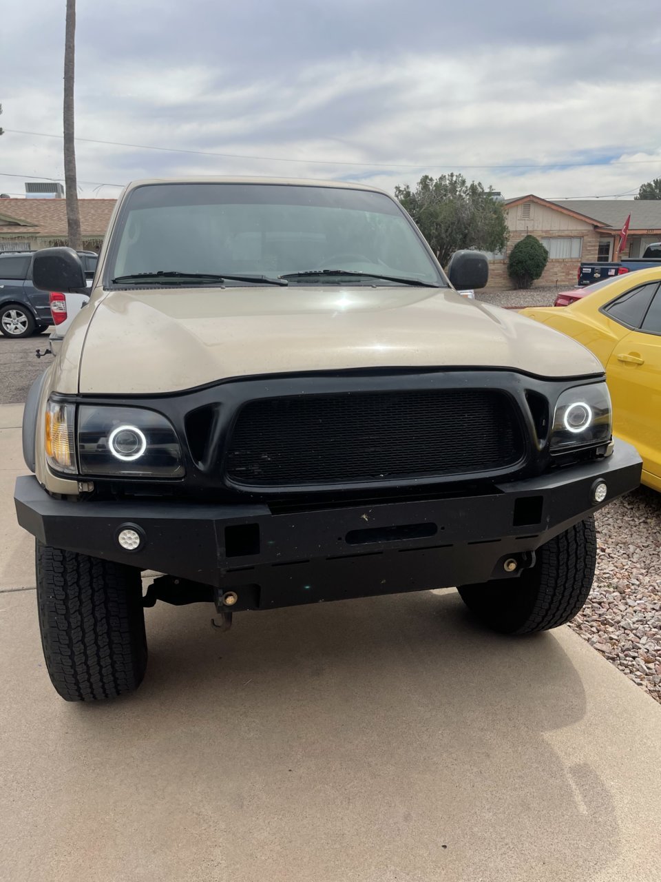

    I’m having some buddies of mine who are gonna help me with my 4x4 swap soon. Gonna be a long process but I’ll keep you guys updated.
    Here’s how the truck sits now. 0ACE97C7-EDA6-4184-8353-AC4E384848E7.jpgE1B813CB-A453-4F76-90EA-1DE783B9453F.jpg

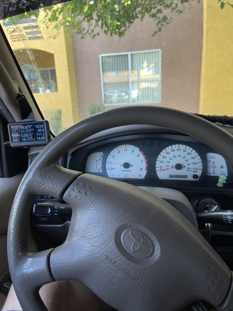

    New Ultragauge and mount finally setup! Thanks @SpikerEng for the mount! 0DD42365-5935-43B4-885A-3547122D8B46.jpg
