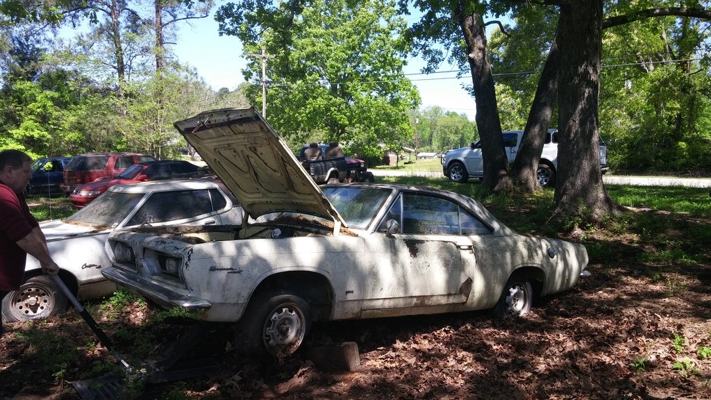

    Yanking the non-original 340 and trans out of this '67 Barracuda before my Dad sells it after sitting for a decade plus.
