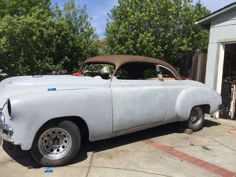

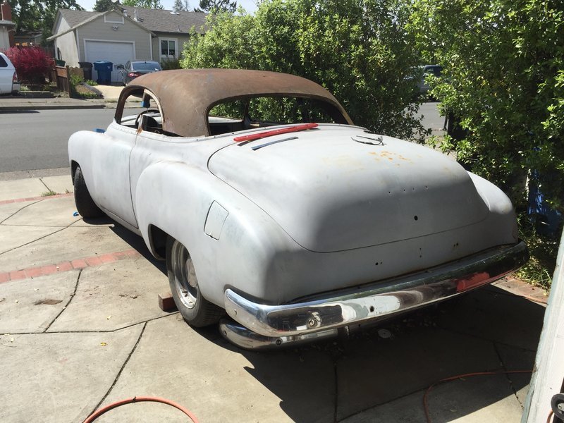

    That's a wrap for today.

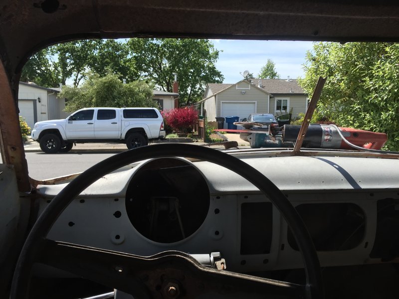

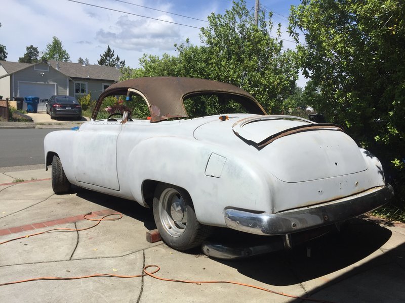

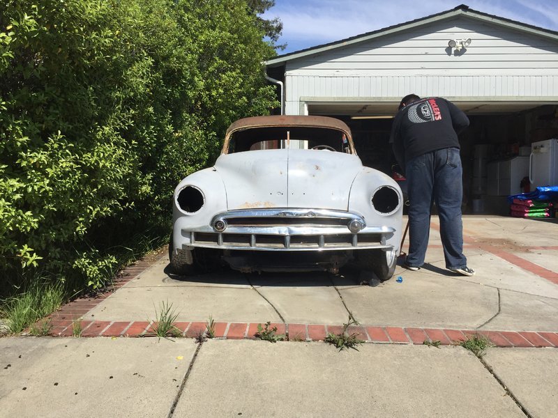

    Cut the old roof off, set the uncut donor roof on and went about measuring after some head scratching.
    This of course is not the finished roofline, but this is where it will stay as far as the chop is concerned.
    Cockpit view.
    Didn't take any pics of the roof at stock height, but we ended up adding 4.5" of height to the roof from the chop the previous owner attempted. We took approx. 4" out of the stock roof on the re-chop, so you can imagine how low the roof used to be! 8.5" chop!
    CaptAmerica likes this.

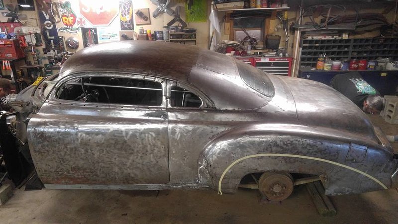

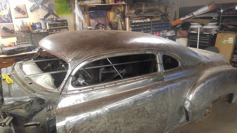

    Might be cutting a bit more off of the roof as it sits now. This popped up and flows really nice, the extended catwalk and curves look pretty awesome.
    Not sure if we can lose that height, but we'll know this weekend when I toss a seat in and check head clearance. Also need to leave a little room in case we need it later when the frame is done and the body gets swapped over.

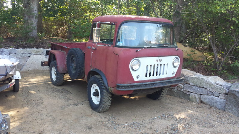

    I'm about 80% to pulling the trigger on a '61 jeep fc 170 (I know it's not a car)
    20150916_100148.jpg But it's pretty bad ass
