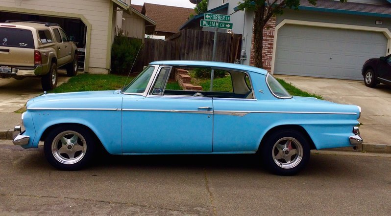

    So @DCSBFTMFW just led me to this thread and I figured I'd show off my old sled. It's a 1962 Studebaker lark Daytona. It still has the original 289 V8 and 3 speed automatic. It was my first car and I actually took my test to get my drivers license in it back in 1992.

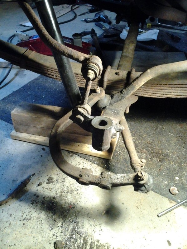

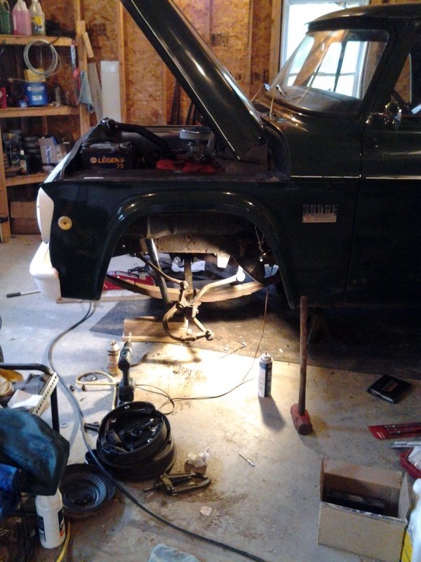

    Looks like it's missing its lower jaw, lol.
    Super high-tech and smooth-riding I-Beam axle

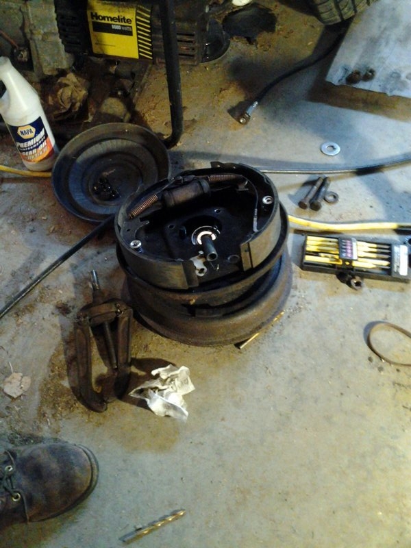

    And high-tech and responsive manual drum brake setup! :bananadance:
    Power brakes by Leadfoot, power steering by Armstrong. Want to parallel park this thing? Best be hittin' the gym.
    :benchpress:

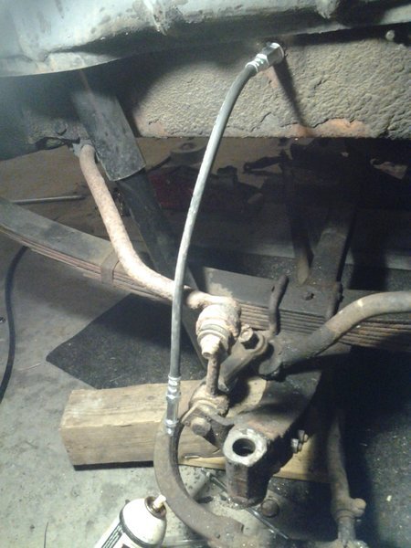

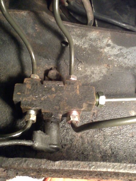

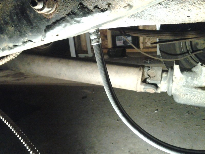

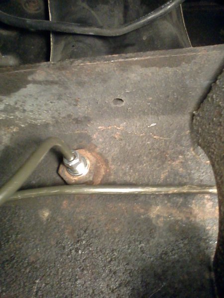

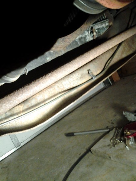

    New brake lines done, front to rear from the Master Cylinder to the Wheel cylinders (also new). Picking my spindles up from the machine shop today, so tonight I can put my front suspension and steering system back together. Then I can bleed the brakes and be good to go!

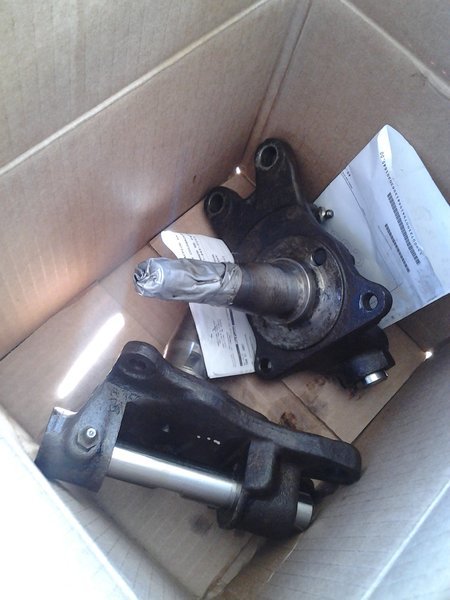

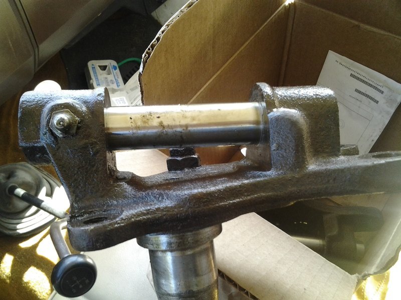

    Spindles rebushed and ready to go! Looks like I'm king pinning tonight, lol. :cool:
