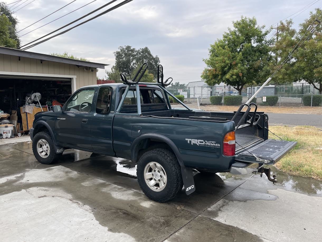

    Problem: 1st discovered going up a short grade with heavy acceleration and wind drag (kayaks on top) Air Conditioning on full. Wide open throttle until 4000 rpm, engine stumbles and quits accelerating. Releasing the accelerator for 5 seconds, the engine returns to normal operation. It does this in all gears.
    Vehicle: Stock 1998 ToyotaTacoma SR5 3.4L V-6 5 speed manual. Slightly smaller tires to make getting in and out easier.
    Parts changed: Fuel Pump
    Fuel filter
    Fuel pressure regulator
    Spark plugs
    Spark plug wires
    Ignition coils
    Ignition control module
    Air filter
    Cleaned MAF
    Replaced MAF
    Replaced TPS
    Cleaned throttle body
    Catalytic convertor
    Checked muffler back pressure
    Replaced gas cap
    Replaced upstream O2 sensor
    Notes: Truck starts easy, runs strong to 4000 rpm, about 17 mpg. Not a daily driver, 2000 miles in a year. 305,000 miles now, new short block @ 200,000 miles,18 years ago Timing belt replaced 4,000 ago. Checked fuel pressure 40 lbs.

    I get the same stumble in neutral as any gear. It is like I am taking fuel from a small reservoir that can run the engine for two seconds. After 3500 it starts depleting it faster than it can be replenished. It will hit 4500 and then drop off with audible misfires. Holding the accelerator it continues to deplete droping rpm to 3000. Releasing the accelerator for a few seconds will return the engine to normal operation.
    I put a jumper cable from the negative battery terminal to the intake manifold to insure a good ground, no improvement. Visual inspection of the brown ground wire showed no defects. Measurement the an ohmeter showed only test lead resistance.
    Replacement of the upstream O2 sensor made no difference. Shrtft1 = 5.5 - 12.5%
    Longft1 - 3.1%
    The exahaust flanges seem to have a gap between the manifold and the catalytic. I measure about .030 at the bottom of the flange, but can not press .005 into the pipe area. Moving a hand around the area with the motor running does not show leakage. There is no gasket but no measureable leakage. My truck has always had " a toyota tick" but i assumed that to be an exhaust problem. The exhaust valve clearance has been checked many times.

    Hey Digiratus,
    is there a button on this forum for handing out Gold Stars, because if there is, you deserve Two of them!
    Your suggestion was spot on. The Crankshaft Position Sensor cleared the problem immediatly. Several had told me I sould be having starting problems, codes, etc. I had none of that. I was starting to think I was too picky, do I really need to go over 4k rpm?
    Rather than dwell over all the needlessly replaced parts, I can take stock in the maintenance that my last the rest of my lifetime, and enjoy a great running truck in the mean time. Things I have been putting off (like kayaking) can now be enjoyed for the rest of this summer and next.
    My thanks to all the members that offered suggestions, I followed up on each of them, you can see all the logical hunches I tried before arriving here, they are all good. Different perspectives and experiences make for solutions that may take AI years to approach.
