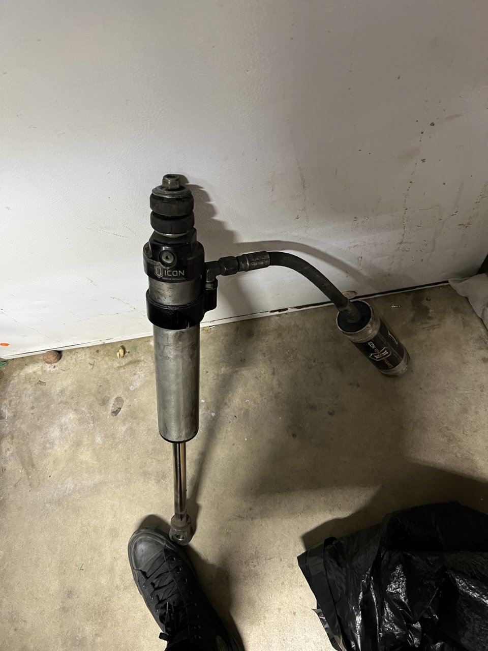

    Was wondering if these old set of icons are worth the repair cost, they’ve been on the truck for about 7 years and really doubt they’ve ever maintained. I went for a set of Rancho 9000xl since theyre the cheaper alternative.

    Worth a shot I'd say. Rebuilding a shock is fairly easy and inexpensive. Assuming the shaft and piston are in good shape, you just need new seals and some fresh oil and they should work like new.
