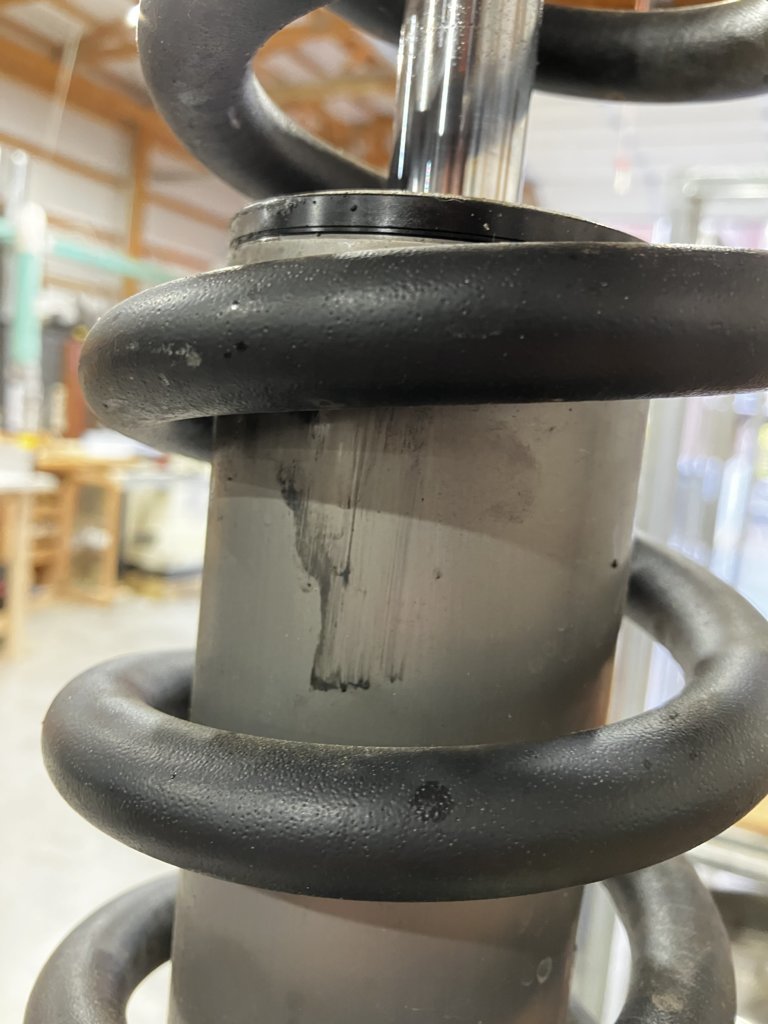

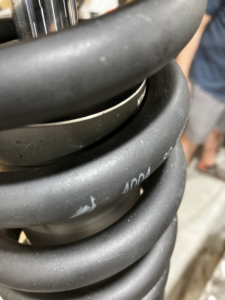

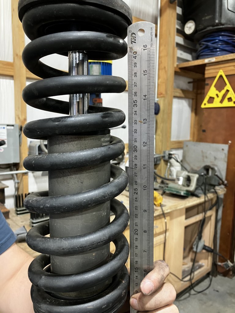

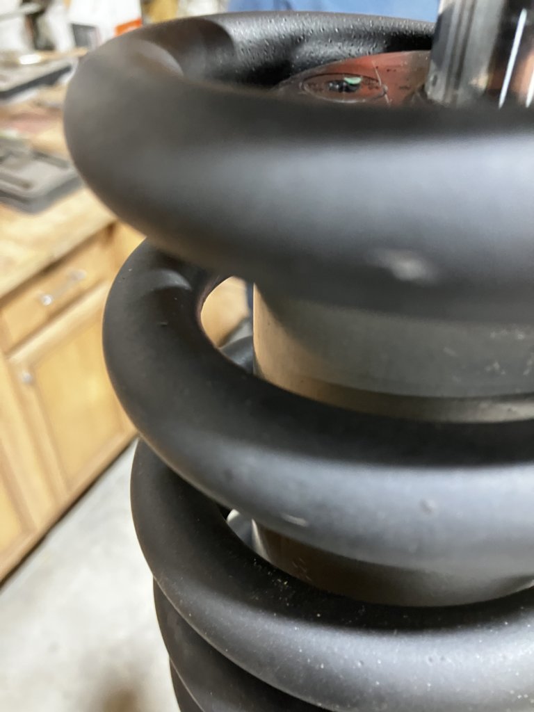

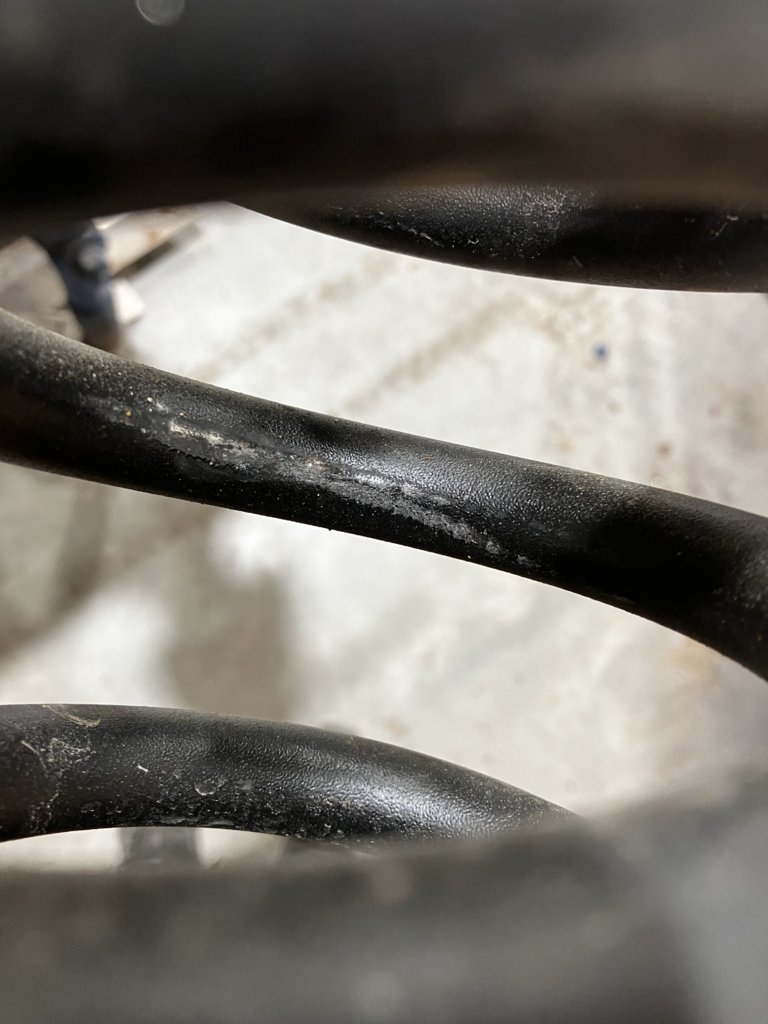

    I feel like something is going on with ARB. I've had Nitrocharger Sports on my 03 for 11ys. So I trusted them and spent big, but I am having a terrible time with the MT64 suspension. The coils are wonky & bent & rubbing the shock even though they're centered on the base and top hat.
    I started a thread trying to figure it out, and here's where I'm at:

    That does seem odd though. It's still a good reliable brand for most people. Does it have anything to do with the spring seat and top hat positions?
