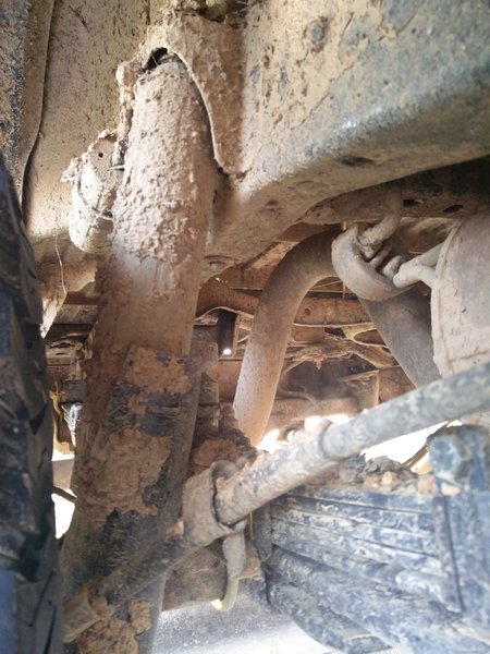

    You can adjust the front height from the coils and the rear by removing or adding the leaves. It's supposed up be around a 2-3" adjustable lift but mine went about 4". The picture are my before and after measurements from the technician.

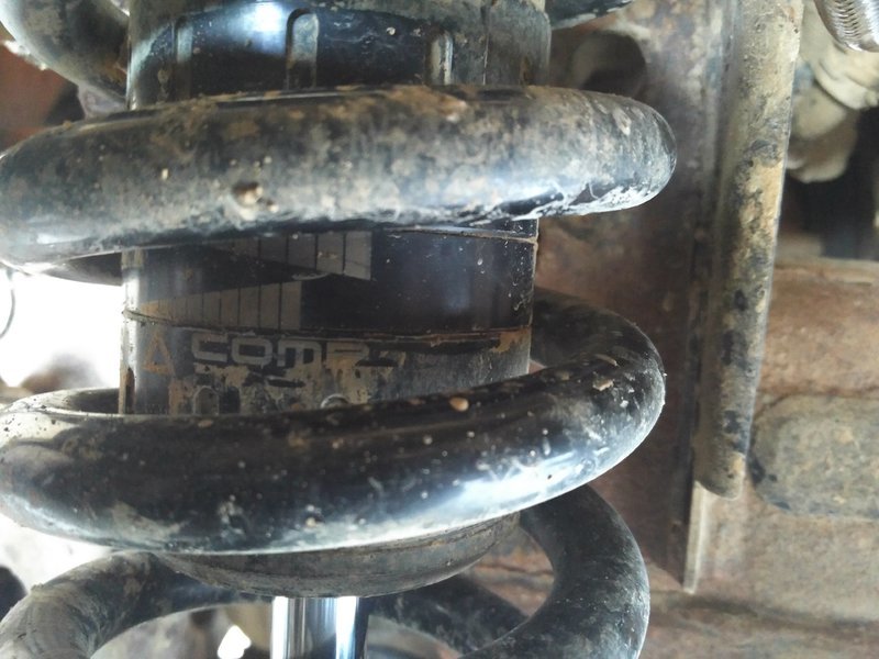

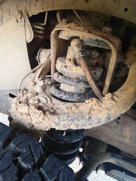

    The suspension handled great. When I moved the front compression to the second line it became super soft and I could hardly feel the small bumps going about 10-15mph. I didn't adjust the damping or rear cause it was a pain to get to and everything was covered in mud. My tires were around 33psi.

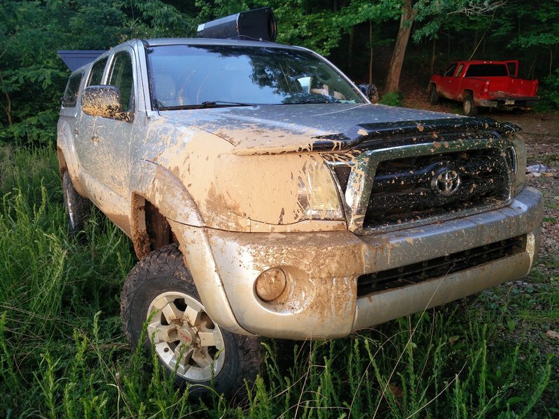

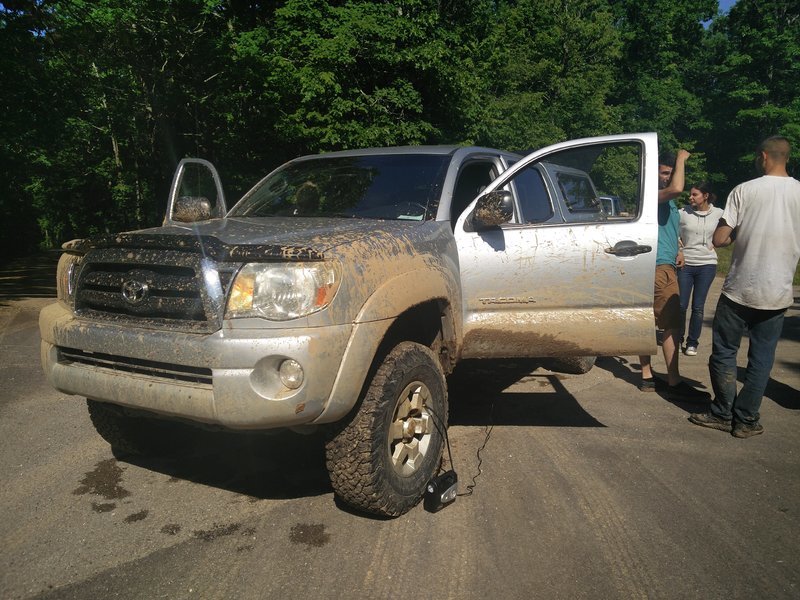

    We did trail 308 at LBL and it was basically all mud. We actually had to turn around at one point because the mud was too deep. So far I'm loving the suspension. It's easy to adjust and the adjustments really make a difference at each setting. I'll keep playing around with them and tell you what I like best at some point.
