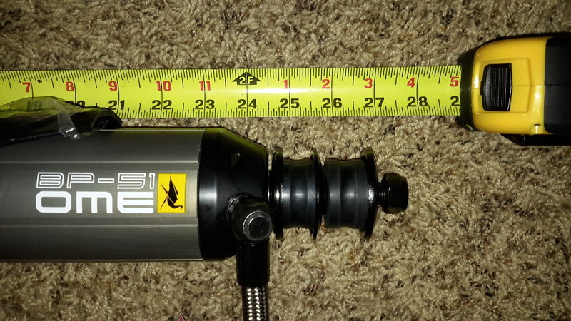

    do you know the extended/collapsed numbers on the rears?
    I'm wondering how they'll work with a shackle flip in the rear...gaining a ton of droop

    2x ^^^^ measurements for shock

    Where do I measure from?

    from each mounting point..usually done while its still uninstalled

    Emailed ARB USA got a prompt response/tracking # kit arriving tomorrow, install Tuesday will take before and after measurements to add to the poll

    As far as I know the collapsed/extended length is the same as OME shocks, IE these are not extended length rear shocks. Someone else want to chime in?

    aww, so not usable with shackle flip.
    I did see the JK bp-51's have an extended shock option, not sure if the mounting is the same though

    rear BP-51 shock length when extended as measured from center of lower mount eye
