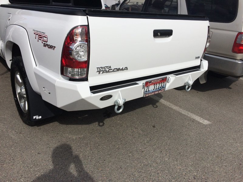

    Believe that's an all-pro.
    EDIT: Illuminati confirmed, it's definitely an all pro. I put one on a few weeks ago.

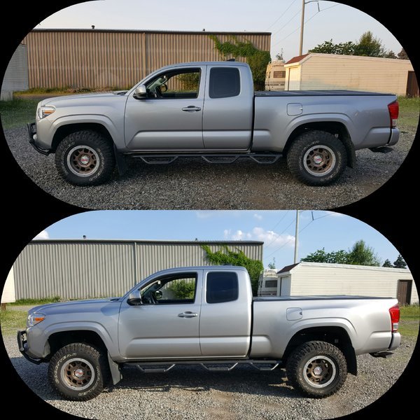

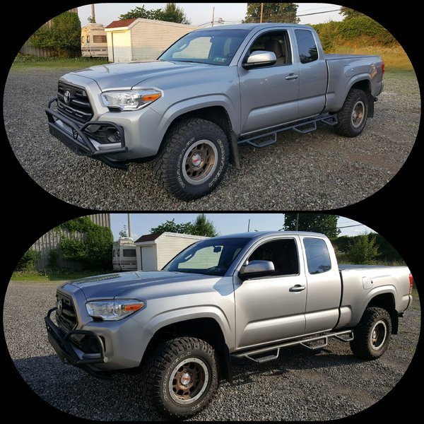

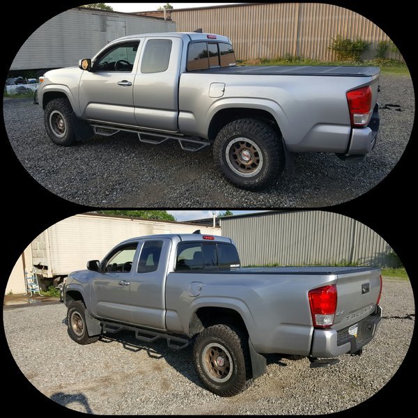

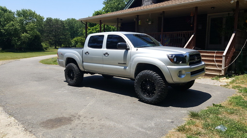

    Just installed my OME kit Saturday with 887s and rear dakar leafs. Also added light racing upper control arms along with 2" extended stainless steel brake lines!
    My lift #'s
    Stock suspension:
    Front: 21"
    Rear: 22"
    OME Lift suspension:
    Drivers Front: 23.75"
    Passenger front: 24.00"
    Drivers rear: 24.75"
    Passenger rear: 25.00"
    Picture's:

    ^ That thing looks huge. Not height-wise, size-wise.

    Lol its not big it's a 4 cylinder also!

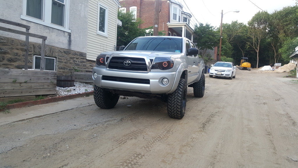

    887 1.5 AAL JBA UCA's 285/70/17 Trail Graps 17x9 Fuel Hostage Custom Headlights
    OME 887 on 285 Trail Graps

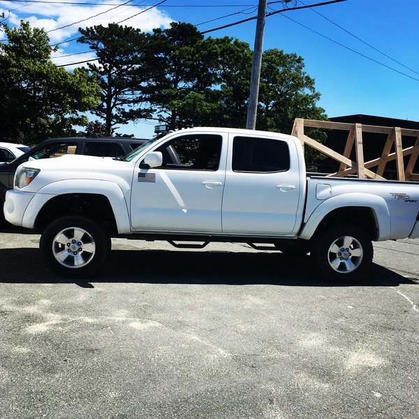

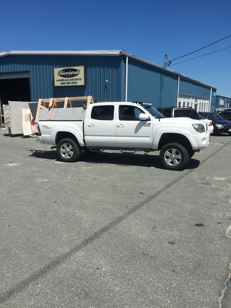

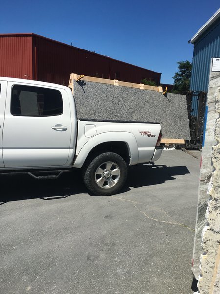

    2009 white Tacoma TRD with 3" OME lift kit, 855 coils, and dakar springs, total chaos UCA's, Nurf steps, 50" Led upper windshield mount radial light bar, 17inch SCS Ray 10 matte black, Cooper STT PRO 285/70/17, blacked out badges, tinted.
    First one is new lift with 885, dakars, and total chaos UCA'S. Second two are it loaded down with 1100-1200lb slabs of stone I'm impressed!image.jpg image.jpg image.jpg

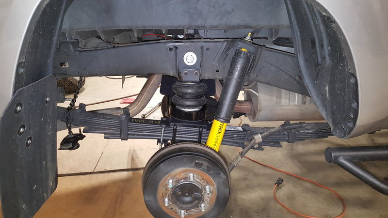

    Did you remove the 3rd leaf on the Dakars? I just ordered the same kit last week. How does it ride?

    Nope left the leaf pack alone and it rides great! I also have the firestone ride rite air bags on them also!

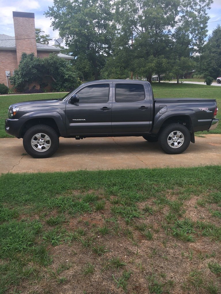

    I installed mine this past weekend. Rides like a dream. No clanking, banging, etc. Couldn't be happier.
    887's and Dakars.

    That set up looks great!!

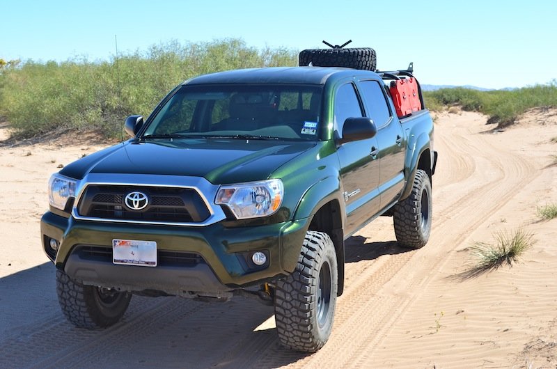

    886s and dakars. About 2.5" extra
