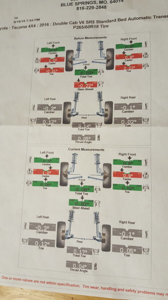

    Stock UCAs? If so, do you remember your caster settings?

    Yes, stock UCA's. I have the printout at home for the alignment. I'll post the #'s when I get home
