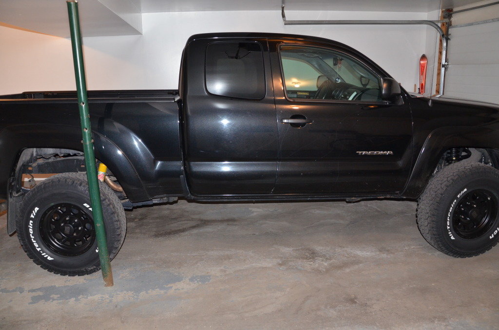

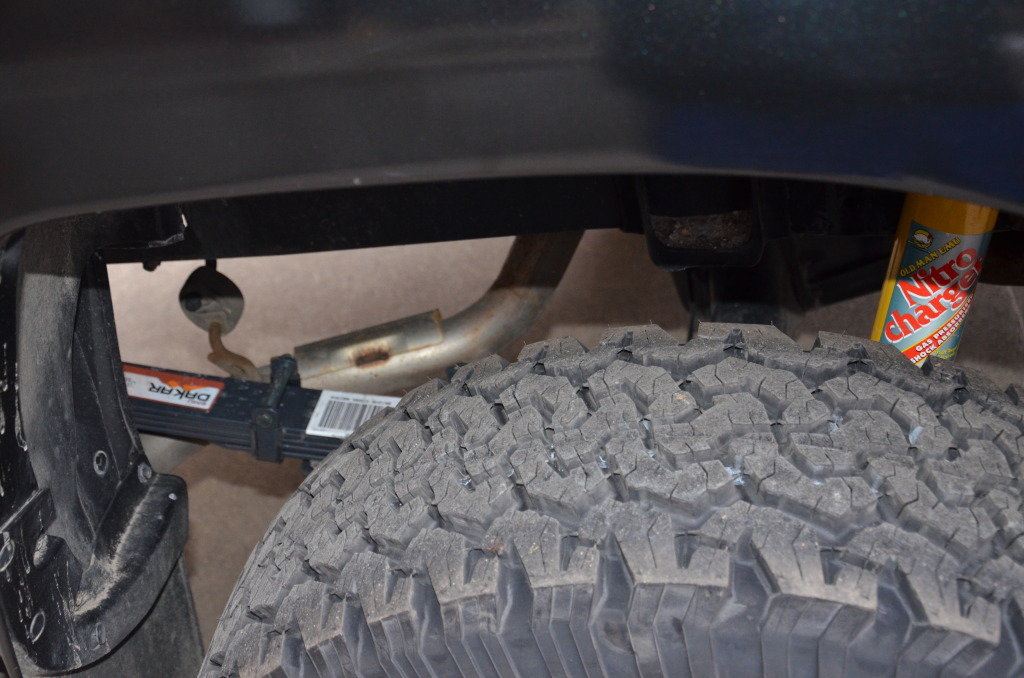

    I am just putting this picture up for now until I get a better one.

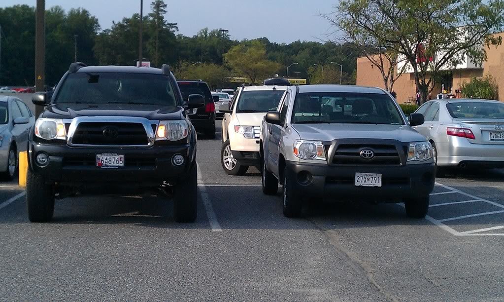

    Not a great pic , I'll add a couple better ones later
    885x , no top plates , 90000's , N182's , Dakars , LT275/70/17

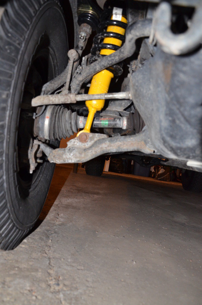

    Crappy pic, but 885x, 1.5"aal, (waiting for dakar funds to build) ome shocks all the way around. 265/75R16.

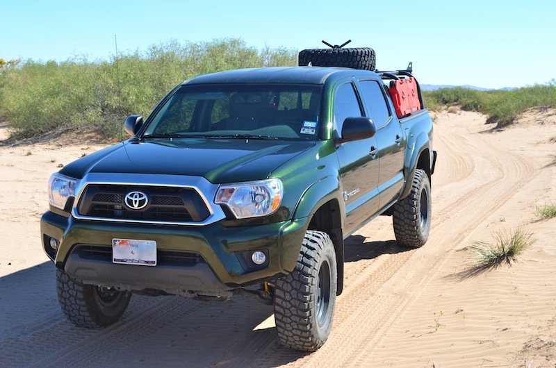

    OME 886 with Dakar rear springs and light racing UCAs

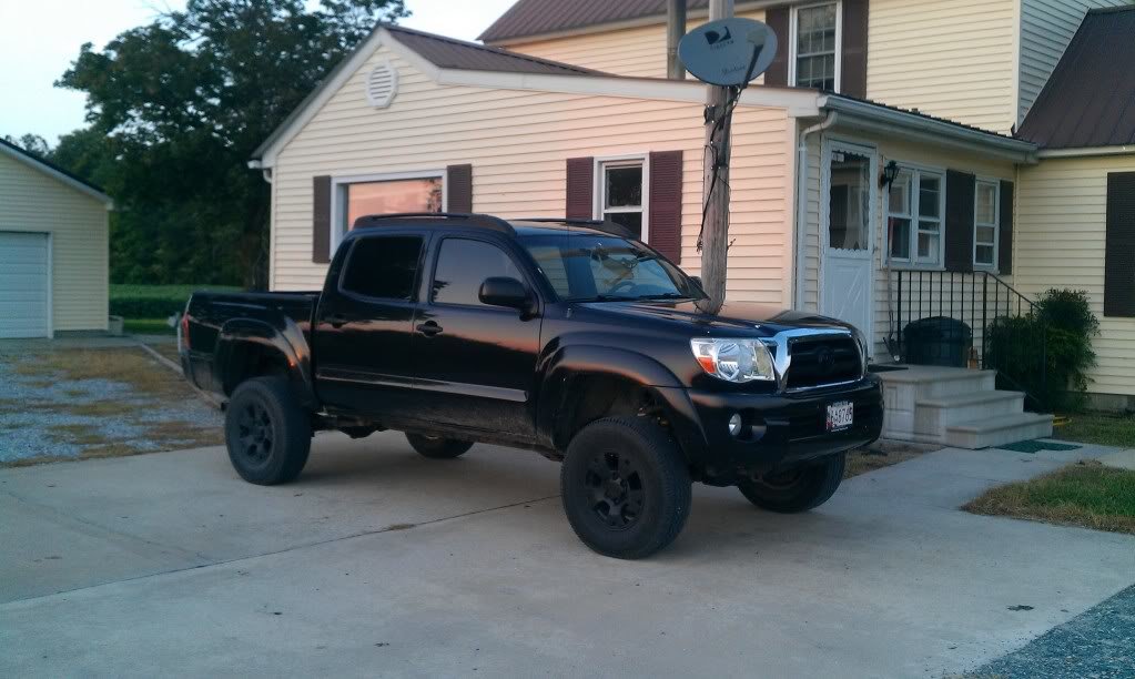

    2007 TRD OR DCSB
    OEM 885's on the front
    Full Dakar pack on the rear
    265/70/17 BFG AT KOs on OE 17" TRD Sport alloys

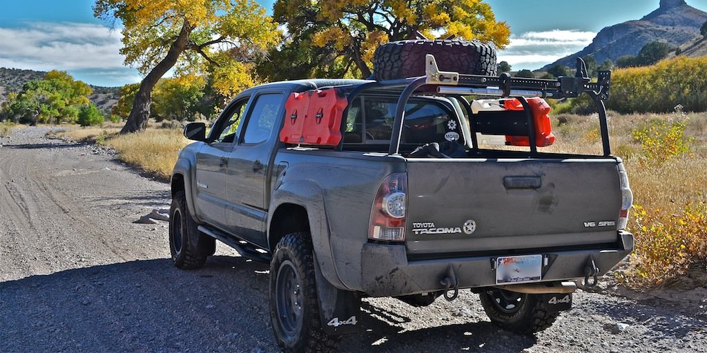

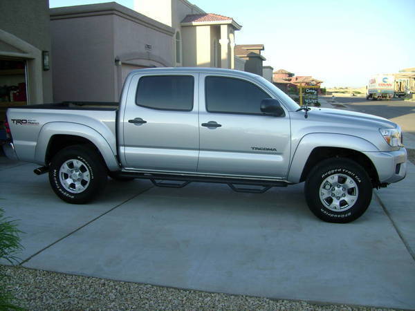

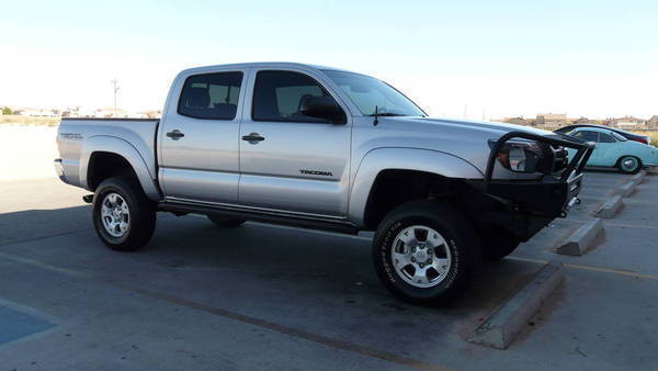

    -OME Suspension
    --886x Coils
    --90000 Nitrocharger Front
    --N182 Rear
    --CB Drop Kit
    --Trim Packer
    -Dakar Leaf Packs
    -Toytec 3 deg Shims w/Longer Center Pins
    -LR UCAs
    *Pre-Lift Hub Center to Bottom of Fender Measurements:
    FD: 20 1/4"
    FP: 20 3/8"
    RD: 22 1/16"
    RP: 21 5/16"
    **Post-Lift Hub Center to Bottom of Fender Measurements: (Taken on 7/15/12 with 4,267 miles)
    FD: 23 1/2"
    FP: 24 1/8"
    RD: 25 1/8"
    RP: 25 1/16"
    ***Post-Lift Hub Center to Bottom of Fender Measurements taken at 7,200 miles on 11/2/12. Additional weight added: Bumper, Sliders, VR8000-s, RI 20" SR LED, RI Duallys (2,933 miles since suspension install)
    FD: 23 3/16"
    FP: 23 13/16"
    RD: 25 1/16"
    RP: 25 1/16"
    The Front Driver's side is 5/8" lower than the Front Passenger's side depite having an OME trim packer installed. I will be installing a 1/4" top plate spacer to the driver's side, which should give me approx. 1/2" additional lift. Hopefully that will even out the front:

    OZ-T, are you using wheel spacers?

    Nope

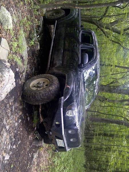

    My '11 with OME 885s & Dakars rolling 255/85/16 BFG KM2s on 1st Gen TRDs.
    Clean
    Out having fun
    Prelift
    Postlift

    Yeah you're right. 886 is the way to go with the added business. I have 886s and it dropped when I added my bumper and winch.
