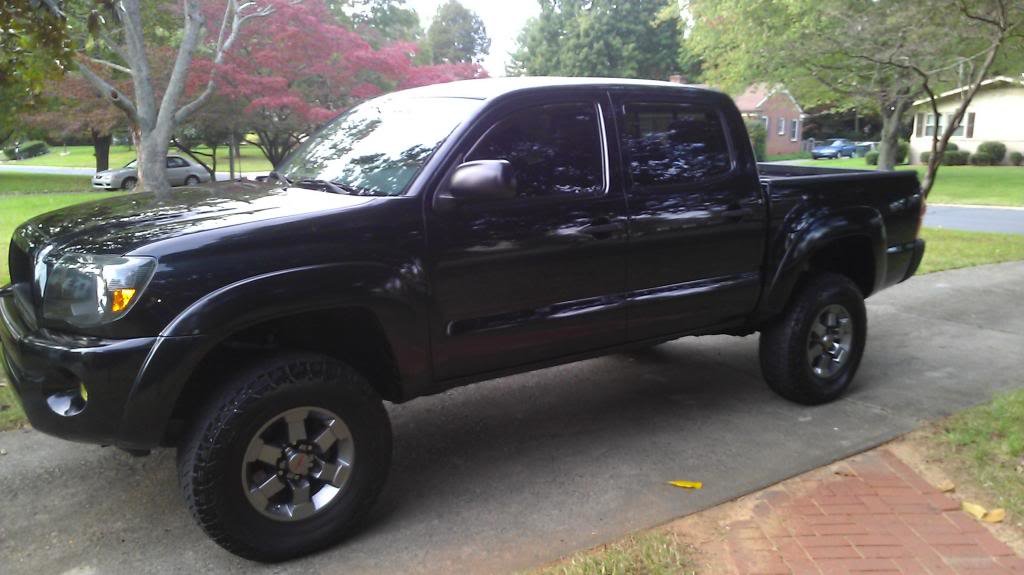

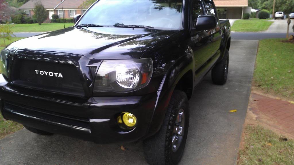

  14. Jan 4, 2013 at 6:29 AM
    #174

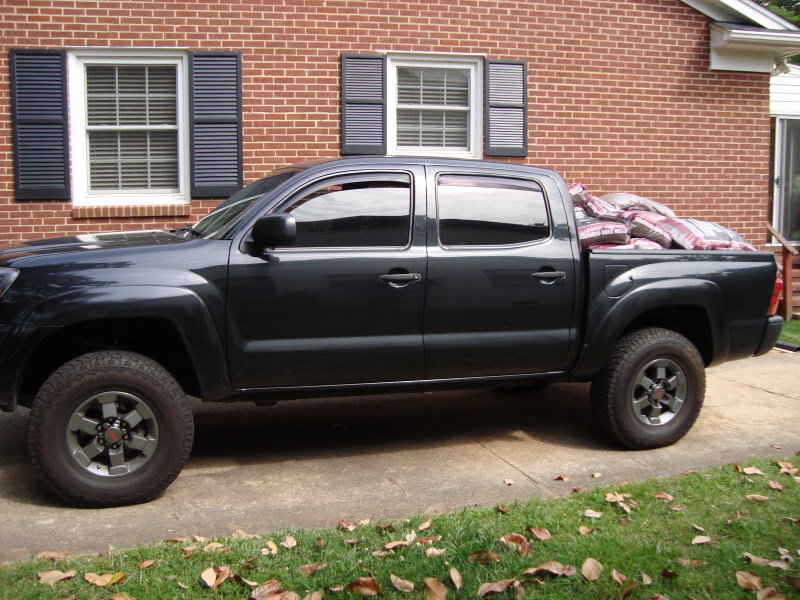

    ACE_Taco
    ACE_Taco Long Range Practical Marksman
    Jan 3, 2010
    #28682
    204
    NC
    08 DBLCab TRD 4x4
    OME 885x Coils, Dakar Leafs, OME Shocks, TC UCAs, BHLM, Tailgate MOD, WeatherTec Window Deflectors, WeatherTec Floor Mats, Blacked Out chrome bumber, Satoshi Grille, Wet Okole Seat Covers
    No offroad pics, but with approximately 1,600 lbs. of mulch.
    Cleaned up..
  15. Jan 4, 2013 at 7:41 AM
    #175
    Eagledynasty
    Eagledynasty The White Knight
    Dec 8, 2011
    #68427
    1,659
    AJ
    Worcester, MassHole
    09 Super White DoubleCab Off-Road
    2009 SWDC O/R. Check Build!
    Damn thats a clean looking truck!
  16. Jan 4, 2013 at 8:55 AM
    #176
    la0d0g
    Jan 25, 2011
    #49903
    19,882
    running for the hills
    For crawling not hauling
    x2, those wheels look great on there!

    ACE_Taco
    Jan 3, 2010
    #28682
    204
    NC
    08 DBLCab TRD 4x4
    Thanks. Tried the Duragloss 501 / 105 combo after claying. Slick as a whistle.
    Thanks. I have enjoyed them. My next MOD will be 886 coils and a bumper.
