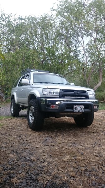

    I put a 3 inch ome with 265/75/16 bfg ko2's on my previous 2001 4runner and after a couple months and alot of reading I wanted to do a full icon setup but never got around to it. So after I sold my 4runner and bought my new taco I decided to save up for an icon setup. My lift is the icon stage 3 with aal and tubular uca's and it is NIGHT and DAY compared to my last ome setup.although It being a brand new taco might make it better too I've always learned to spend the extra cash for the better product in anything.
