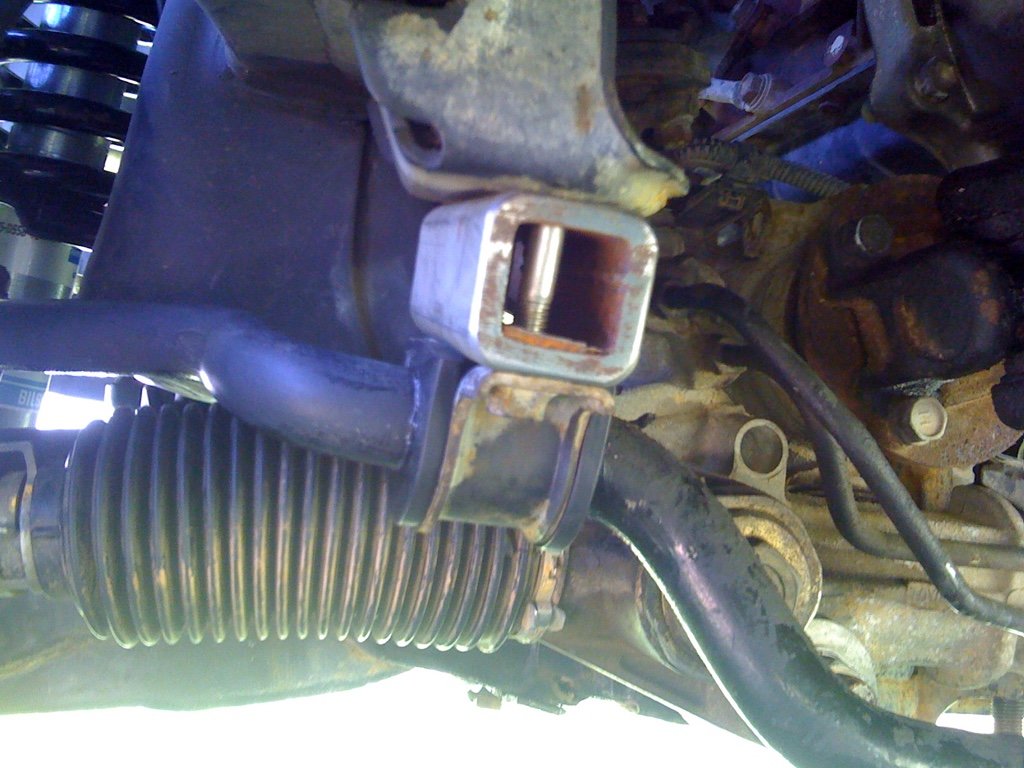

    The easiest boot mod is to take off the factory band, pull/stretch the boot out, burp so air into it to expand the ribs back out, and zip tie it down as tight as possible.

    Here's the brackets I attempted to use that didn't work. They were to lower the sway bar.
