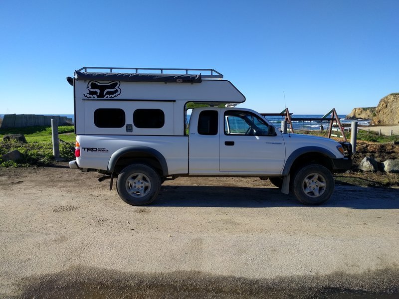

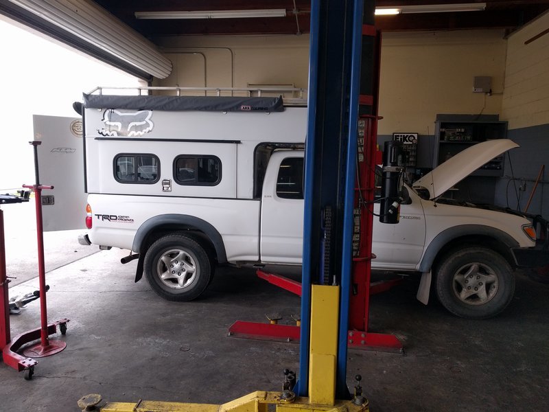

    I finally did it! Got the new suspension installed on the truck yesterday and couldn't be happier. Handling is amazing compared to the aging and overworked stock leafs and coils and blown P.O.S. KYB shocks. With the ARB bumper and the oversized shell I opted for the 2883 coils and the Dakar leaves with the additional CS046R leaf added into the leaf pack for extra support. I also did the OME nitro shocks on all 4 corners since they are designed to be used with the OME kit. I ordered everything from wheelers offroad and they were great to buy from and very helpful in answering a few questions for me.
    I now have a little bit of cv boot rub in the front, but am planning on adding a warn winch in the near future and expecting to see everything settle a bit more with a few more miles. The ride is substantially more stable and surefooted on the road now. It went from felling like driving an overloaded box truck on mr toads wild ride to feeling like a normal car or truck on the road. Don't have enough off road time to report on that yet, but the bumpy, lumpy barely maintained county roads by my house feel much better than before also. It is a little more stiff in terms of small bump compliance at speed, but not in an uncomfortable way.
    Before:
    After: (~20mi later)
    The cabover shell on the back was made by Access Mfg. (same company as Tradesman) and weighs about 400#. I got lucky and found it used locally. The home-built roof rack with 2x100w solar panels, cargo platform and awning ad an additional 125#. There's also a basic wooden bench/storage/sleeping platform/surfboard storage setup inside as well as an engel fridge, light electrical system and 125Ah battery for the solar system. I didn't see many picture examples in this thread of trucks with heavy bed loads so I hope seeing this could help someone else know what to expect. The extra set of (new/old) leafs, coils and shocks are in the back in each picture also. Altogether ~800lb extra on the bed and ~100lb on the front with the bumper. The truck is a 4wd manual V6 extra-cab.
    Next up is all terrain tires and a winch. Looking forward to much, much, more!

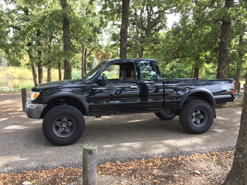

    OME front and rear with Light Racing UCA's. 16in SCS F5's
