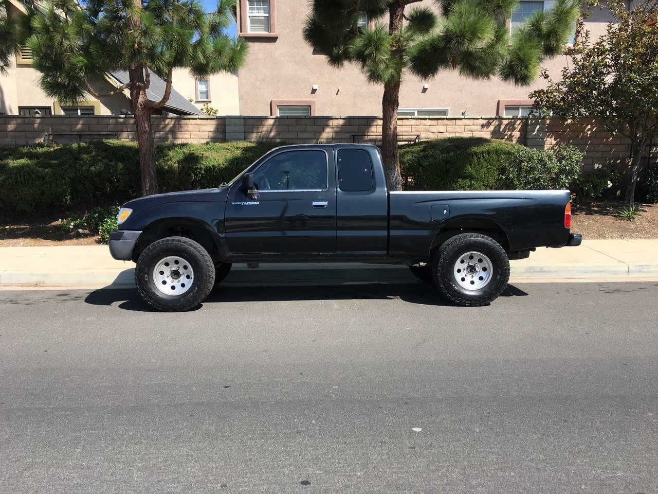

  17. Sep 9, 2017 at 9:35 PM
    #3257
    STEVEO13016
    STEVEO13016 Well-Known Member
    Jun 22, 2016
    #190258
    172
    STEVEO
    2000 Tacoma Prerunner V6 2WD
    5100 Billy's set at 0" with 881 coils
    IMG_3628.jpg My 881 coils finally started to sag in the front...
    m3bassman likes this.
