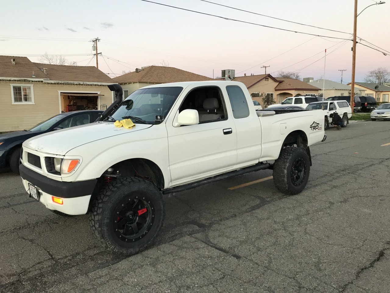

    I put some old man emu Dakars cs019r leaf packs. Anyone know which leaf I can remove it’s sits pretty high in the back. I was told I can remove 3rd one counting from top. BEA5C65F-D636-4872-B022-E894607D0131.jpg

    I’ll see if I can snap a pic of mine later today. It’s a good leaf pack IMHO, lots of options. Whatever you remove, I suggest keeping it incase your set up changes.
    A few members have posted useful info on the CS019r including @jjsul and others...

    Agreed. Keep any leaves you pull out of the pack. I pulled one of the longer leaves (not an overload) when I first installed them and am planning to put it back in this coming spring.

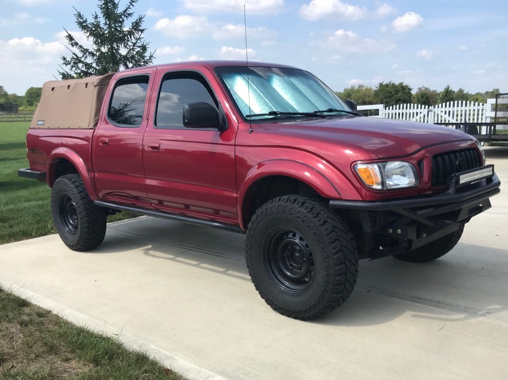

    Basically stock. OME 882s, HD Dakars and nitrochrgers, TG front bumper, custom rear bumper, 4Xinnovations sliders, RAT skids, Softopper, 255/85/16 ST MAXX's on 16" steelies, 1" B.O.R.A. wheel spacers Scangaugae II, deck plate mod, grey wire mod,ECGS bushing, diff breather relocation, alarm mod, defrost w/o compressor mod, de-badged, sockmonkey beside decals.
    To you fellas that know the OME setups. I’m looking for aproximately 3” inches up front over stock height. I currently have 5100’s set at 2.75 with factory coils which I believe are worn and sagging after 103k miles. Up front I have a tube bumper, no winch, full RAT skids and sliders. From my research I’m thinking 882s with the trim pack and then the 10mm spacer kit? Does this sound like it would net me about 3” after it settles in?
    Current set up with stock coils on 5100s set at 2.75. Tires are 33s(255/85/16)

    882’s or 883’s will yield the closest to 3”

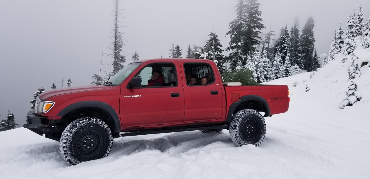

    These pics are 881s, I threw 882s on friday and havent gotten them to settle in yet. Still at 24" c hub to fender.

    I dont have a winch in yet either, I also have a 1in body lift on there as well, so that might be why you are seeing so much clearance. I can say my cvs are at around 30deg angle. Which is more then im comfortable with.
