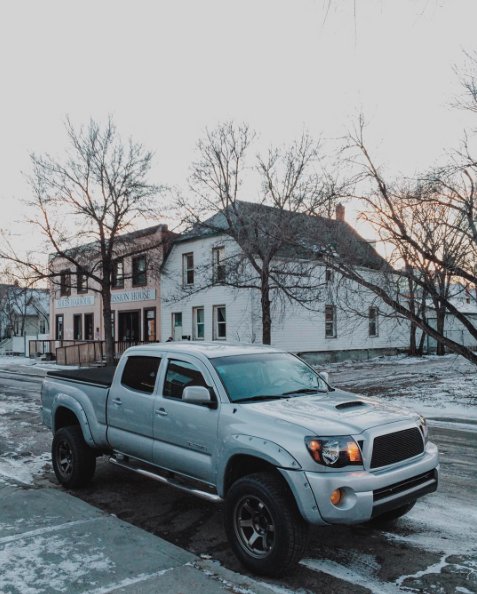

    Hey guys, I recently purchased a 2007 Tacoma with the Old Man Emu suspension. It appears that the rear leafs were upgraded as well. Now the truck doesn't sit fully levelled. The rear end sits higher than the front. My question is, with this suspension upgrade, is it still possible to add block lifts to the front suspension to level the front out? My truck rubs with my new wheels and I don't like the look of it not being levelled. Any help would be appreciated. Thanks in advance!
    Screen%20Shot%202015-11-27%20at%2012.48._e43d4b72e15e293a6cac4d395bdbb96b4077f028.jpg

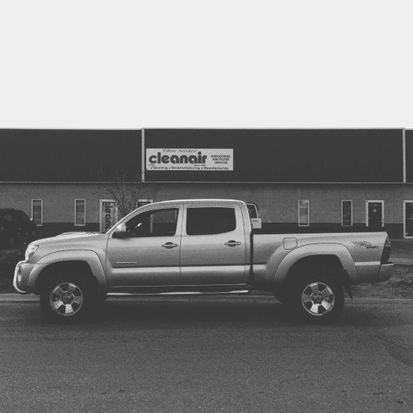

    You can see that the rear sits substantially higher than the rear
    Screen%20Shot%202015-11-27%20at%2012.54._3154251dc477472015632de51f1125a40c719bdd.jpg

    Some weight in the rear will level it out :D
    I would imagine you could still do the top plates. Check to make sure the mounting studs on the struts are long enough to add plates. Install of the plates is pretty easy.
    A couple things to consider: If the truck sits level when empty, it will have ass sag with weight in it. Also, it looks like you are pretty close to 3" of lift up front already, which is about the max on these trucks for a suspension lift. The down travel has been greatly reduced already, plus the CVs and their boots could be stressed if you go higher, and you might experience the struts topping out on bumps.

    OME offers spacers for the front assembly which should level you out. Sounds like you have OME Dakars on the rear, which give ~3" if lift. Only way to get 3" up front with OME is to use those spacers from what I have seen.
