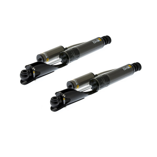

    Anyone running the newest of new OME BF51 kit!?image.jpg image.jpg image.jpg

  18. Sep 12, 2016 at 11:17 PM
