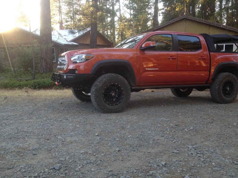

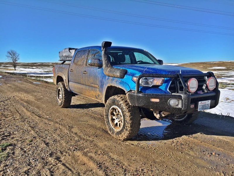

    So these BP-51 Coil-Overs are designed to handle any weight possibility's. They can be set up for light loads or heavy loads. We probably won't see an extended version anytime soon if not ever. ARB is very conservative. They make Parts to Work and Last. They are also conservative when offering certain ride heights. This kit is claimed to be a 2" Lift. Most the time Old Man Emu runs 1/4" - 1/2" taller than claimed. Also this is a Coil over so you can turn the adjuster to increase ride height. ARB stop by before and after Cruise Moab with a Brand New 2016 Tacoma with this kit on it and it looked more like a 3" lift.

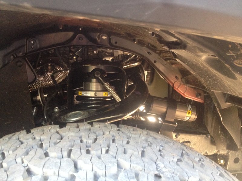

    Just installed this kit on mine!
    I ended up with about 2 3/4" over stock. So far this is the first suspension that has exceeded my expectations! I have run icon, King, fox, bilstien and the old ome stuff over the years and never had
    A suspension I was happy with.
    This kit seams to have a better on road ride than stock and the offroad performance is impressive.
    We will see how they hold up over time but arb products are built to last so I don't see there being any issue. image.jpgimage.jpgimage.jpg

    From the looks of the pic you can keep the stock UCAs?
  17. Jun 29, 2016 at 10:14 AM
    #57
    Dissent86
    Dissent86 Well-Known Member
    Jun 18, 2016
    #189898
    721
    Ben
    2016 trd offroad Tacoma.
    Yes,
    Arb says it was designed to be used with factory uppers.
