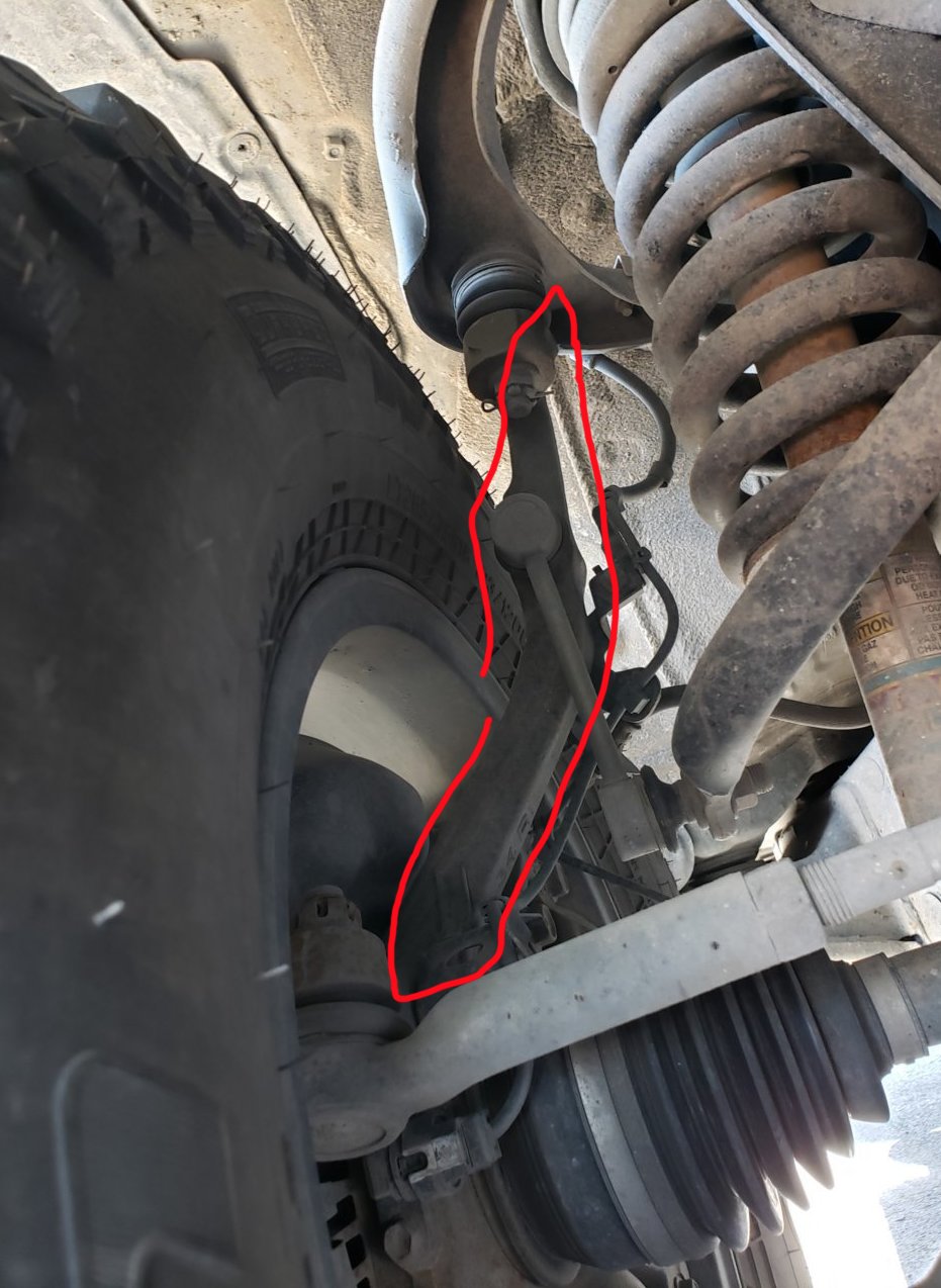

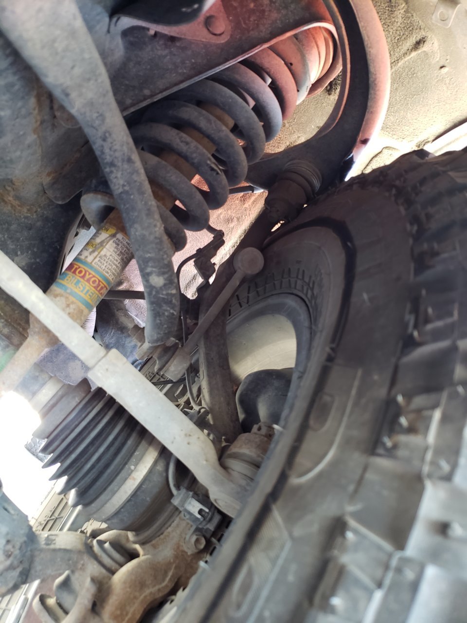

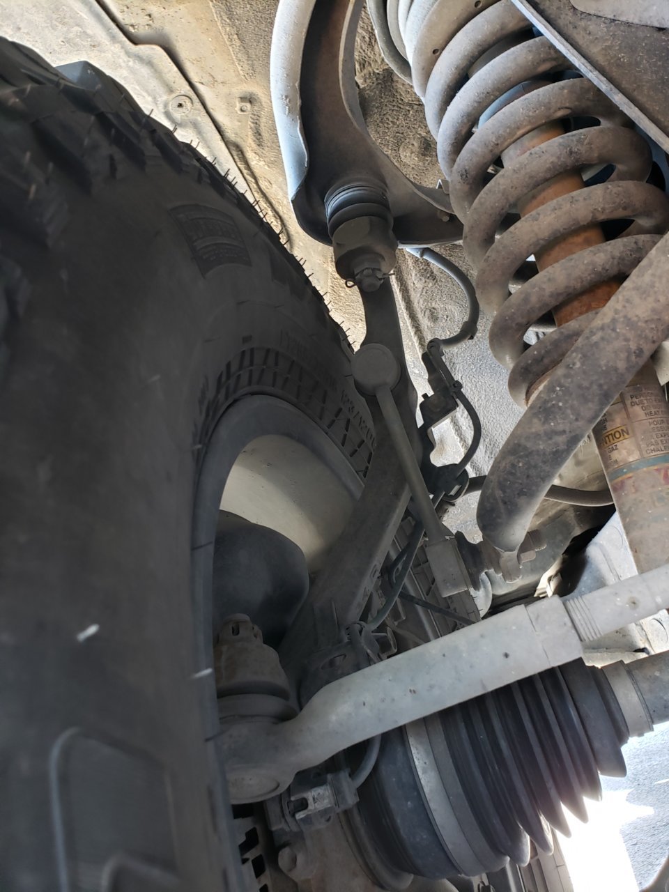

    Took an s u v to my left front tire today...scuffed up plastic on plastic, but no dent...yet the top of the tire leans in and rubs...had it towed to my dealer...what is bent?

    Spindle got bent probably, maybe the control arm/arms.

    Spindle is most likely culprit.

    I thought these things had no spindle just a double ballbearing unit.
    I'm thinking UCA or the upright link between the two arms

    Spindle links the upper arm to the lower
    This guy
    They are stout but if you hit something hard enough especially at an angle, they can bend

    That's why a lot of guys that do moderate to difficult offroading will have their spindles gusseted to strengthen them. Not uncommon to bend a spindle offroad if you hit something just right (or wrong as it were).
