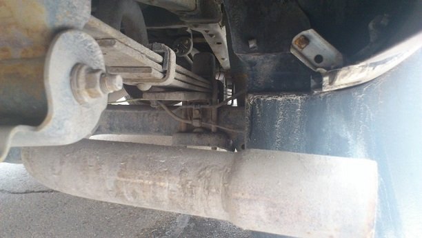

    Just as the title states. Is this TSB leaf pack still any good?
    It does not have a negative arch really, but seems quite flat to me. Is that how its supposed to be? I mostly see pictures of lifted trucks here on TW with leafs arched and built to give lift so it is hard for me to compare.
    To be honest, I was never really impressed with how much the truck sagged with a few hundred pounds in the bed and always wondered if the leaf pack was close to shot.
    Either way, what would be a good replacement leaf pack, even if not now, but down the road that will not give any lift. Would like to keep the truck stock height for now. I would most likely buy a set of four 5100 at that time. Wheelers HD 5 leaf pack made by Alcan? Other options? Thanks.

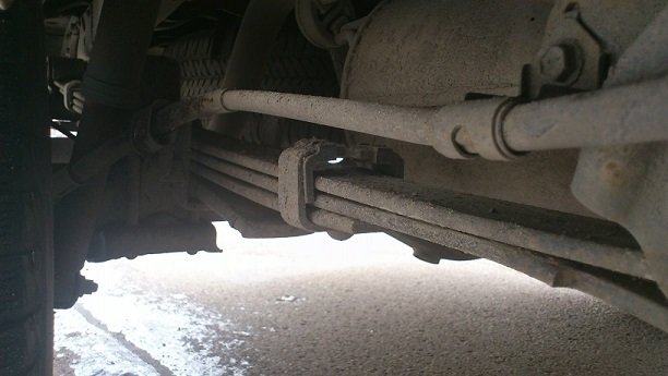

    Driver side:

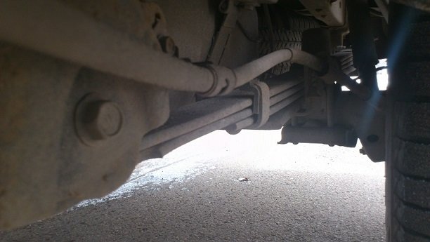

    Passenger side:

    Seem like it does suck, at least that is my impression of it, just not sure how accurate my evaluation is as I have not driven any other Tacomas, just 1/2 tons and 3/4 tons and that is apples to oranges.
    What I mean is:
    Is my leaf pack shot? Therefore the disappointing performance?
    Or is my pack actually in alright shape, but TSB leafs just plain suck?
    As for wheelers hd 5 leaf pack, my understanding is, it gives roughly the same height as TSB springs do, therefore a supposedly better replacement than stock for someone not wanting to lift?

    I suppose that means mine are already sagged and would sit higher were they newer and they are close to end of life...

    I would say , yes

    Honestly. Even the TSB leaves blow. I heard about the TSB on here, and after throwing my bike in the bike a couple times and riding the bumpstops, I went to the dealer...the only change I noticed was i got about 1" of free lift in the back, for about a year...and my bed slammed the bumpstops more...instead of just sitting on them, when I had my bike in the back.
    Right now? They are flat. I step up on my bumper and jump up and down and slam the bed against the bump stop. that's with my toolbox in...maybe 100 lbs tops.
    The TSB leaves are great if you plan on never having any weight in the back. Probably best if you don't put anything in your backseat...let alone 2-3 adults in the back.
