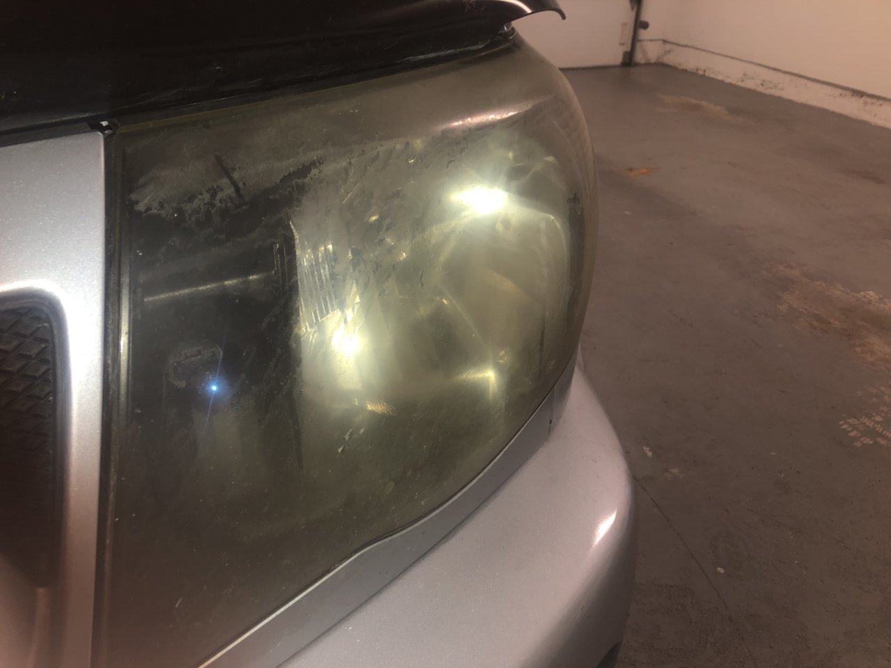

    Like many older 2nd gen Tacomas, my headlights have become hazy and fugly with age. Historically people have polished theirs back to new but at this advanced age of my 2006, I think they may be due for replacement. I used a Rain X chemical application that cleaned them up only slightly. Last week I briefly tried polishing them back with my random orbit polisher and Sonus FX-1, the cutting polish of the Sonus 3 stage polish line. Granted my polishing pad was old but several minutes of polishing yielded very little, and wondering if anyone has had success, what they used and how long it took.
    If anyone bought new headlights, which off brand do you recommend? I did the BHLM when the truck was new and I like the black look and want to keep that.

    Easy to replace. I pulled mine when the truck was new to paint them black. Here is mine now after a brief attempt at polishing. I used a fair amount of my Sonus FX-1 which is expensive stuff. At some point the polish may cost more than replacement headlights.

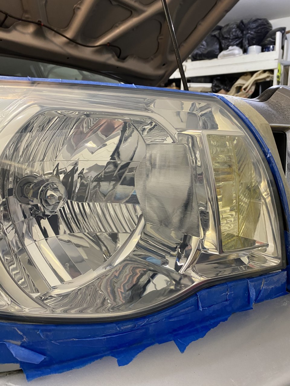

    Mine where completely hazy and yellowing I I was able to restore them to almost new condition. I used the 3m kit and hand sanded. If you take your time and out in the work they come out really well. With the first stage you have to sand out all the oxidation and yellow then as you move up in grit you have to make sure you remove all the scratches from the previous sanding. Then like others suggested get a good clear and they will last a long time before needing any other attention. The 2k clear works really good for this. I did mine over 2 years ago now and they still look good. 7E813EE4-287B-4CFF-B06A-98FD3152FE21.jpg

    I used the 3M kit that was about 30 dollars. It took almost an hour per headlight but it 100% worked. Sanded from coarse to fine grit progressivelt. It was an absolute PITA but it beat replacing the headlights.
