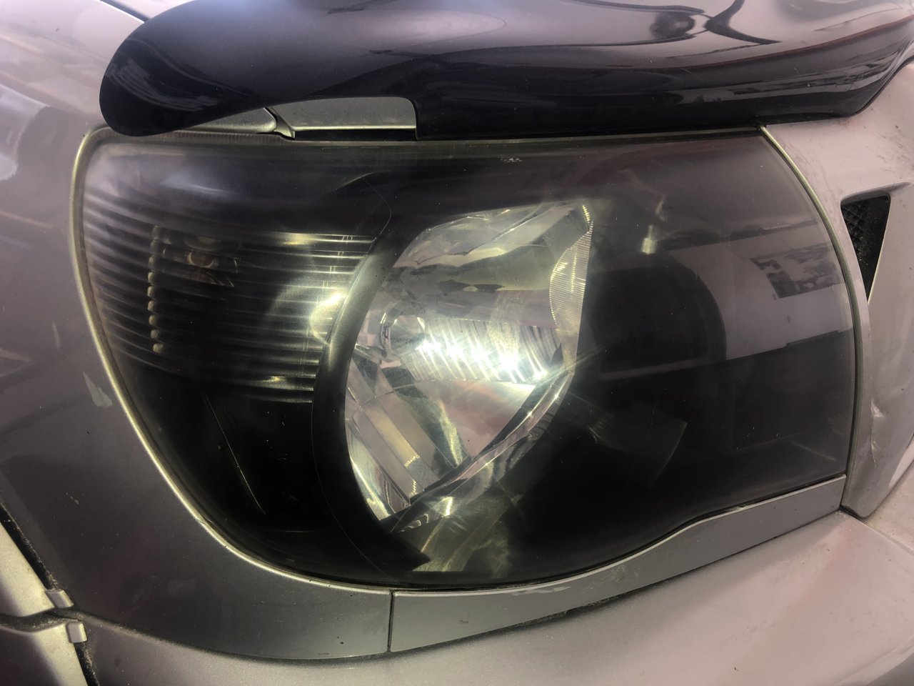

    I used Meguires Heavy Duty kit and it worked pretty well. I also had some 600, 800, and 1000 grit sandpaper handy and hit it hard with that before doing the buffing stages. I think those extra passes with the sandpaper made the difference. Most of the bad reviews of those kits are because there was too much elbow grease required and not enough sandpaper of the right levels.
    Afterwards, you either need to do a clear coat option (2k shown above) OR be prepared to apply the Meguires UV protectant (also shown above) or a similar product every 6 months.

    some evidence. I think I did one or two more rounds after that initial
    “After” picture.

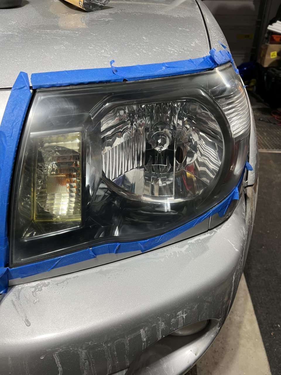

  13. Mar 30, 2022 at 11:37 AM
    #33
    Sprig
    Sprig Well-Known Member
    Sep 28, 2017
    #231426
    2,925
    Ken
    N. Calif. The Twilight Zone
    Tacoma TRD double cab 4x4, Barcelona Red

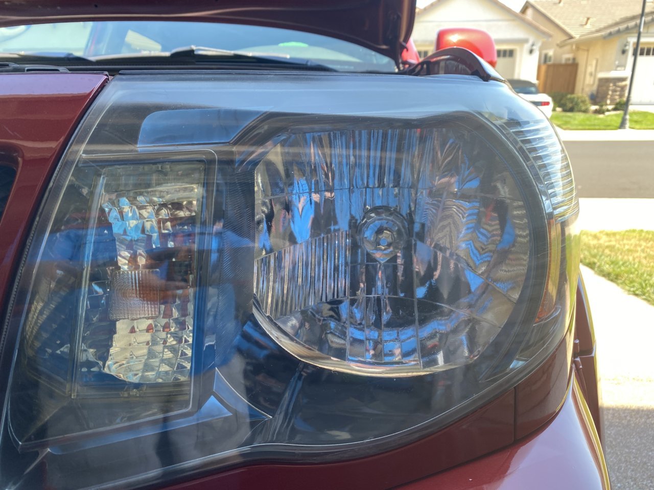

    There’s a number of kits out there that work great. I personally used Meguiars heavy duty kit. Made my super oxidized headlights crystal clear again like new. But the next step after getting the lights clear again is the most important. If you don’t apply a UV protectant then the lights will become cloudy again within a couple months. I spray on Meguiars headlight coating UV protectant twice a year. I did my headlights over 3 years ago and they still look like new and the truck is outside not garaged. Here’s a pic taken a few months ago 3+ years after I restored them. The whole thing is easy peasy and you save $$$ over buying new headlights.
    EF515DAE-4E53-4D48-A400-751B10AC9EA4.jpg 3395BFDB-53A3-4A13-80E3-D8D850730B01.jpg

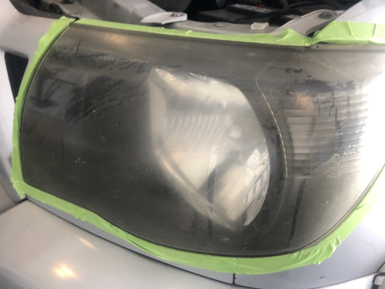

  20. Apr 5, 2022 at 7:38 AM
    #40
    novataco
    novataco [OP] Well-Known Member
    Jul 15, 2008
    #7953
    502
    NOLA
    06 Sport V6 auto
    Aries bull bar, Lund grill screen, blackened h/l, Weathertech plastic all over, Access LE tonneau, window tint, tube steps, DF-Toy aux adapter, cig plug always on, console vault, hitch step, 1700 watt in-cab inverter and dual battery (in-progress), Delta bike hitch mounts

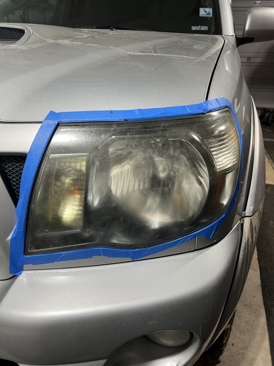

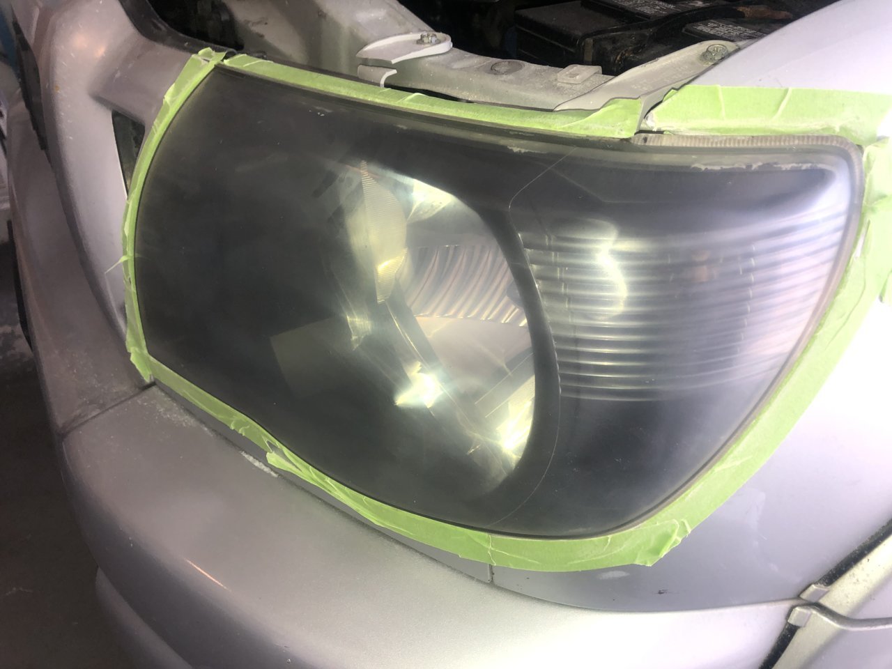

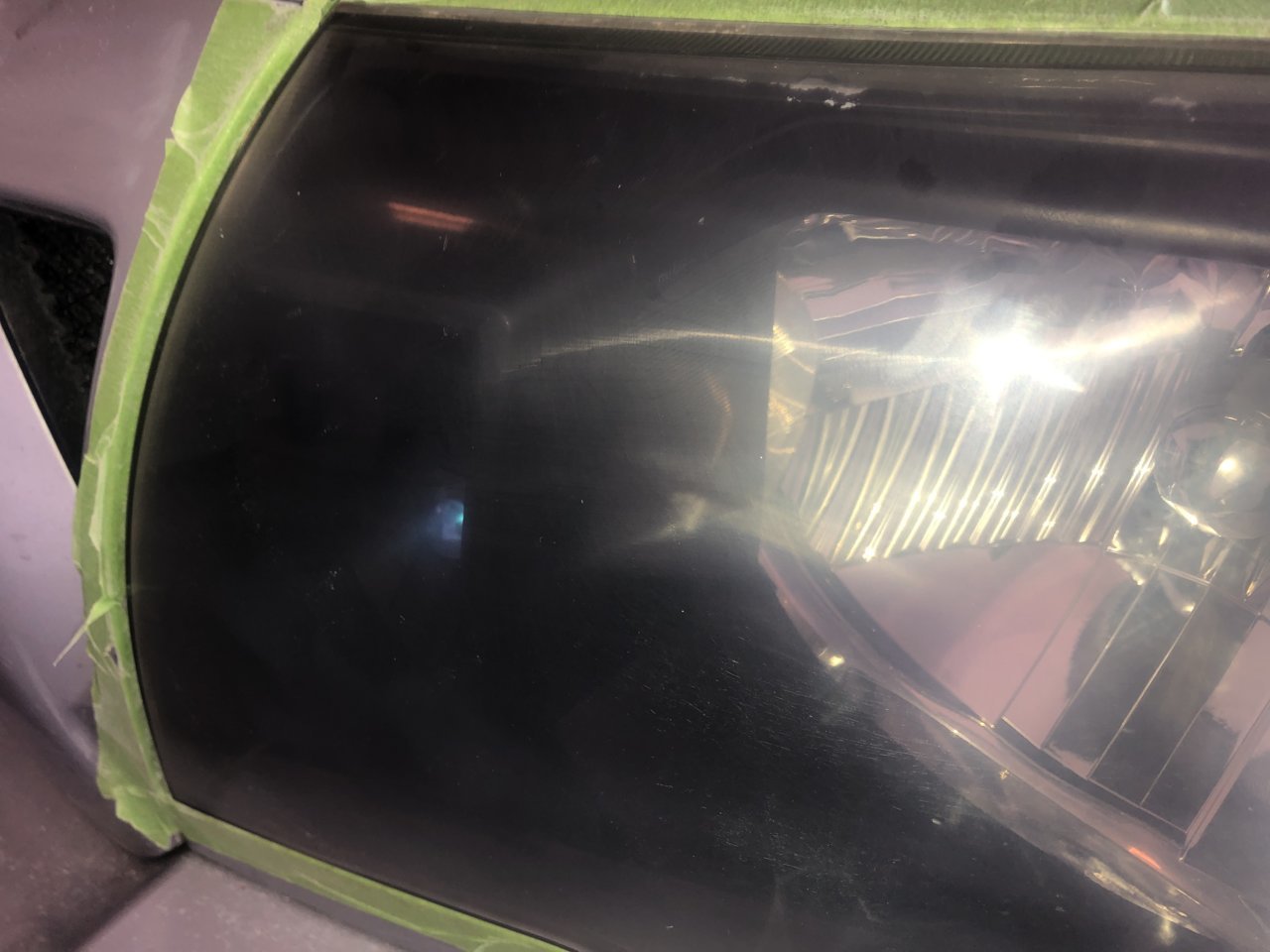

    C5F6F627-2DC7-445E-A4F9-95B7E5AACD30.jpg 7879BC7E-3186-4AD4-BD03-E3781E7B75DF.jpg A64BB716-D0BD-436D-A1CC-8D01C006B199.jpg I used the 3M kit yesterday. It did a pretty good job but I see there is a hazy film inside the headlight assemblies, from when I did the black headlight mod back in 2006. Some weekend soon I will open them up again and clean the inside. If that doesn't go well, I will just order new ones.
