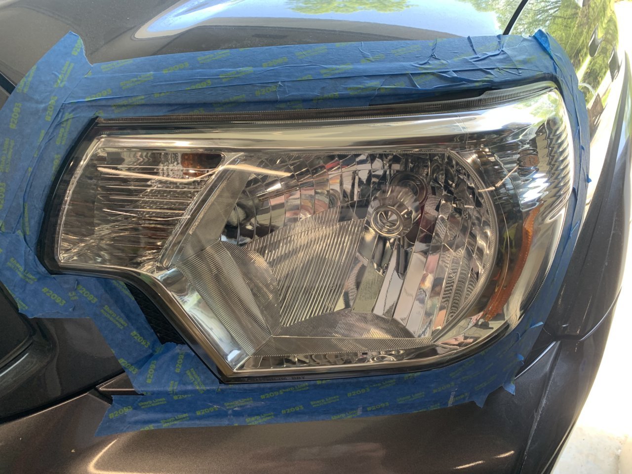

    We’ll see how long it lasts

    I just bought this kit. We’ll see how it turns out. Your headlights look good.

    Thanks, but I’m curious how long it will last…
