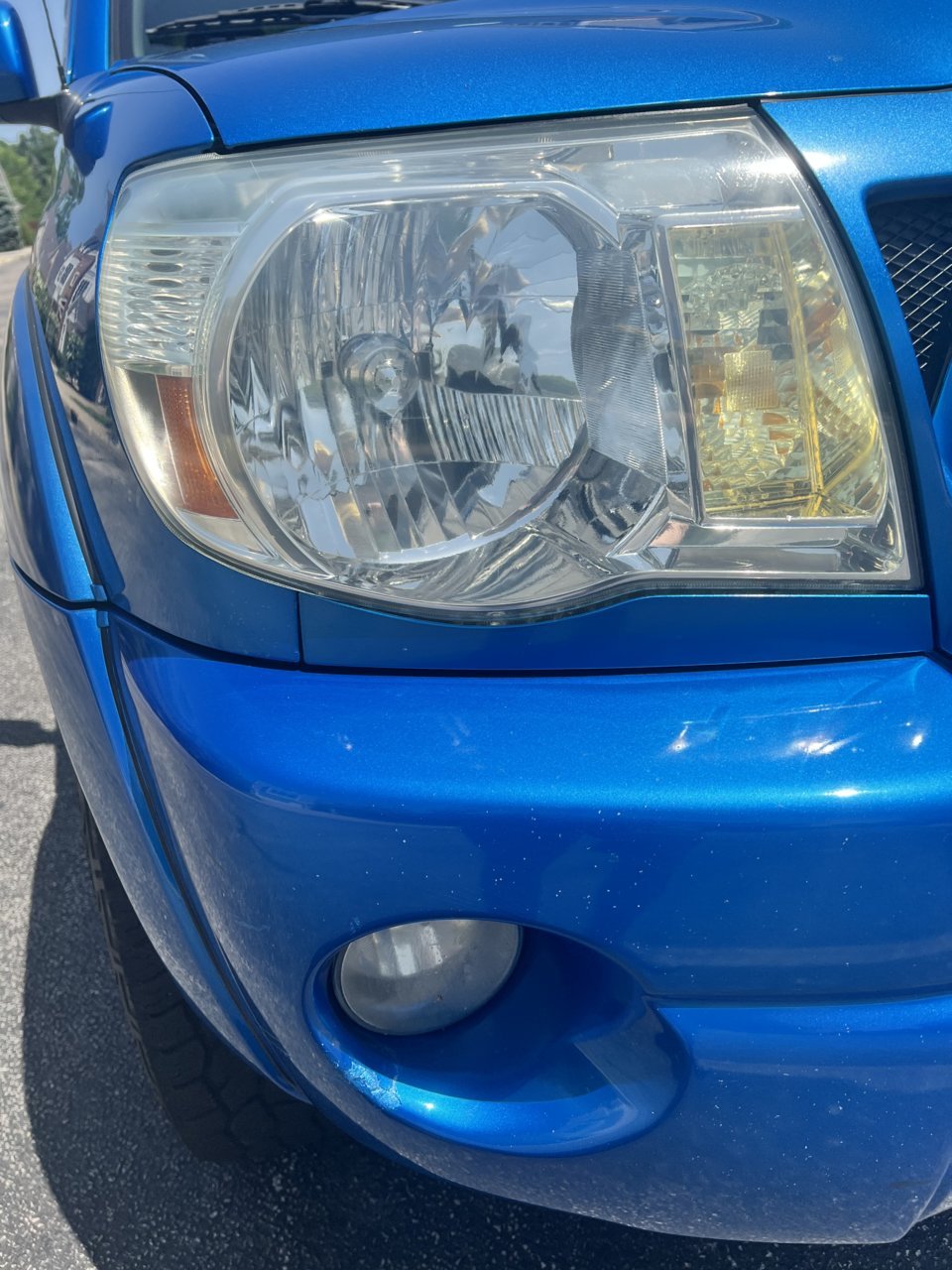

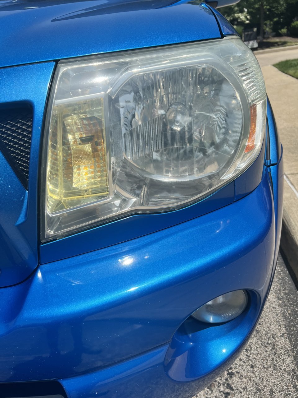

    I used Cerakote and the result was amazing. Mine were not terrible, and these pics do not do justice to the end result, but I ws delighted! I was close to buying new eyeballs for my glaucoma riddled Taco. Happy I saw the post for Cerakote. Best $17.00 ever spent!

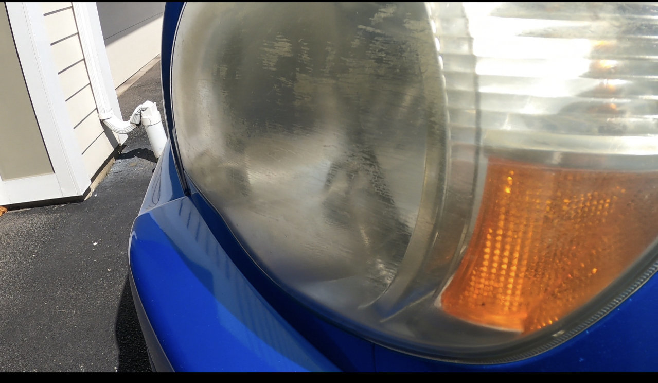

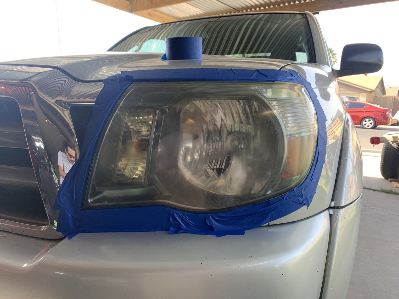

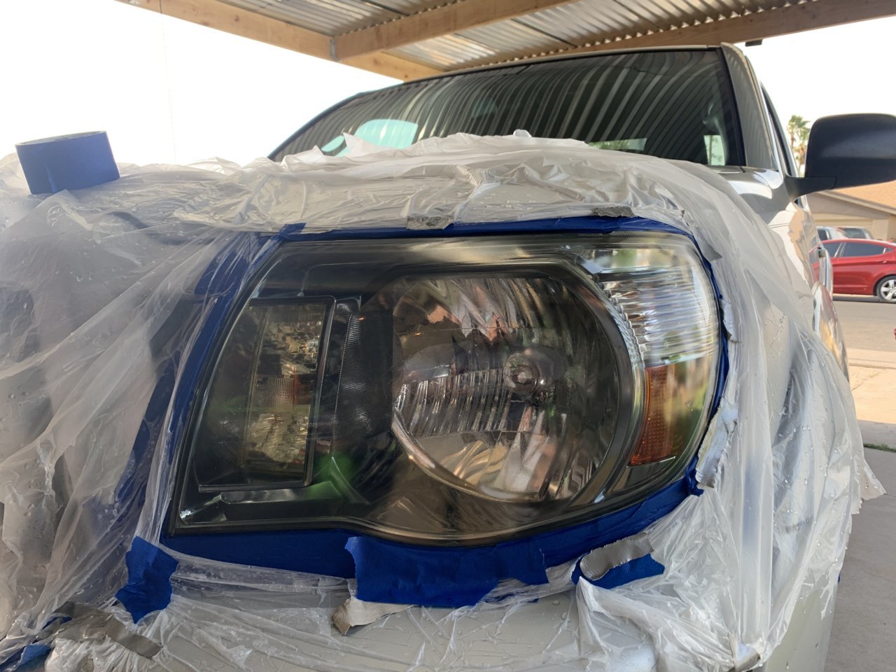

    I watched this video and followed the steps.
    https://m.youtube.com/watch?v=UEJbKLZ7RmM
    Steps I used:
    1.
    Tape off around headlights
    2. Wet sand using 400, 800, 1000, and 2000
    3. I polished headlights using Sonax perfect finish and a dual action polisher.
    4. Isopropyl alcohol wipe down
    5. I placed garbage bags around headlights to protect other surfaces
    6. Sprayed 2 coats of USC SprayMax 2K Glamour High Gloss on each headlight
    7. I allowed clear coat to dry for 24 hours. I then put on a coat of wax.
    Before:
    6B95E089-6F23-4C3C-BE9D-5AFD584B7A70.jpg E6E65260-2A1D-445E-AA7B-999C7EA0ACAF.jpg 20AF8585-4D14-4655-84E6-9E5BADBC7141.jpg
