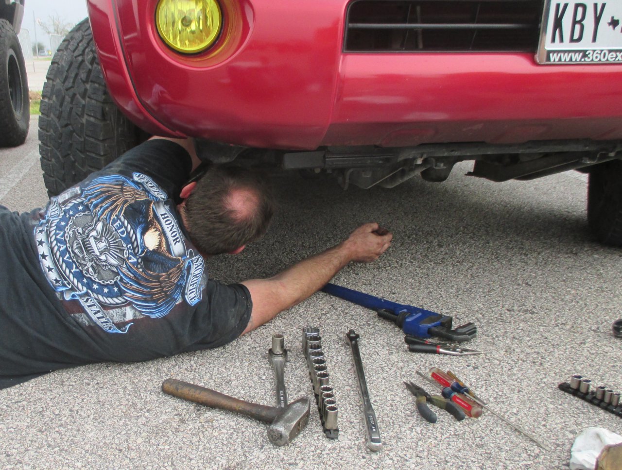

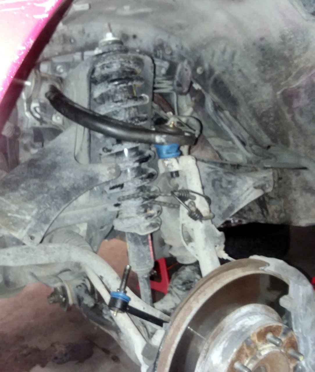

    Onward to photo fun, and Triple C Chop Shop action! This will be two parts, sort of, because I got the wrong outer Tie Rod Ends. So, we did part at the shop, and finished it a CIRCUIT OF THE AMERICAS! Not everyone going to be able to say that! Tough to get great pix, and the phone did bad on some. Off we go!
    Good things come in boxes, and like to be posed like Umagumma albums!

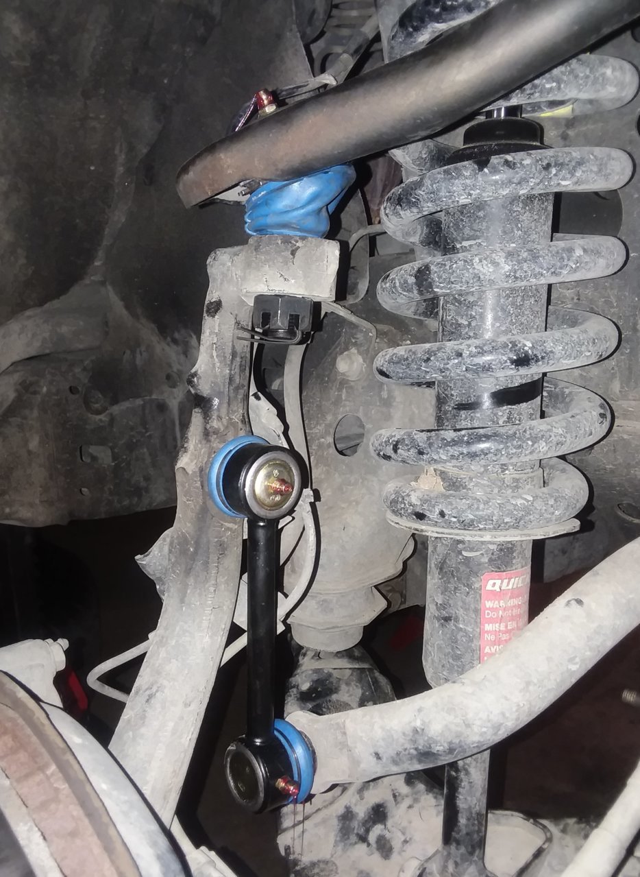

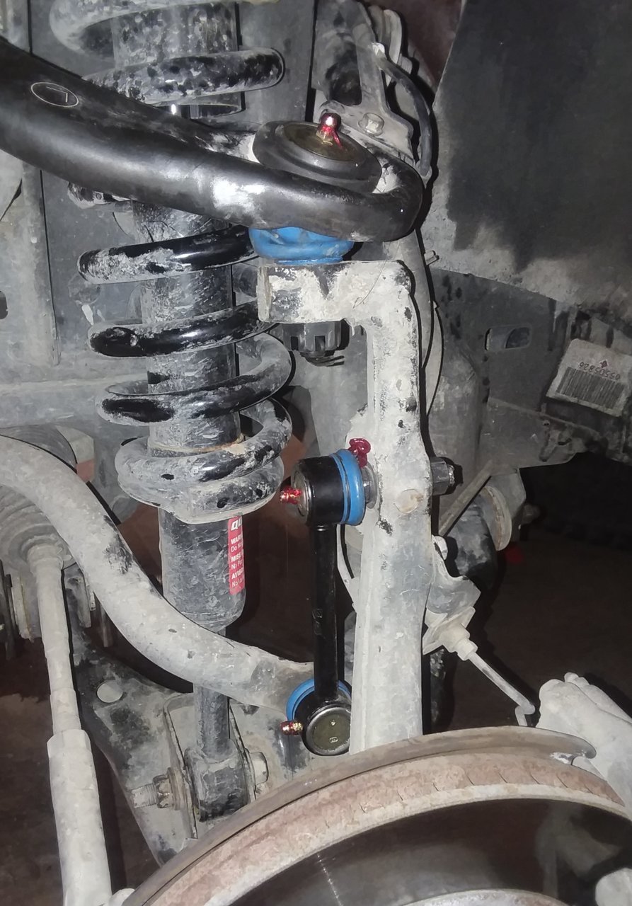

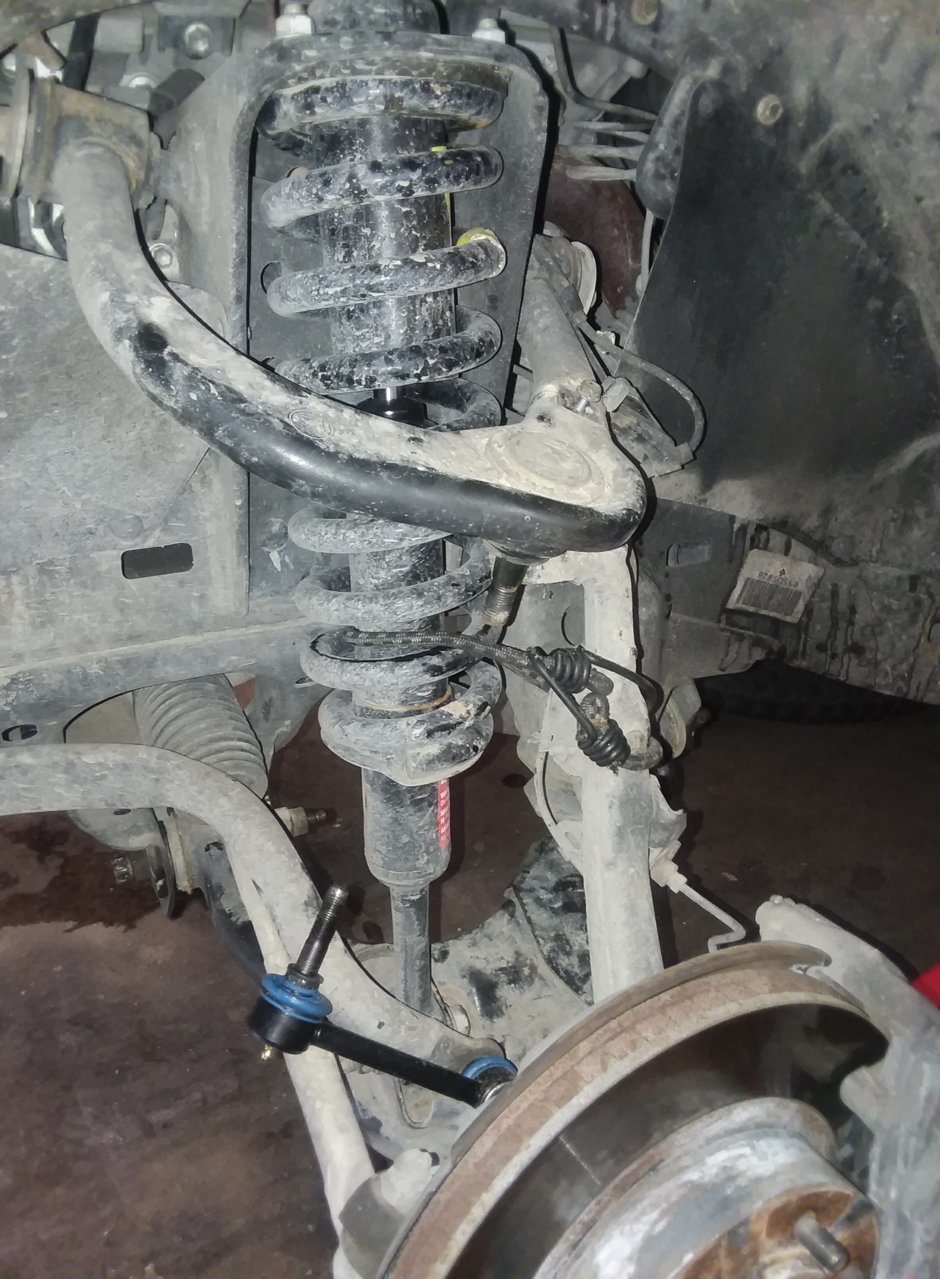

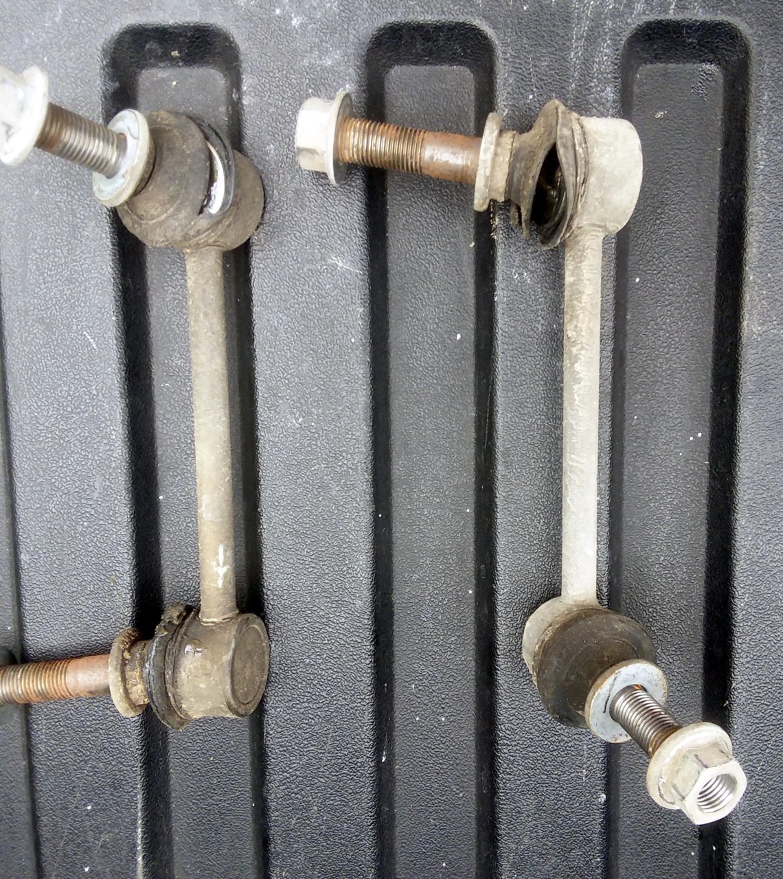

    First off were the Stabilizer Bars
    20190302_143127.jpg The new ones all have BLUE insulators by the way. And grease fittings.
    Yeah, they look the part... :rofl::rofl::rofl: get it? Oh stop, I'm killing me here!

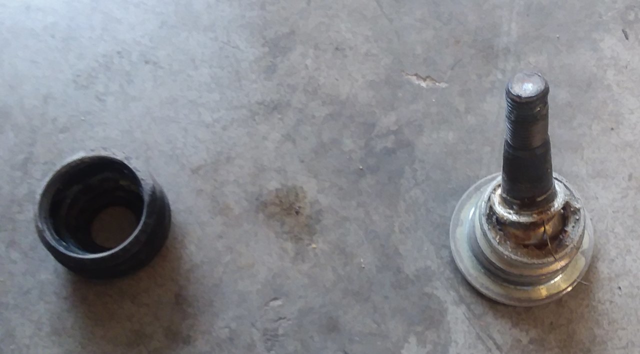

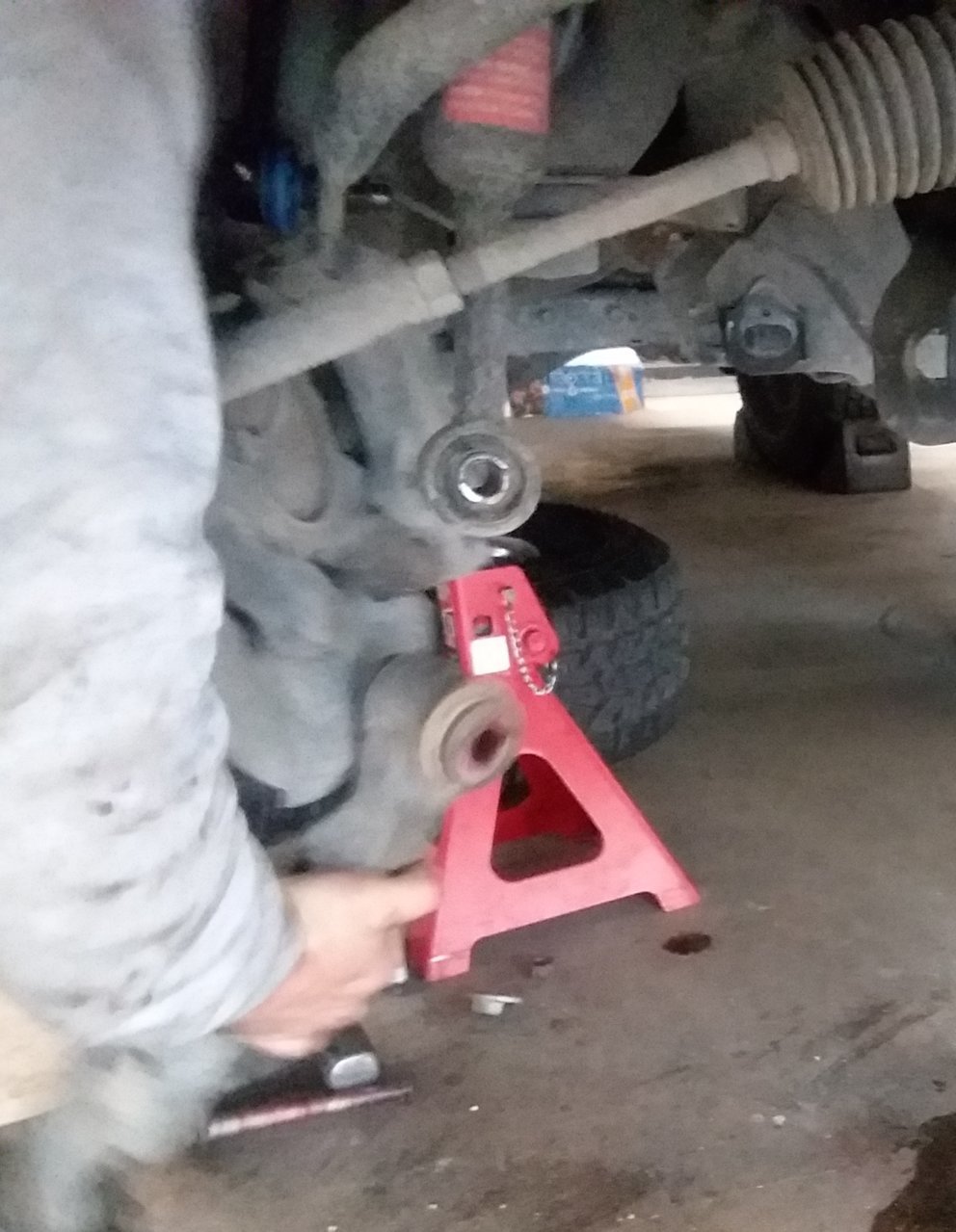

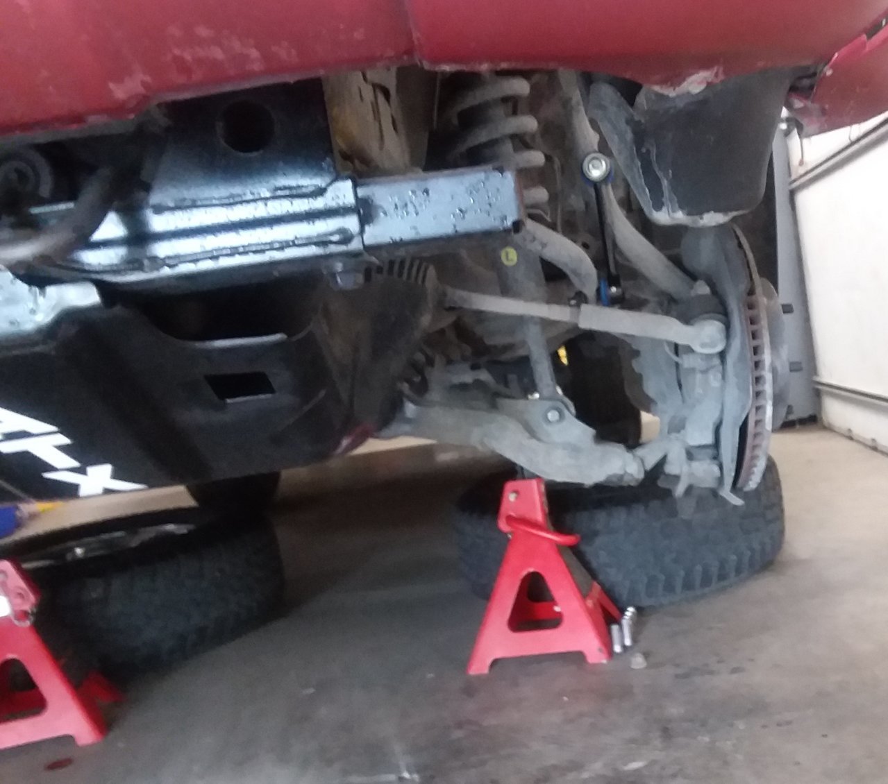

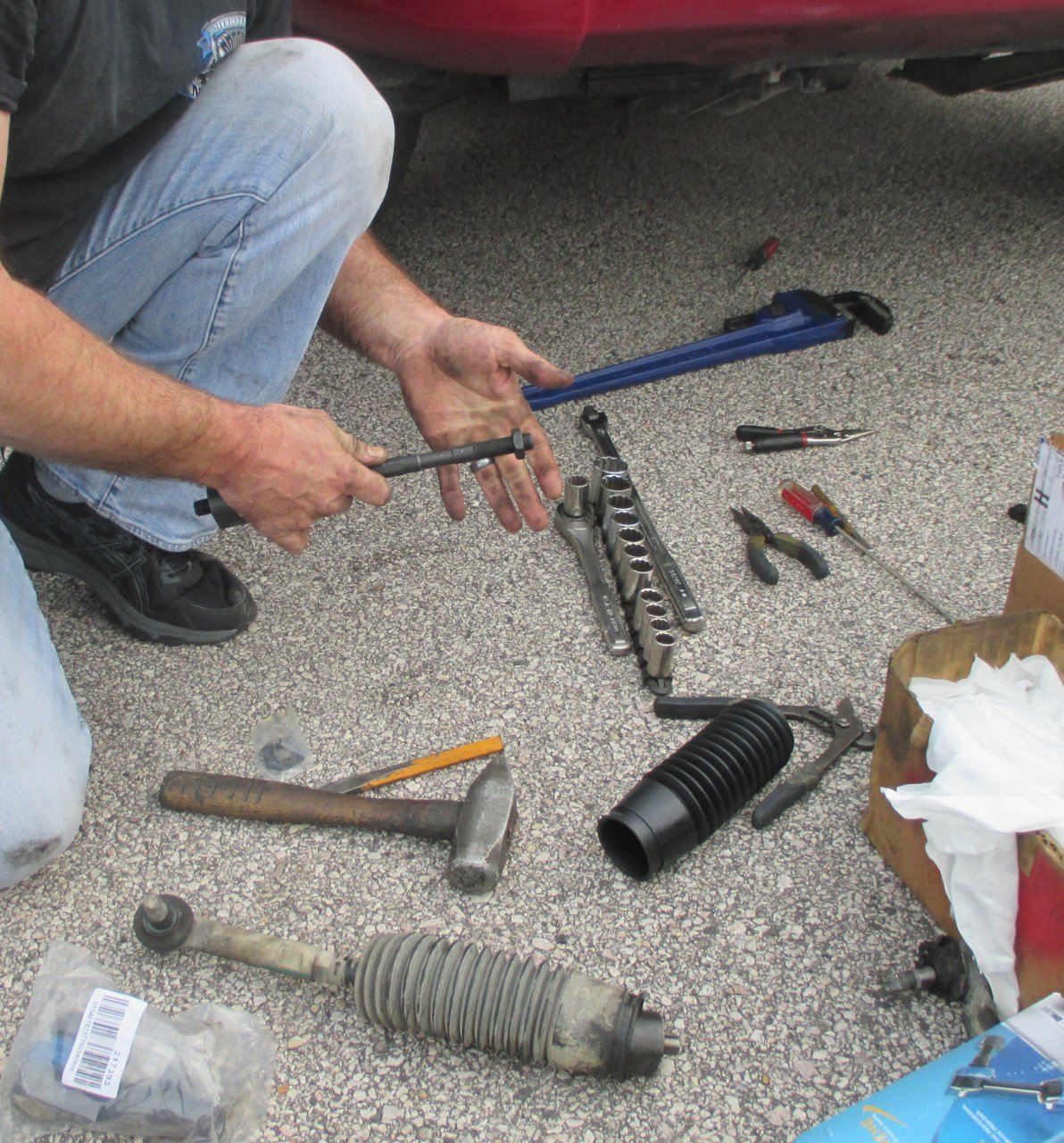

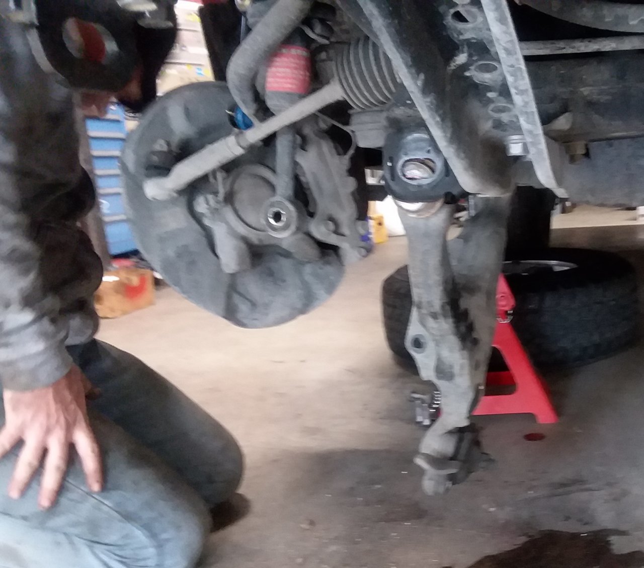

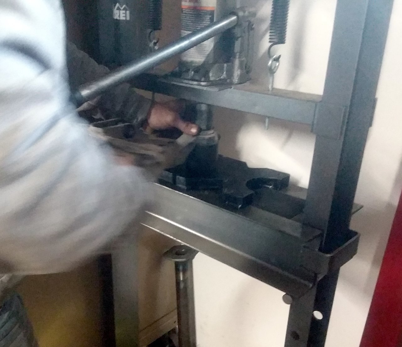

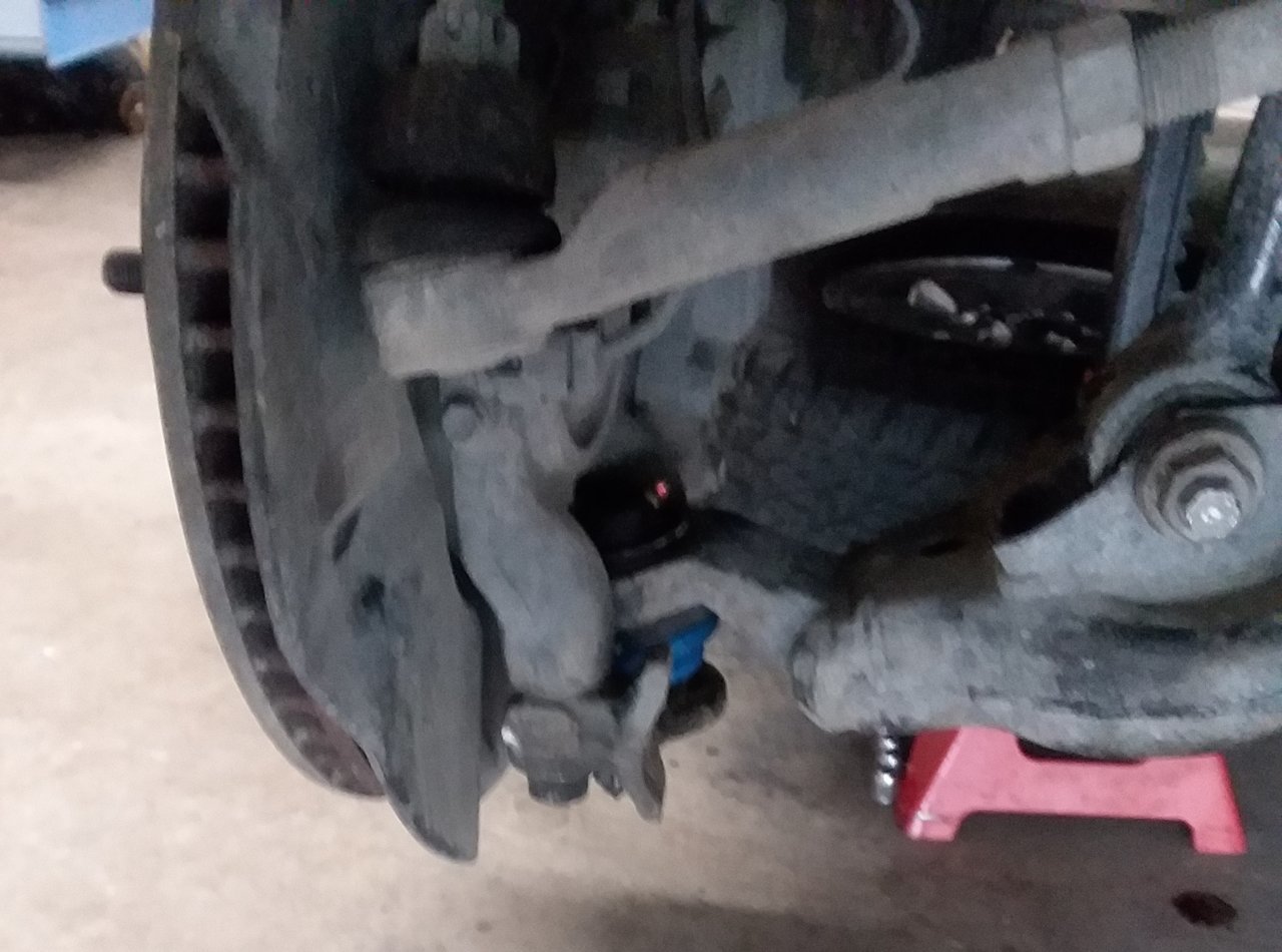

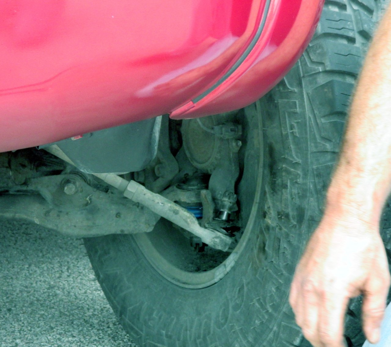

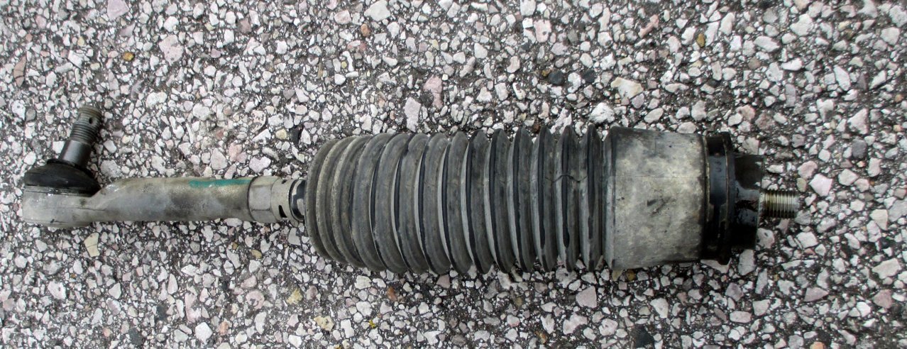

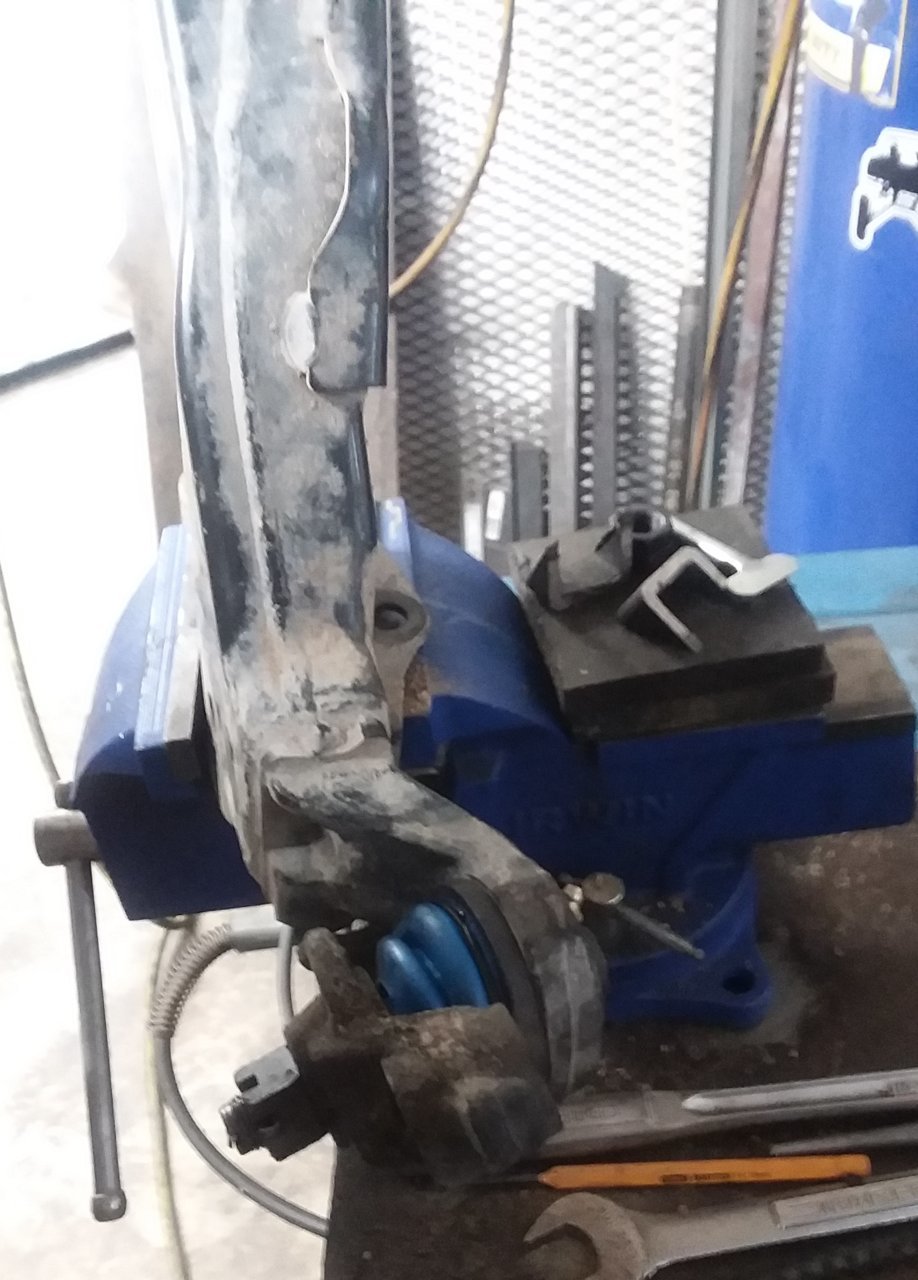

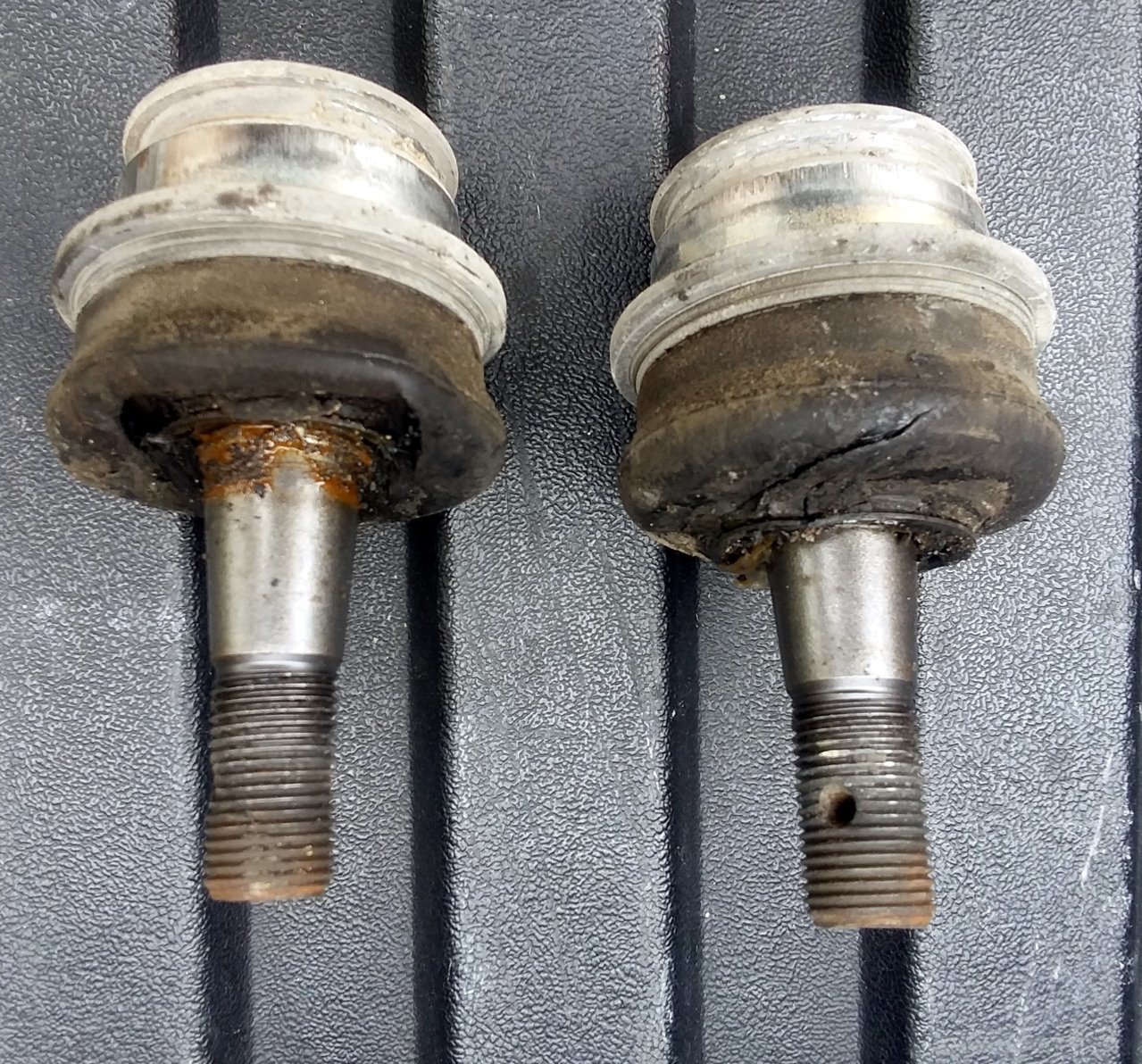

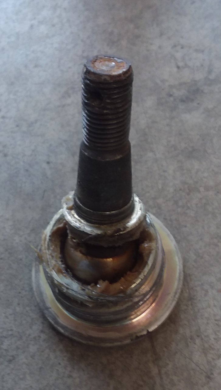

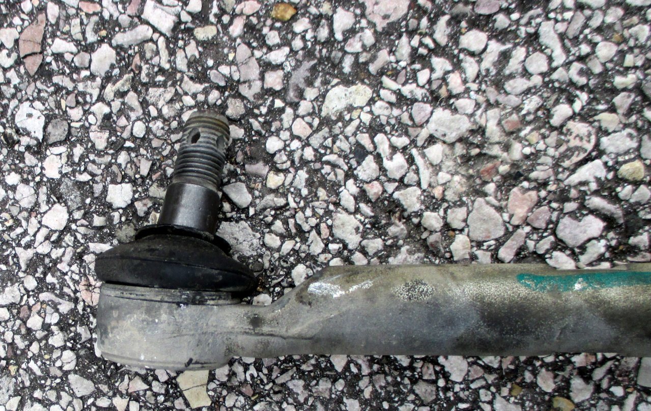

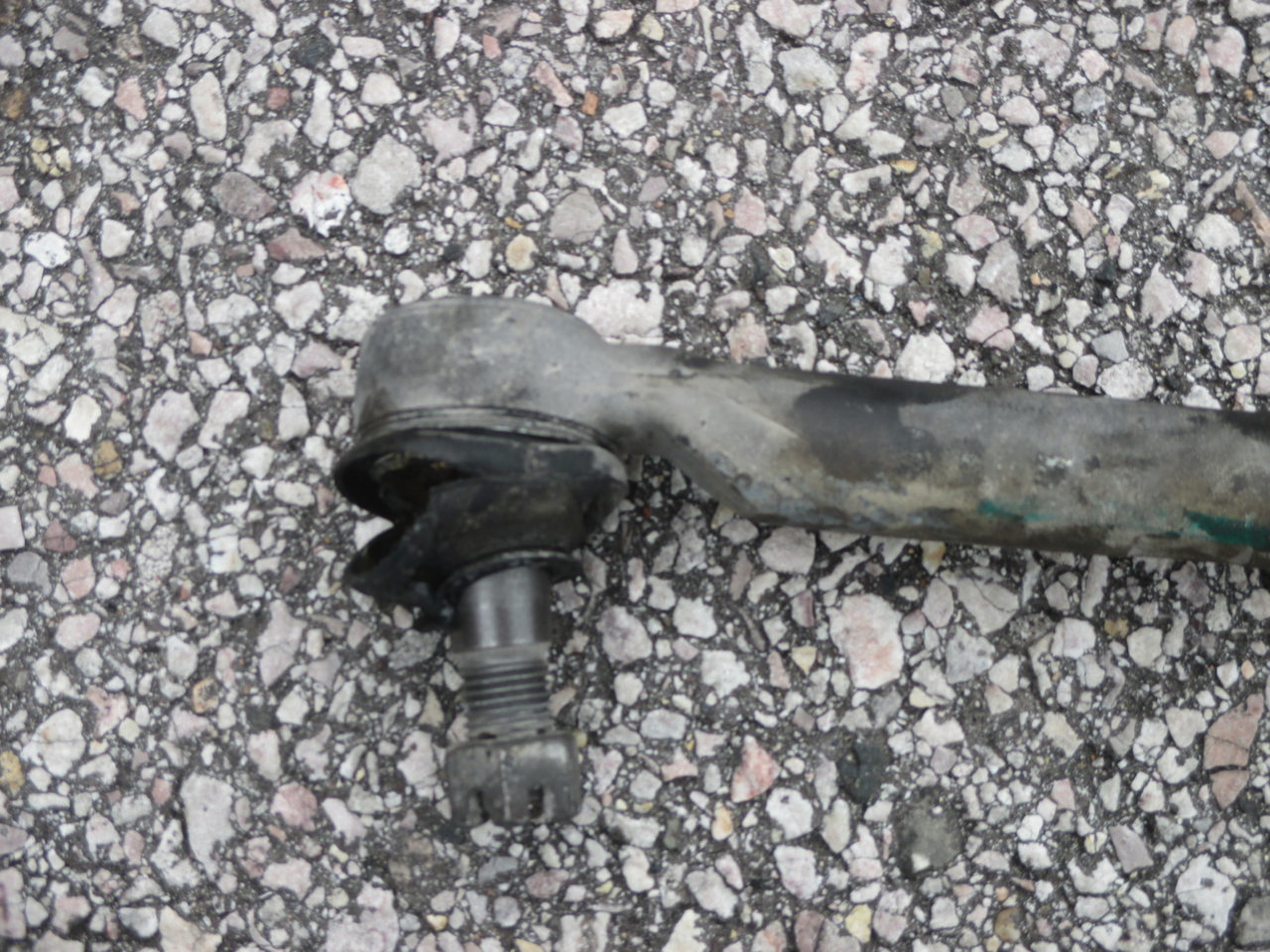

    Next was the exciting Lower Ball Joints, and I got to help with the press. Needless to say, you can't do this yourself without a big ass press. Skid plate off time for the rest!
    That's right, old guy got to pump it up!

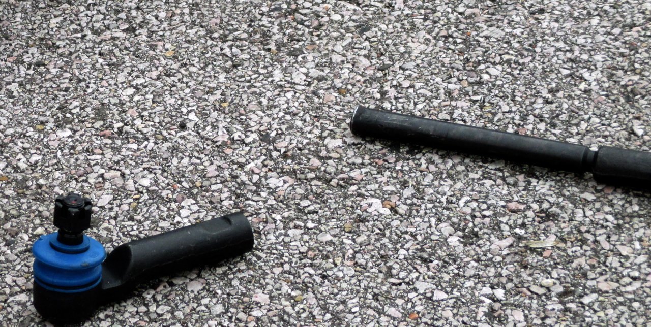

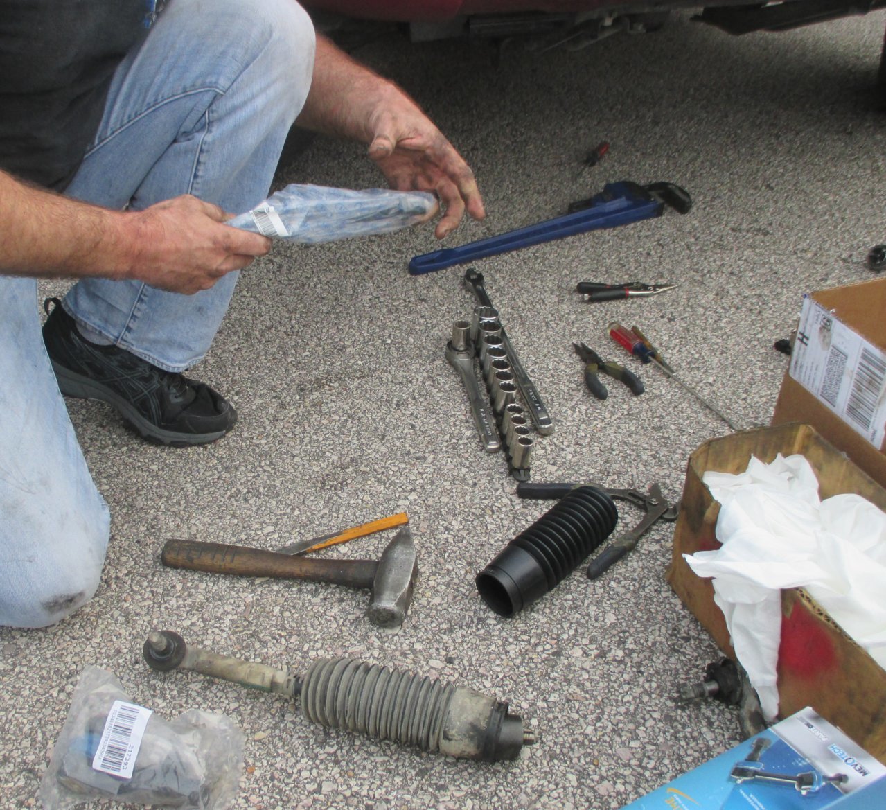

    OK, here are the old ones. Pretty beat, even if they were not the noises!

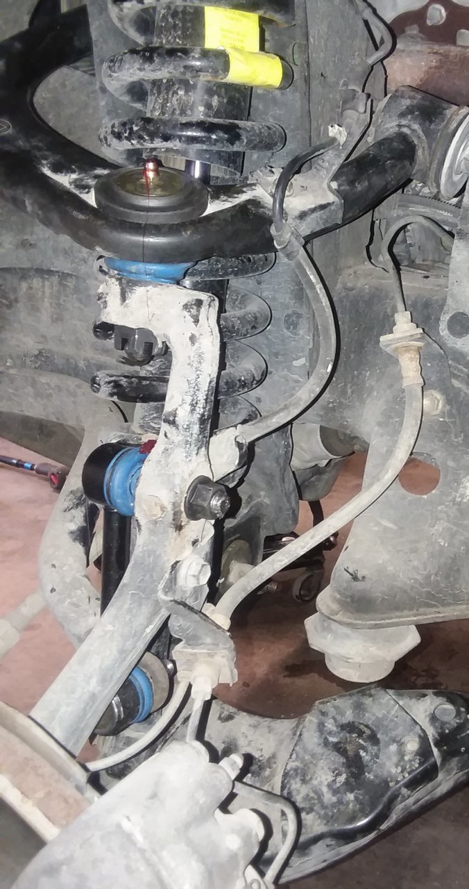

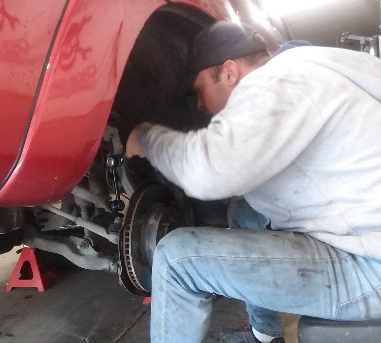

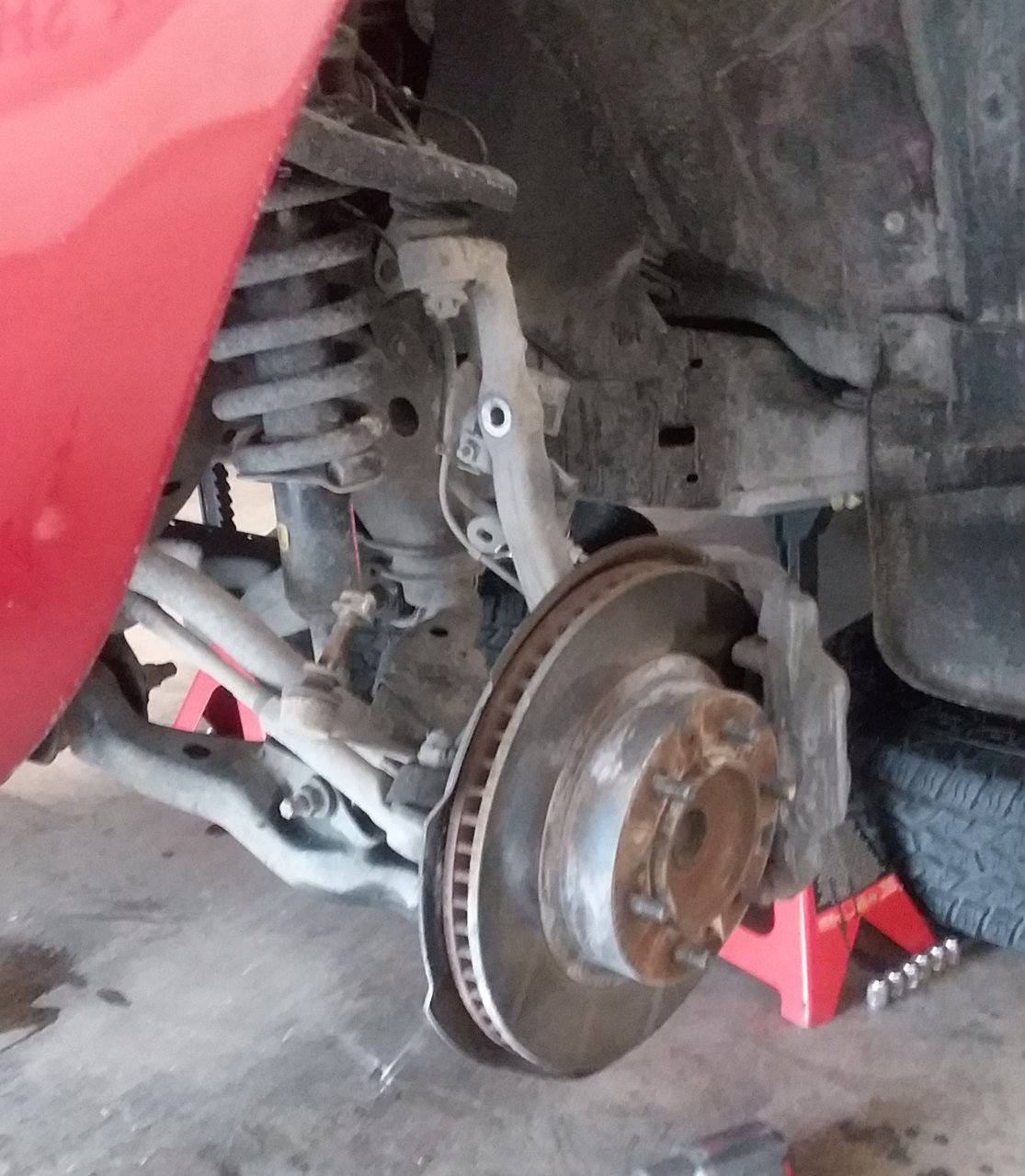

    On to the tops. Now, this was EDUCATIONAL because @Texoma has always REMOVED UCA complete, and not replace the top Ball Joints, because most customers are replacing the UCA. So, he fought it for a while, and then said "I can take the UCA out in the time we wasted", so he did, and back to the press, and much better progress. Chalk one up to new experience.
    Stuff back together!
    Off we go to Circuit of the Americas! I mean really. I can say my truck was fixed up at COTA! Really? Freaking AWESOME. On with the Tie Rods. Sorry, I'm not able to get low enough, so best I can do! Thanks so much, @Texoma !

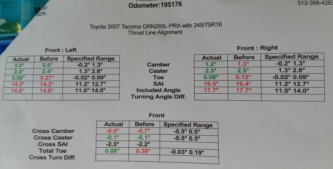

    IMG_1236.jpg "Alignment" of the new parts. And I will have you know, FREAKING DEAD ON all the way home!
    old driver
    New stuff!
    OK, once again, a thing gets done (actually a few things), and nothing looks different - EXCEPT to me! So happy to look at a fixed up truck when I go out in the morning, or whenever, so thrilled to take it to the meet ups, even though it's "just a cared for" truck. I like it, I love it, I want some more of it!
    Edit - add the alignment specs from the following day:
    And, as always, "But Wait! There's More!"

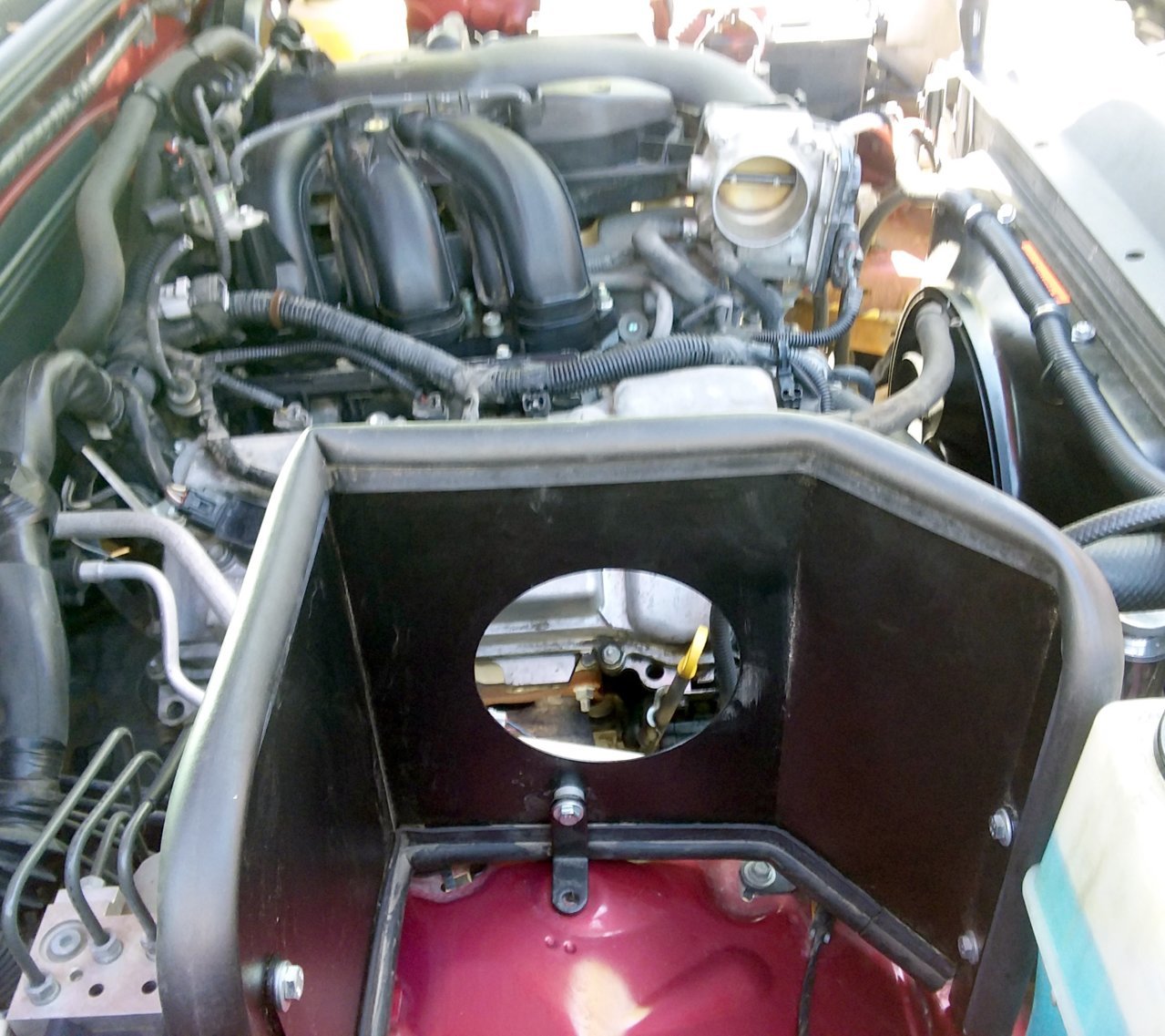

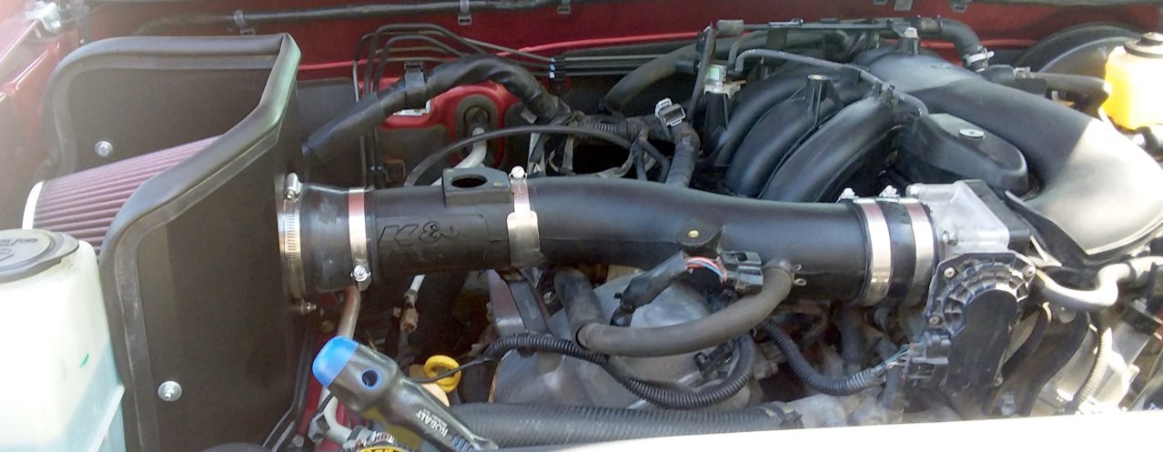

    Under the Hood Again.. - Phase Fourteen; A little R&R, and little Mod! Road to 200K
    So, as we approach that 200K milestone, time for some updates to the basic mechanicals, and to engine breathing! Full tank on the change, so, I can certainly track as well as not. What is going on? Replace the serpentine belt, because Toyota always checks it on the list, and I can't verify it's been done in 193K or 10 years. And it's supposed to be a half hour DIY. Up for that.
    Second, to replace the stock air system with a custom K&N system, courtesy of a great deal from my SATX friend, @BuzzMor ! Gently used, but he had dustier travels than I, so I am going for it! Sounds like fun for the hottest, windiest April day in Austin area history, NO?

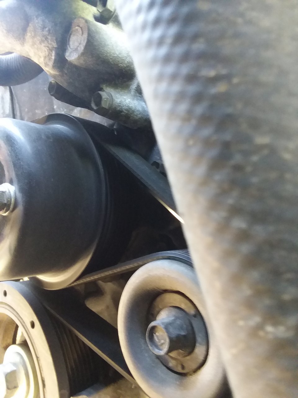

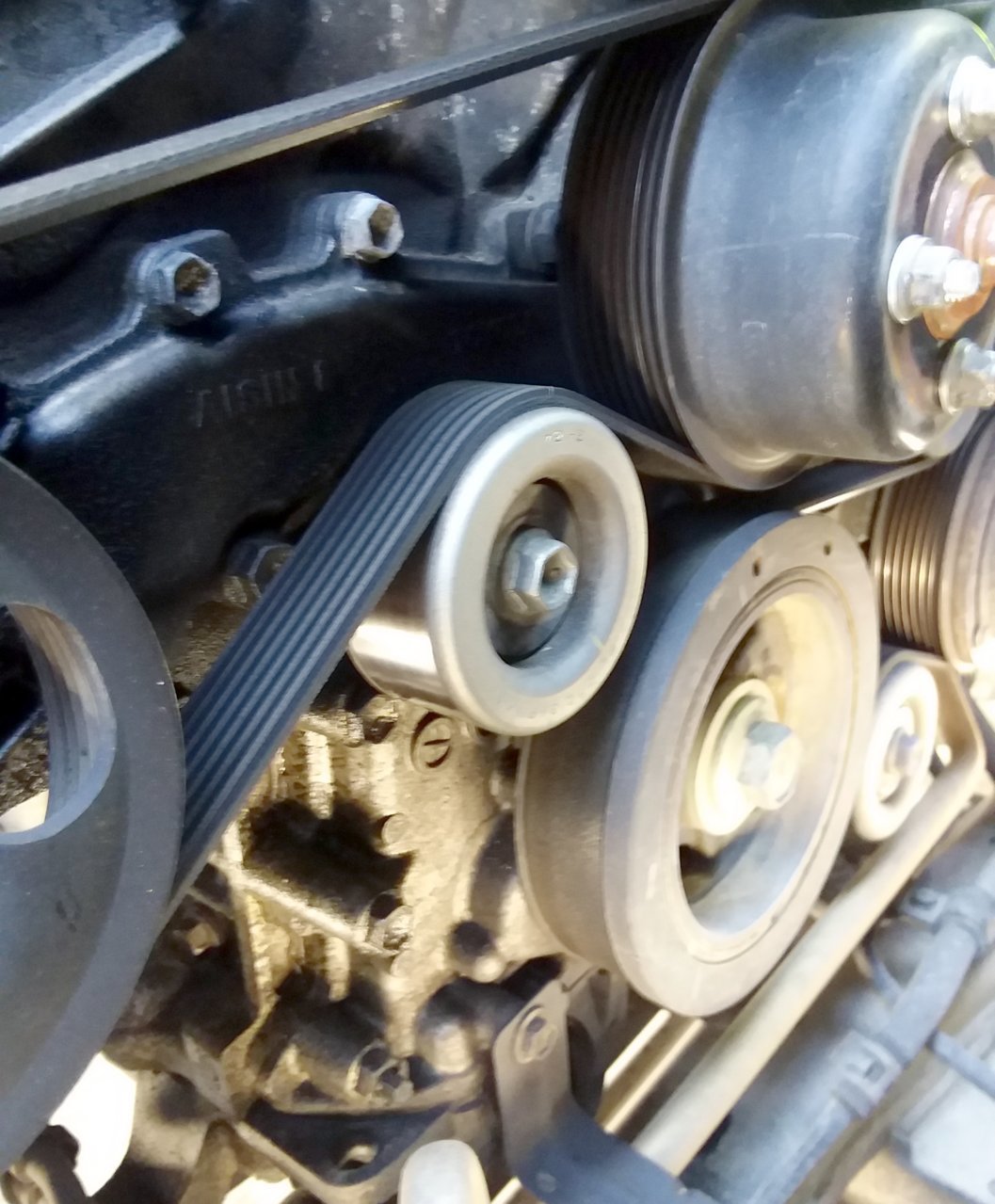

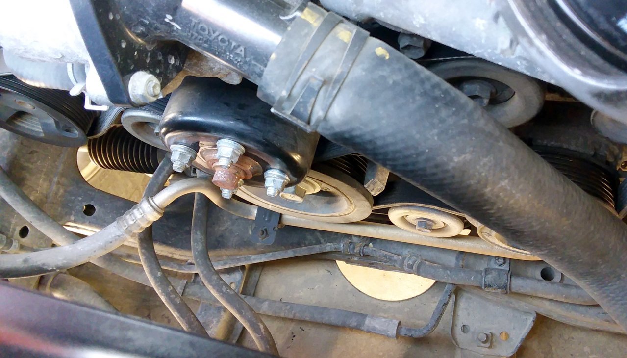

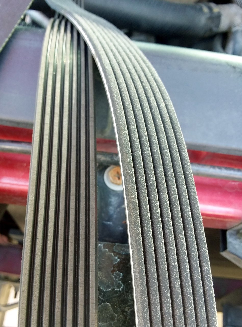

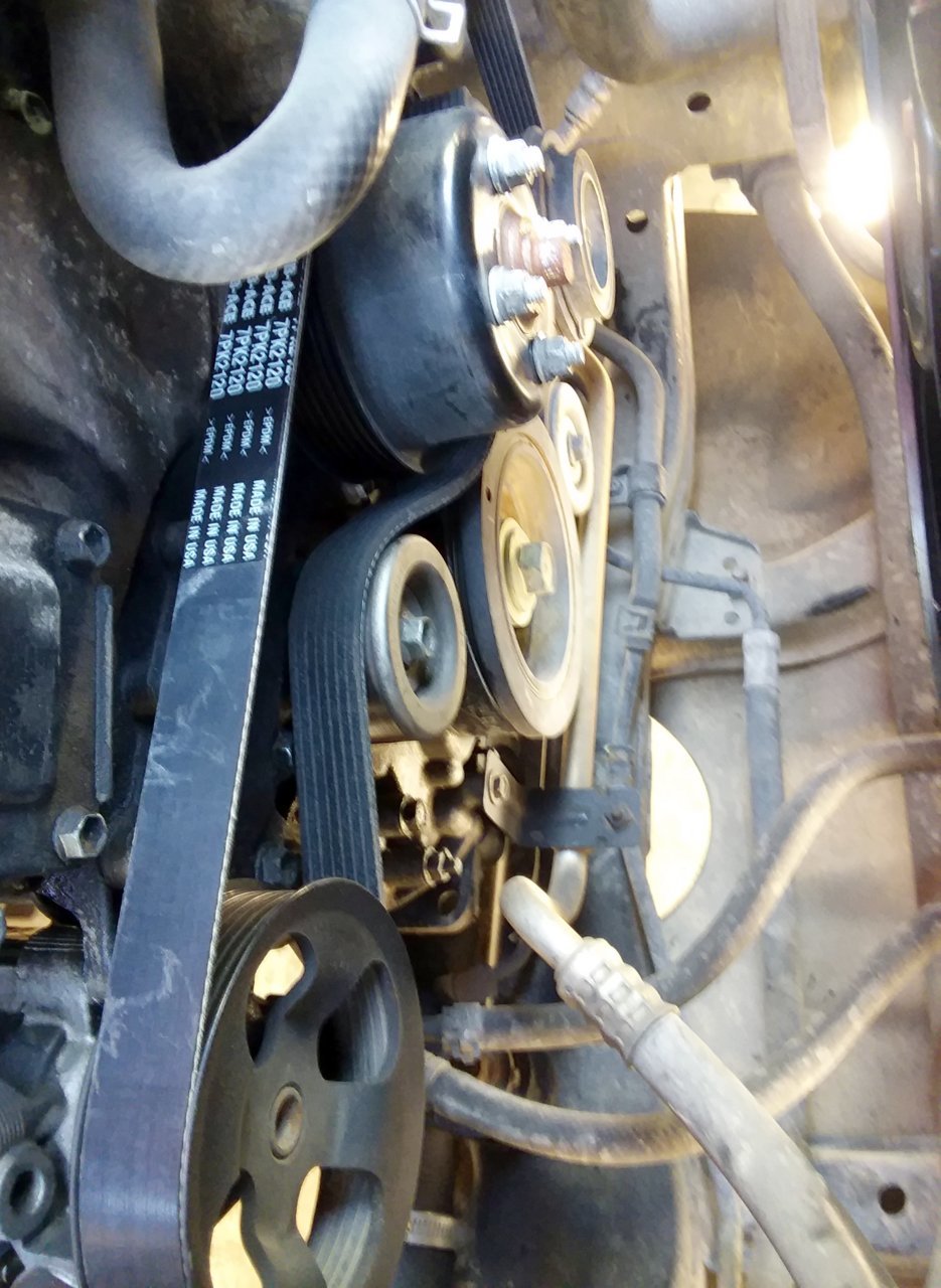

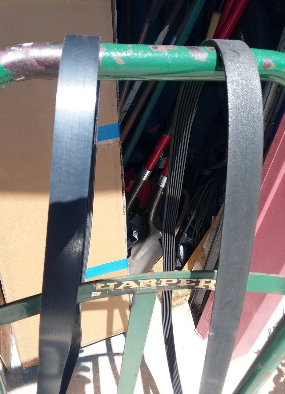

    Let's start with the belt. First slowdown was that I had to go buy some socket adapters - swear I used to have some - but my little 3/8 breaker bar was no match for the tension pulley, so I had to get something to use my 1/2 inch! Not a problem after that. I got to use my fab little Horrible Freight stand for most of this work, so thank you whoever recommended it! And it's kind of hard to get good shots down there, much less when doing the work. Off we go!
    Here is the old stuff, much more convenient having the clutch fan out of the way! A few extra inches of room is greatly appreciated! Engine cover off, and on the way.
    Belt before;
    What's the old one look like? Not really horrible - I will save it. I don't know why.
    After
    And it worked. I was not launched into space by a flailing belt! And it stayed on! I am happy.
    Now, off we go to the K&N install. Again, thanks to @BuzzMor for the great deal. I think this is going to be a good mod for me! First, clean the filter, let it dry (jeez, not enough wind for that!), then re-oil it. NP. Here is before and after. When it's oiled, it's "red".

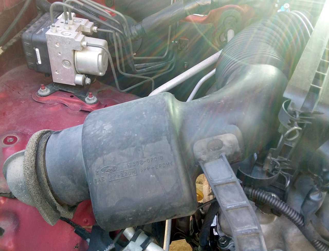

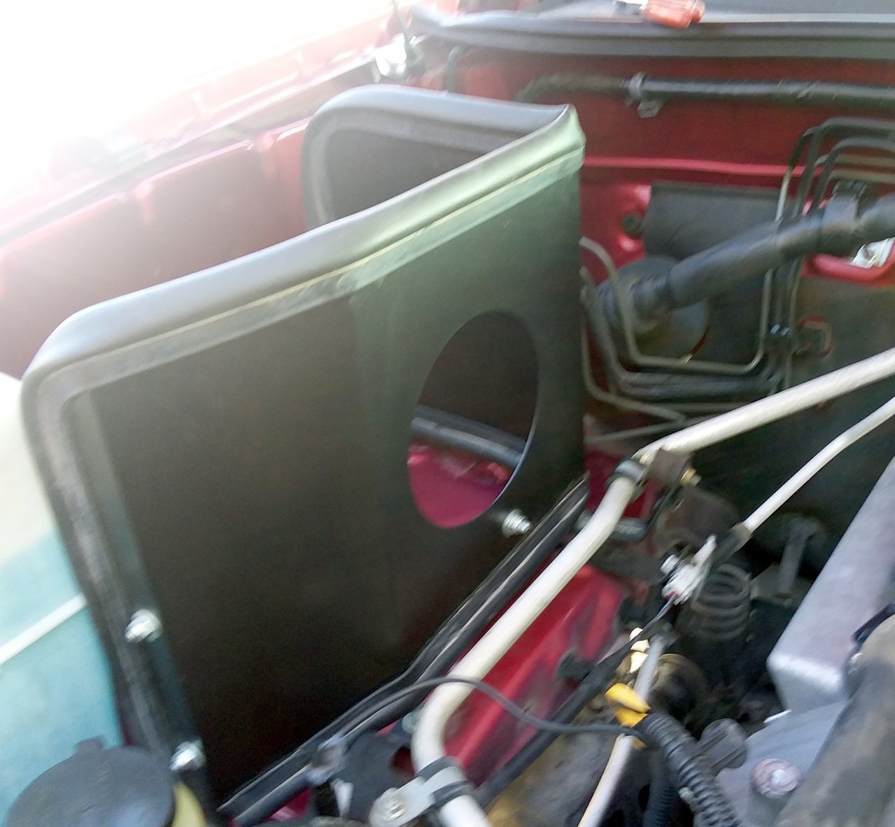

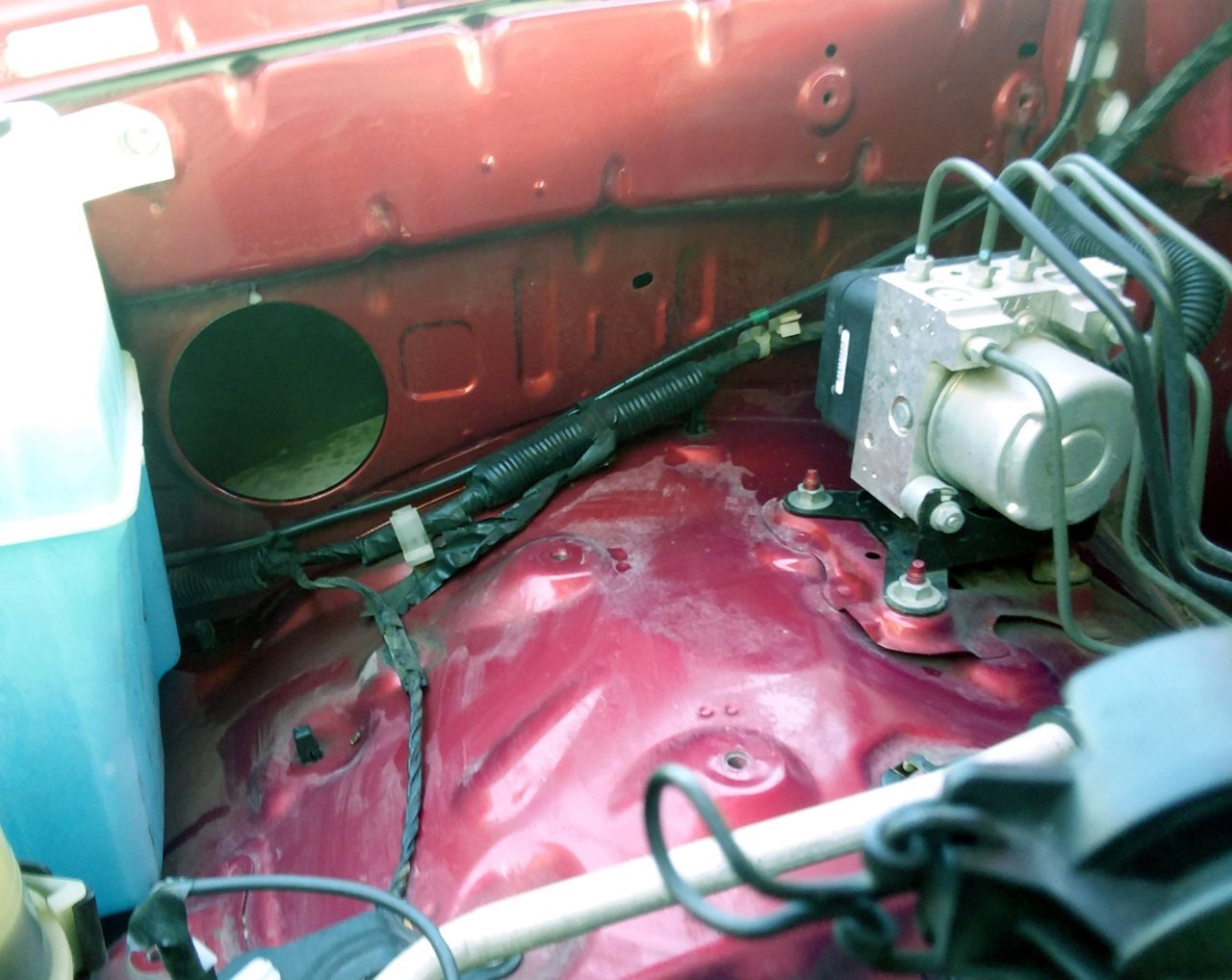

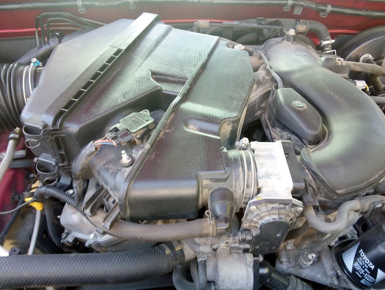

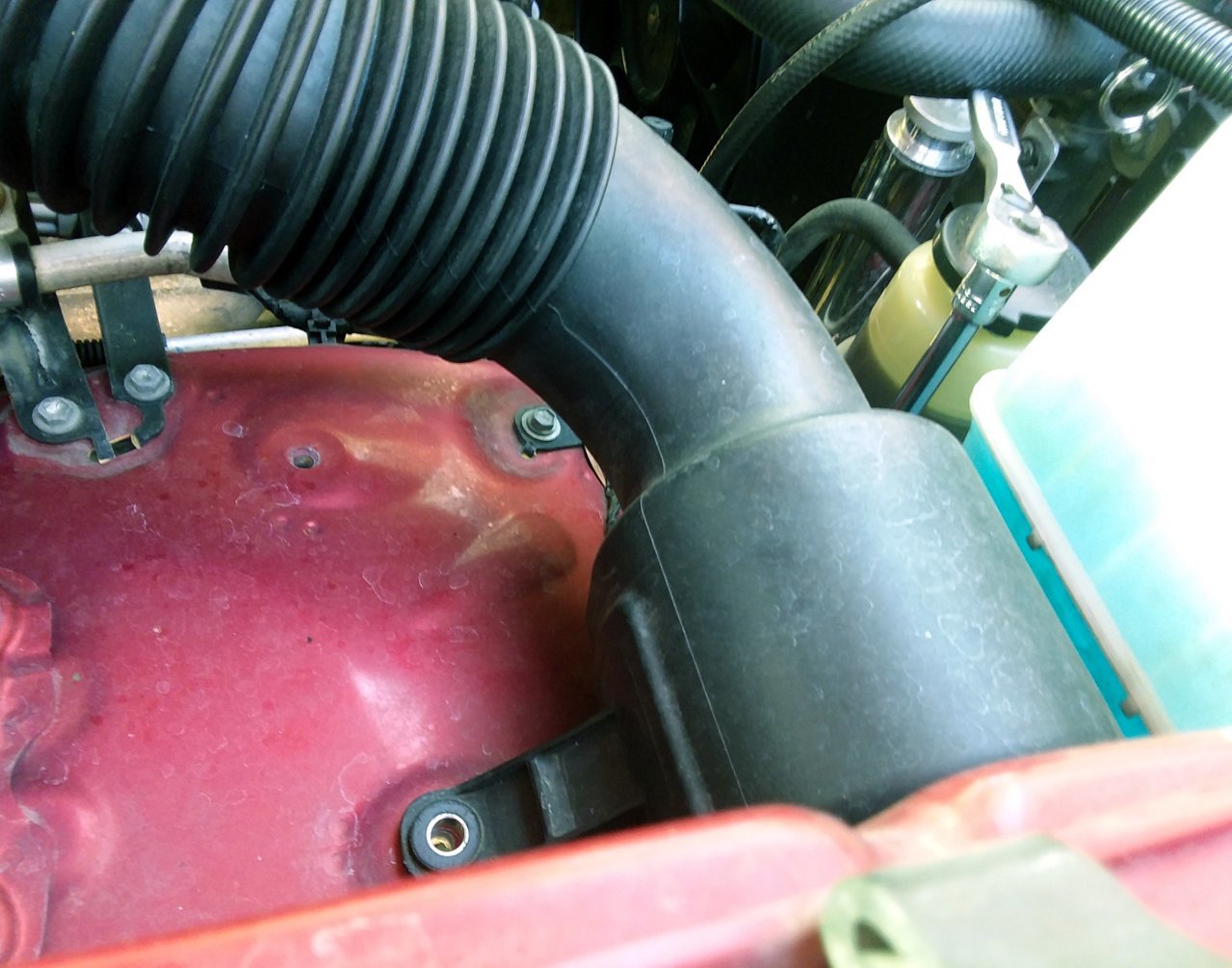

    Let's see what comes next in general? Basically, remove the filter assembly
    and the resonator
    Giving me the hole, and dirty stuff cleaned up a bit

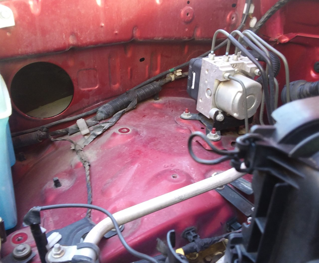

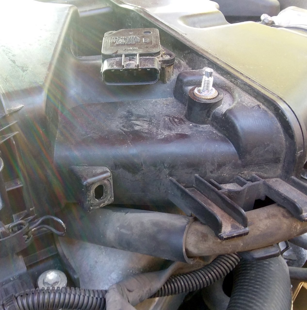

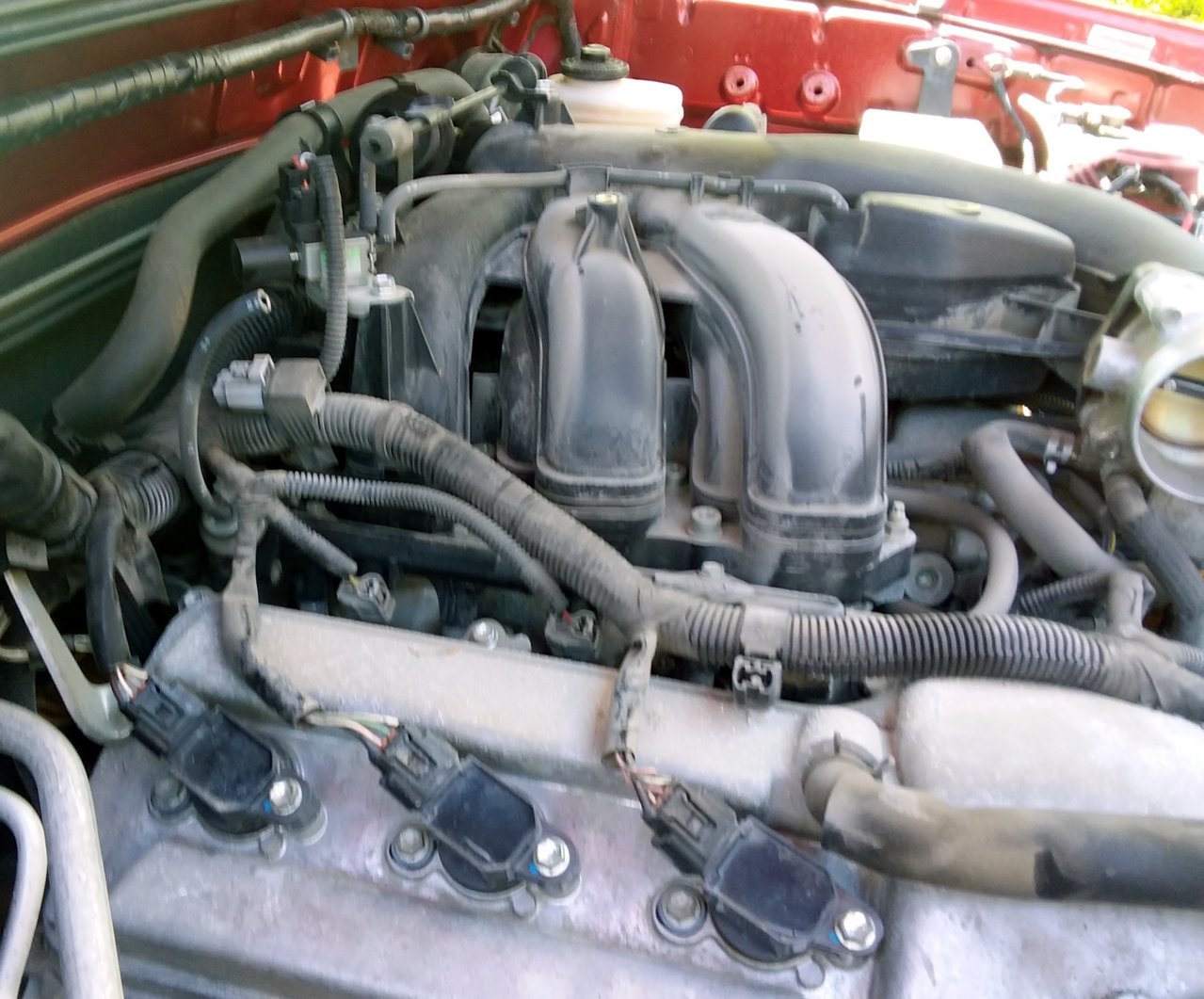

    And more removing of the airbox

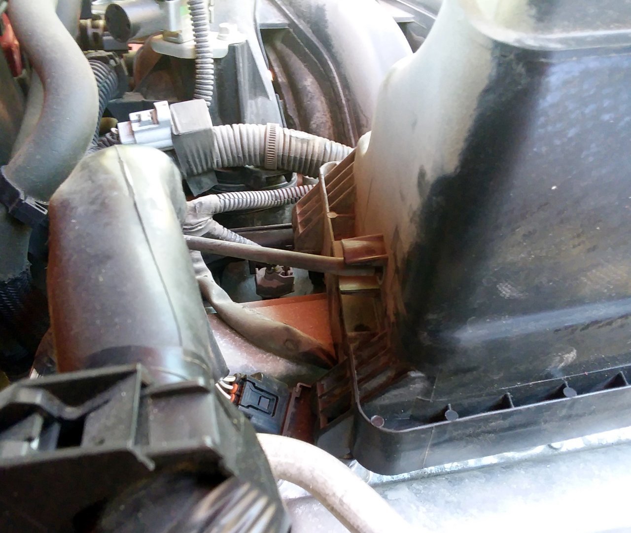

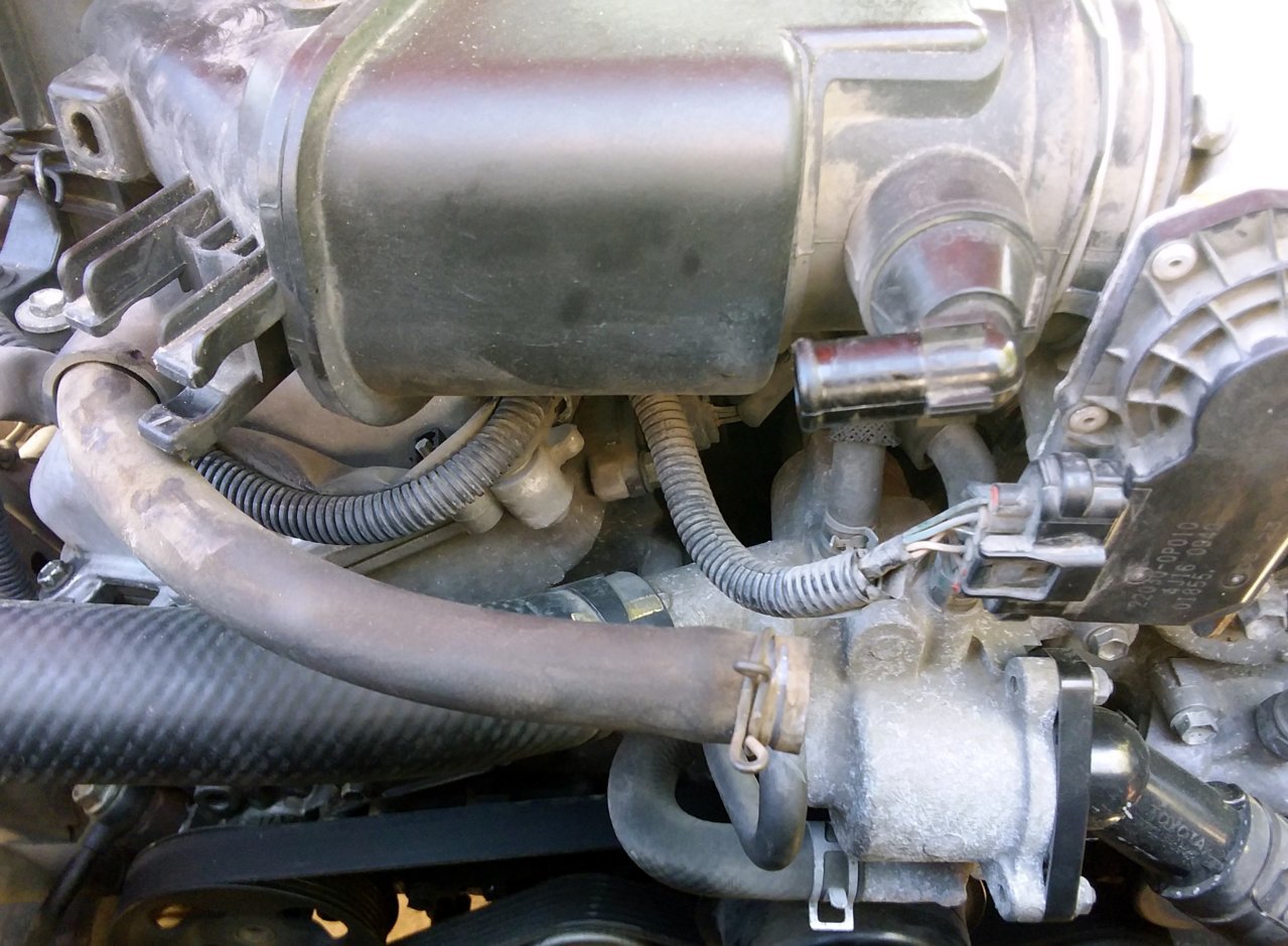

    20190410_143834.jpg The MAF plug

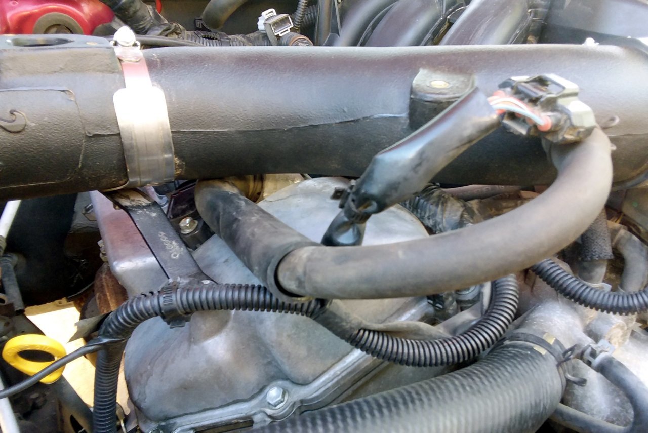

    20190410_144100.jpg The PVC hose - ignore the instructions and don't "turn it around"
    20190410_144726.jpg Just turn the box on it's side, and pull the fuel vapor hose. So damn hard if you don't
    20190410_144815.jpg OK, that's all, so I cleaned it up a lot, thinking I could not put the cover on. WTH. It's cleaner.

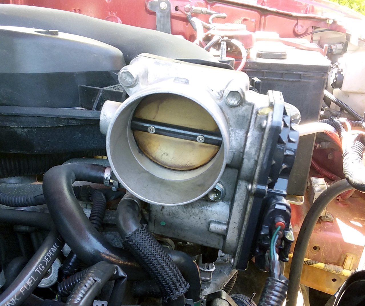

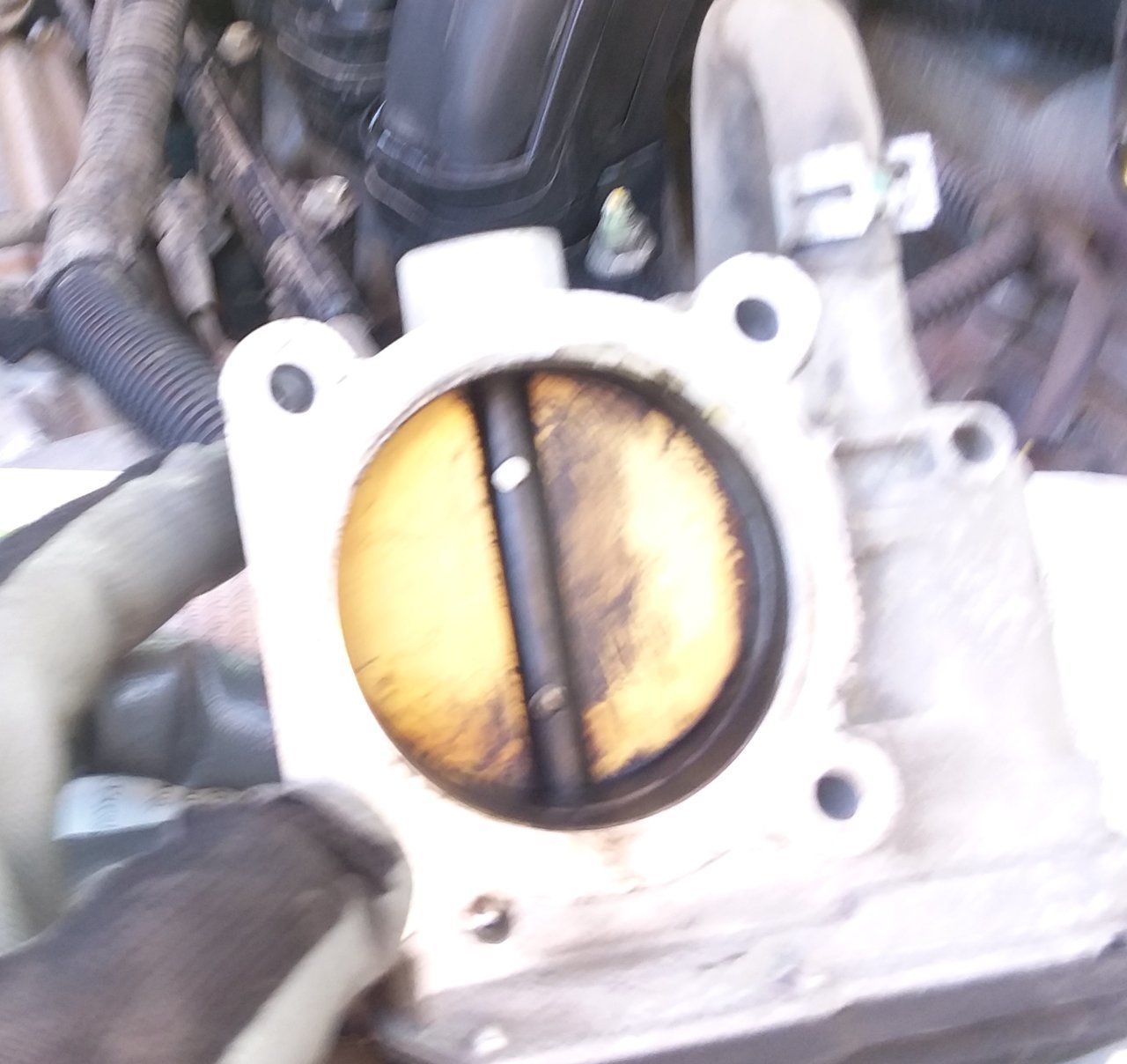

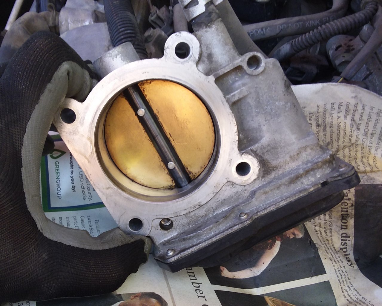

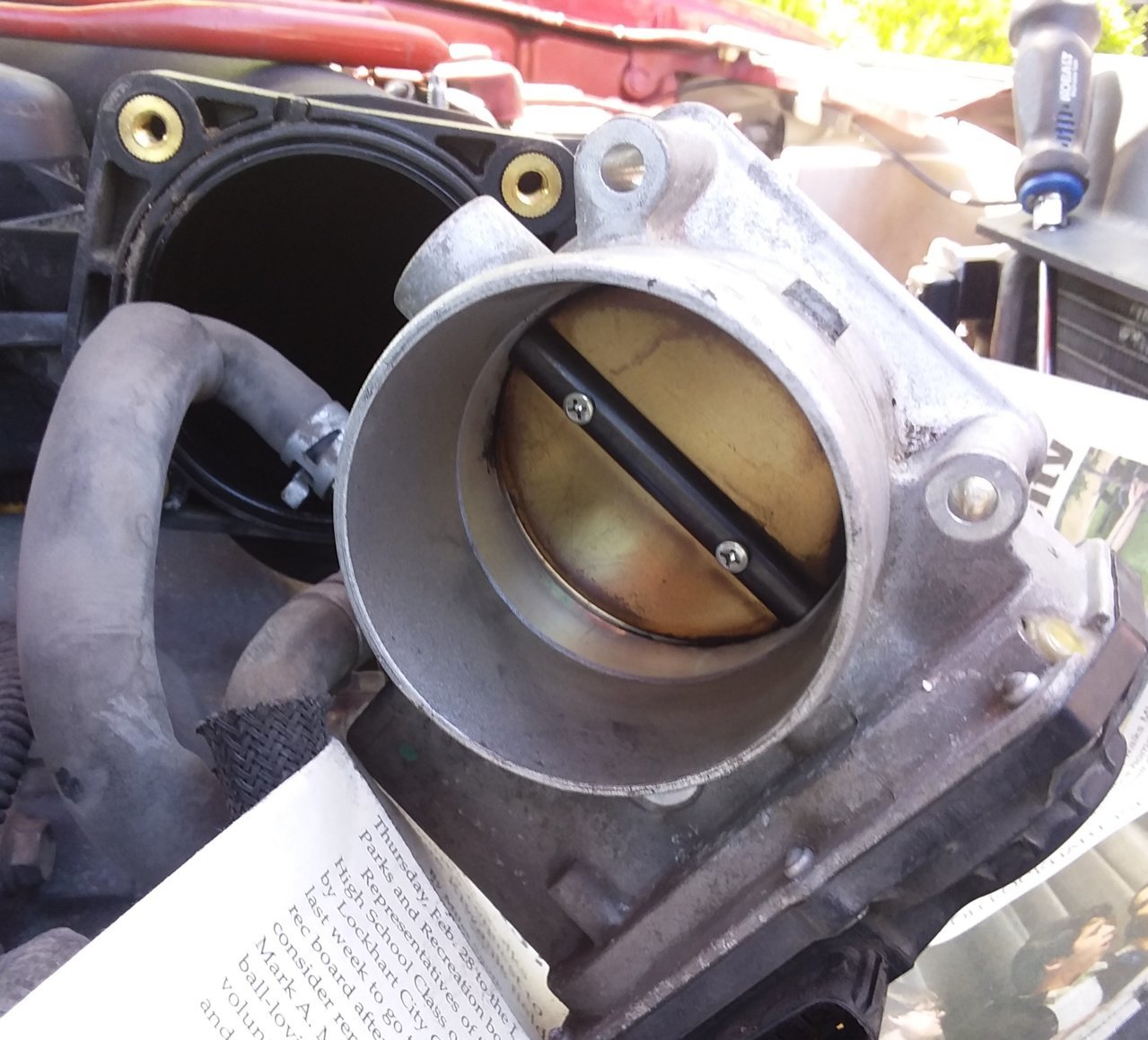

    Where am I? Oh yes, this is all apart, so clean out the throttle body, right? RIGHT! Bloody well right!
    20190410_150914.jpg Intake pretty clean from last time
    20190410_150921.jpg Backside, I didn't do so well
    20190410_151642.jpg So, I spent awhile on the backside
    20190410_152526.jpg OK, that's out of the way - back to the mod!

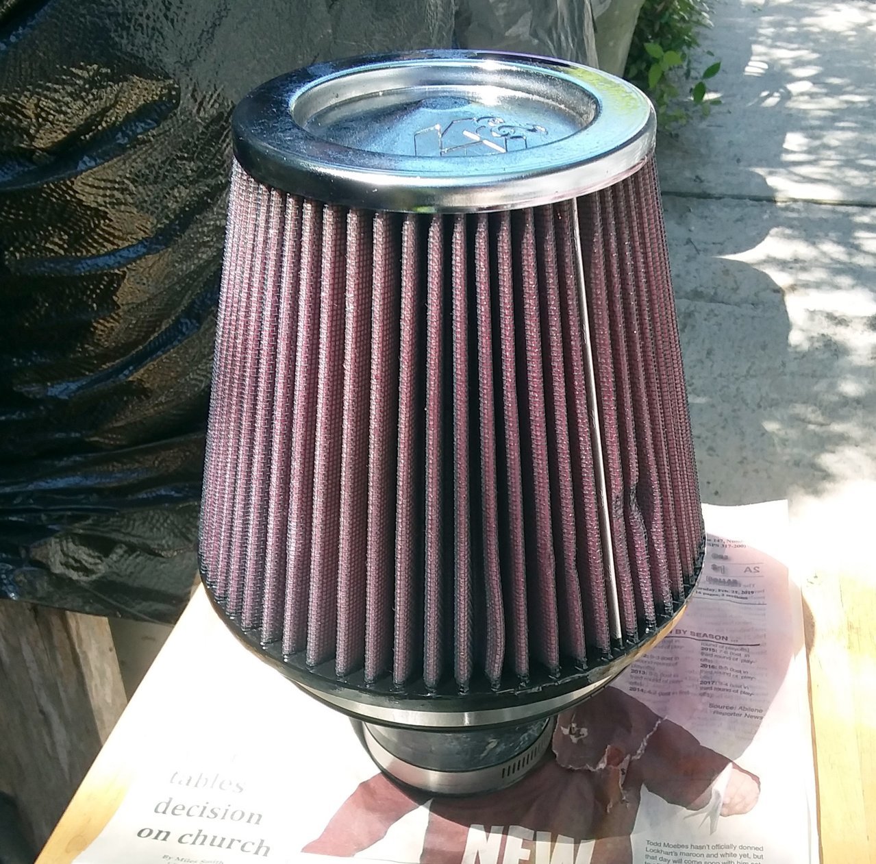

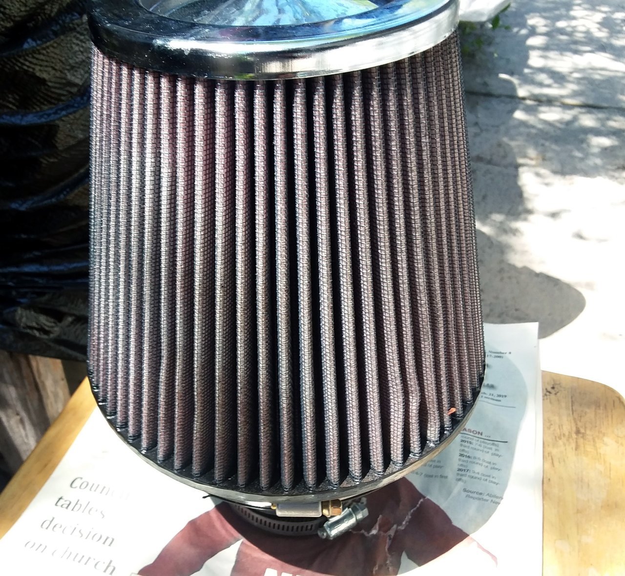

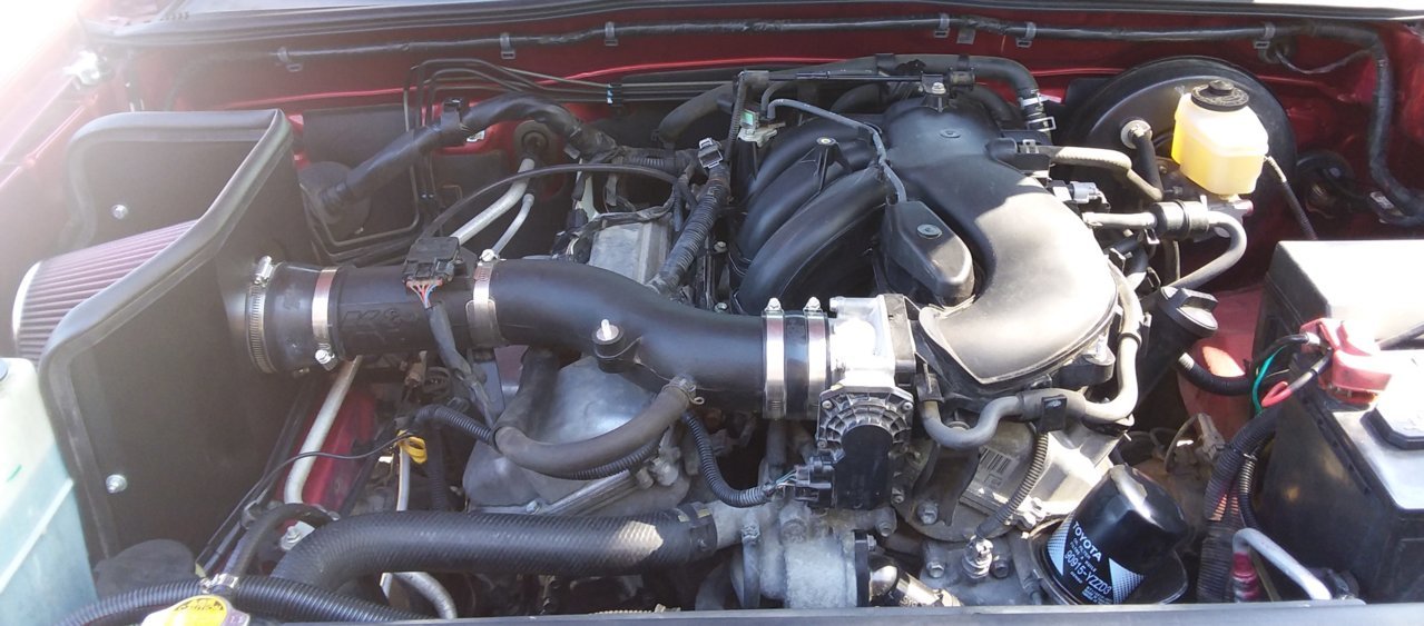

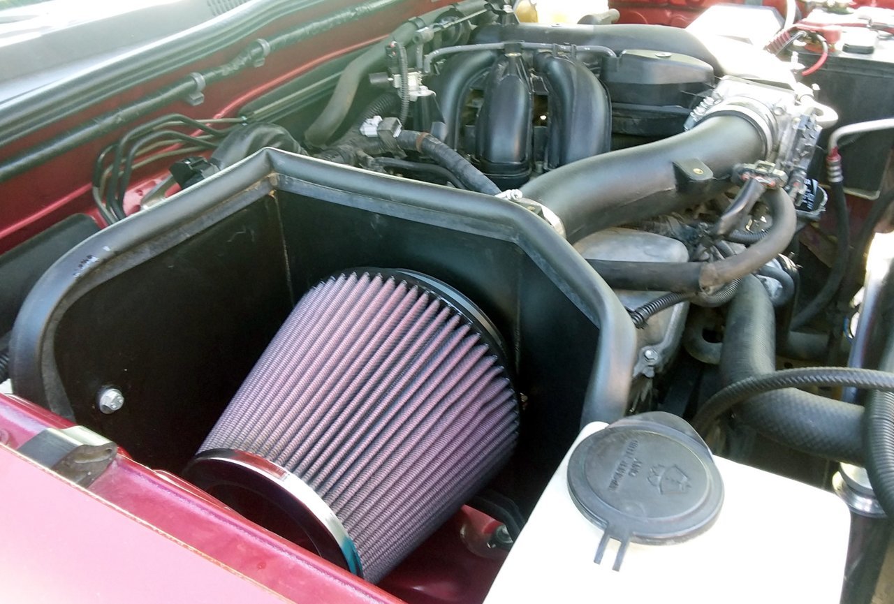

    So, basically, it's time to assemble the tube. The instructions aren't great, and since it's used, some of the steps DO NOT equal first install. But, here we go
    20190410_153835.jpg 20190410_153843.jpg Install the filter mounting barrier

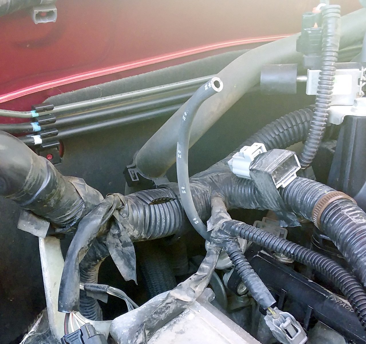

    20190410_155100.jpgReplace the fuel vapor hose with a long one.
    20190410_160441.jpg Don't reverse the PCV hose as instructed, works just fine.
    20190410_160819.jpg Snug up the K&N lntake
    20190410_160824.jpg Slide the filter down to the intake, and snug it down

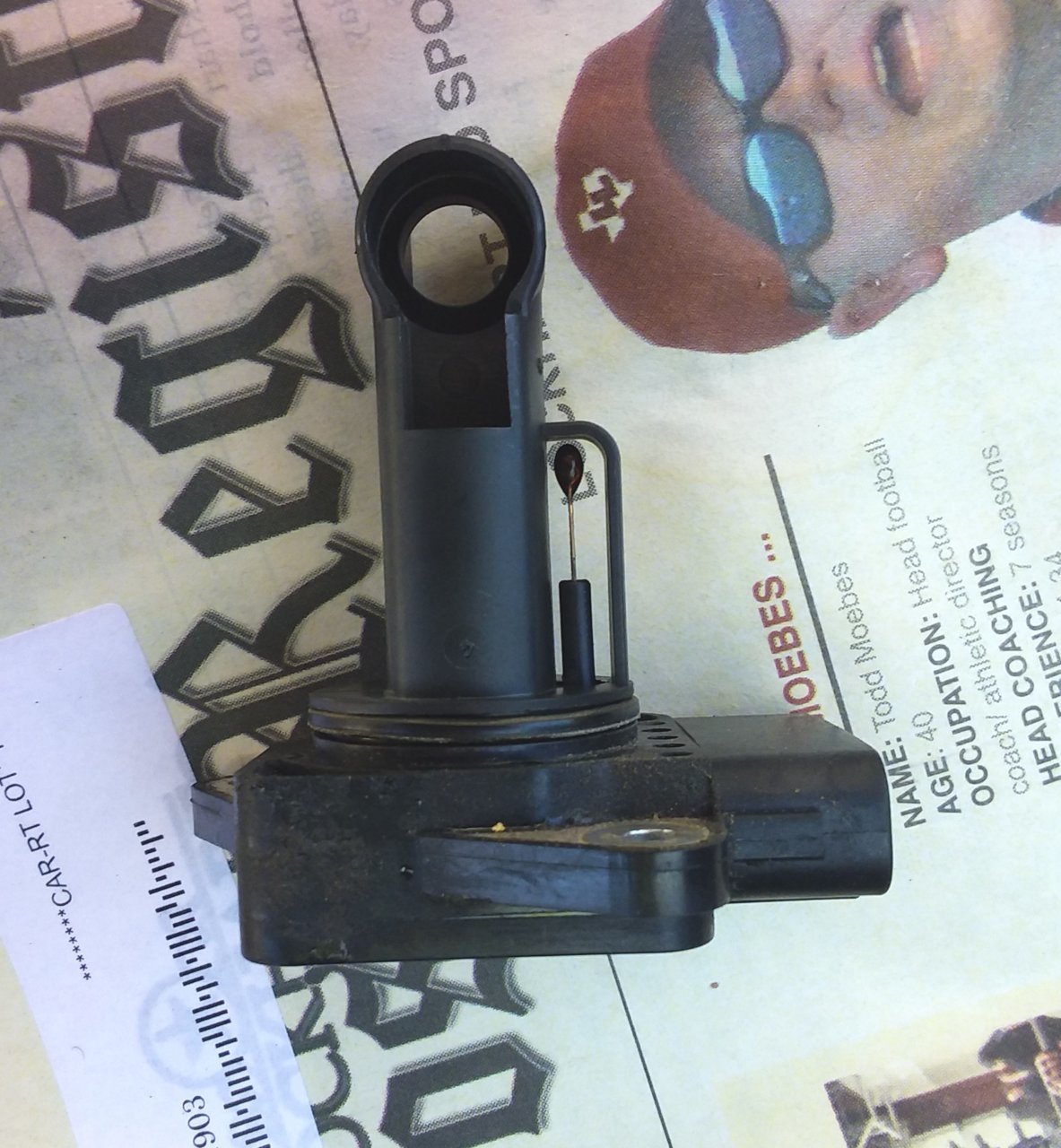

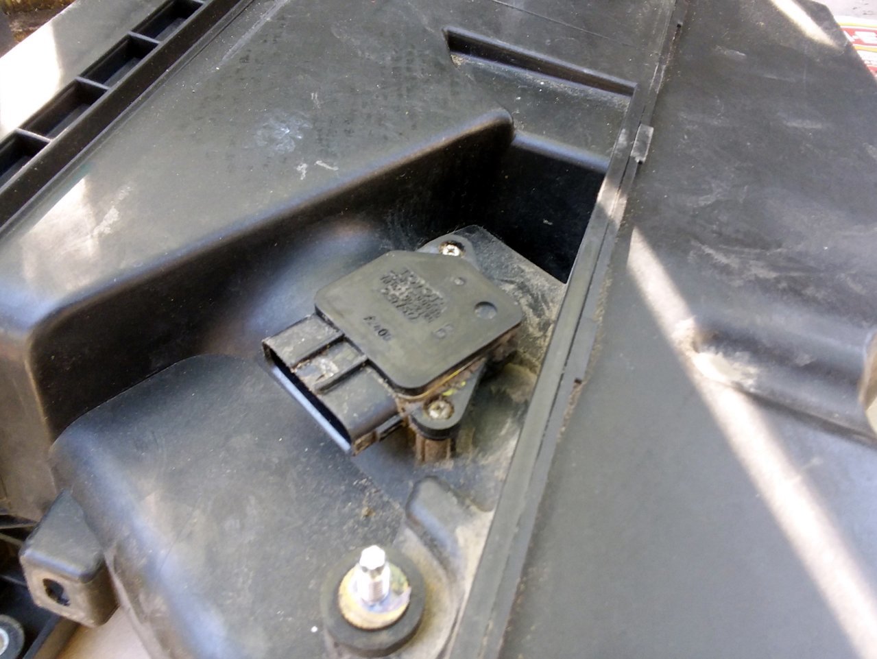

    20190410_160905.jpg Time to remove the old MAF from the original housing
    20190410_161037.jpg Might as well spray the heck out of it with MAF cleaner.....
    20190410_162235.jpg Didn't have the gasket, but I had a skinny O Ring, and with the spacers, worked just fine.
    20190410_162604.jpg And, though I had information I could not cover it back up, I could.

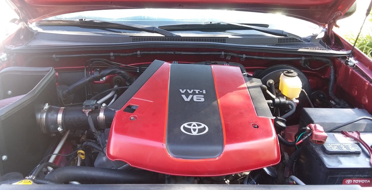

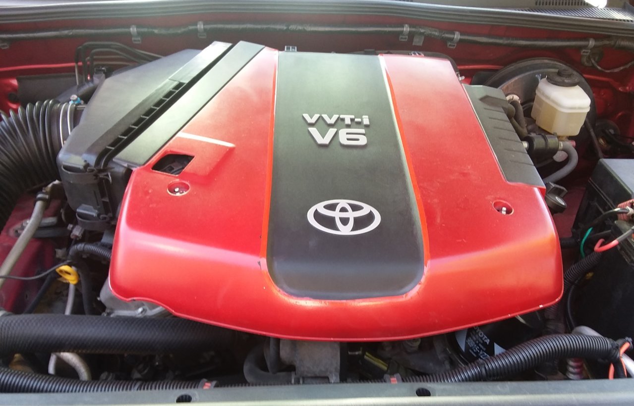

    Took it for a little grandpa drive around the block, and purrs like a kitten. More "FEEL" details to follow, as well as any MPG I can report.
    Edit 5/4: I've had three fill ups since the install, and a mix of driving conditions as well. It feels more responsive, sound nice normally, and a little mean when stomped, deepens exhaust note a bit - I like it!
    15.3 mpg - all city with only a few stomps!
    17.1 mpg - mostly highway, and lifted halfway through
    19.3 mpg - today, inter-urban, and matches my best within a 10th or so.
