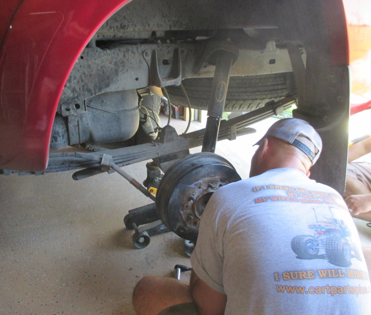

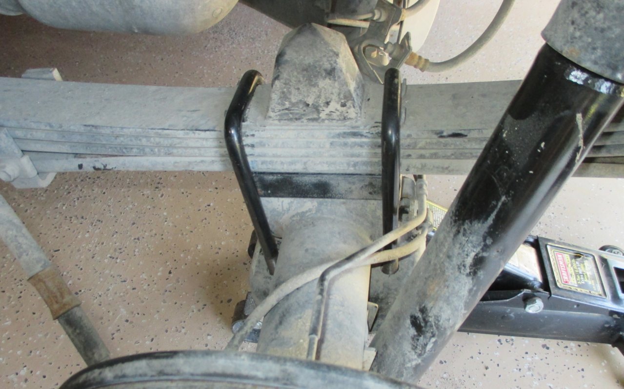

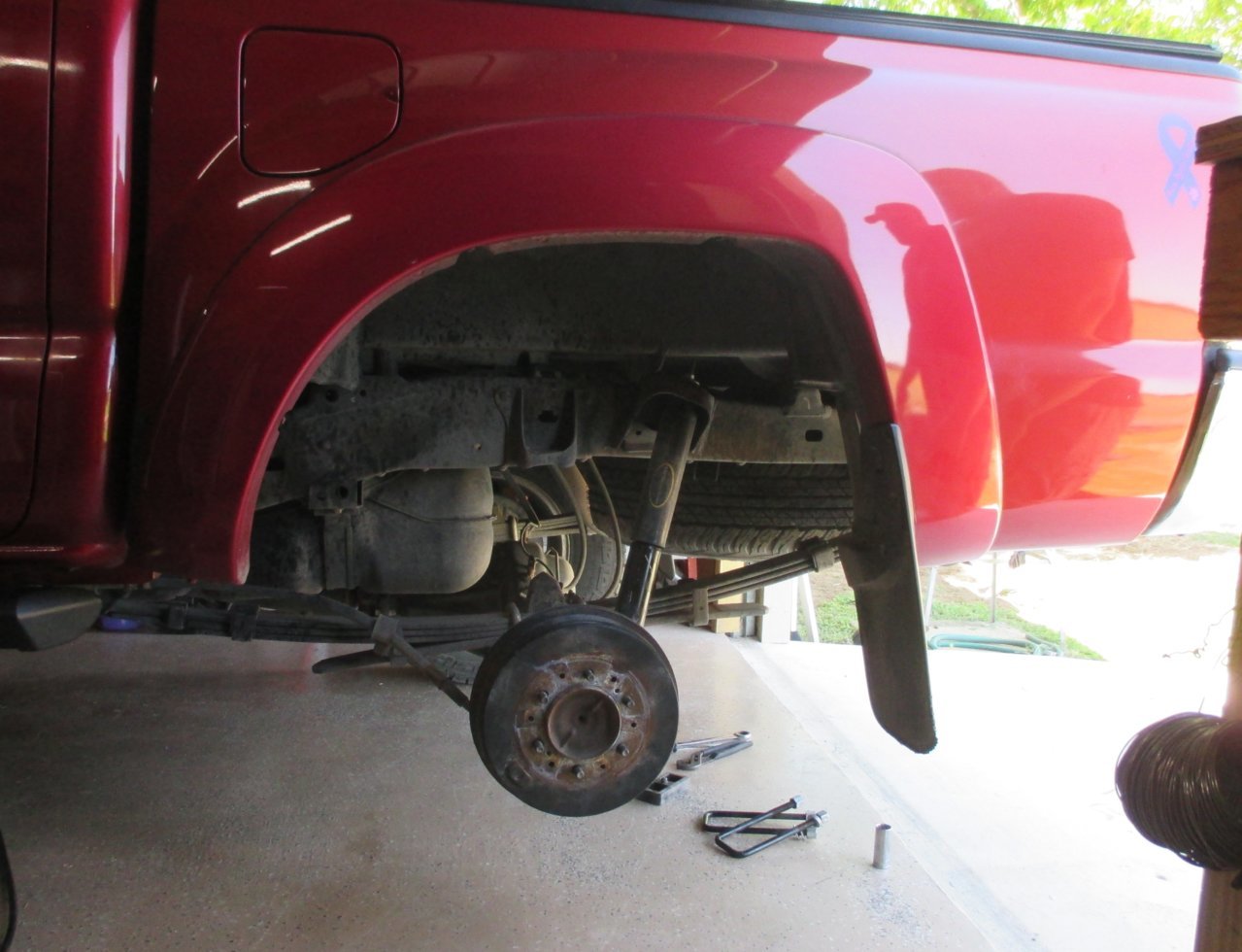

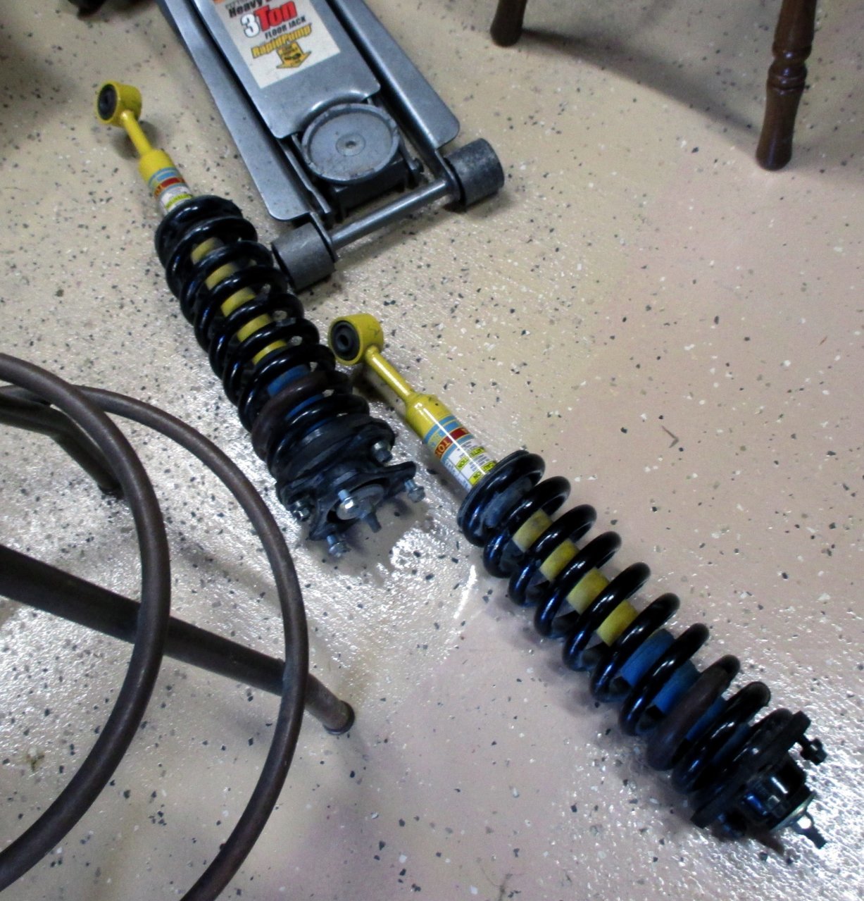

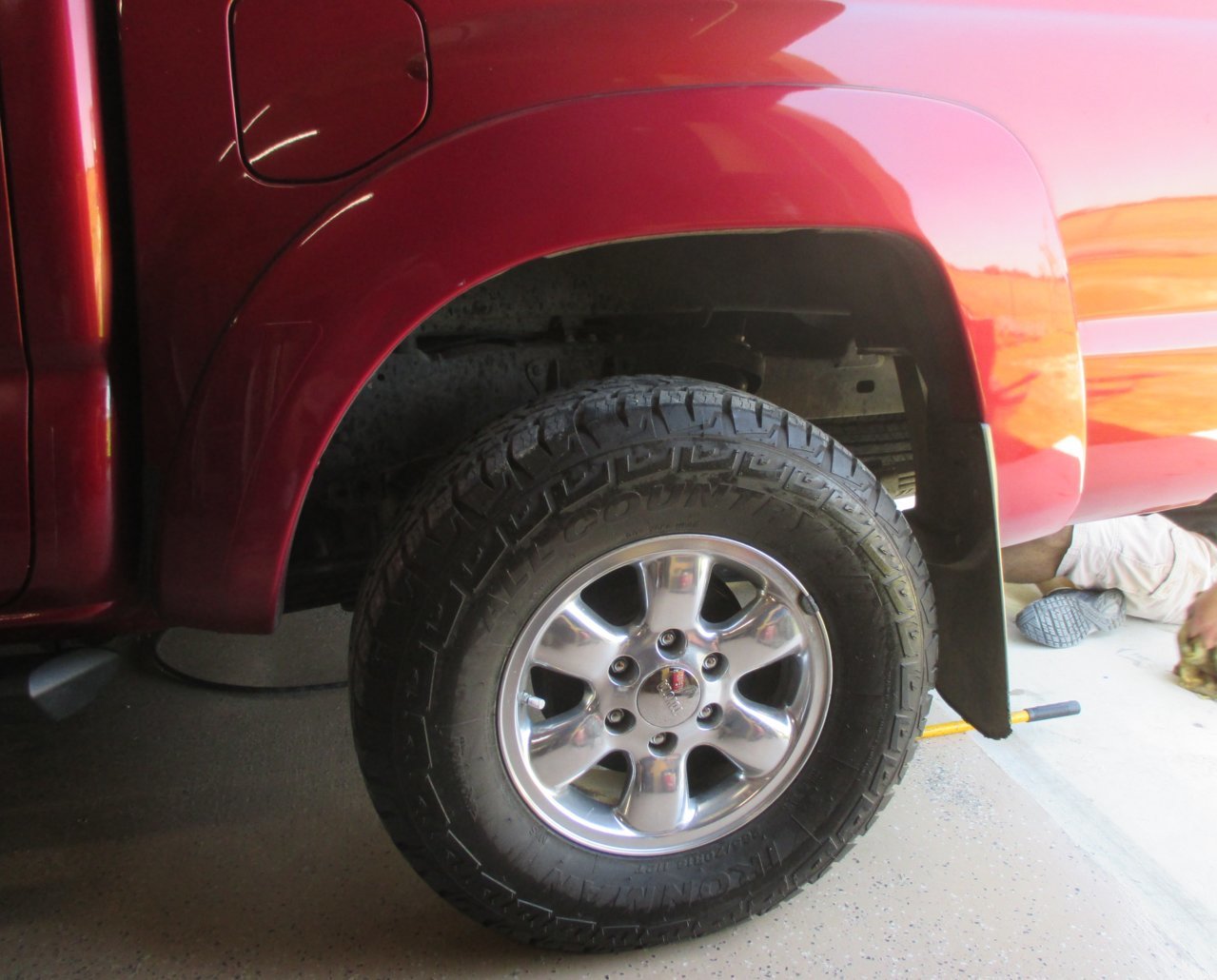

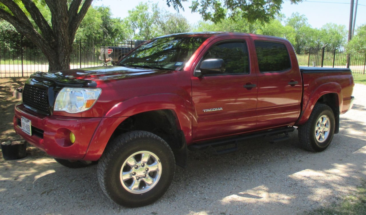

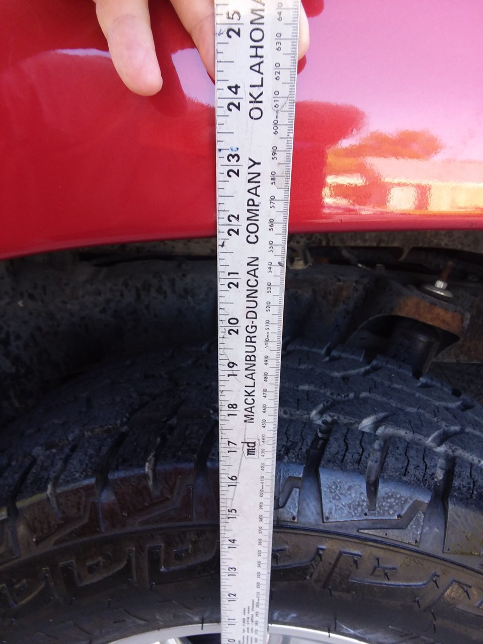

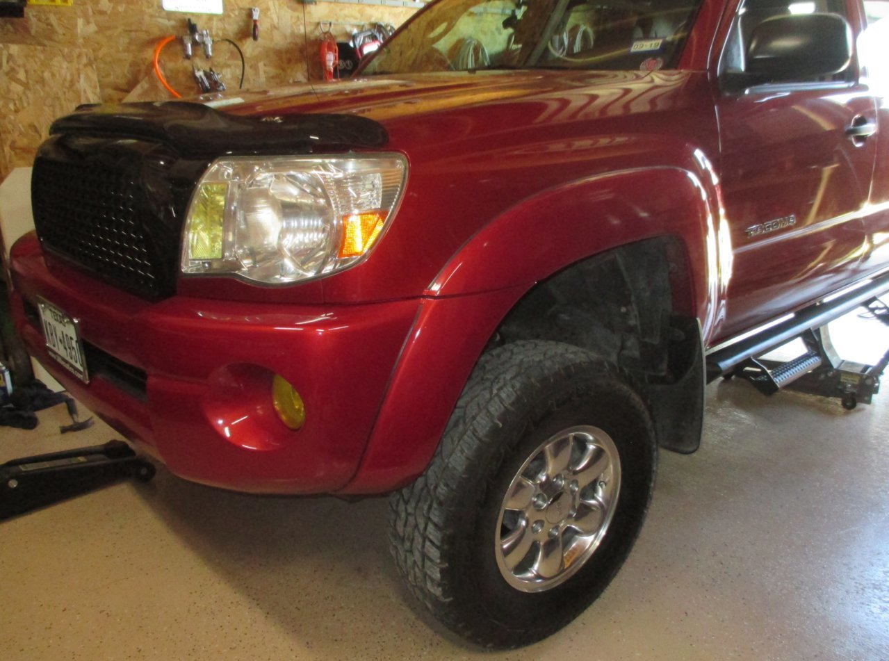

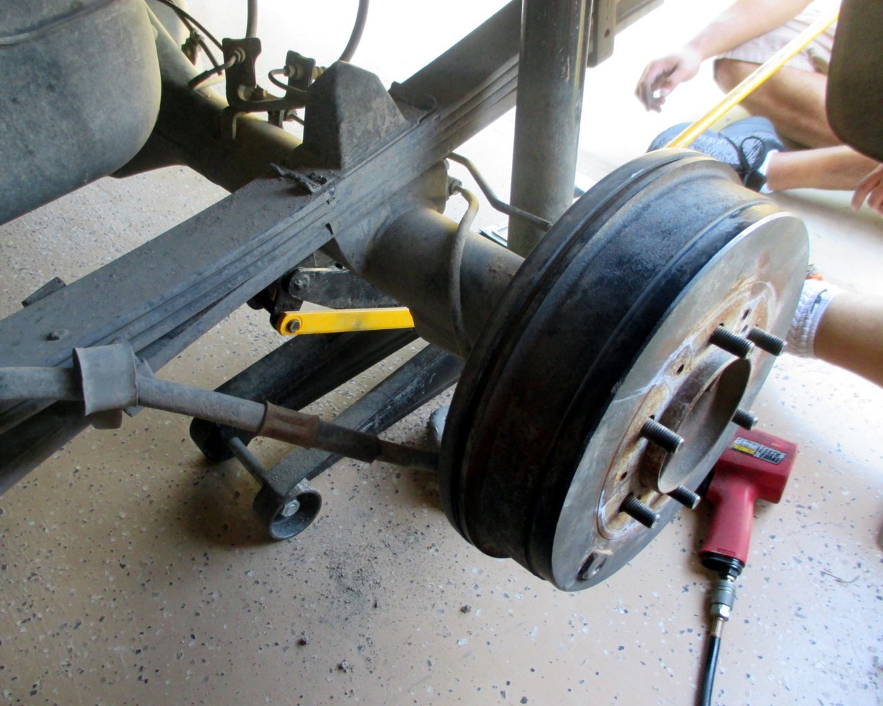

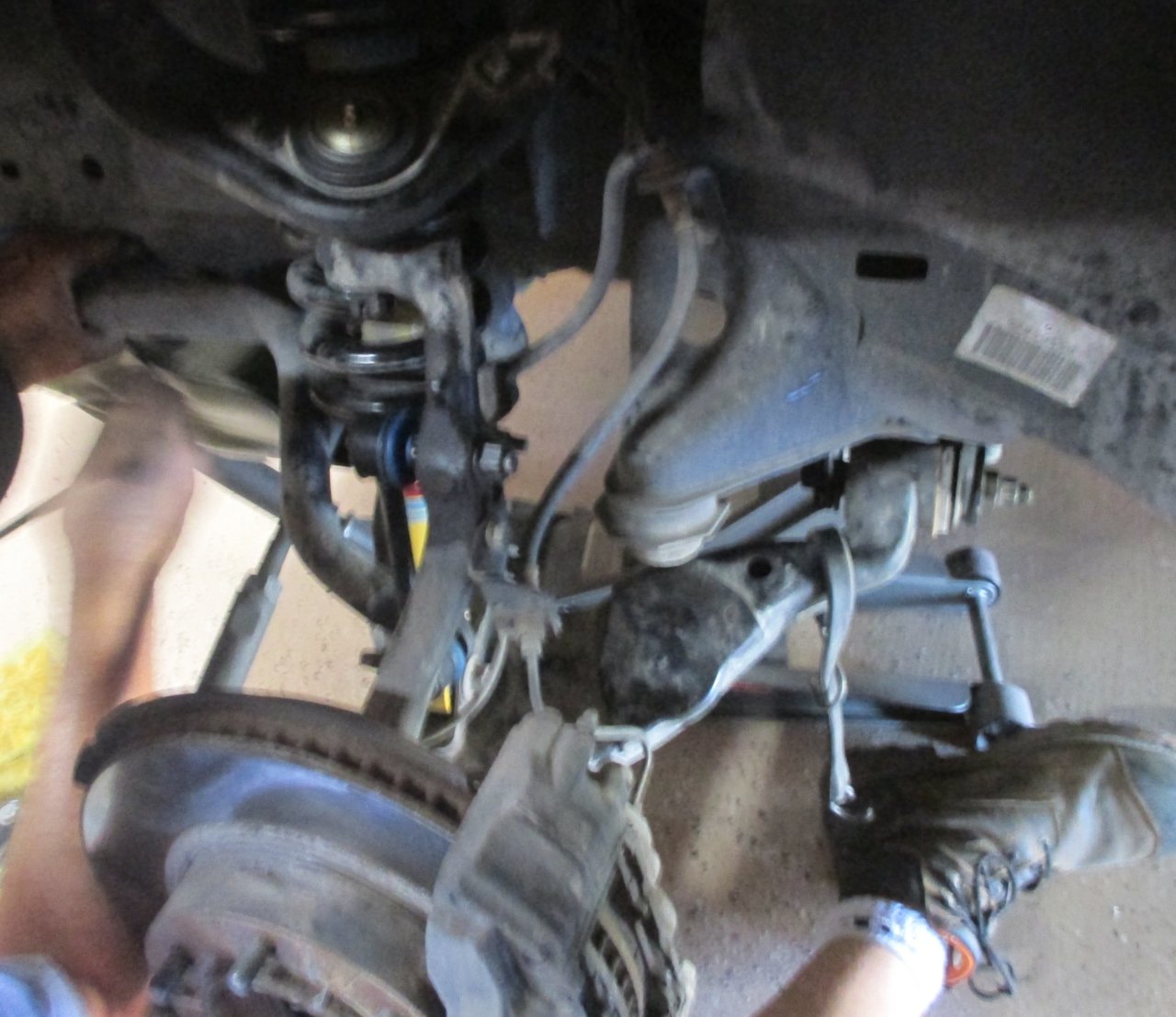

    Back to Reality!

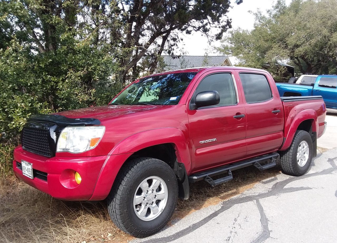

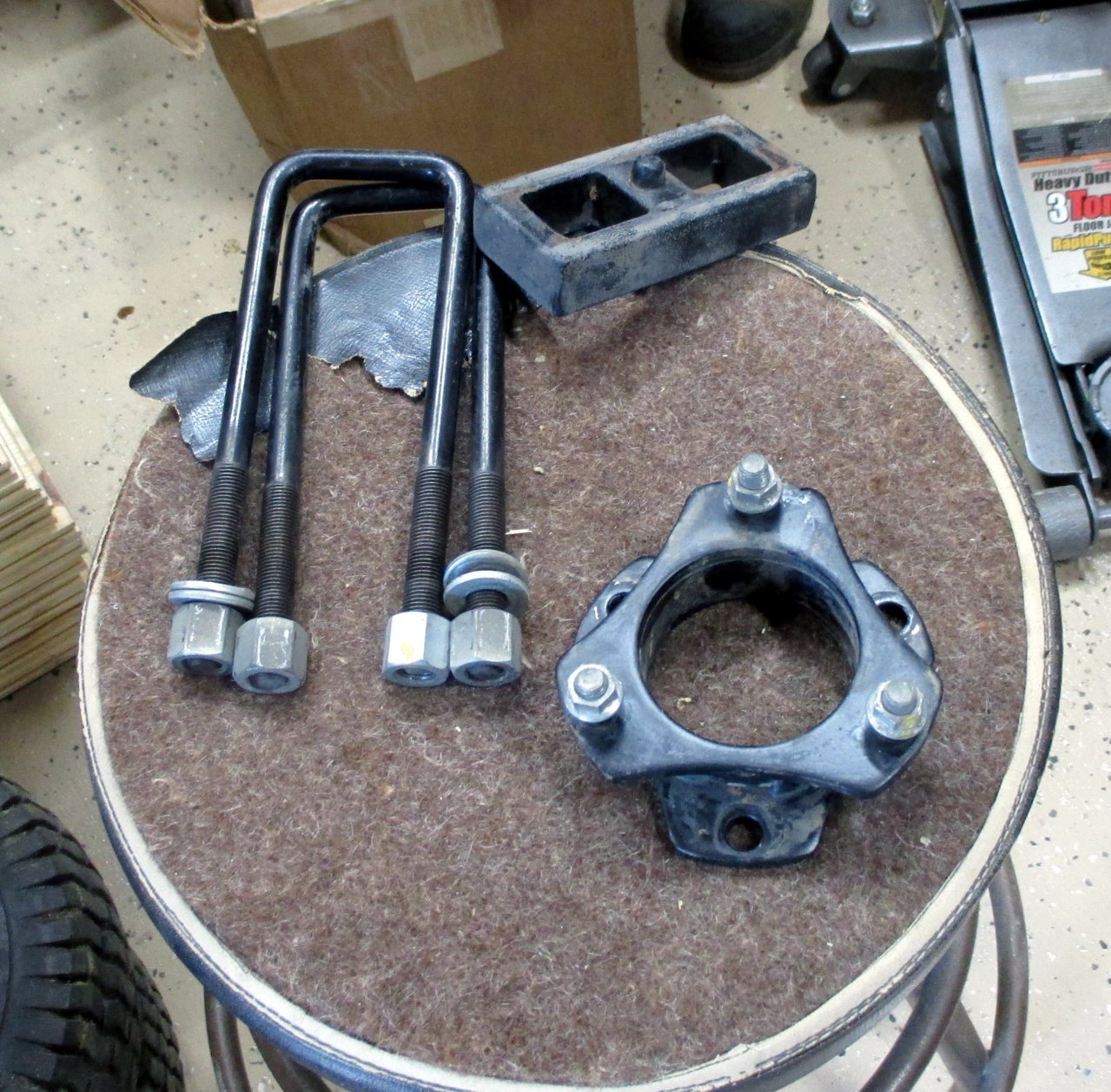

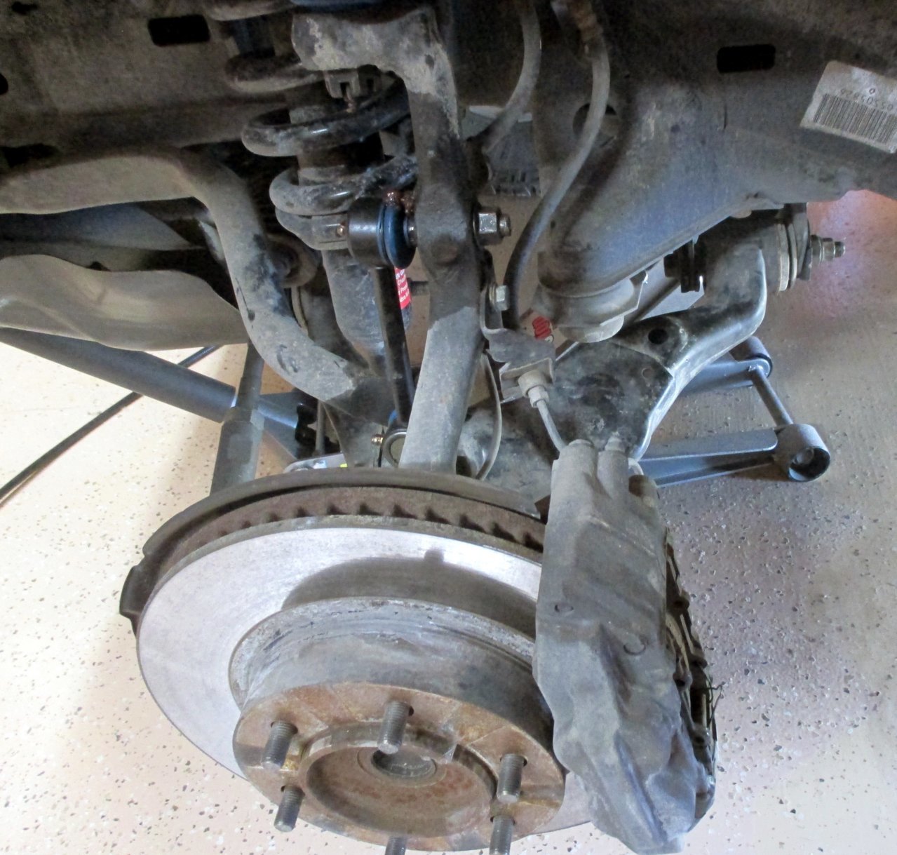

    The Secret Ground Clearance Project - Phase Fifteen; Oh, Heck, It Got Lifted! I admit it!
    First off, have to give thanks and props to my main benefactors here. @LostHusker , huge thanks for the deal and the labor! Huge. And @MattCowsmasher , who puts up with way too many questions from me, and helped supervise and wrench on this change! Me, I take pictures and ask even more questions. But I will admit, I missed the OBVIOUS one on this tinker!
    This started because I wanted a little "ground clearance" at very low cost. Enough so a little extra comfort on trail rides or the beach; NOT to avoid rocks, large or small! I found that installing OEM 3'rd Gen fronts (Toyota-Bilstein's) with the stock spring would provide about 1" of lift, with no other mods, and supposedly improve ride quality over OEM. Even though I just replaced the fronts with Monroe OEM replacements, I was offered a cannot refuse price, and at the rate I rack up miles (NOT), even used will last me over a decade! Mark also had a rear spacer block that would give a little to the back as well. Beer and such were negotiated, a schedule was made, and a trip to Lost Husker Estates was planned! The surprise came along the way in one of those little details that didn't seem like much at the time. I will give CLUES with a little "*" along the way!
    Here's the parts. Note the parts on the stool* in the second photo!

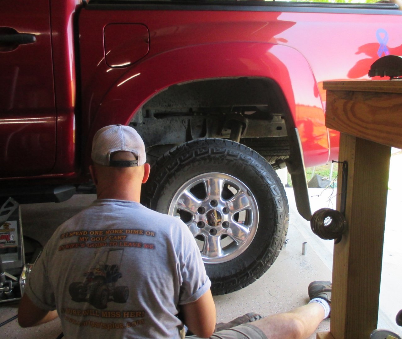

    So that's what we got. Off comes the wheel, and off we go. Mark does the hard work, Matt helps, I watch in awe!
    OK, front is done... uh, that jack is still holding it up, right?*

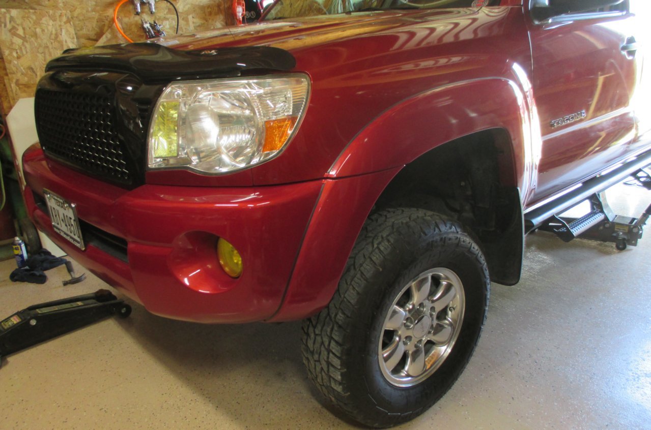

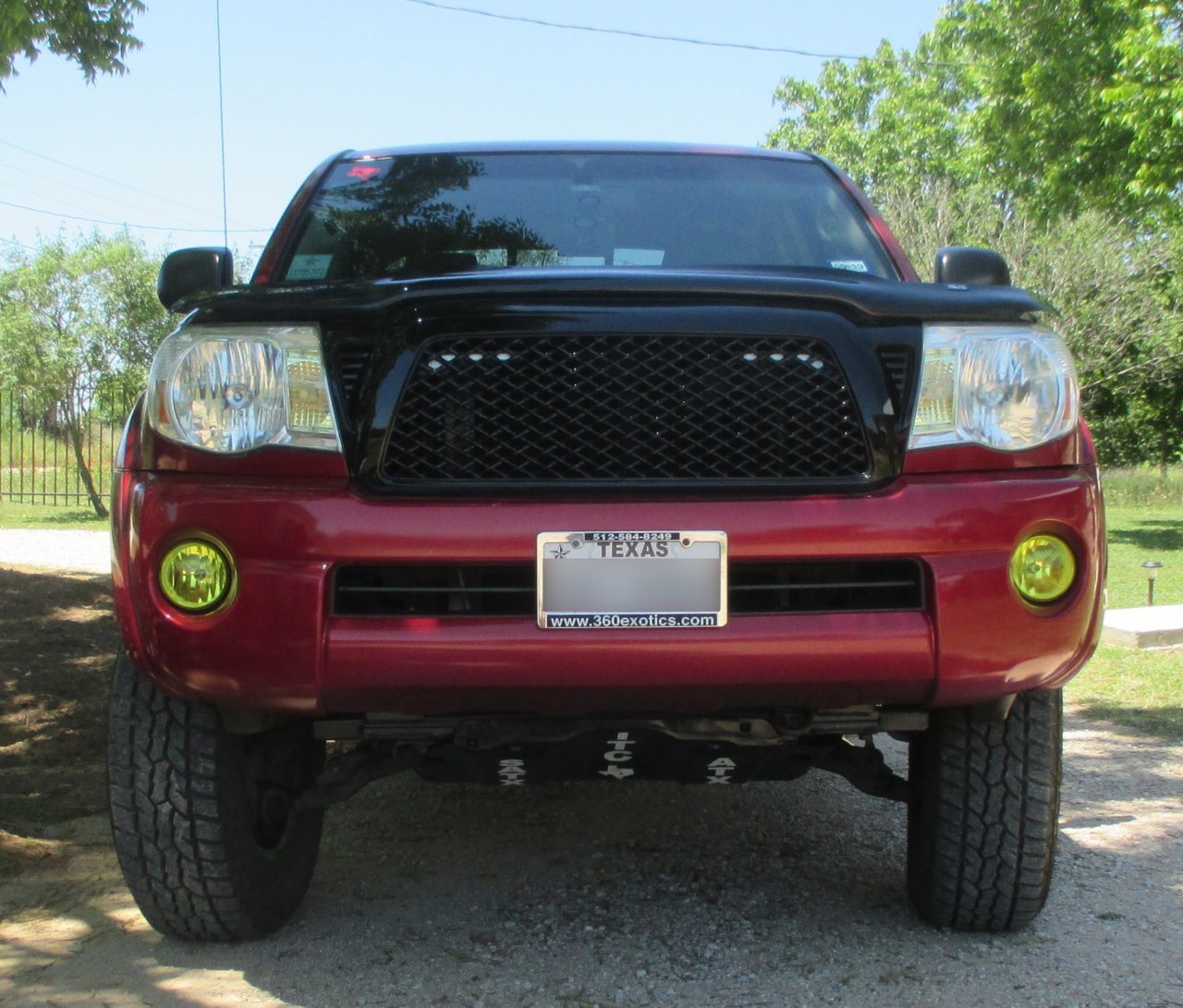

    Right?* NO, those spacers that I said "sure" to are 2", so the front goes up 3"! (They knew that! My face said "NO, I did NOT realize that!"

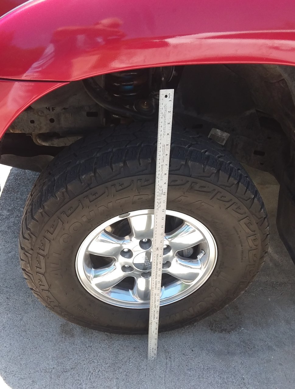

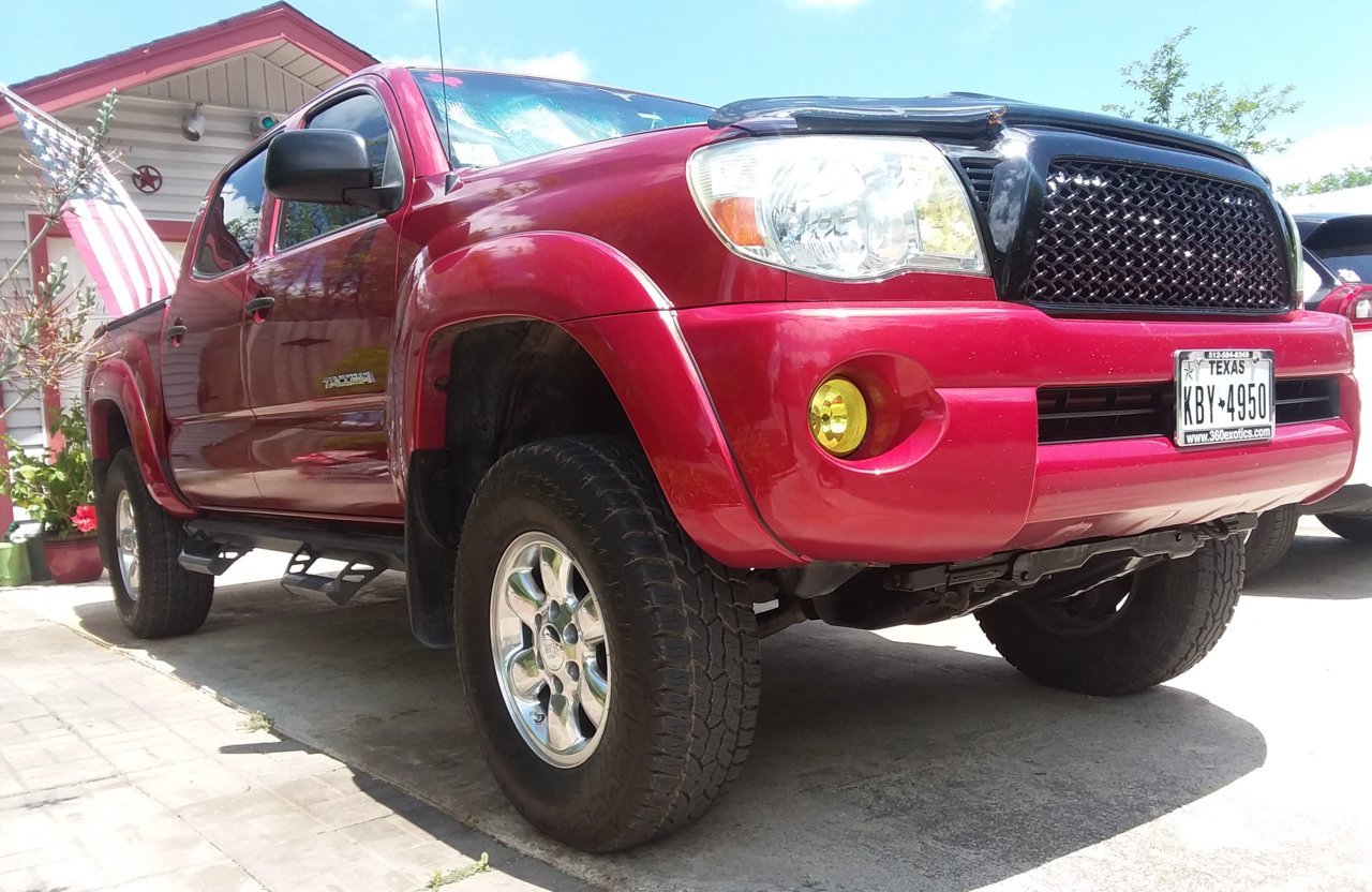

    All right, now I know, I can't call it Ground Clearance anymore. I am thrilled, embarrassed that I could not do the math, I really just thought those spacers were part of the 1" I was expecting. So, on to the back, where I am promised I will be less surprised.

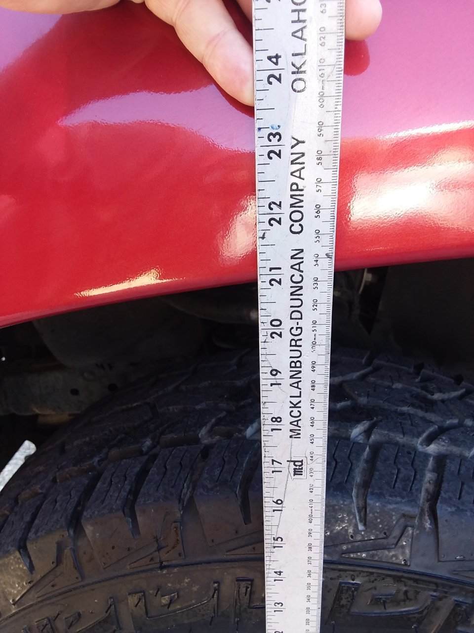

    We're finished! Drive it down to the end of the road and back to "settle it in" and see how it feels. Better than I drove in on! Excitement rules! And now it looks like this!!!!!!

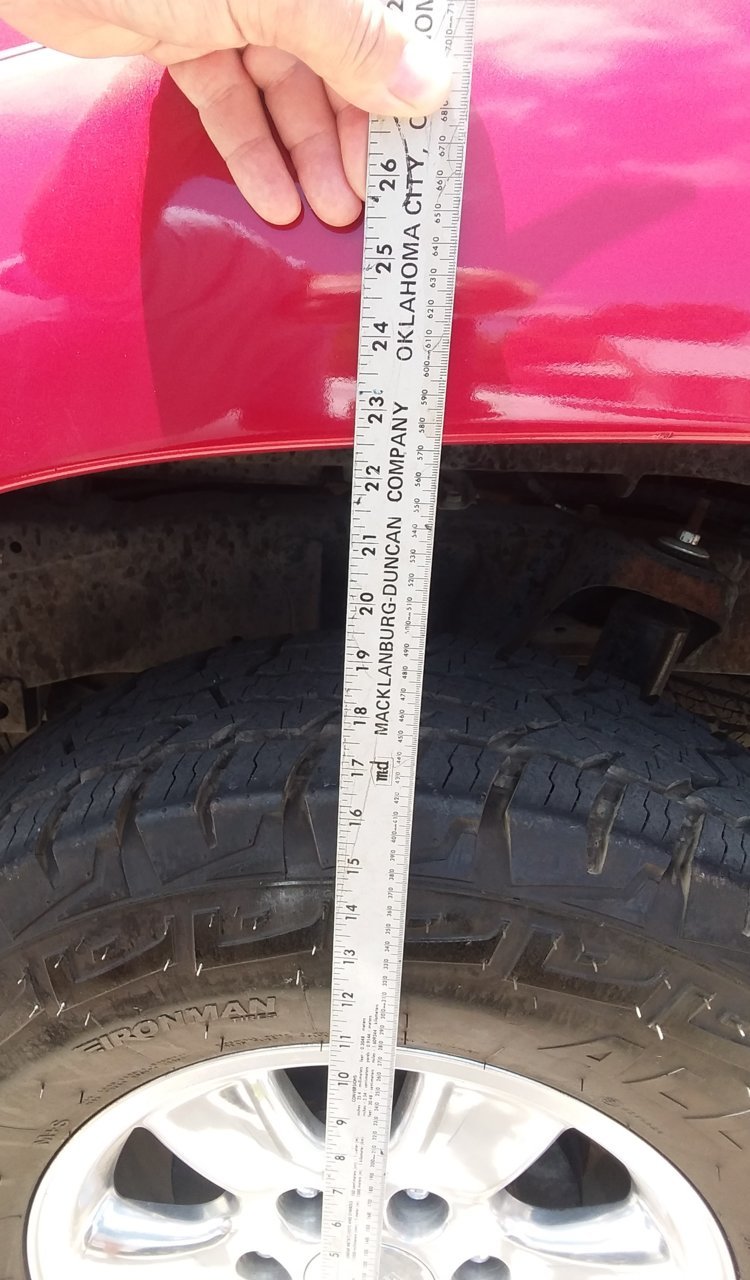

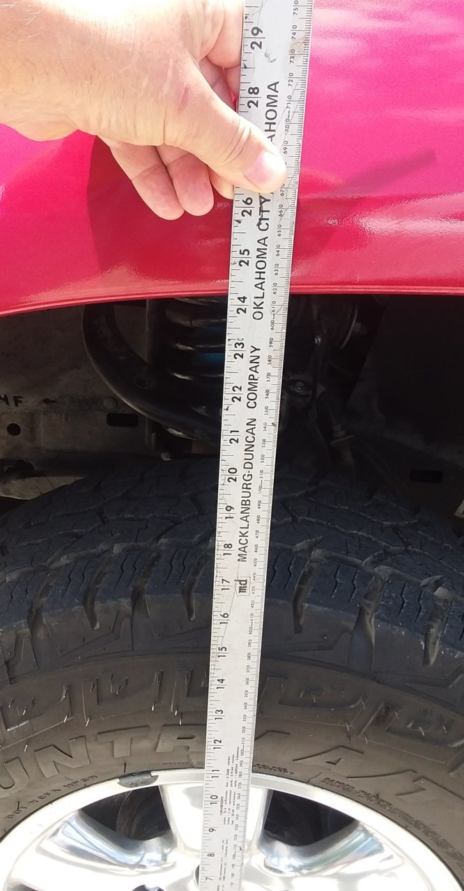

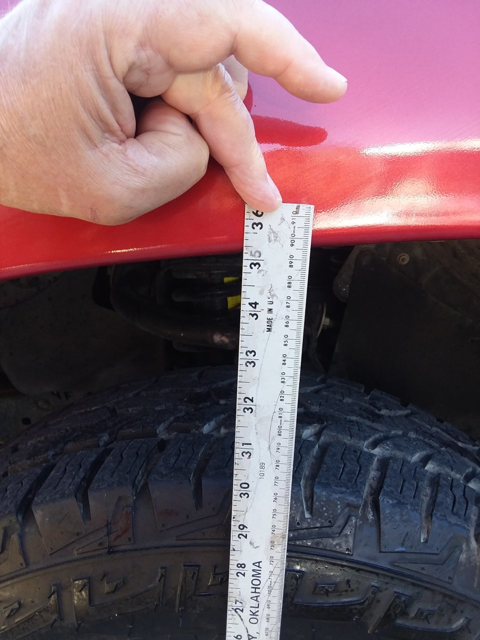

    I know measure it! First attempt with a yard stick didn't work (I'll show you), and I couldn't keep the tape in place. So, from approiximate center or wheel to fender lip, and fairly straight. Results were same on both sides within a skosh, so level.
    Not going to work that way! Fronts - was 21" center to fender, now 24" center to fender
    Rears were 22" center to fender, now 22 1/2" center to fender
    Little Big Red at Triple C in January
    Most recent comparisons after the Predator steps
    And thanks once again!!!!!!!! TTC must be an abbreviation in some language for "friends and family", after all, "Tejas" does mean friend. So grateful to our wonderful members!

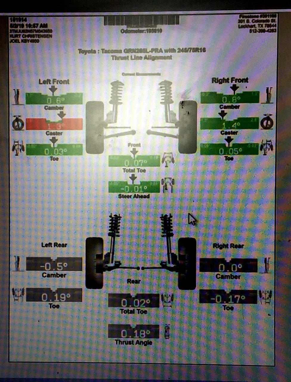

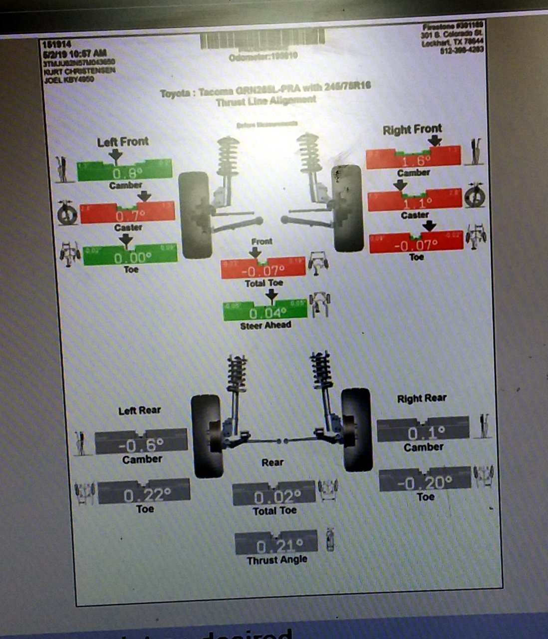

    Edit 5/4: To add alignment spec - their printer was broken;
    Before
    And After
    And of course, "But, wait! There's more!"

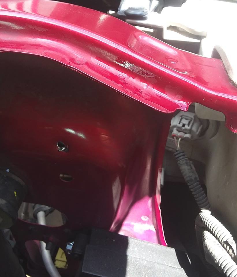

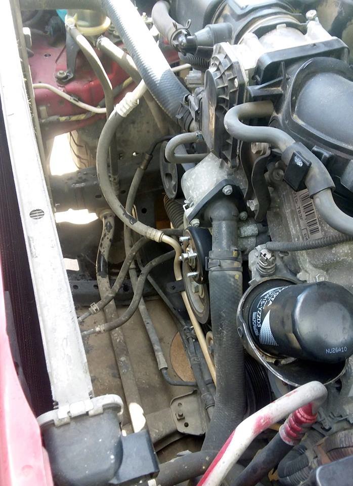

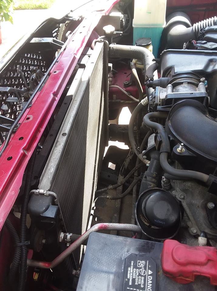

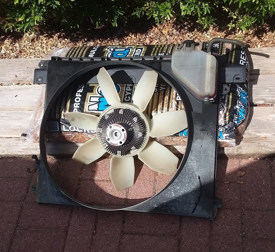

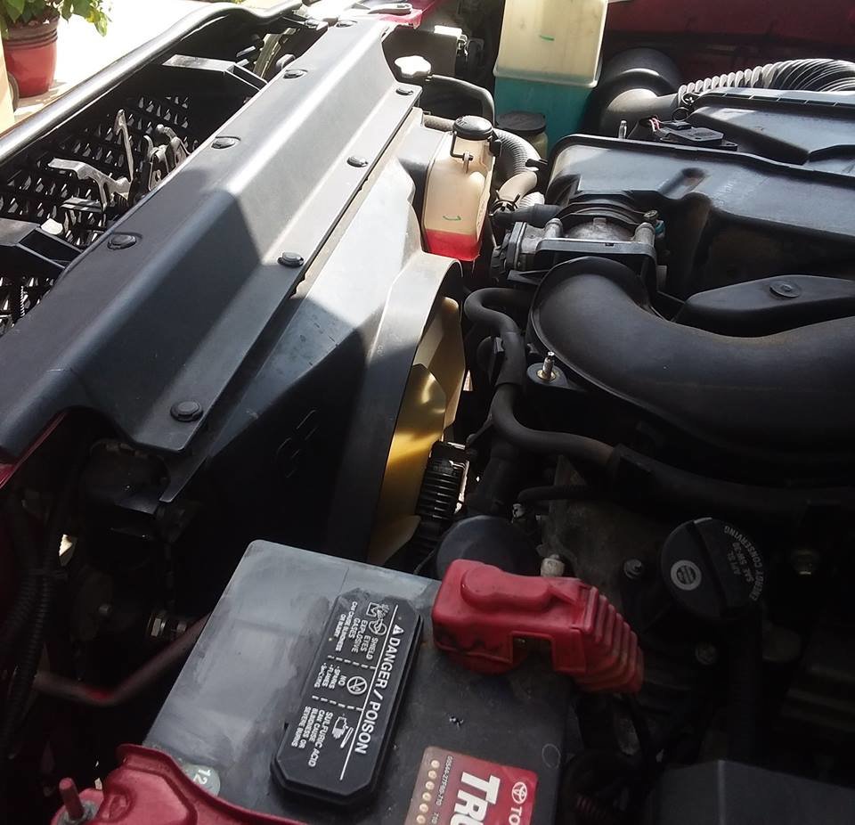

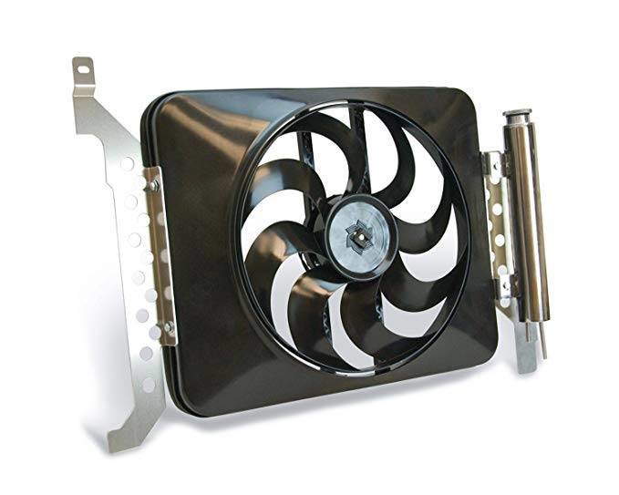

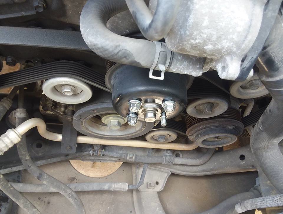

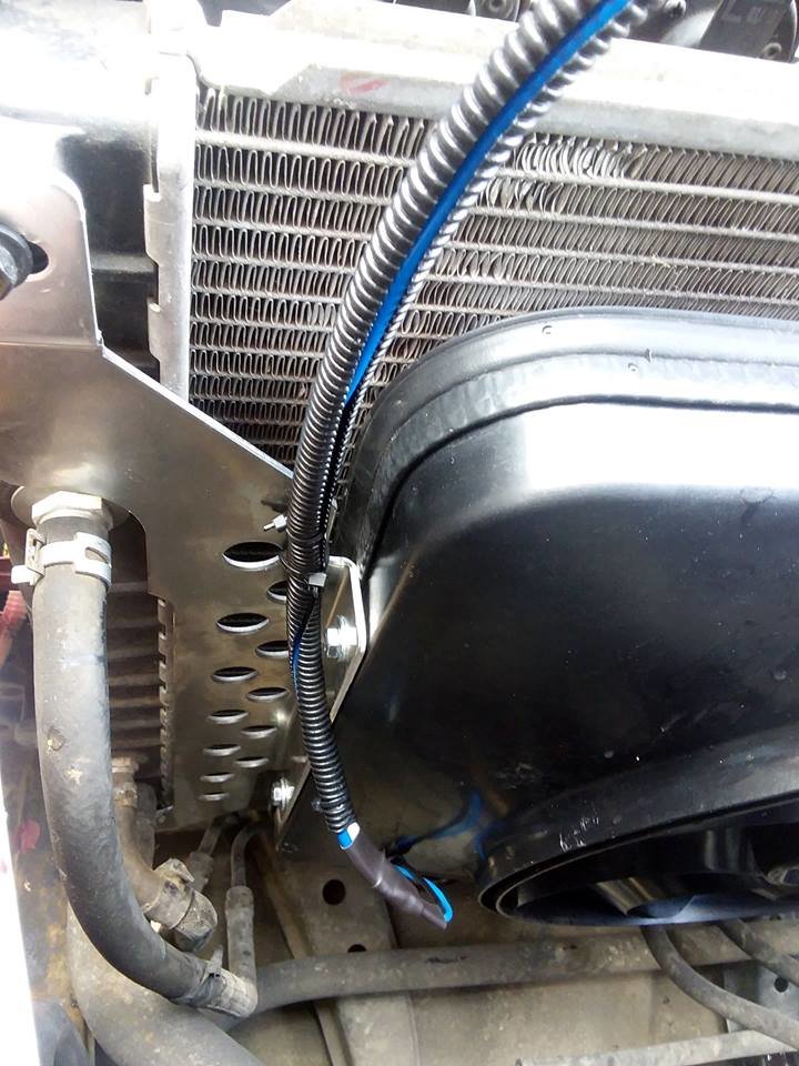

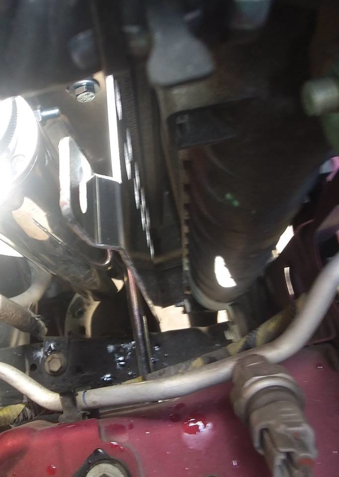

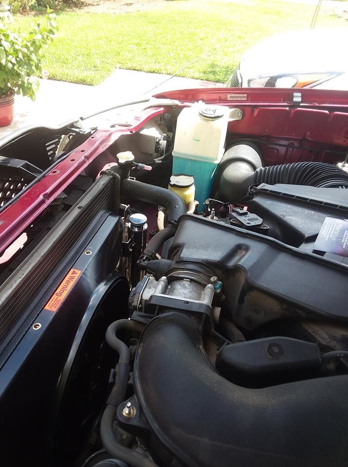

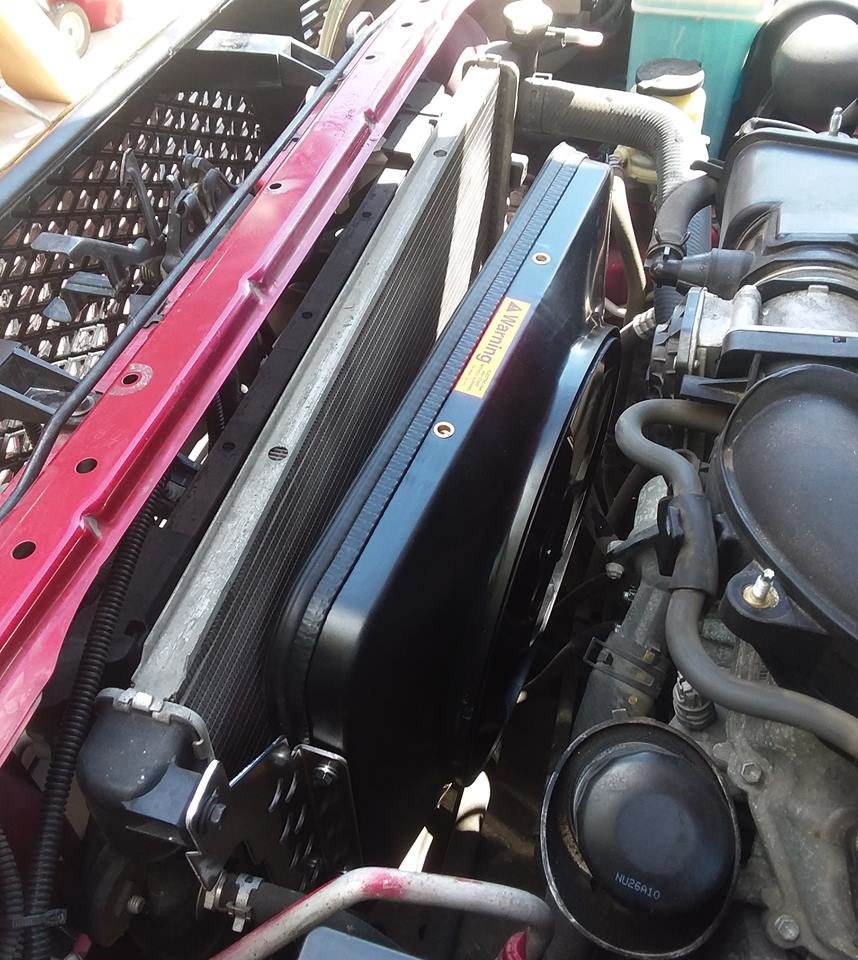

    The Lost Electric Fan Replacement - Phase X-Files; I Totally LOST This Somewhere!
    Have to rescue from FB posts - September of 2018.
    The thermo-clutch fan was making grinding, dying noises if let set for a while - which the truck does a lot of. A good replacement was a few bucks, so I researched electric-fan replacements. Won't give better mileage (probably), but you can control the operation, and it takes about 10 pounds off the rotating mass of the engine. So, I found the Flex-a-Lite in the Amazon warehouse for about half price (as new), spent a lot of time on the Tacoma forum, and decided to do it! I did plan two four hour mornings, and I used every bit of it. But mostly because I don't try to go too fast, and take breaks. And, you learn after you do things, that there are things you should to NOT in the order of the installation instructions! Not too bad of kit - missing ONE nut, and a little skimpy on the wire (I had to buy 2 8" rolls of #10), and tie wraps (of which I have hundreds on hand). And you want shrink wrap - I used every last bit of the needed sizes - time to go to Harbor Freight again. So, it still being very hot, I got to test drive it a little bit to the Post Office, gas station, and car wash. The temp guage used to run at just over "half" (say 55%) on the scale - now it runs less than half (say 40%), so it does run cooler. It runs with the AC engaged (all the time right now), and then will run on it's thermostat until it cools down when you shut it off. When the AC isn't on (HA!), it will run under thermostat control, which is adjustable. I tweaked that a little higher when I got home. So, it was almost fun, and I am happy how it all turned out. Next up - shocks and struts that I won't be paying over a grand to have installed! But, when it's cooler - much, much cooler! This is the Flex-a-Lite 678 that I am putting in
    40222239_2255977301299348_78615339084021_c1cfc6d418d3e7de30ff647c06b18bb198d54588.jpg
    First off, the shroud cover has to come off. Reaching in to the back of the fan & clutch, remove the nuts connecting to the pulley. Then, only two bolts hold the shroud.
    40257902_2255974657966279_31298033822528_82faa7e457ccf5b77aeecb869a85f75aed27a692.jpg
    Tip the shroud back, pull the fan and shroud up, and we have a big empty!
    40209958_2255976567966088_43538906094638_1f3e95f2053c97acbebde8116ab9dce3d6c5a195.jpg
    40223489_2255974804632931_22029620755698_47e1ac209a68a373869cf942b19d2342830049d8.jpg
    This is what came out
    40337343_2255974677966277_49166452105926_538acaaeefe08b7bb7136e467cb2e2c6b9acaad8.jpg
    Put a lock washer and the nuts back on the pulley.
    40243160_2255974627966282_69546171826385_1b6db4f26134ab15ddaabd39b0c8482f9d90bc20.jpg

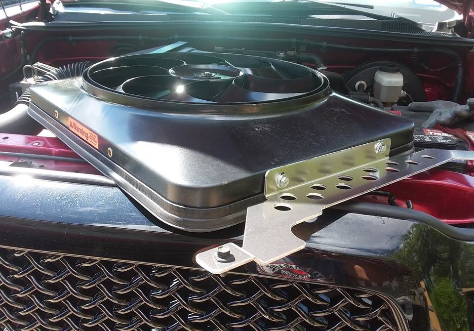

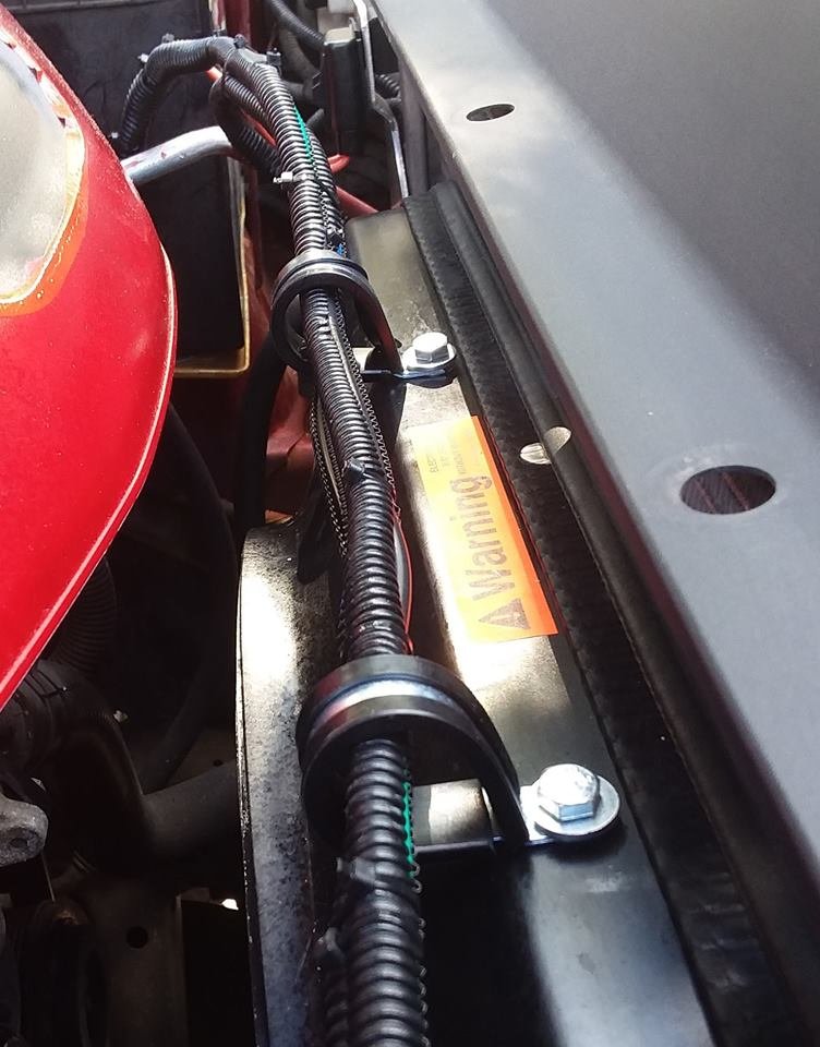

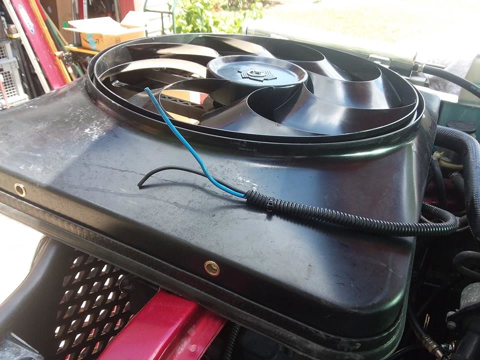

    First, the drivers side bracket is attached to the new fan and shroud
    40215540_2255974771299601_92030415342812_c22c76db1af5d5b8d46d8933b6081ad422cdd30e.jpg
    Now, not in the instruction, and NOT in order - the fan wires just lay around inside the shroud - not ideal. So, I drilled a hole in the bottom, and put some split loom over the wires, and pushed it into the hole. Then drilled 2 smaller holes to make a tie wrap hold down.
    40293660_2255974854632926_88945892280342_2f9bccf4055bd951225884150053a02aaecd797a.jpg 40363702_2255976454632766_20810850685115_e04e663090273841456312f075cf20c1a17b7411.jpg

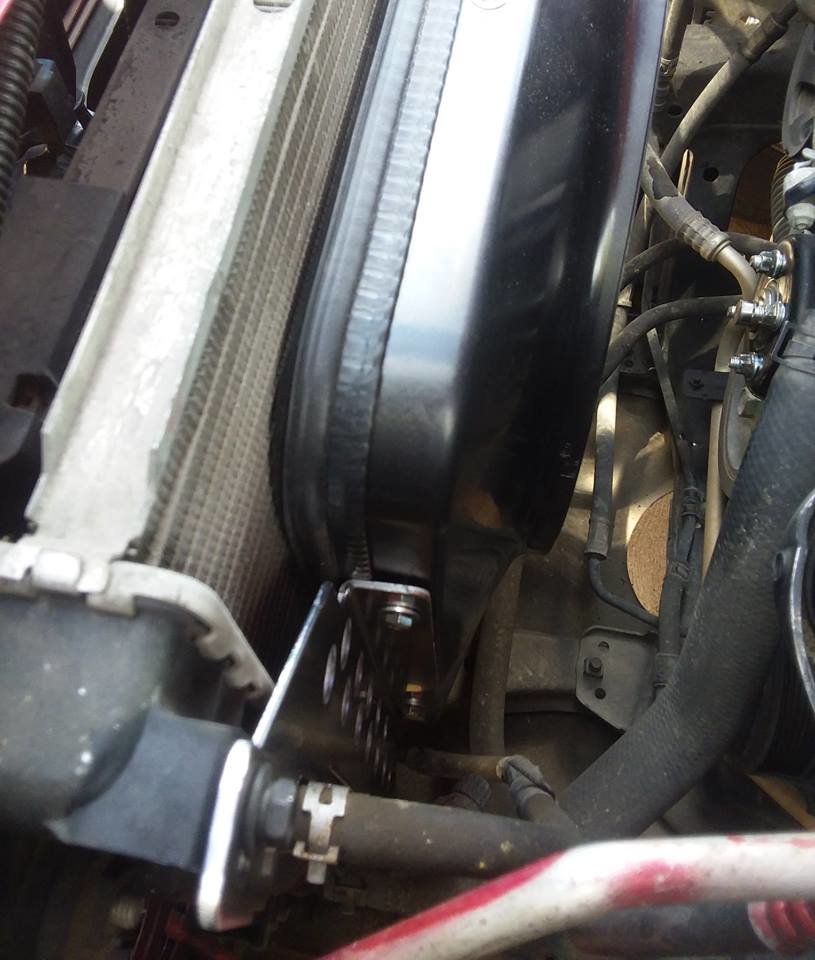

    The bottom of the bracket actually mounts into a slot in the radiator frame. Then the nuts are loosely installed.
    40250334_2255974724632939_53280547677572_ff32108da3e3ad9ce3783644c1cb32bb572da6c4.jpg

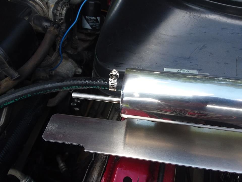

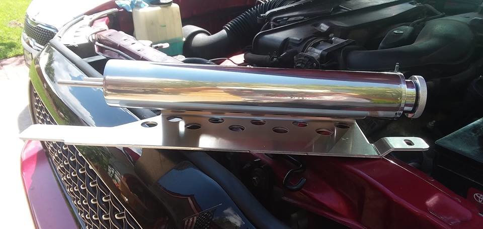

    The overflow tank is bolted to the passenger side bracket. They shorted me ONE 10mm nut. Amazingly, I had exactly ONE in with all the US thread nut bin
    40318549_2255976711299407_36807230979183_d91f2df33b0566b98fd96653f36ce20f21f1ba21.jpg
    Another out of step lesson learned. You have to connect a hose to the short tube
    40357224_2255976297966115_19953399290973_c047c8644717c47d58d865d8f4e195cb57d85276.jpg
    A REALLY GOOD time to do this is BEFORE you install the passenger side bracket! That way, the coolant you add doesn't leak out...
    40224802_2255974887966256_70419904711402_d2b7b04e5253f76fe3fd324eb89eca90b6939ca6.jpg
    Then you install the tree bolts loosely - two on the shroud, and one to the frame.
    40273633_2255974744632937_73113882403327_1da8df17427fe32bcad4e216e8c10047f637f7e0.jpg
    Last, compress the shroud gasket to the radiator, and tighten everything up.
    40219613_2255976437966101_72690707865586_6c25e3d578b773ac3e2602f2dbbce5a72eca2b35.jpg
    This marked the end of the mechanical, and day one. Four hours that could have gone quicker, but it is 103 in the driveway, and someone cut down the shade trees!
    40297226_2255974827966262_84323455675305_4bd2b4367aedf6b4b61189ed459bc66b6d4528ff.jpg

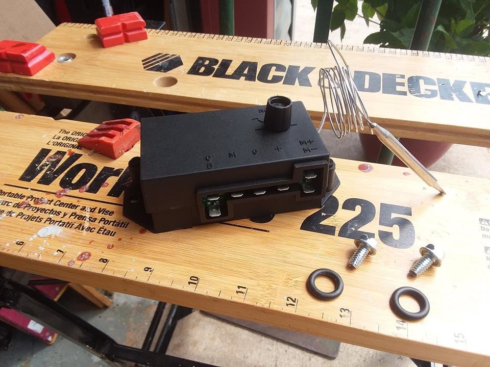

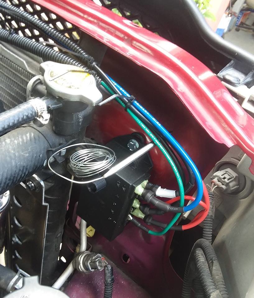

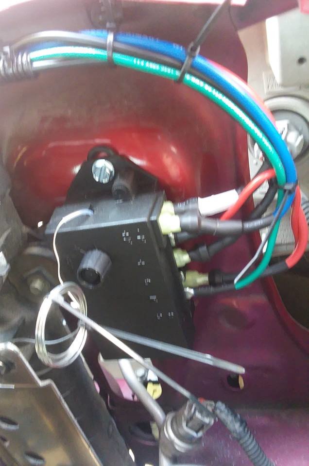

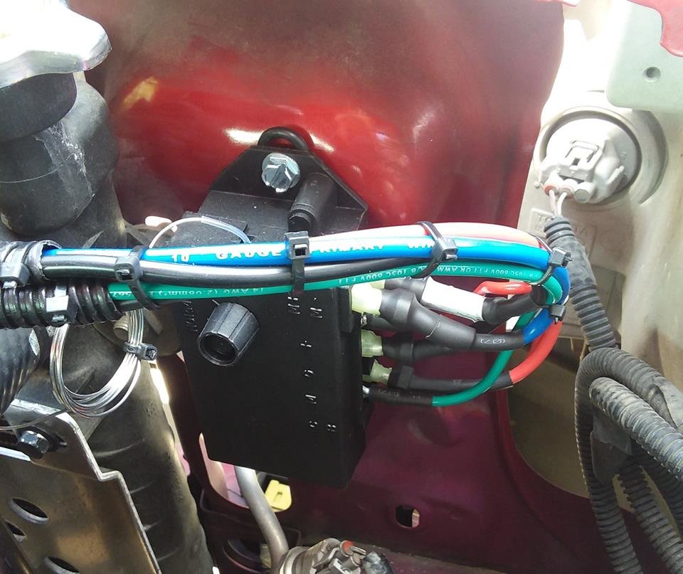

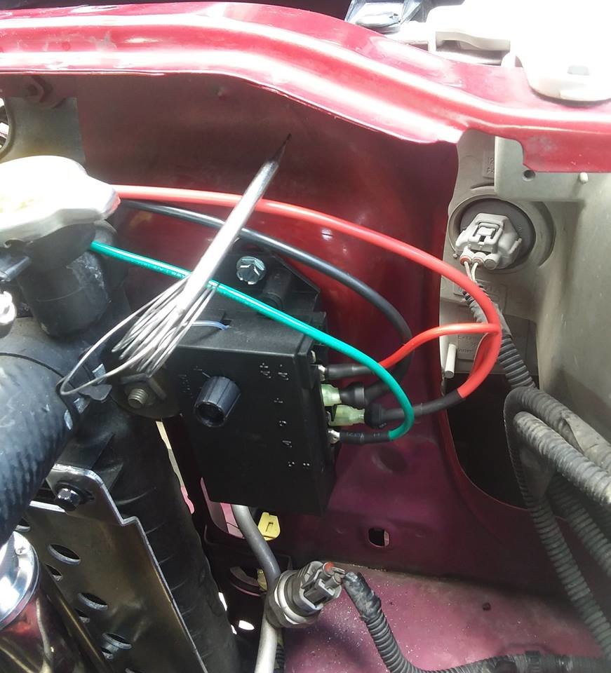

    This is the controller. Given that it has a mechanical thermocouple connection, that doesn't go real far, it needs to be close to the radiator. And, it has an adjustment knob, so accessible as well. I threw in a couple O rings to provide a little mounting cushion.
    40368628_2255976617966083_86440744672422_563a52901b5dad6fd62c1358626fe001b7dfadd4.jpg

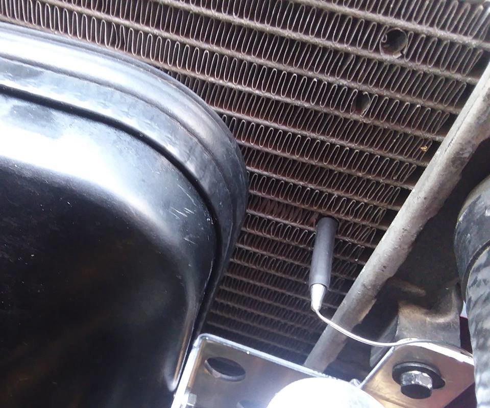

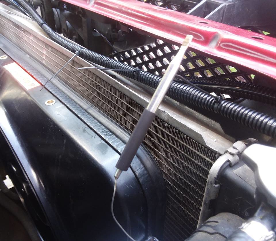

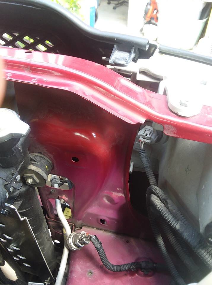

    The thermocouple needs to be near the inlet hose, so passenger side, up on the front looks like the place.
    40221134_2255976161299462_58154751786578_4313daab2c94873e09a65ea81589daad825fa9f1.jpg
    There is room enough, and of course, existing holes are too big, and not in the right place
    40337648_2255976184632793_65258559790729_e06051016ca07376c3031ca87cf3bd4c6e71ca0e.jpg
    So, drill a couple holes, and that is where the controller will reside.
    40352518_2255975061299572_60506391851680_335ebd4f992118d7ab55ff51eb58b0492929ba8d.jpg

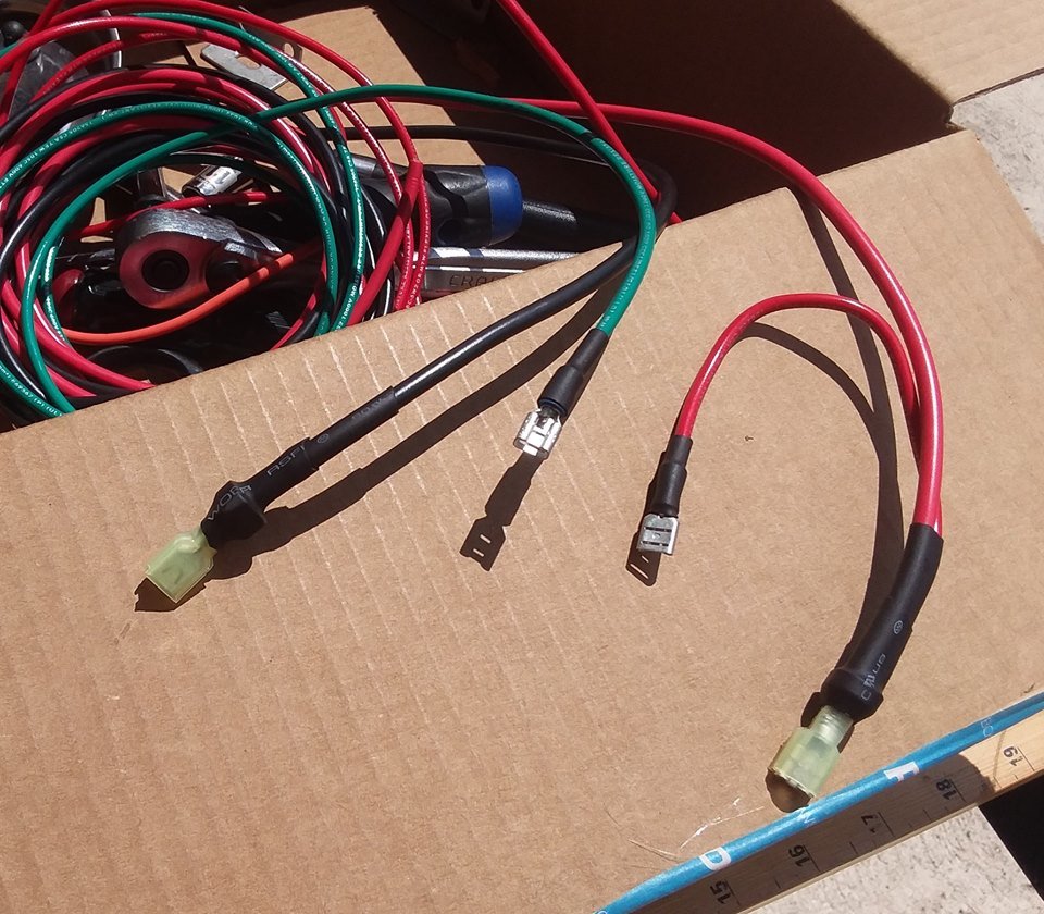

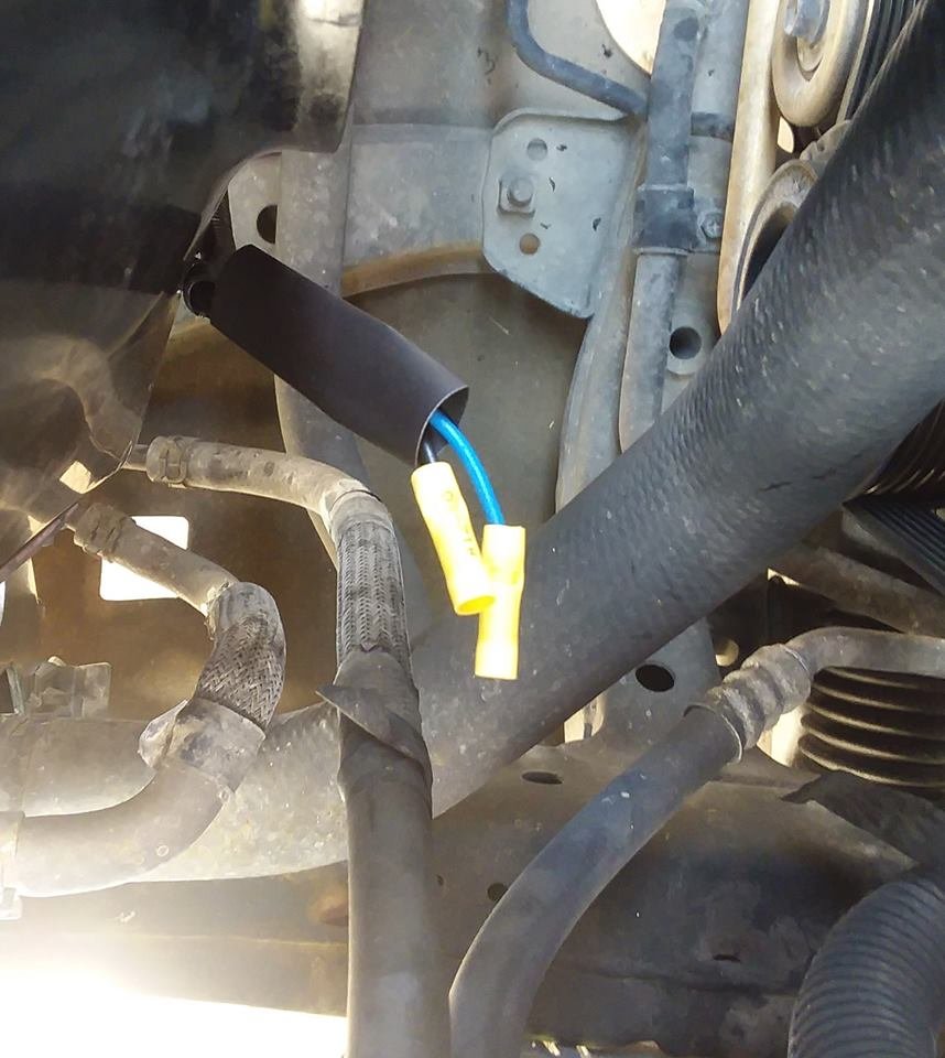

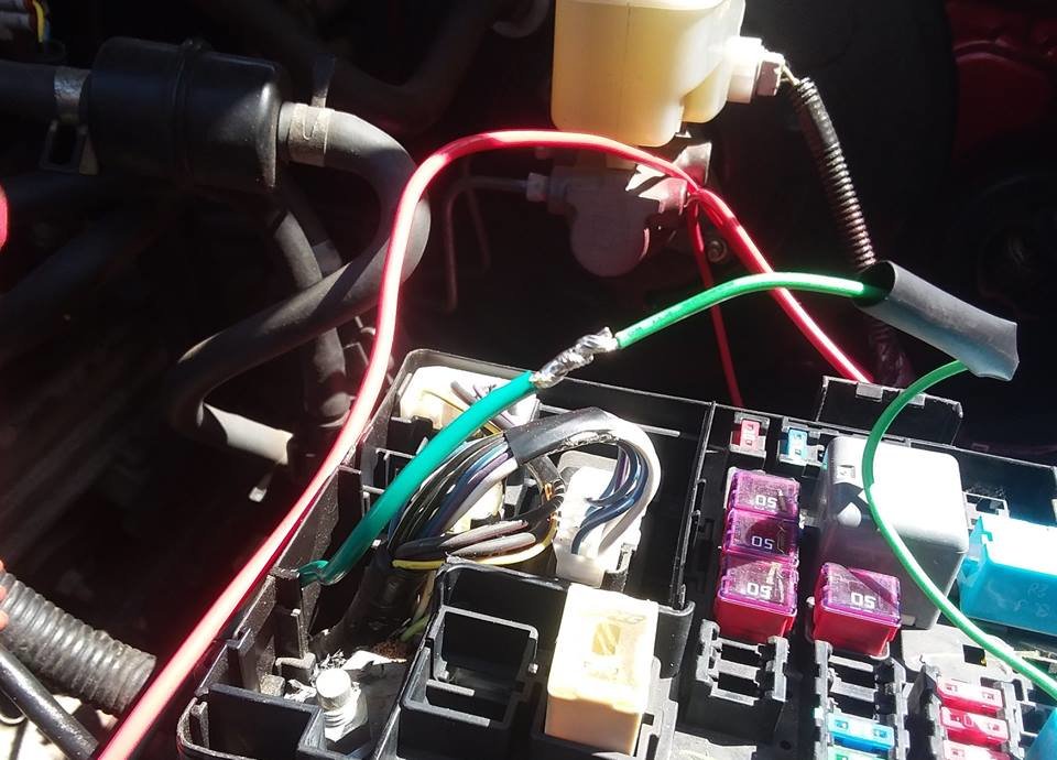

    Crimp and shrink the controller wires. I used a jumper on what can be a "switched" hot, because I want the fan to be able to run after shut off for cool down.
    40287369_2255974994632912_13388238554346_6ac10ae6f74c4f9ddb756785ead4c20bca63903b.jpg
    I like to wire from a known starting point! And everything has to connect to the controller, so there you go!
    40243167_2255975081299570_31141975369785_968687afad0668d91ed218dbacb18b24380730be.jpg

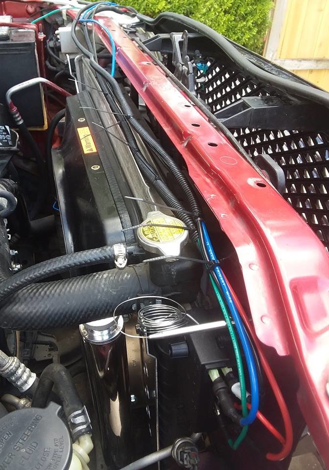

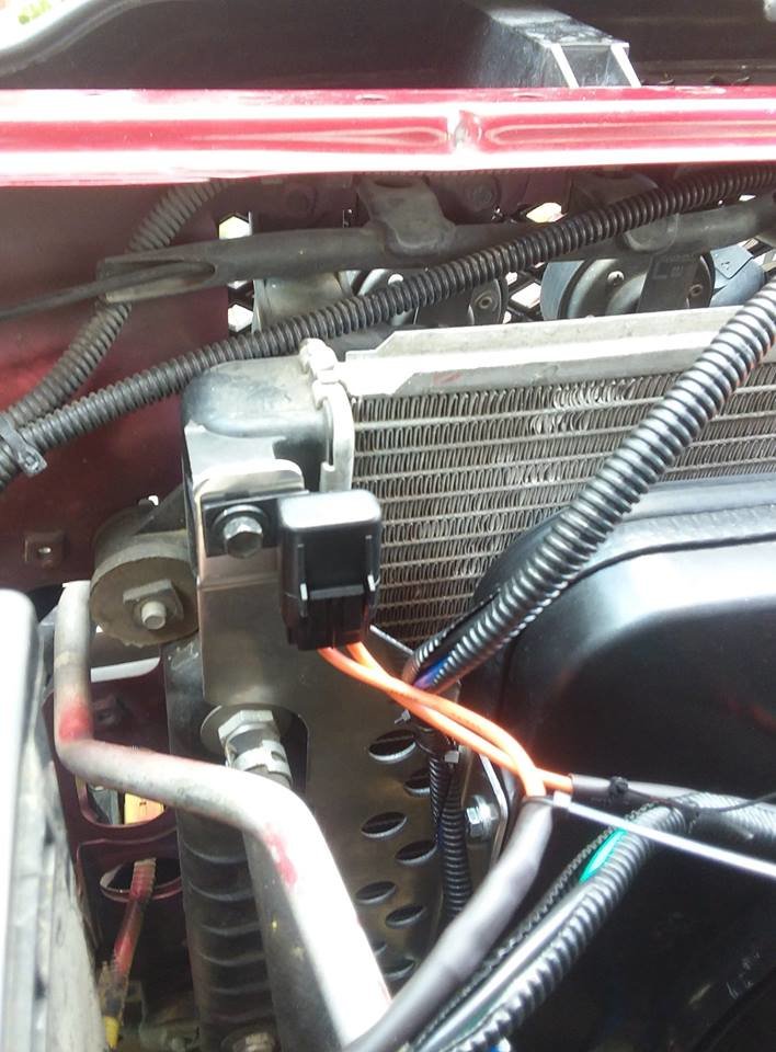

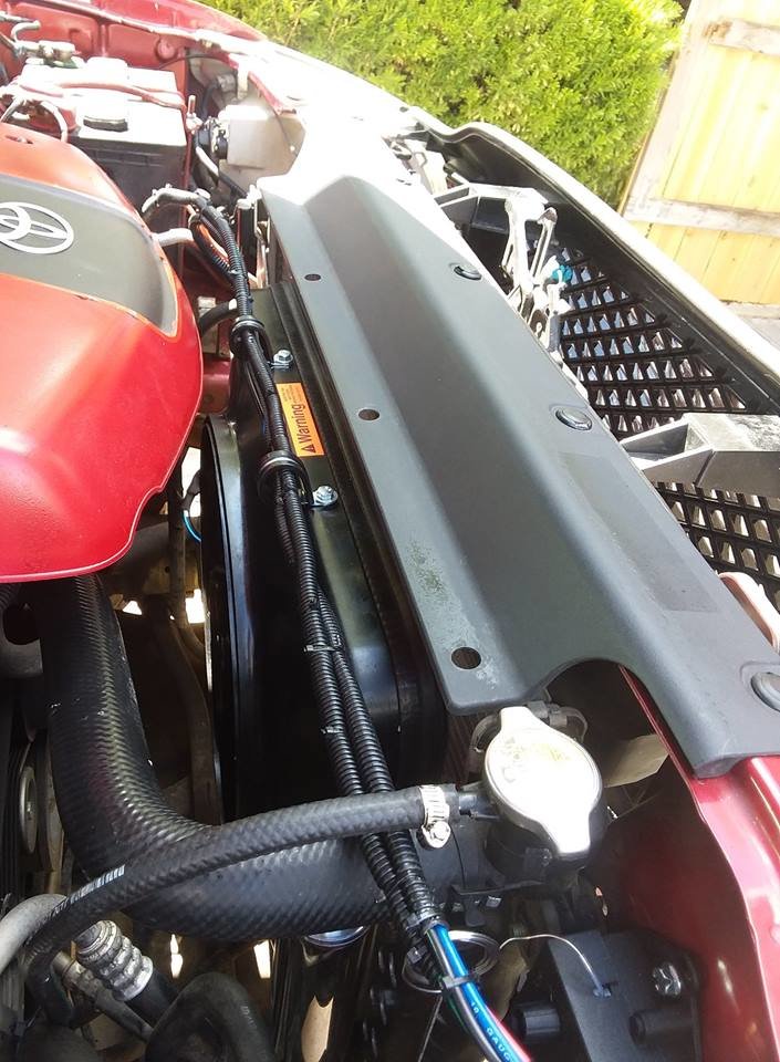

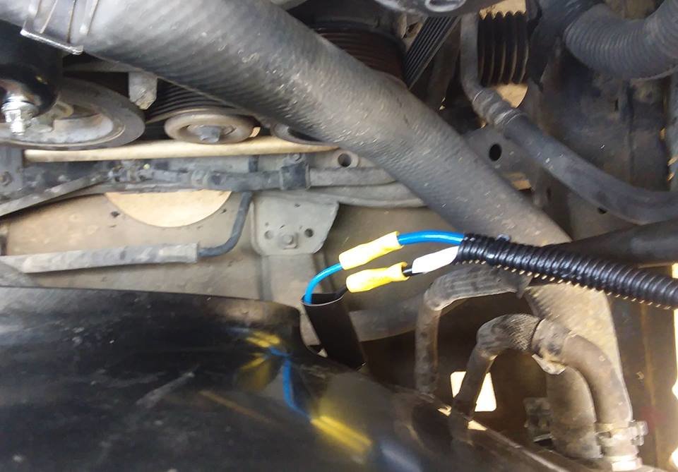

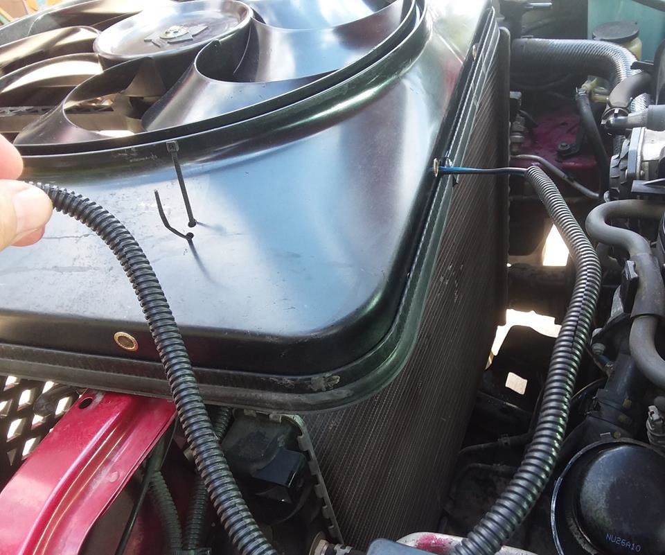

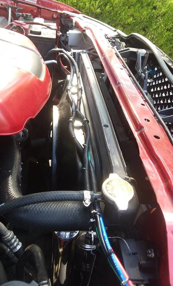

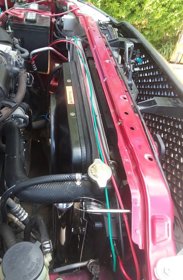

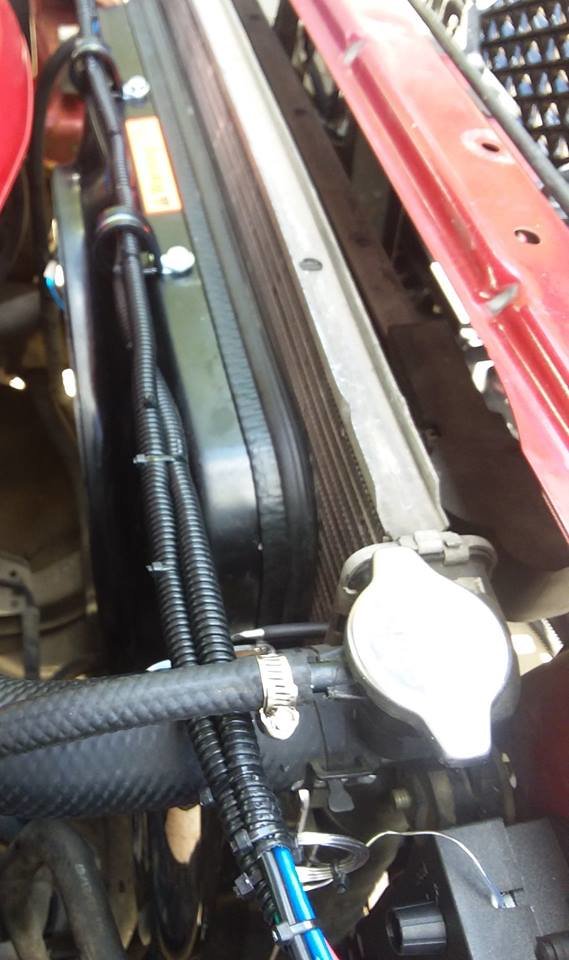

    Routing the wires across the radiator, and over by the battery, shows me that they did not give me enough wire to make the controller to fan connection. So, it's off to the store for some #10.
    40243166_2255975097966235_65026938861655_469521efebb33bc41ce735036ac9c3dee9eb22ff.jpg

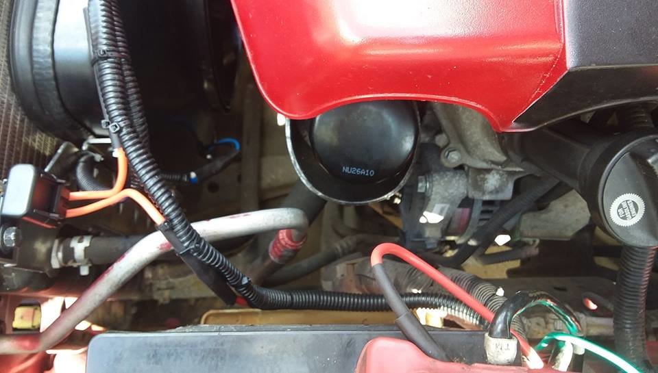

    Since I have about a half mile of 1/2" split loom, two harnesses it is. One for power, one for fan.
    40294500_2255975261299552_45930643931466_c2b1eddf4ab15bc27b6a63a71b1c2608ce396357.jpg
    40122599_2255975194632892_15969567586333_562216202ca1769d7d2eb6320c66b575698dda8d.jpg

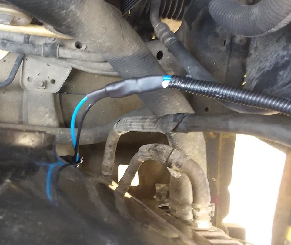

    I really would have liked to use a connector, but the local shops had nothing. So, butt connectors suppiled got used.
    40318533_2255975141299564_60722179297918_407d3cdcc634d7efcf93b926e4a9dfd26f62516e.jpg
    Bottom wires to fan, meet your harness.
    40313648_2255975164632895_57317001665120_2439b3bf33228f0f859f1d482bb449a221e2a89d.jpg
    40198844_2255975254632886_50154901591734_a2767af234a866b7226560b2f9e6a4923363990c.jpg
    I tied off the harness to the top hole in the bracket.
    40205725_2255975391299539_22399211839799_123ce3574247a4bcc75dcae792cbe8238bccfa95.jpg

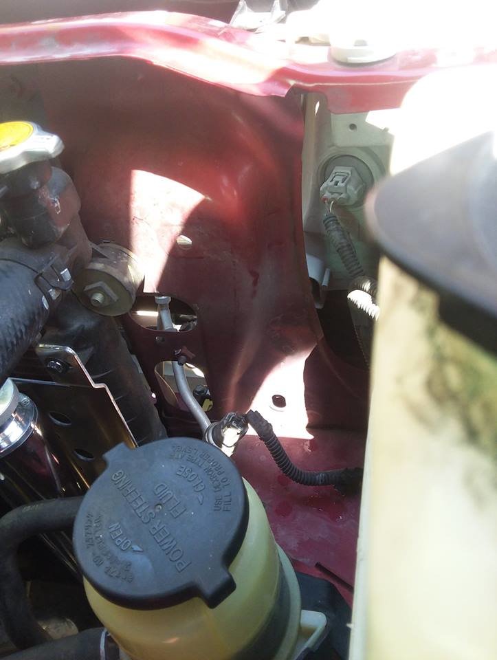

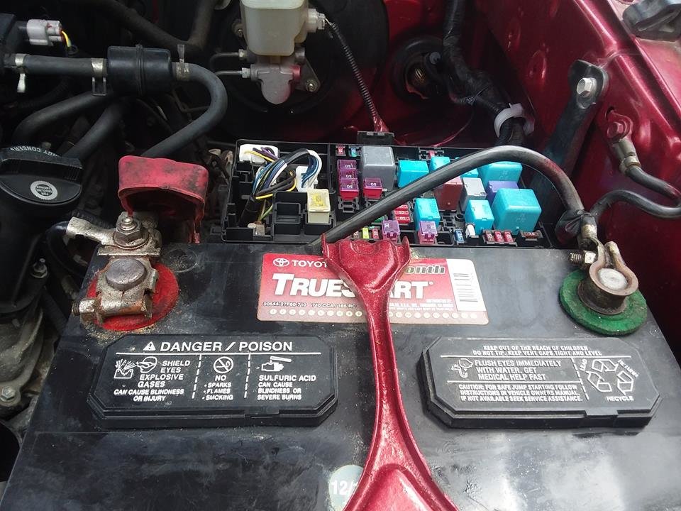

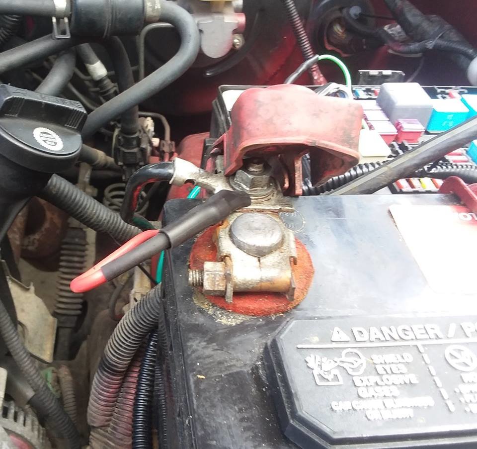

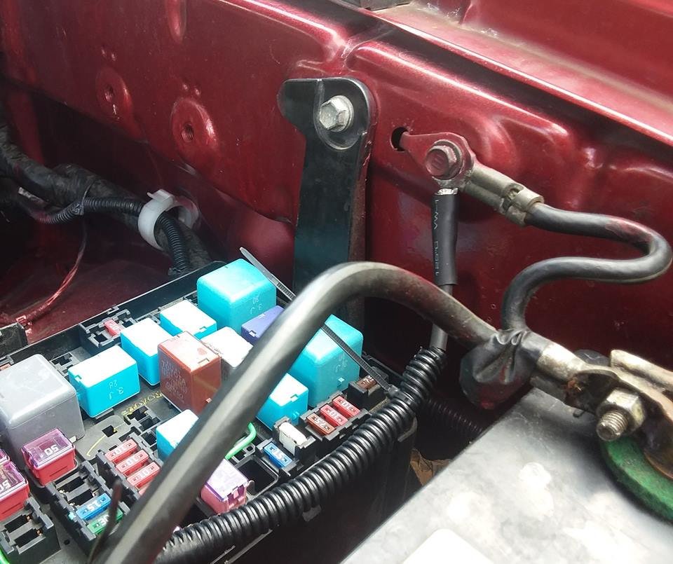

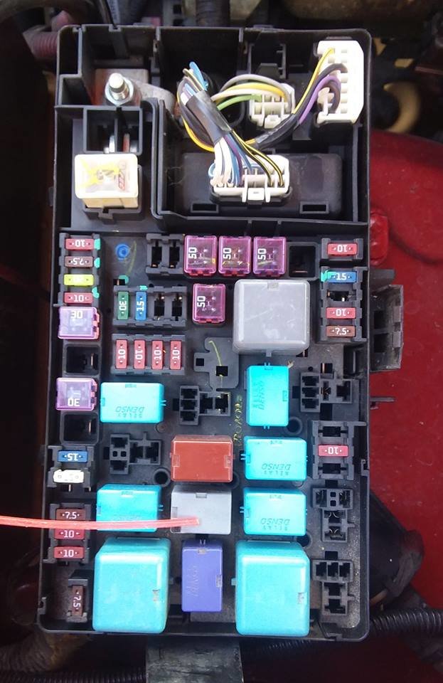

    At this point, I fnally disconnected the battery. The instructions have this as step one! Ha! After this, I wasted a LOT of time searching for a wiring connection for the AC clutch wire. I removed the battery, and completely unbolted the fuse block, hoping to get inside. A Taco forum friend had identified where it was in the block, and I didn't want to go underneath to try and find the compressor harness.
    40219578_2255976664632745_61618041400632_fb71c5a73d7f2ac3fa88e8a9ce00e3dbeb7c545a.jpg
    I put the ground wire (in the harness) under this body connector
    40172402_2255975684632843_70072374383219_9edf721a97ed62a1e3820497368a7b04296c7946.jpg

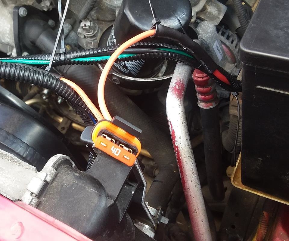

    The positive had an accessory nut on the top, and I grabbed that.

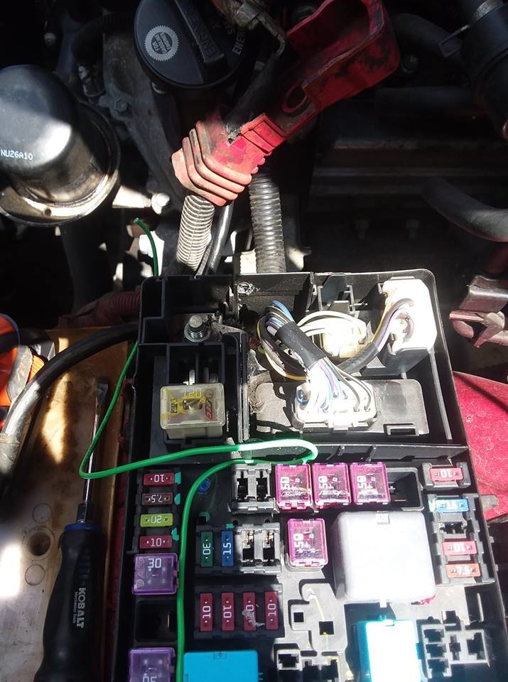

    40237165_2255975601299518_50439288212674_be91f4ed0689e817bc1464e17db29ec433a83464.jpg

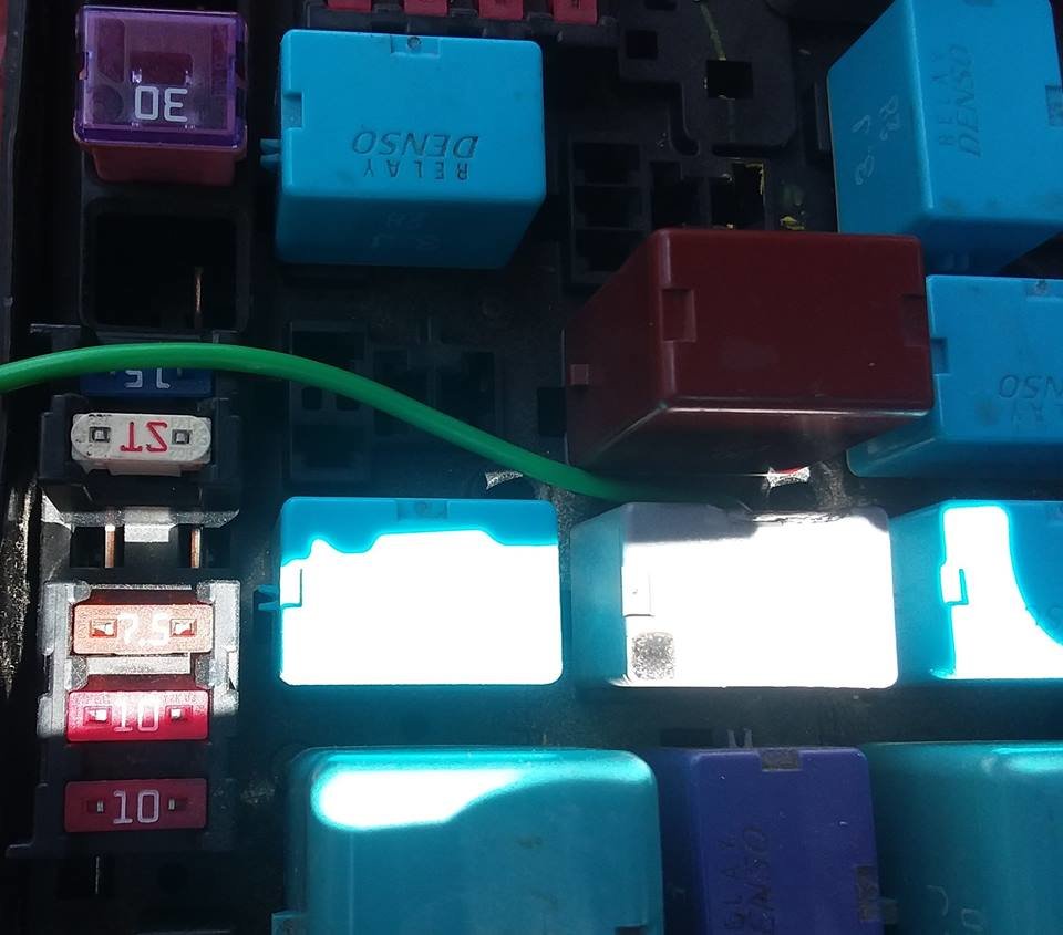

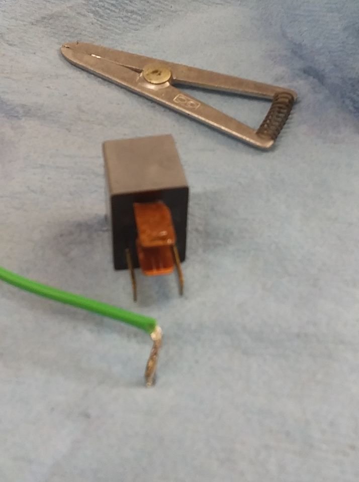

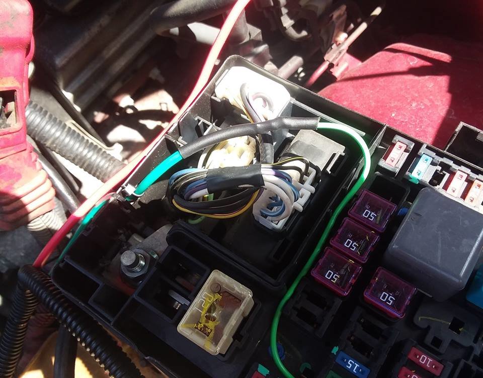

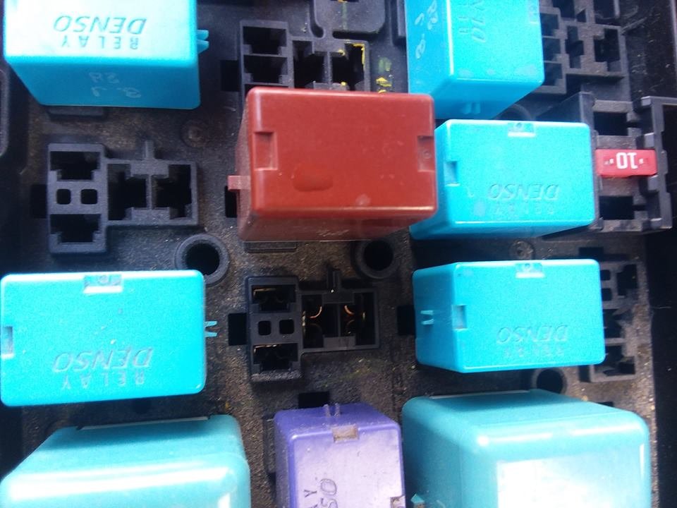

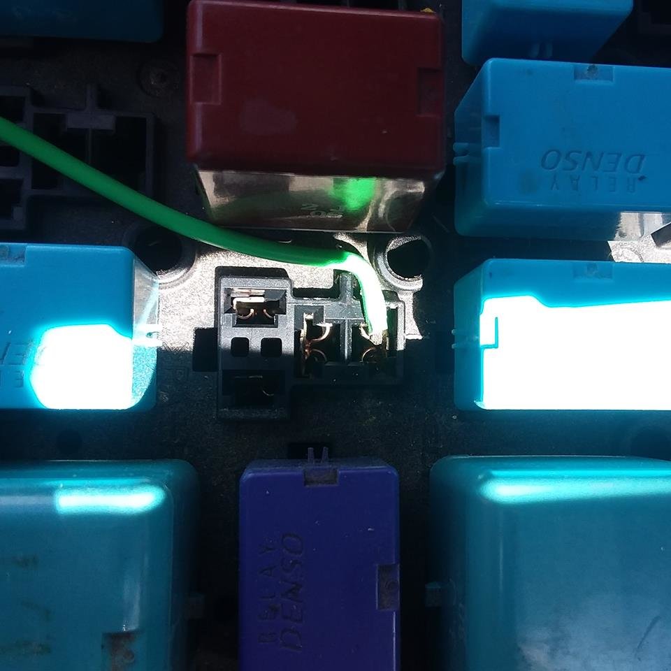

    Now, the Readers Digest version of the AC Clutch wire (to run the fan when AC is on, which is like all the time here, these days) The red wire points to the relay.

    The terminal I need is the right most (vertical) one.
    40314834_2255976727966072_66481555980282_0466aee1ce3b62f519a4320b10591237c01a58e9.jpg
    The relay does NOT like solder to the terminal - So, at least I have a tinned 90 degree wire.
    40253663_2255975314632880_65405344077641_45dccca40db2948b0ac2621fd8f131885d48fd1b.jpg
    Using some needle nose, I got it placed inside the fold of the terminal. The relay tab will keep it in place.
    40332161_2255975364632875_52725110910442_86ec0adae6c79a2e43f66b2fd926b9180b571493.jpg
    40237190_2255975421299536_84054868349262_248ccee854615b26b7dba418107efa1defe2a0cf.jpg
    I drilled a small hole on the engine side for the AC wire.
    40225746_2255976537966091_62109296238075_44d7e40e8070bb8512c076e993ef7450d8615c69.jpg
    And here they meet, and soldered in place.
    40235214_2255975517966193_61885358747796_4b91718f5b20d55c36b60e9a4b8de78f9a1f3db2.jpg
    40138497_2255975467966198_65209599353988_f8651ab5c041d5aa6a130e325d6ccc2147312862.jpg
    And you thought I would forget the fuse, didn't you? No, I wanted is accessible, and the top shroud bolt was just that place
    40240023_2255975627966182_54555449448841_e27d482c21e3750dbd04df6b6e932e19bab00d9c.jpg
    40281994_2255975694632842_16464403095061_565682aded387b31681382bafd67d7754b3523b0.jpg
    This is the thrmocouple that has to go into the radiator.
    40226671_2255975721299506_40478070464000_6809eea6c5d987472cc57f5d82ed2f195d0aafaf.jpg
    The top two, unfortunately, were not accessible from the other side to put the cap on. In place, I heated up some wrap to help hold in place.
    40284174_2255975827966162_87421990896779_ac3a07f46df65897f96ef61cce6588be031704e1.jpg
    At this point, I have everything connected, so it is time to connect the battery, and fire this thing up!
    HAPPY HAPPY HAPPY. Runs with the AC on, not with it off, runs with the temp control. Runs after turn off for cool down. It is quieter, and AC seems a little cooler.
    40259667_2255975764632835_23647772490743_6afef2a9430fa67ed51147cb98b0bf4fa6610690.jpg
    I didn't want the harness to sit on the radiator core, so I brought the wires
    between the hoses, and used the two "extra" nut-serts on the shroud top.
    40253636_2255975871299491_30178403537146_5855d0a54eccca5a4bcf6094743a6c44fb341b7d.jpg
    A couple insulated clamps hold the harness away from everything.
    40358058_2255975937966151_72724949621203_73f25c572c0536ba36f66b7e7503200218d9ba8d.jpg
    40245339_2255976074632804_50734585296086_a03ed1df5d841e01534552c7e980ba6853181537.jpg
    Final harness tie off. The adjustment knob is easy to get to.
    40236447_2255975981299480_44633032563569_3e94b604a07b97a890467dc52b201b85201a1ccf.jpg
    On the battery side, the harness stays OFF the trans cooler pipe.
    40244675_2255976061299472_56241130310436_522273fe71b788ceff13567f02b6e287756529e4.jpg
    And last, the shrould cover goes back on, even though the back doesn't hit anything. It will keep you from touching the top of a hot radiator!
    40141216_2255976127966132_34159707352884_377c4dd36492c42e23779404f9621015b2d6ca43.jpg

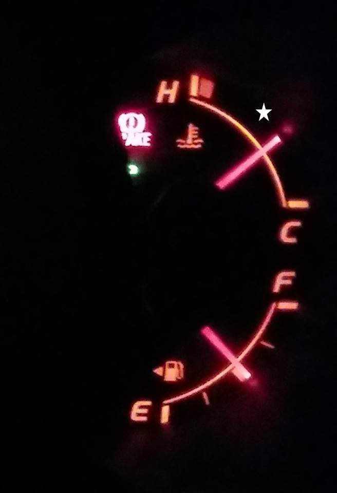

    I don't have a photo editor that I really like, but the STAR shows where it normally ran, versus where it was after I warmed it up last night. So, it does run cooler.
    40397897_2256078521289226_44405271135057_c8a210cb8c697f834081721e8dec13d99221bbd7.jpg

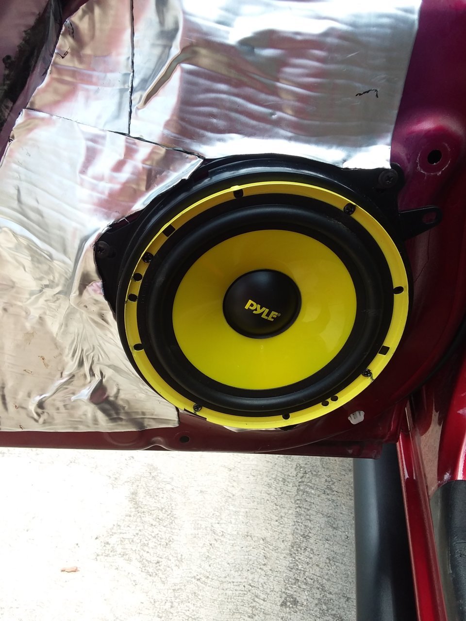

    This is the combo I ordered. 6x9" multi-speaker and tweeter with crossover for up front", 6.5" in the back.
    So take the skin off, and I'm sure most of you know this, so only once..... handle screw, door pull screw, little button fastener (of course mine was a crap replacement), and sail panel. Oh yeah, the sail panel on the back of the door/window, the door lock/window control (from the front). Then yank.....
    So, what do we find after that? That someone made a pressboard adapter, to stick a fairly good speaker (I might still try), and used TWO dang screws to attach it. ONE of which was still attached and the pressboard was devil dead from moisture. (New yellow, old silver)
    I put new wires in for the speaker, and started the insulation after an alcohol spray and clean of the inside. I decided I am going up to the mid belt supports - halfway up. Since the Press and Seal is 6" wide, that was basically 3 strips, 32" long. Later, I cut them in half (lengthwise) to more easily install. Both ends of a plastic shot hammer did fine to mold stuff...
    Dang, this is only the first speaker, and it's been all afternoon. That "adapter" really sucked, but I soldered new wires and shrinked them up for the new speaker. @hoverlover came to the rescue with some speaker adaptor dishes that I met him for on Thursday afternoon. THANKS @hoverlover (He already drank his beers!) So, I know I will be back to that door, now on to Driver Front. Pop, pop, fizz, fix!
    Well here we are - what have we got? MORE F'd up shit!!!!! Two screws left in place, two treads hanging on. I would discover that the "adapter" was actually a gutted speaker and its mount. No way to even mount my new 6x9 without being equally CRAP>
    Old and new
    Mount it? Yes, I had to butcher the adapter @hoverlover gave me because it was for a 6", not a 6x9". Crude, but I love having some tools.....
    So, we're off to the peel and seal... and will get back to actual speaker install. I cut up both sides and sanded them smooth somewhat, so they are ready to go... Again, up to the mid-belt reinforcement.
    Oh, it should be easy, this "fits your truck". LOL
    Tweeter time. Here is what I got - one piece - and what they gave me (smaller). Had to sabre saw the speaker frame off, and then epoxy the new ones into the old frame! Nothing to it.....
    Meanwhile, back in the door! Wrap up outside, and remember to put the crossover in! The peel and seal works great for mounting this.
