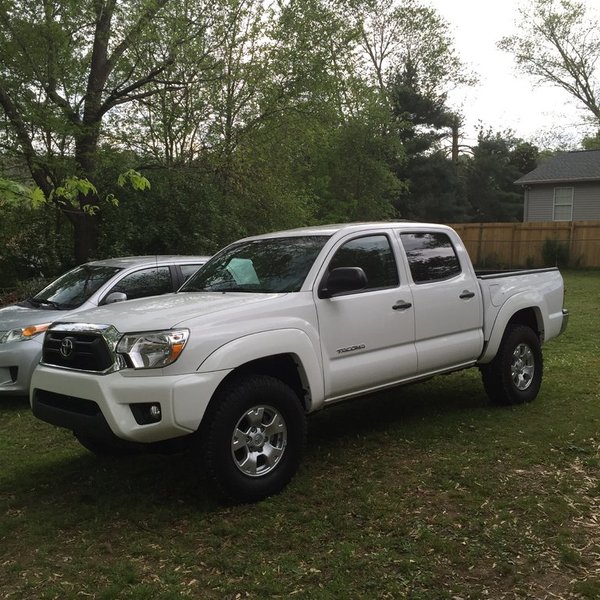

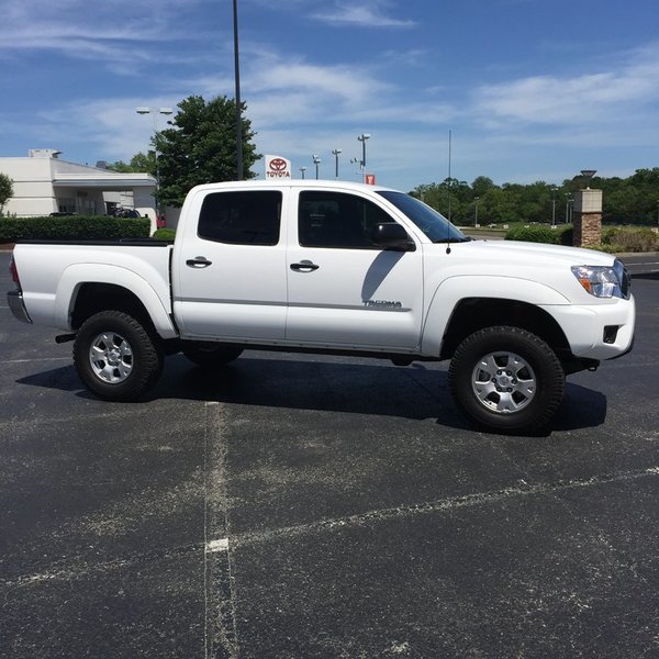

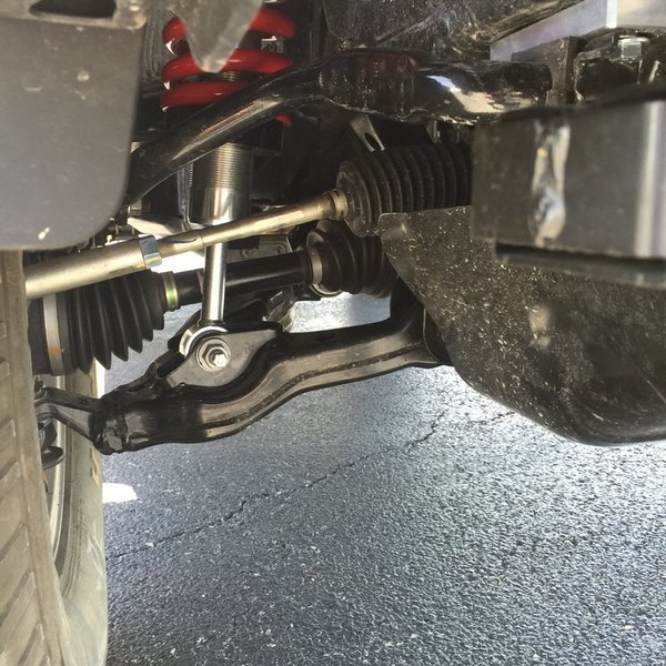

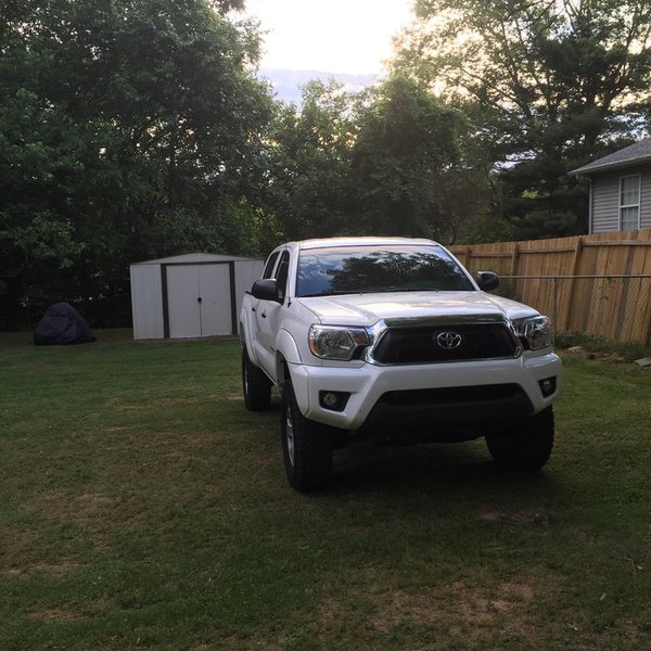

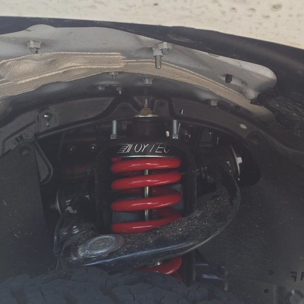

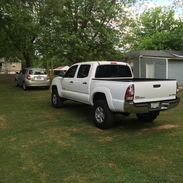

    Hey TW, I decided to start a build thread for my 2015 Taco SR5 4x4. It's probably going to be a kind of slow go for a while. But I'm pretty dedicated to turning it into semi overland/off road 4by. So far I've got the Toytec Ultimate Lift Kit with Billy 5100's, Eibach springs, and Toytec AAL with Diff Drop. This weekend I'll be doing my rear diff breather relocate which might turn in to a full scuba mod. Anyway, here's some pictures. Thanks for looking.IMG_0061.jpg

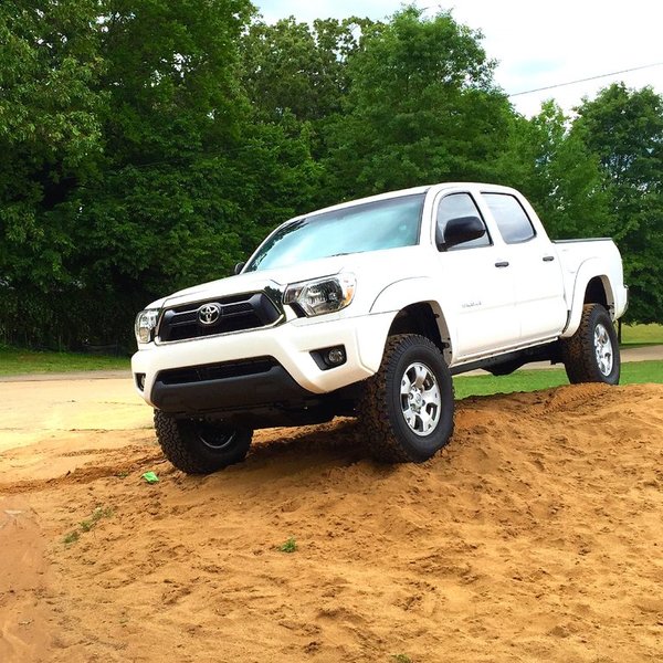

    Here's the stock truck with BFGoodrich All-Terrains in 265/75r16 after a bath
    And the truck after picking it up post lift installation (5/20/15)
    Front coilover. Went with red Eibach springs for the TRD look. Staying with stock UCA's for now. Alignment specs at the bottom of this post.

    Here's my CV angle with the diff drop kit
    The front end in the back yard
    Left Rear

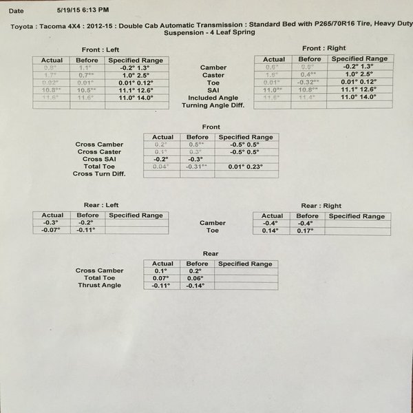

    Alignment specs from the Toyota Prep and Design team at Toyota Knoxville
