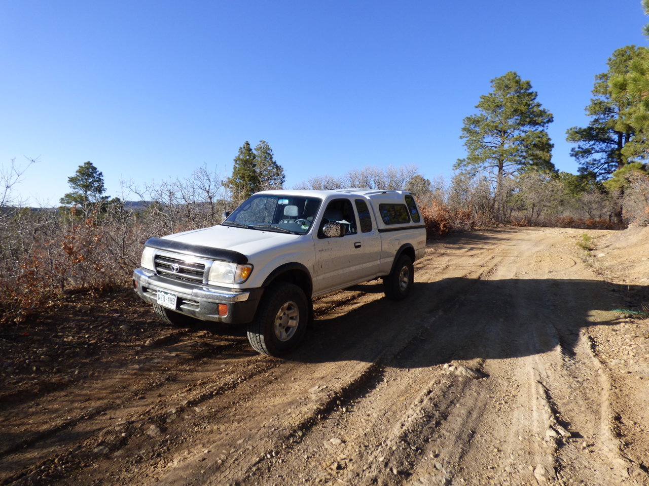

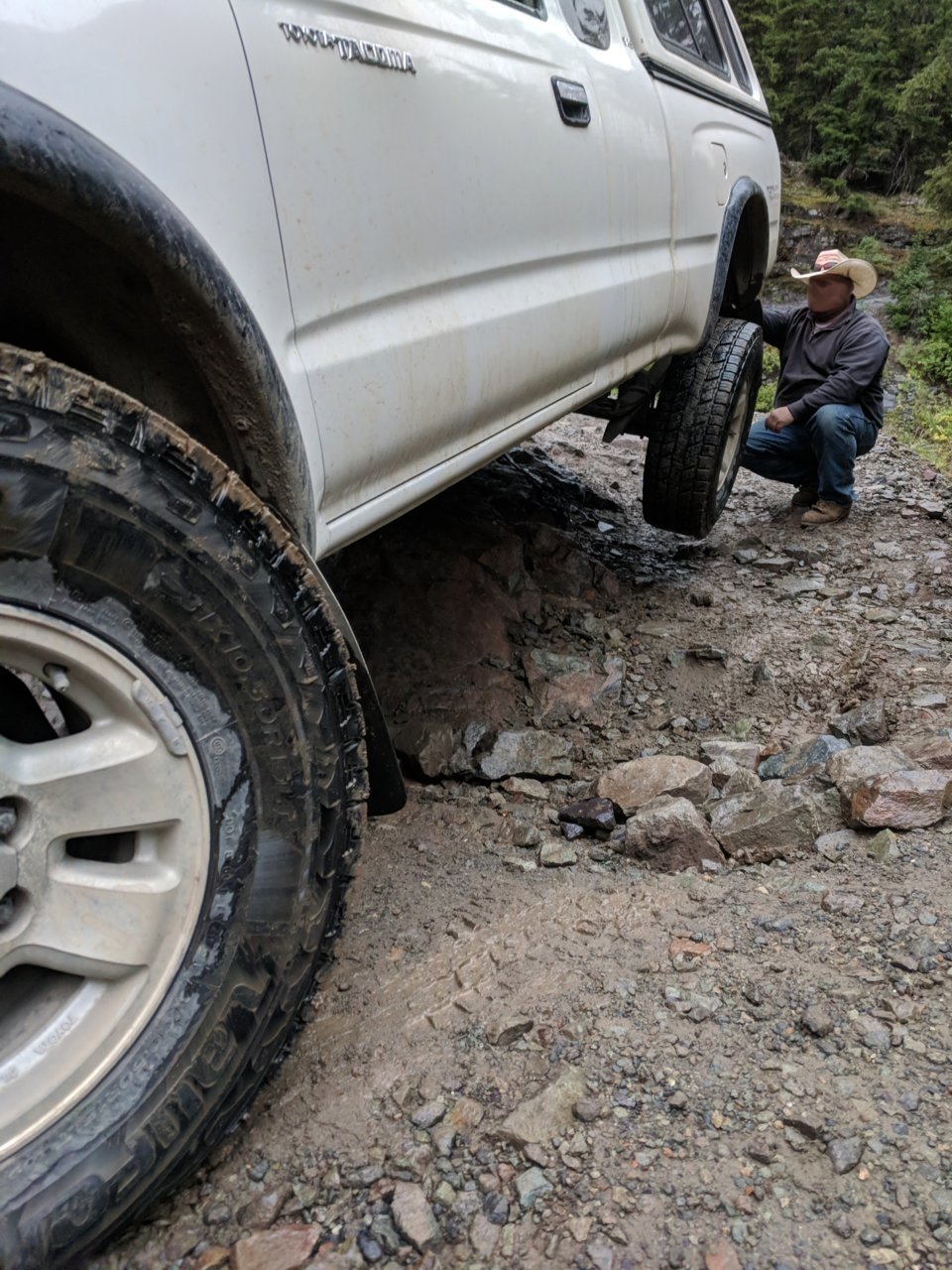

    4/11/17- The First Excursion- Echo Basin
    With a little maintenance out of the way, I felt comfortable taking the truck out to test it's off-road capability on some mild trails. Most trails local to me were still closed for the winter, but I found one that wasn't and headed out with a friend, who for some reason started calling the truck MG, which stuck.
    I was surprised at how well the truck did, especially on near bald 235/75R15 Yokohama Geolanders. Granted, the trail was pretty mild, but I did encounter some deep mud that I had to engage the rear e-locker to get out of. All was good, and I decided to head back home. That's when disaster struck. I was off the rougher trail and on a graded dirt road when I accidentally hit a pot hole and heard a loud popping sound. I pulled over and found this.
    The passenger side front shock had pushed up through the mount and was now touching the top of the fender well. So much for the newish front shocks the previous owner had put on. I limped it back home and ordered a cheap stock height Monroe Quick Strut to get it back on the road. Link: https://www.amazon.com/gp/product/B002NETMZU/ref=ppx_yo_dt_b_asin_title_o05__o00_s00?ie=UTF8&psc=1

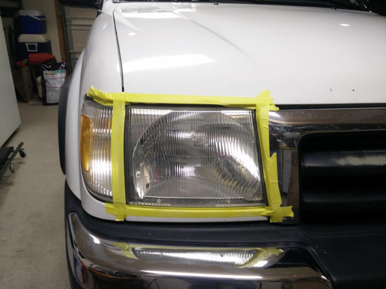

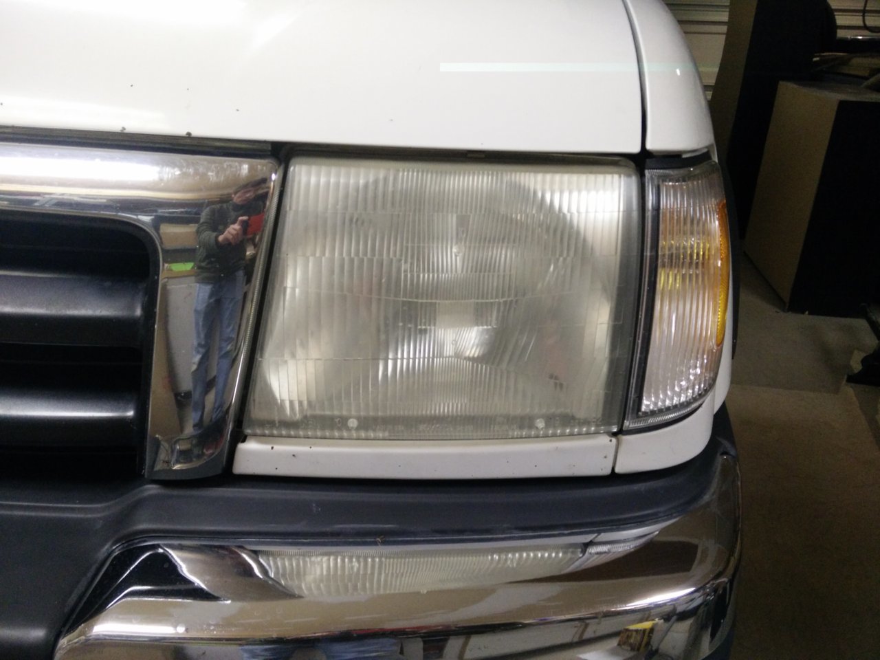

    My headlights were extremely hazy and yellow, so I decided to restore them. I used this Turtle Wax kit, which worked pretty good. I was impressed with the results. https://www.amazon.com/Turtle-Wax-T-240KT-Headlight-Restorer/dp/B001TI5IIQ
    Before:
    After:

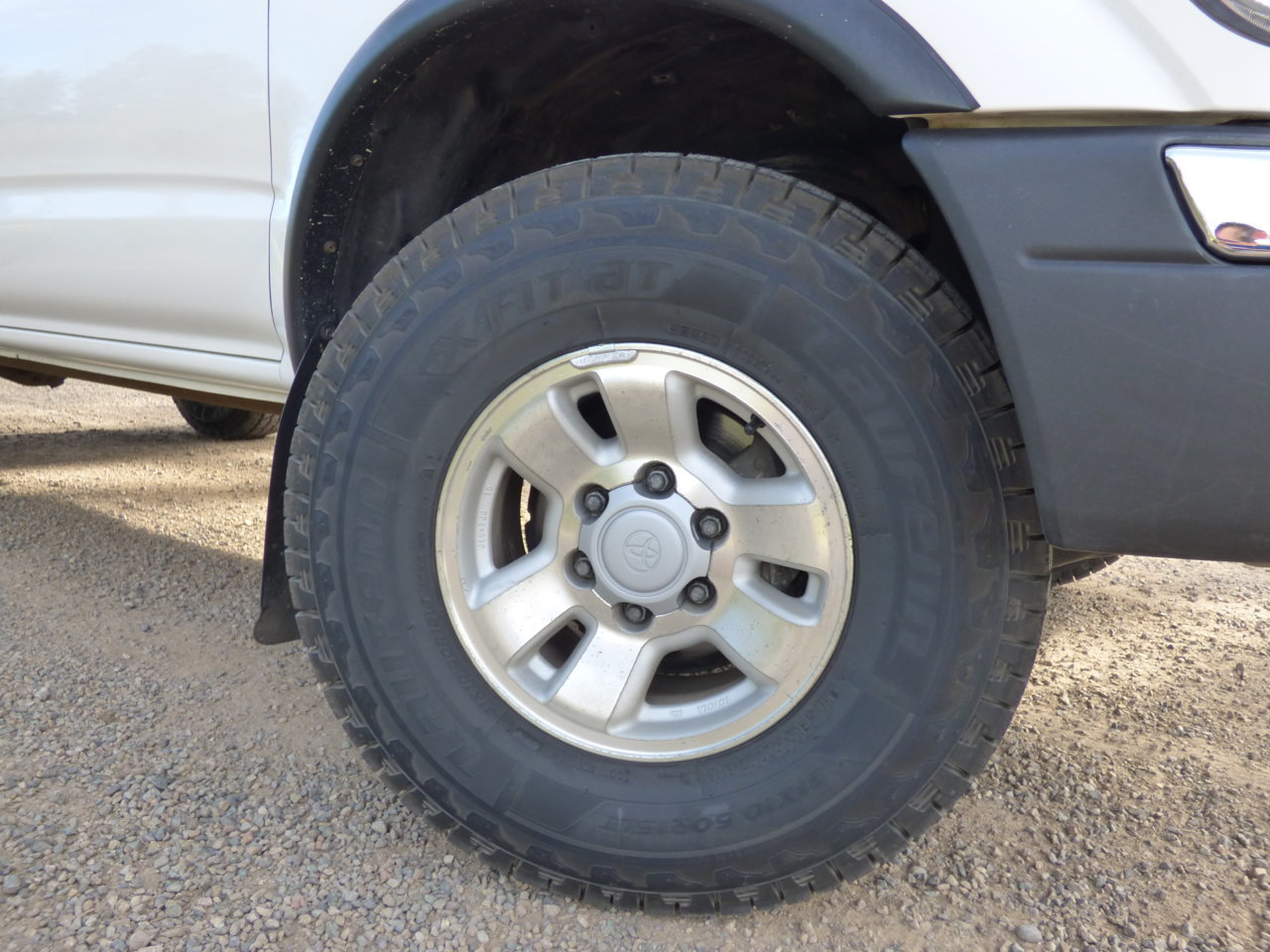

    6/5/17- New Tires
    Next, I made the decision to get new tires. The badly worn 235/75R15 tires that came on the truck when I bought it were't cutting it and they looked too small. I chose to go with 31/10.5R15 Laufenn X-Fit A/T's. They were affordable, fairly aggressive, and I knew several people that had them on their vehicles and were impressed with them. Plus they were the size that came on the truck from the factory and would match my spare. I got them from a local tire shop that my friend worked at and he was able to get me the employee discount, so I ended up spending about $400 mounted and balanced.

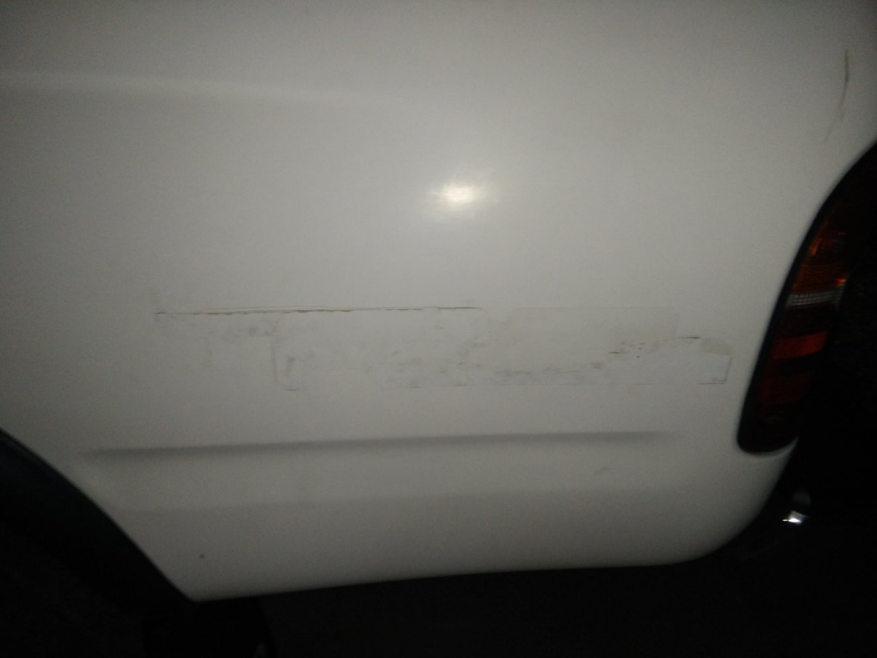

    6/12/17- Painting the tailgate
    The paint was worn off of the top 2" of my tailgate due to the camper shell door rubbing on it. I took the tailgate off the truck, grabbed a can of truck bed liner, and went to work.
    Before:
    After:

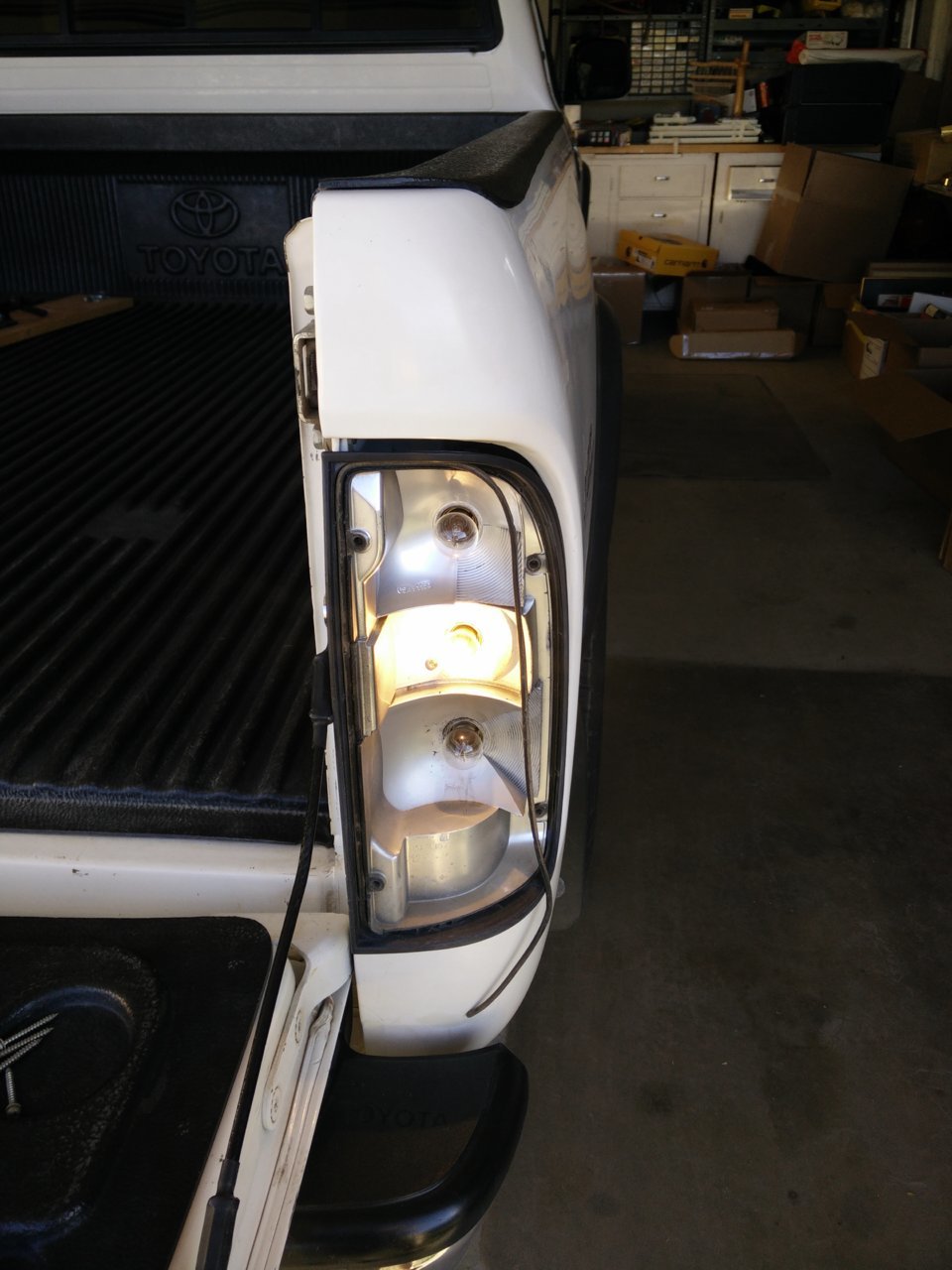

    6/19/17- New reverse light bulbs
    Next, I replaced the stock reverse lights with LED's. I have a very long driveway and I could barely see backing out at night with the dim stock bulbs. I got some cheap ones from Amazon and they are significantly brighter.
    https://www.amazon.com/gp/product/B017386GLS/ref=oh_aui_detailpage_o02_s00?ie=UTF8&psc=1
    Before:
    After:
    Also did some maintenance during this time period. I replaced the PCV valve (just because), replaced a squeaky idler pulley (https://www.amazon.com/gp/product/B000C2YA6G/ref=oh_aui_detailpage_o05_s00?ie=UTF8&psc=1), and did another drain and refill of the automatic transmission fluid.

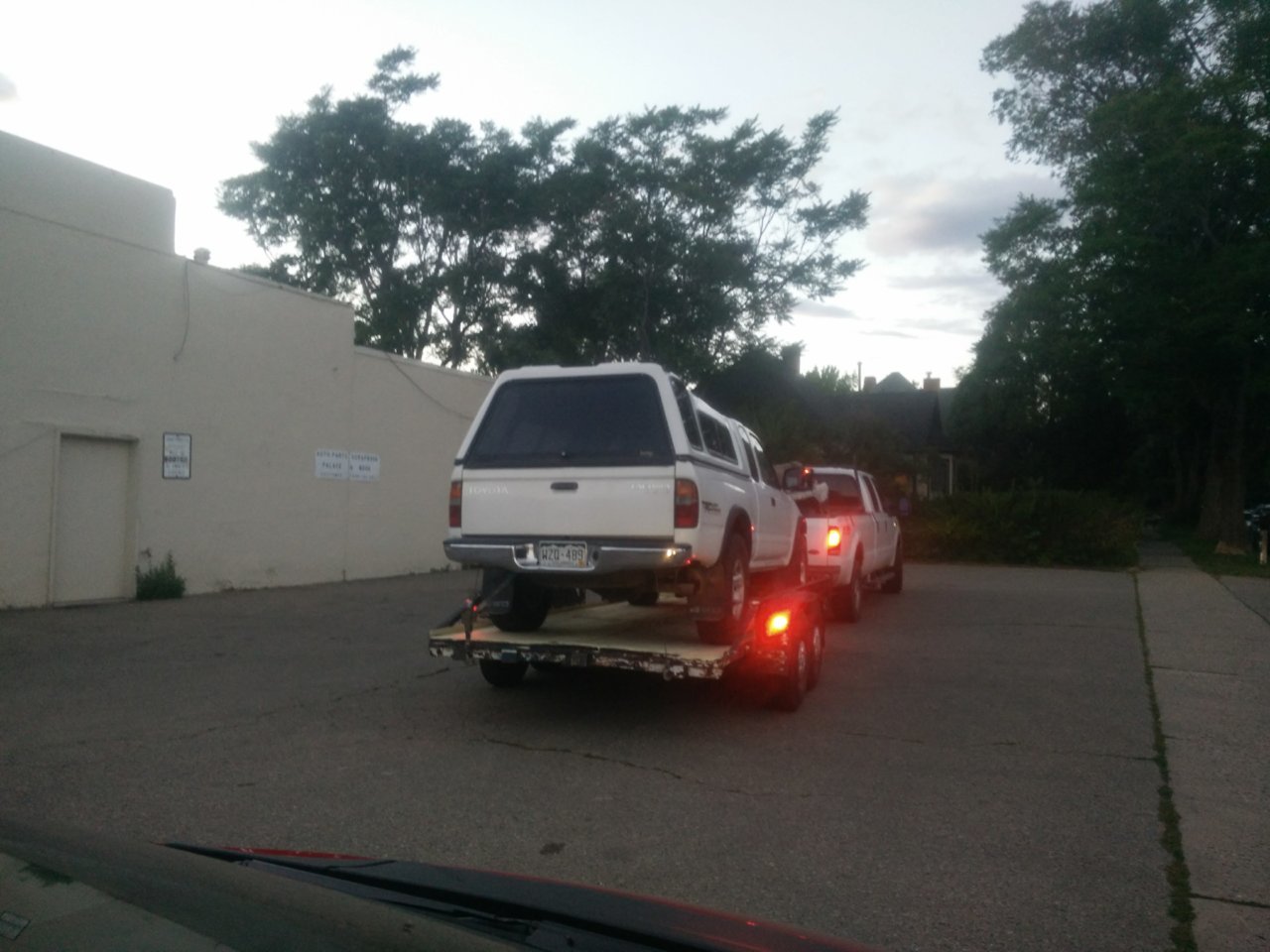

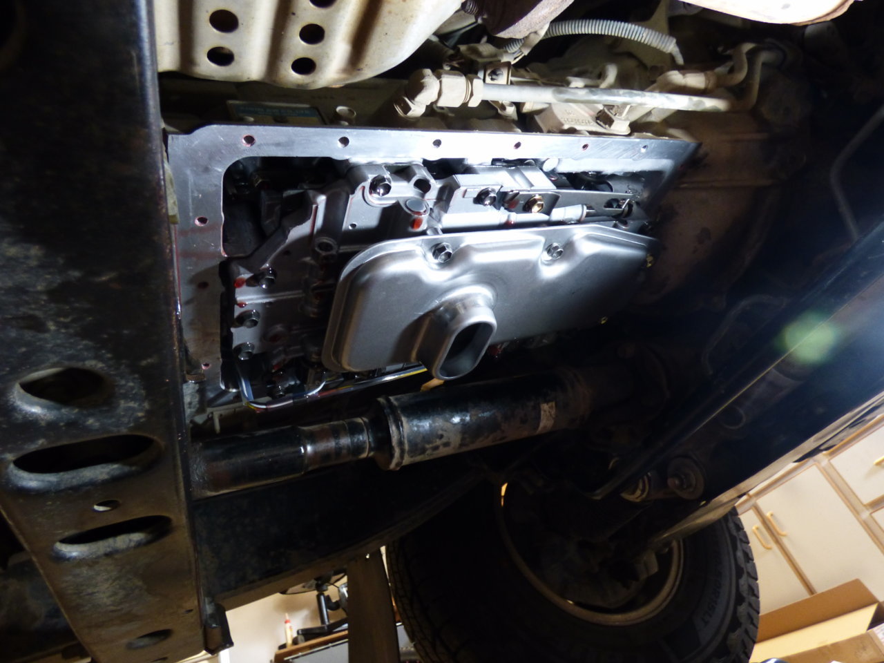

    8/17/17- Oh no what was that noise- a strange transmission issue
    I was out running errands and stopped at my bank. When I got in my truck to leave, I put it into reverse and heard a loud metallic ping sound. I put it back into park and then into reverse again. Ping. Figuring the noise was transmission related, I popped the hood to check the transmission fluid. I pulled the dipstick and only 3/4 of it came out. Great. The bottom 1/4 of the dipstick had sheared off, fell into the transmission pan, and was now rattling around whenever I put the truck into gear. Not wanting to risk the dipstick doing any damage to the valve body of the transmission, I called a friend and loaded the truck onto a trailer and towed it home.
    At this point, I was about to start my first semester of college, so I parked the truck and used my other vehicle, a 2006 Honda CR-V, to commute for a couple of months until I could get around to dropping the pan to remove the dipstick.

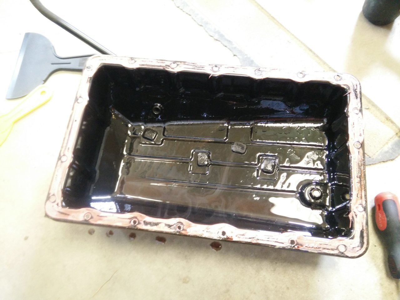

    9/23/17- Replacing the trans dipstick and filter
    I finally got around to ordering a new transmission dipstick from Toyota. I figured while I had the transmission pan off, I might as well replace the filter as well. So I ordered a new filter from RockAuto as well as some Toyota FIPG to reseal the pan. Getting the pan off was pretty easy, but the hard part was scraping all the old FIPG off the pan and the transmission itself. I used a plastic tool and some acetone so as to not damage the mating surfaces. The inside of the pan was pretty clean, and the magnets had what I would call a normal amount of clutch pack material on them. Filter looked pretty good as well, but since I had the new one, I went ahead and replaced it anyways.
    All clean:
    All was going well, I applied the new FIPG to the pan and got it torqued down to the transmission. Then everything went downhill when I went to put the drain plug back it. Started tightening it and the bam, the plug strips out. Wouldn't tighten or come out. Luckily the FIPG hadn't set yet, so I quickly removed the pan and drilled the plug out. I was hoping only the threads on the plug itself were ruined, but to my misfortune it was the threads on the pan. So I cracked open my tap and die set and tried to re-thread the pan, which didn't work at all. Angry and irritated at this point, I went inside and ordered a whole new pan and drain plug from Toyota. Expensive, but problem solved.
    10/1/17- Installing new transmission pan
    The new pan arrived on 10/1/17, so I installed it, waited for the FIPG to set up, and filled the trans up with fresh fluid. It was nice being able to drive my truck again after having it parked for almost 2 months, plus the transmission felt like it shifted smoother as well.

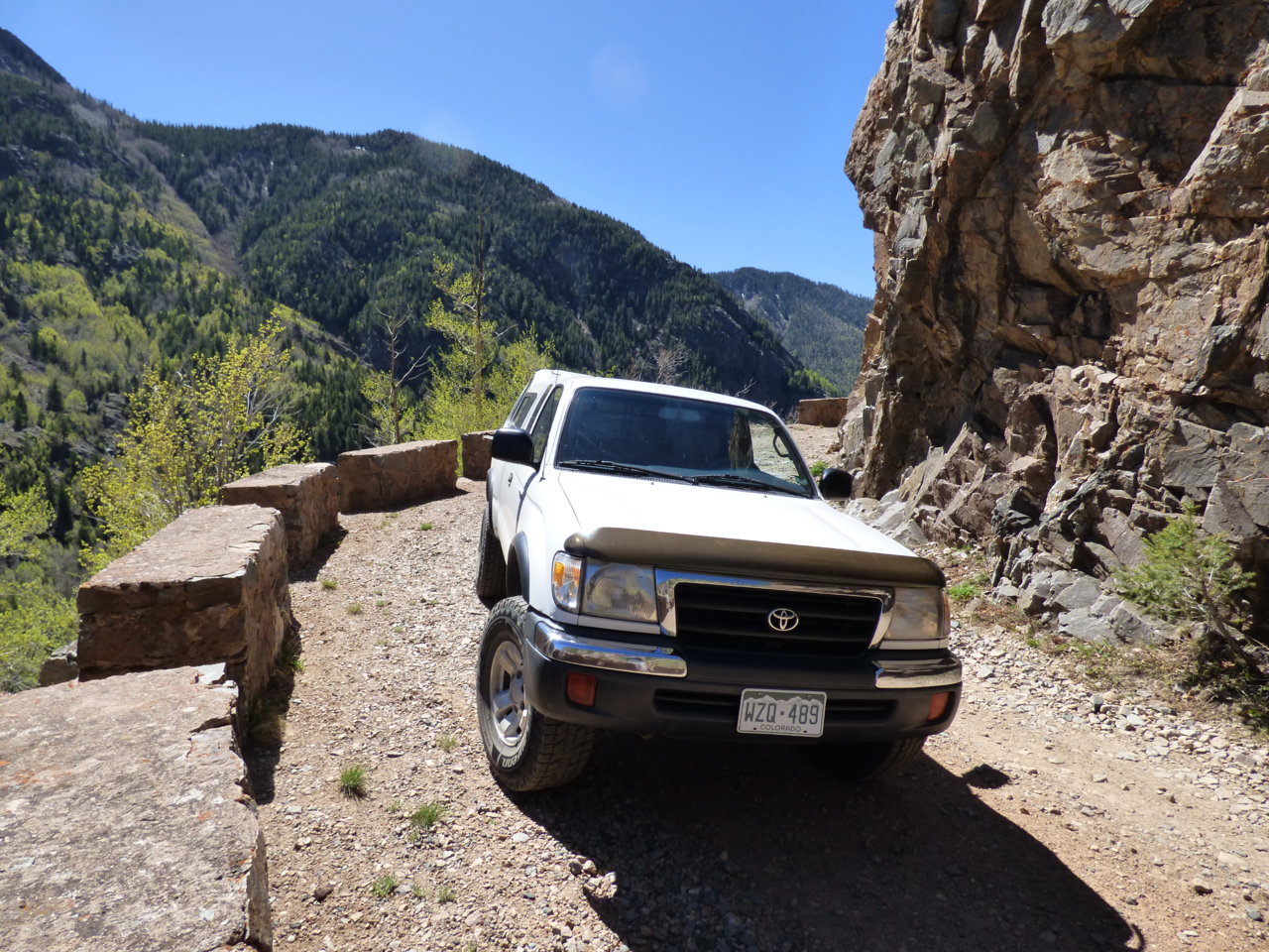

    10/7/17- La Plata Canyon- Kennebec Pass
    After getting the truck back up and driving after the minor transmission issue, I decided I wanted to do a little wheeling as I hadn't done much since I bought the truck. I chose to head up La Plata Canyon and Kennebec Pass, a relatively easy but fun trail local to me. Kennebec Pass, despite the name, is not actually a pass. At one point it was, but now it just dead ends at a notch that was blasted in a ridge. The views from this point are quite spectacular, especially with the fall colors. The trail/road itself isn't terribly rough, just a little rocky. The worst section is leading up to the "notch", where it turns into a shelf road just wide enough for one vehicle and is peppered with loose scree. I went with a few friends, one of which brought his Lunar Mist 1st gen Double Cab with an ARB front bumper. The truck did excellent, just threw it in 4hi on the way up and 4lo coming down so I wasn't riding my brakes the whole way.
    The lack of engine breaking off-road is my main issue with the automatic transmission. 1st gear isn't quite low enough, so you have to resort to using 4lo to slow the truck down on steeper slopes. I took my father's 96 5-speed Tacoma on this exact trail the previous summer, and I was able to use 1st gear and 4hi to maintain a slow speed on the way down.
    Warning: This post is picture heavy. :D
    The notch can be seen above and behind the trucks:
    Looking east from the notch:
    An old, sealed up mine shaft we encountered on the east side of the notch:
    Looking west from the notch:
    More Tacoma pictures inside the notch:

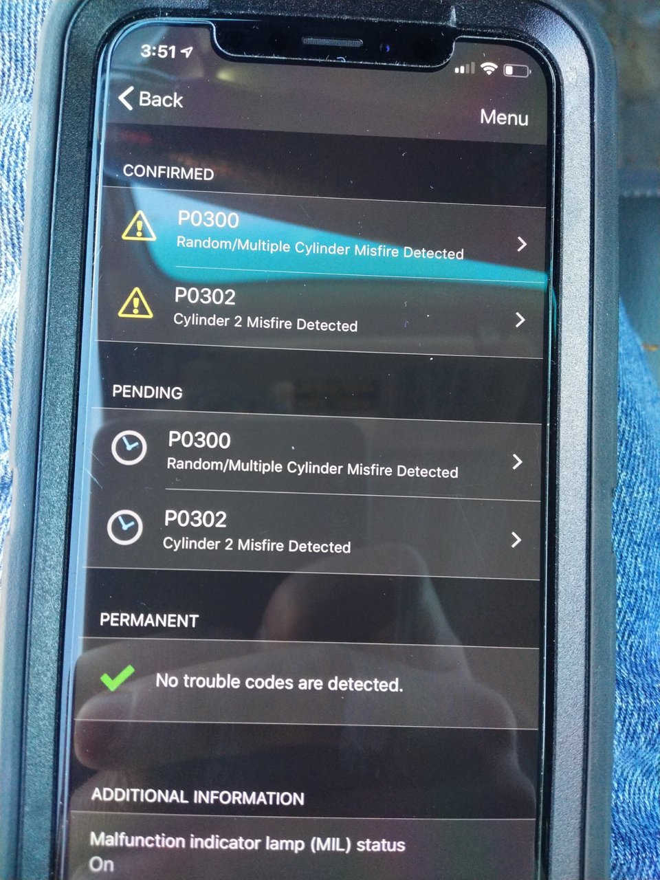

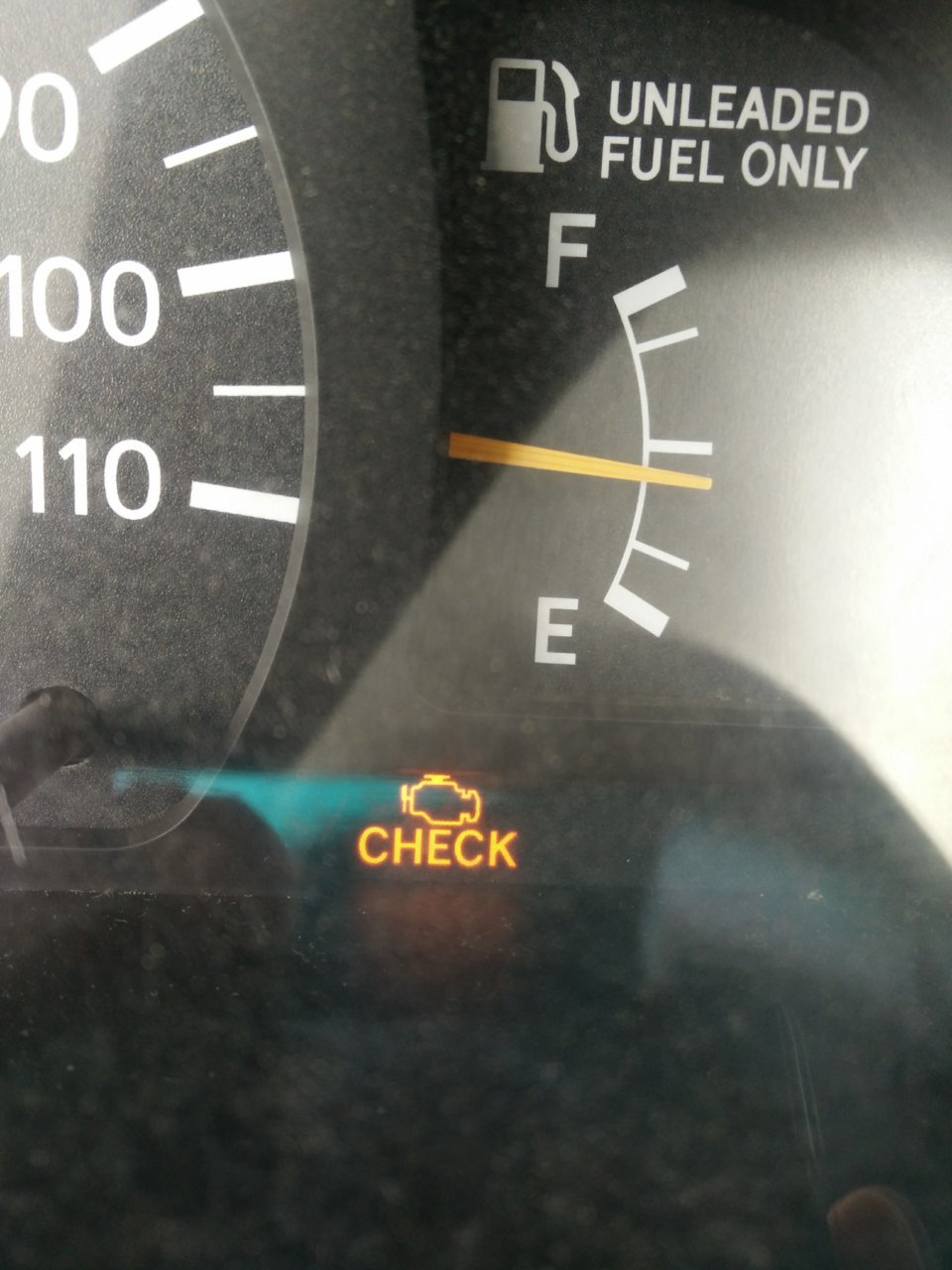

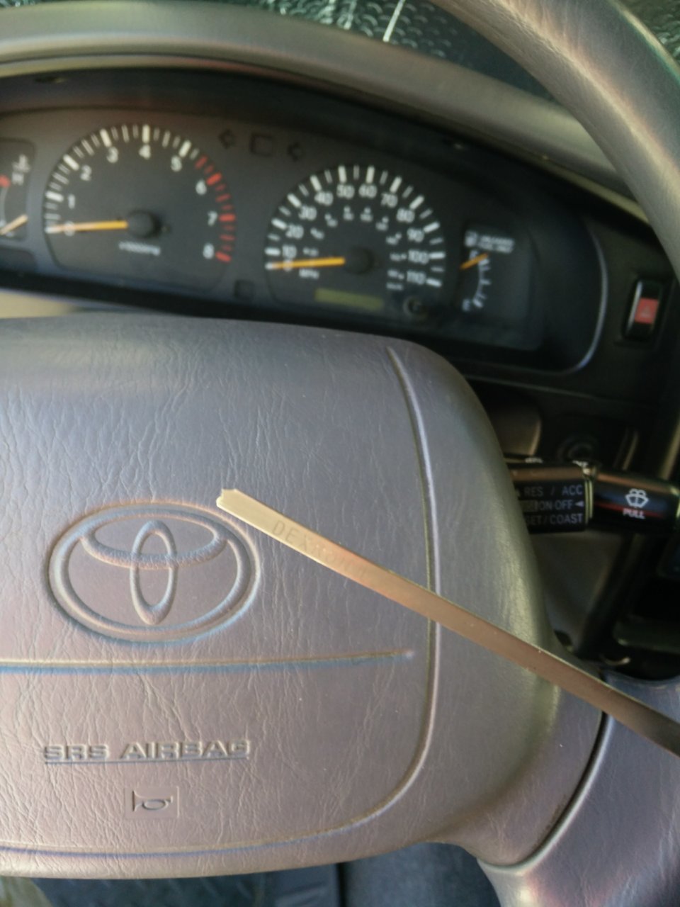

    10/18/17-12/27/17- My first check engine light, a detail, and another small trip
    I was driving to class in the morning when I noticed an orange light appear on my dash. My first check engine light. Truck was running fine and I didn't notice any considerable issues. After class, I drove to my local auto parts store and had them plug in their OBD scanner. Code came back as a PO171, System too lean (Bank 1). I did some quick research on TW and found that the MAF sensor might be the issue. So I bought some MAF cleaner, pulled the sensor and cleaned it well. I put everything back together, disconnected then reconnected the negative battery terminal, and took the truck for a drive. No more check engine light. Awesome.
    MAF cleaner I used: https://www.amazon.com/CRC-05110-Mass-Sensor-Cleaner/dp/B000J19XSA

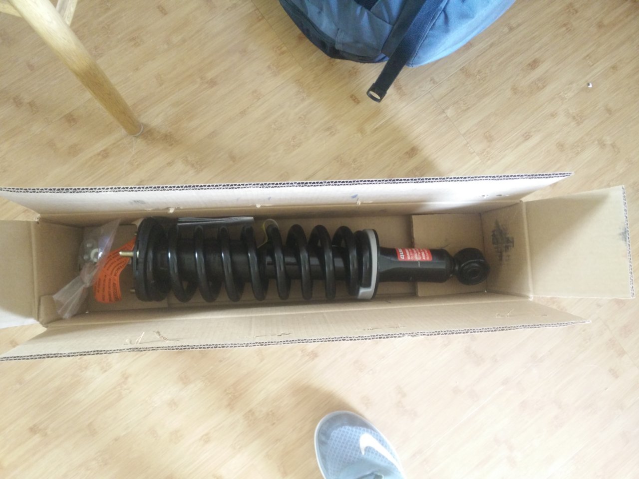

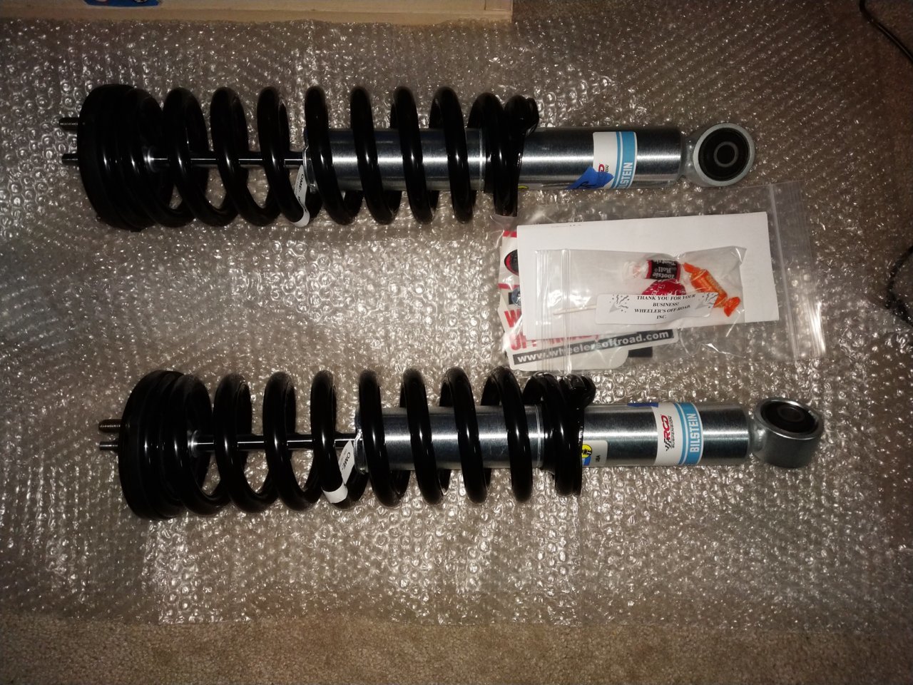

    1/4/18-3/5/18- Front lift and more maintenance
    I decided I wanted to replace the cheap stock height shocks and coils that were on the front of the truck. The driver's side was of unknown quality, was replaced by the previous owner, and was in much worse shape than the passenger side Monroe QuickStrut I had installed a few months earlier. I decided that I wanted a small amount of lift and chose Bilstein 5100 shocks paired with OME 880 coils. I ordered them from Wheeler's Offroad and had them assemble the shocks and coils as well. The install went smoothly as I had replaced the front suspension on my father's 1996 Tacoma and the passenger side strut on my truck previously. I used the stock bottle jack and placed it between the fender well and upper control arm in order to push the lower control arm down enough to slip the bottom bolt through, which worked well. I didn't take any before measurements, so I'm not sure exactly how much lift I gained, but I measured 22" from hub to bottom of fender on the driver's side and 23" on the passenger's side.
    Installed:
    Overall, the ride was much better and felt more controlled. It was definitely stiffer than before, but I figured it would soften up a little as the shocks and coils broke in. Also, as evident by the pictures, I had a little bit of reverse stinkbug going on, with the front now higher than the rear, which still had the stock, sagging leafs. I had plans to remedy this later however.

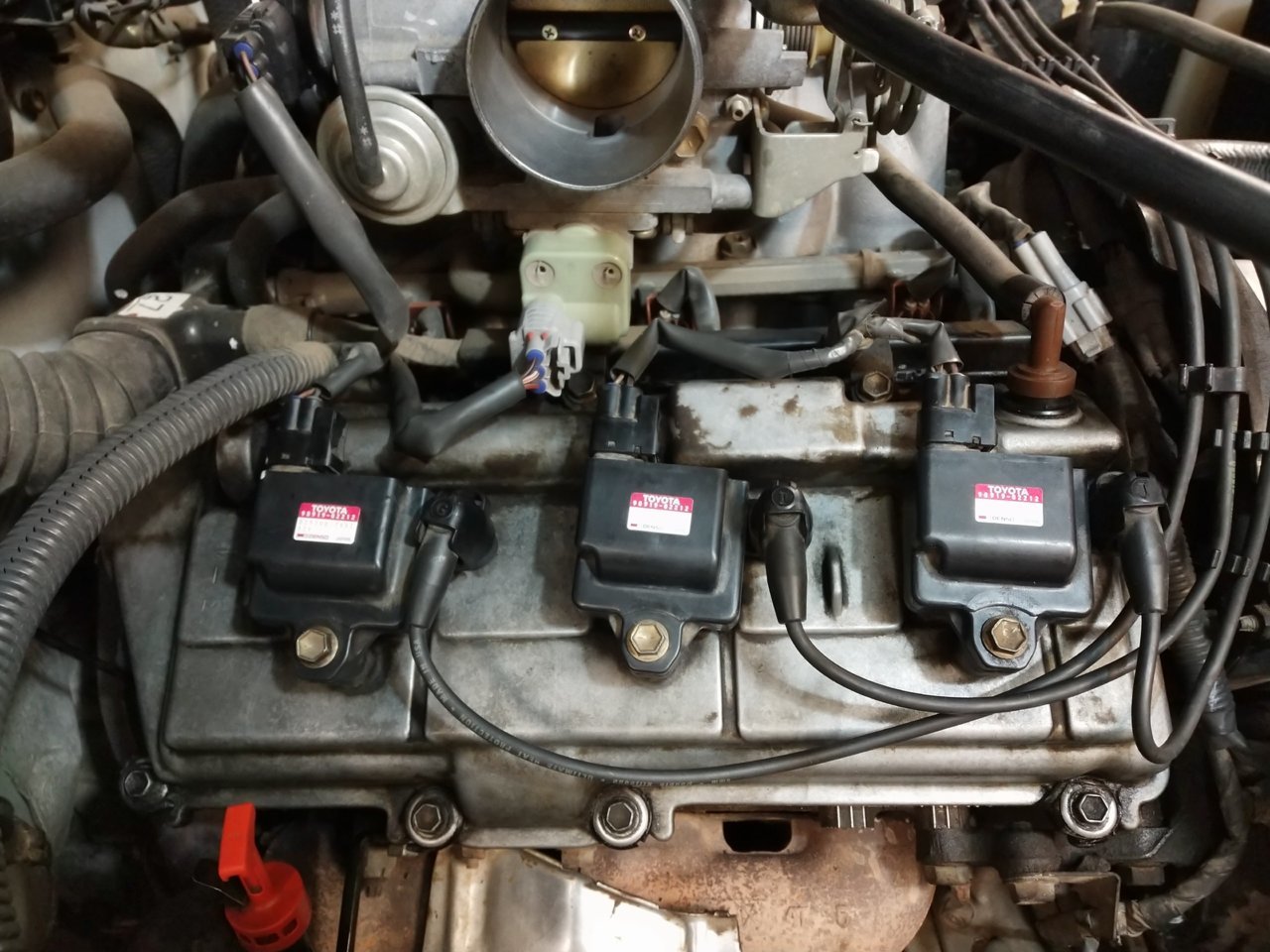

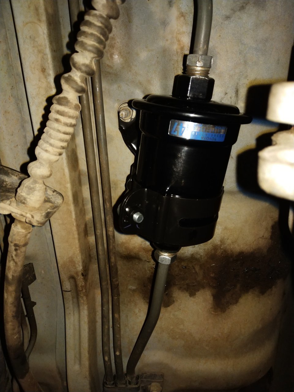

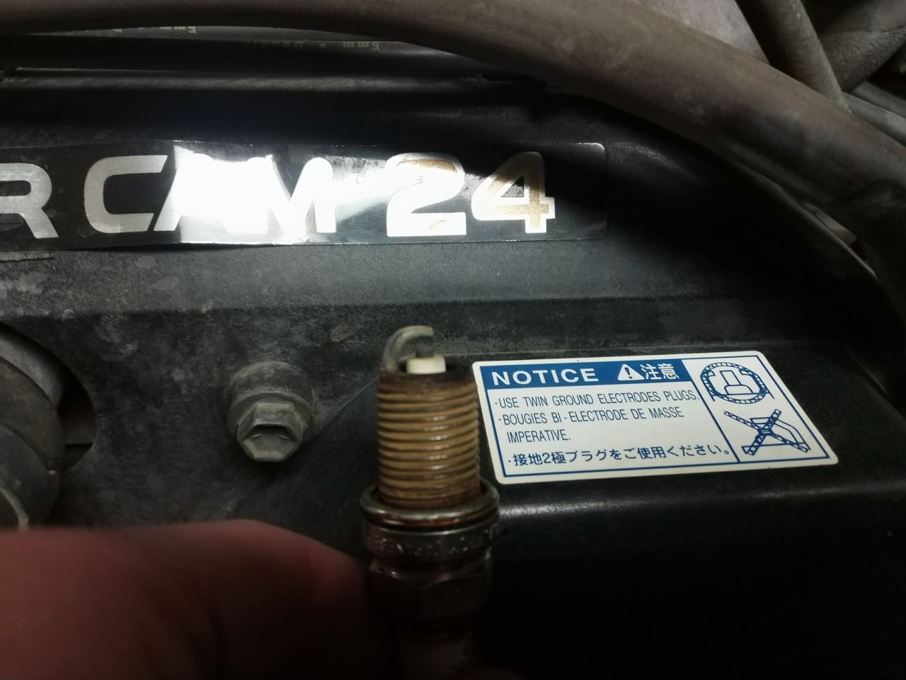

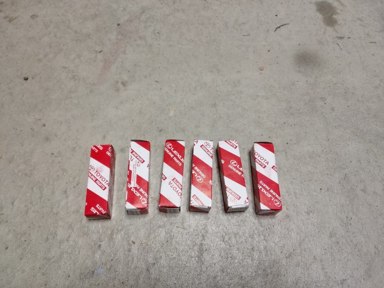

    2/3/18- Maintenance day- New plugs and fuel filter
    The previous owner told me that he had replaced the spark plugs and wires a few months before selling the truck to me. I decided to pull a plug to see if he had and what kind of shape they were in. So I pulled out the spark plug socket and removed a plug. It was the wrong one, a single electrode instead of the dual electrode recommended by Toyota. It wasn't in bad shape, but I decided to order the correct ones from Toyota (Denso K16TR11) and replace them anyways. The wires looked in good shape to me, so I decided to forgo replacing them (This came back to kick me in the butt later). I also ordered a new fuel filter as it had never been replaced to my knowledge. The plugs came out easy as did the fuel filter and the truck seemed to run better after replacing both.
    The parts (along with some oil filters and outer tie rods) I ordered from Toyota:
    Installing the spark plugs:
    New fuel filter installed:

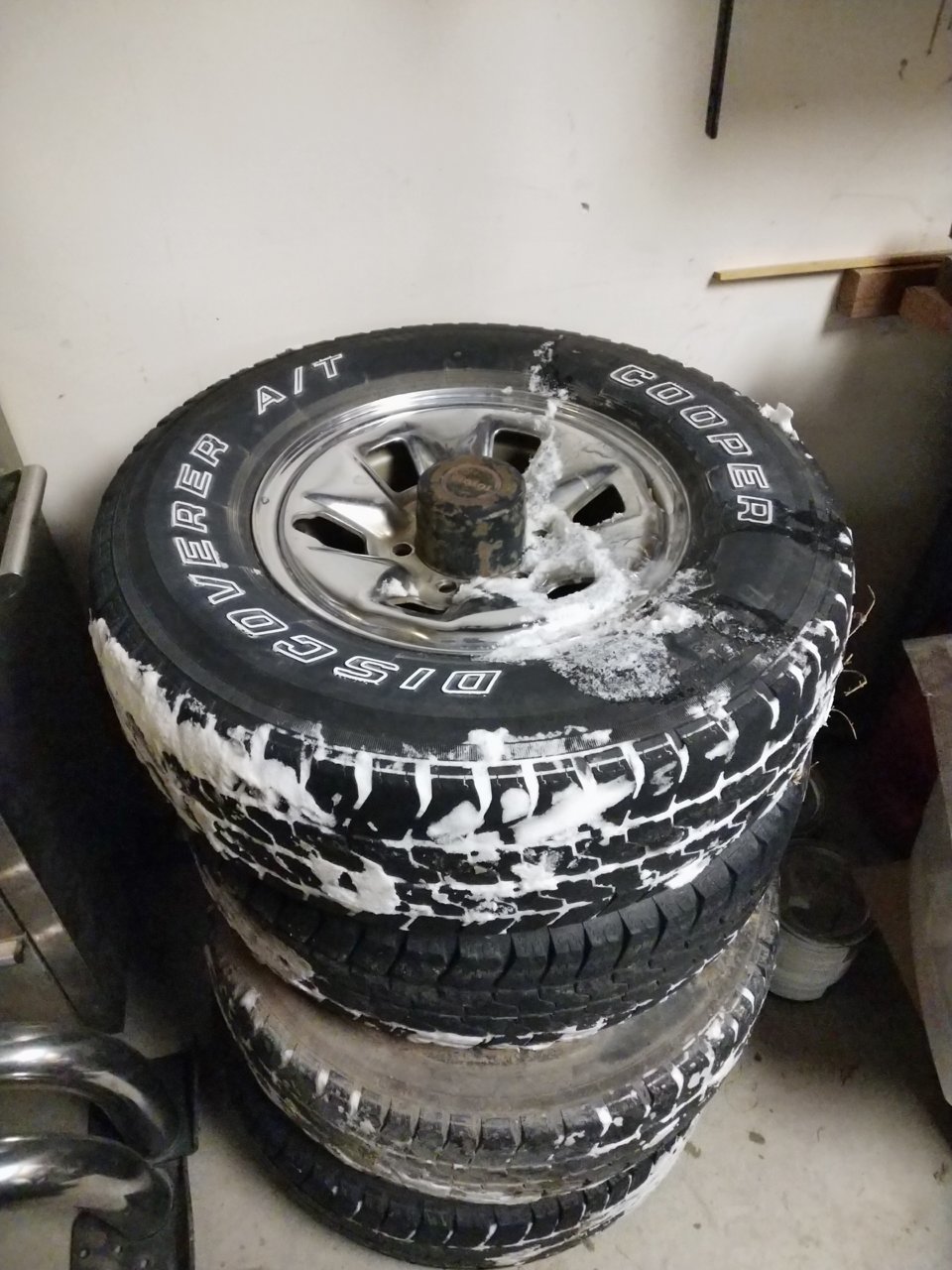

    2/22/18- An attempt at new (to me) wheels
    Ever since buying the truck, I wanted to put black wheels on it. I thought they would look really good contrasting with the white paint. But I couldn't justify getting rid of the stock alloys that came on the truck as they were in such good shape. I was scouring through Craigslist when I came across a set of steel wheels with tires that came off a 1987 Toyota Pickup. The tires were shot, but the wheels were in good shape and they were only asking $40 for them. So I figured I could buy them, get rid of the tires, and paint the wheels black. So I went and bought them, cleaned them up, and attempted to put them on the truck.
    When I went to put them on the truck, I immediately noticed a problem; they wouldn't fit. They were hitting the brake calipers in the front. I looked closer at the wheels and realized they said 15x6. I needed 15x7 in order to clear the calipers. Damn. I should have done more research before buying them, but you live and you learn. I later ended up selling them for a profit, so it all worked out.

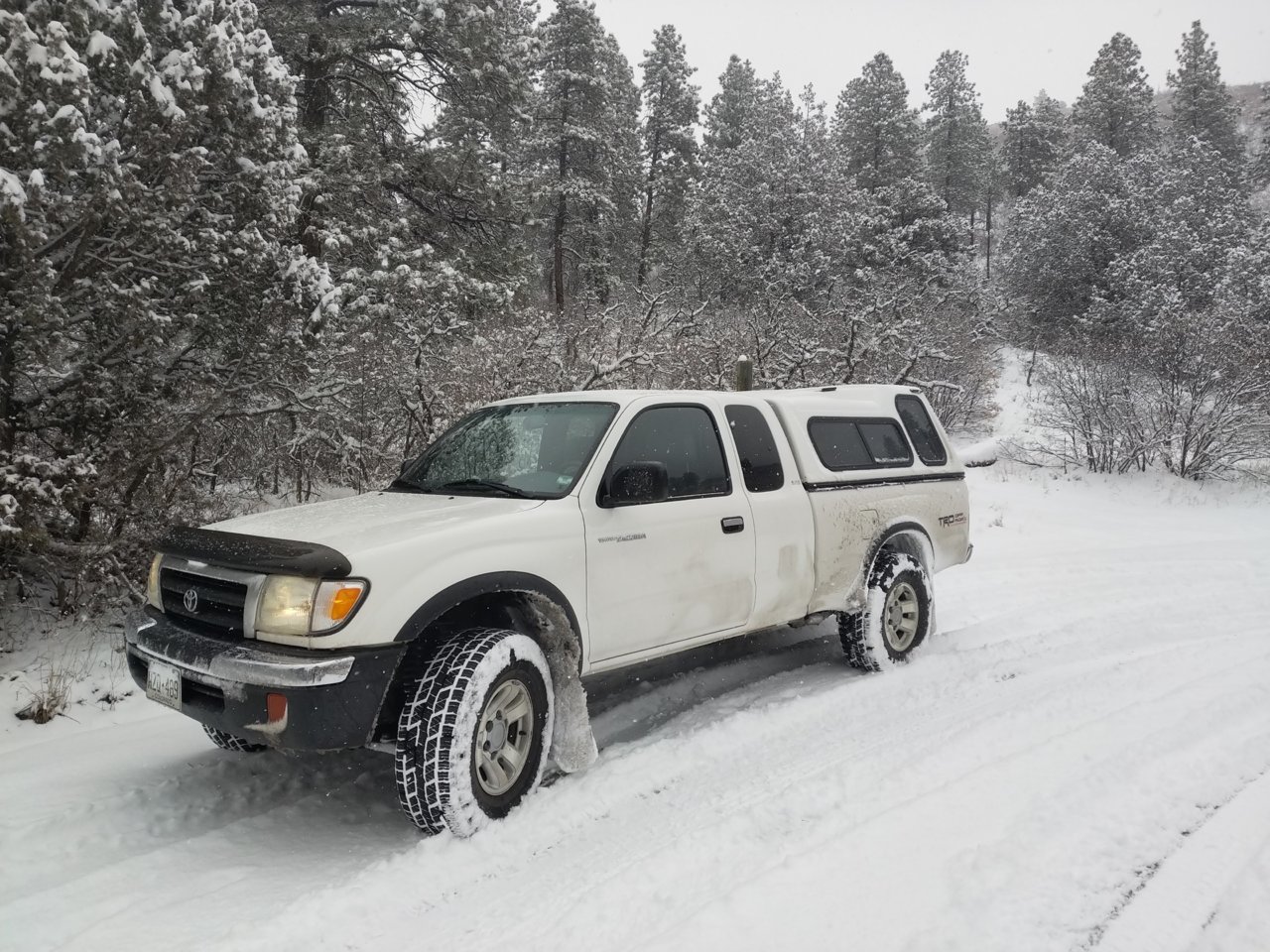

    Some pictures of my truck in the snow to make up for the lack of tie rod pics:
    Overall, I was glad to get some maintenance done before going on my first major journey in the truck: Utah.

    5/14/18- Old Lime Creek Road and Relay Creek Road
    Eager to see how the truck handled off road after installing the AAL and new rear shocks, I headed to Old Lime Creek Road. Lime creek road was the original road connecting Durango to Silverton, traversing over Coal Bank and Molas Passes. It was abandoned when HWY 550 (a.k.a The Million Dollar Highway) opened in the 1920's. An 11 mile stretch of the original road still remains and is maintained by the forest service. It's a relatively rough trail with a narrow shelf section that is only wide enough for one vehicle.
    At the south end of the road, near the trail head to Spud Lake:
    Along the narrow shelf portion of the road:
    Original stone barricades along the edge:
    Further along the road (US 550 can be seen in the top right of the photo):
    Twilight Peak:
    An old car that crashed along the highway in the 1950's:
    Tunnel blasted to allow Lime Creek to flow under the highway:
    Still itching to do a little more off roading, I headed south down the highway a few miles to Relay Creek Road, which can be accessed behind Purgatory Ski Resort. It's an easy road that is well maintained, but was fun nonetheless and provided some good photo opportunities.
    Showing off my cracked passenger marker light, damage left from an encounter with a Jeep (whoops):
    Overall, the new rear lift did well on the excursion. No more bottoming out in rough sections of the trail. I did, however, encounter one big problem; the AAL kept slipping out of the rest of the leaf pack. At one point, both ends of the AAL almost slipped completely out of the pack. I had to stop a few times along the trail(s), loosen the u-bolts, realign the AAL, and tighten the U-bolts back down.

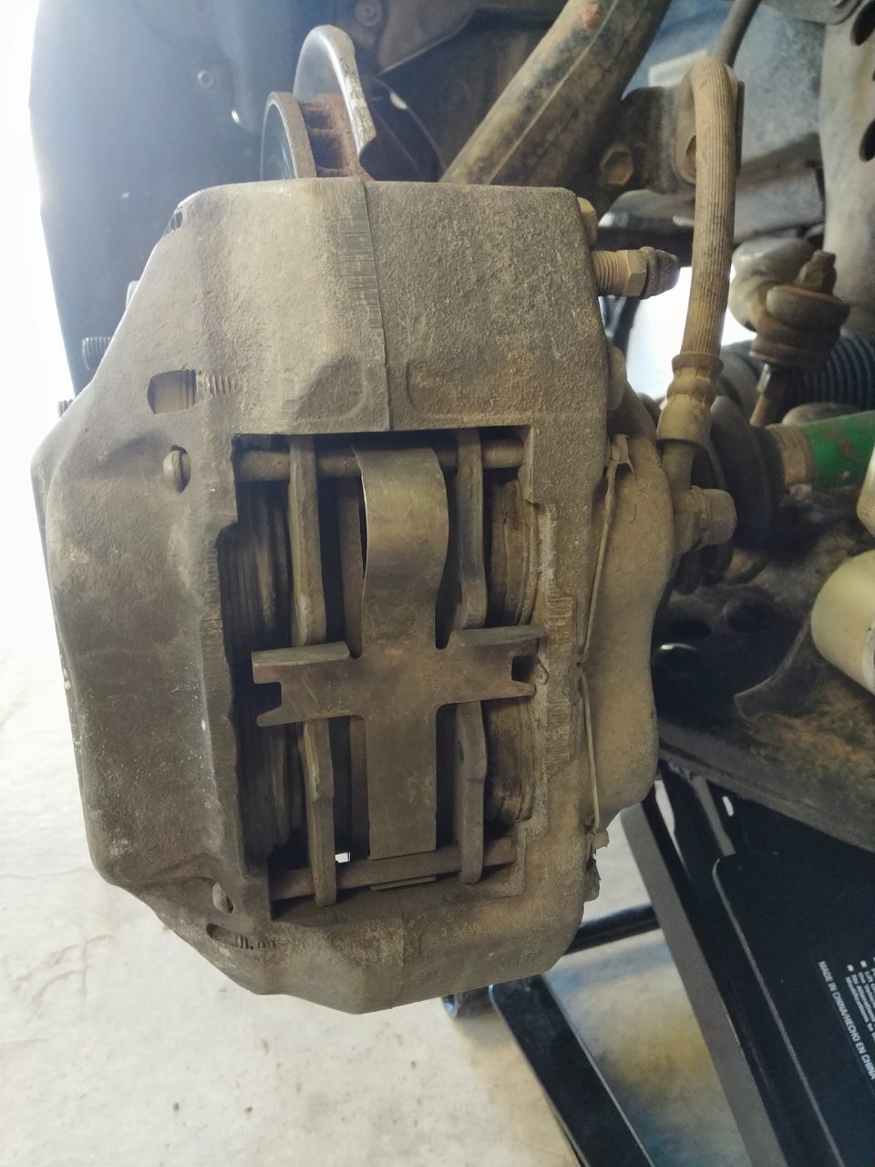

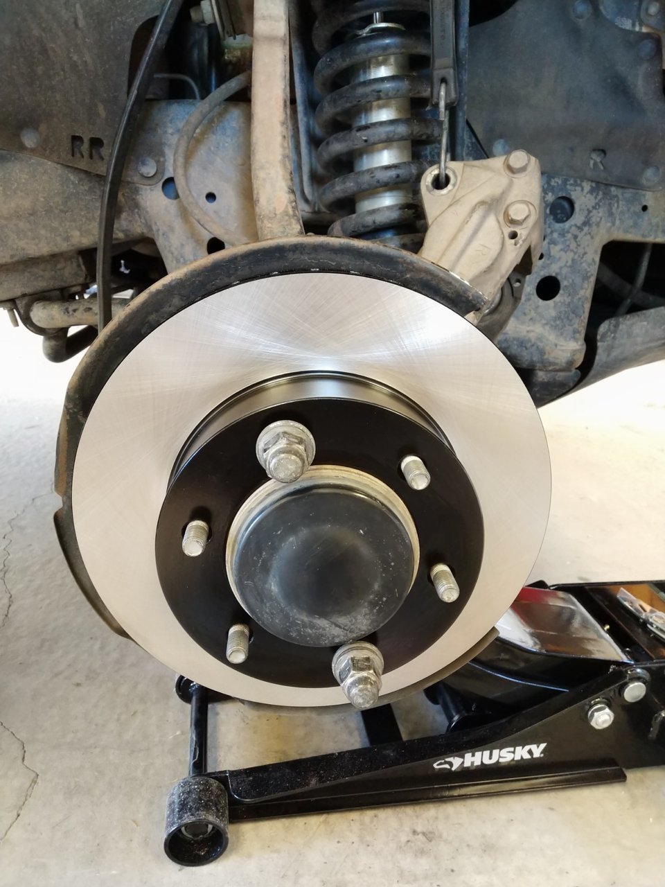

    6/8/18-6/28/18- Brakes and some Mountain Passes
    My front rotors had been warped for several months and were causing a pretty serious vibration during braking. The truck still stopped fine, but I got fed up with the vibration and decided to replaced the brake pads and rotors. I chose Centric High Carbon Alloy rotors paired with Akebono Ceramic Pads. I ordered both from RockAuto along with a brake hardware kit.
    Links:
    https://www.rockauto.com/en/moreinfo.php?pk=2761052&cc=1364723&jsn=465 (Rotors)
    https://www.rockauto.com/en/moreinfo.php?pk=362277&cc=1364723&jsn=558 (Pads)
    https://www.rockauto.com/en/moreinfo.php?pk=2027392&cc=1364723&jsn=589 (Hardware)
    Old pads and hardware:
    New rotors installed:
    The install went nice and smooth. None of the caliper hardware holding in the pads were seized, so everything came apart easily. The old semi-metallic pads still had a good amount of life left in them, but I went ahead and replaced them anyways.
    I also exchanged the brake fluid in the master cylinder reservoir with new fluid. Eventually I will bleed the entire system and get all new fluid in there. After everything was put back together, I broke in the pads and enjoyed the lack of braking vibration. Stops were nice and smooth now, awesome!

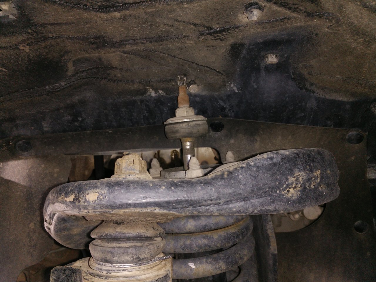

    7/31/18-8/22/18- A little maintenance and the Alpine Loop
    My lower ball joints had been leaking a lot of grease for a few months, so I decided to check them and noticed they had a little play in them, almost unnoticeable though. But given the poor design of the ball joints on these trucks, I decided to replace them as they were original to the truck. I was in the process of moving out of my house into a new apartment without a garage as well as starting a new semester of school, so I decided to have a local shop do the work.
    While I had the truck at the shop, I figured I would have them replace the valve cover gaskets while they were there. They had been leaking since I got the truck, shortly after which I re-torqued the bolts and cleaned off the valve covers, which did slow the leak, but didn't stop it. I had the shop order all OEM Toyota parts because I didn't want to take a chance on aftermarket LBJ's (Insert LBJ debate here).
    The shop did a very good job installing everything. I would have done the work myself if I had more time and a place to work, but unfortunately I didn't. At least I didn't have to add oil between changes or worry about the LBJ's failing now, so it worked out well.
    I don't have any pictures of the work unfortunately.

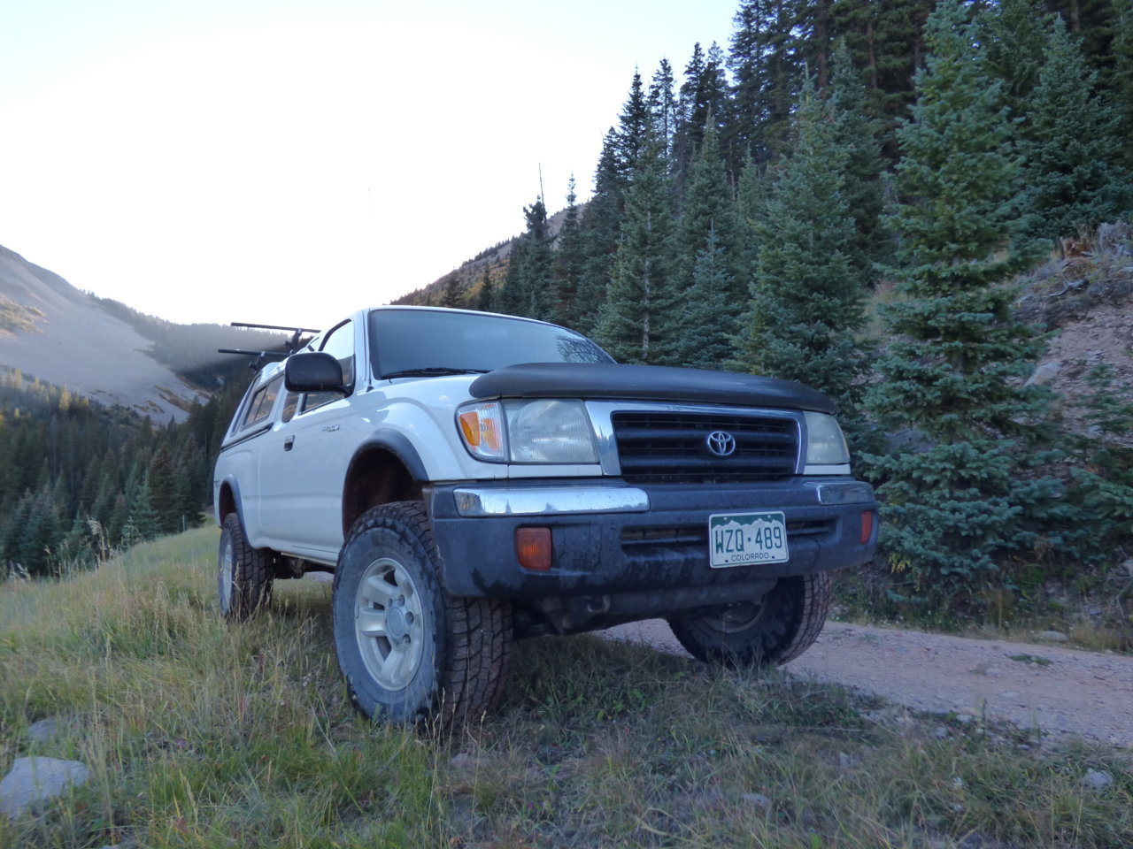

    8/21/18-8/22/18- The Alpine Loop
    One of my best friends was coming into town for a week and wanted to do a little off-roading. Given that it was the end of August, I suggested the Alpine Loop as it wouldn't be open for that much longer due to snowfall. For those not familiar, the Alpine Loop is a drive that involves a series of 4x4 roads in Southwestern Colorado. It starts in Silverton, traverses over Cinnamon Pass into Lake City and then over Engineer Pass into Ouray.
    Our plan was to start the drive up to Silverton early the morning of the 21st, do the loop, and camp outside of Ouray. We would then take Imogene Pass from Ouray into Telluride and then head back to Durango (Spoiler alert: that last bit didn't happen). In addition to bringing Ole' MG, my friend's father had a 1980 Jeep CJ-5 that he decided to bring.
    This Jeep was a little bit on the rough side. The 258 AMC Inline-6 ran like a top and the 4-speed shifted pretty well, but that's about all that was good about it. The steering was sloppy, it had a death wobble above 30 mph, the brakes barely worked (we'd figure out why later), and the rust and bondo body work was unique to say the least. This was going to be a fun trip.
    Fair warning: This post is long and picture heavy :)
    8/21/18- Cinnamon Pass and (most of) Engineer Pass
    We met in Silverton early in the morning and headed up Country Road 2. We weren't on the road for 10 minutes when it started pouring down rain and hailing. This wasn't a problem for me, but did get my friend a little wet (aka soaked) in the Jeep with a leaky bikini top. By the time we got to the start of Cinnamon Pass, the rain had stopped, but it remained overcast. It was at this point that I realized I had forgotten my camera, so it looked like this was going to be a cell phone picture trip.
    Climbing up Cinnamon Pass:
    Cinnamon Pass isn't very challenging, so we made it to the summit pretty effortlessly. We had to deal with all the tourists in their rental side by sides at the top, but eventually we got the summit to ourselves and got a few photos, which really showed off the stellar condition of the CJ-5 :D.
    At the summit of Cinnamon:
    Heading down off the summit, I stuck the truck in 4lo Low (1st gear) in order to gain some engine braking. Meanwhile, my friend left the Jeep in 2wd and 1st gear, which provided plenty of engine braking and made me jealous of the low gearing and manual transmission of the CJ-5.
    Coming down Cinnamon, heading towards Lake City:
    A little Jeep flex:
    Lake San Cristobal, which gives Lake City it's name:
    We made it into Lake City around lunchtime. Both rigs did excellent over Cinnamon, now it was time to see how they did crawling over Engineer, which is a little more challenging in sections. But first we had to get gas for the CJ as it was running a little rich and was thirsty. We also picked up some brake fluid as we had discovered that one reservoir in the Jeep's master cylinder was empty and the other was almost empty. After adding the fluid, the Jeep's braking capability improved and we were on our way once again.
    An old mining establishment near the start of Engineer where we stopped for lunch:
    A waterfall we encountered on the way up Engineer Pass:
    Nearing the summit:
    After getting passed by a group of about 25 dirt bikes, we finally made it to the summit of Engineer. We chose to stay in the vehicles as it was cold and rainy. But the views were spectacular.
    Sitting at 12,800 feet:
    Next we started our steep descent down the pass, which reinforced my opinion that 1st gear is not geared low enough in the A340F transmission. The descent also had some tighter switchbacks, which were made a little more difficult in the Taco as it's about 5 feet longer than the Jeep, but ended up not being an issue.
    Getting a bit flexy on the switchbacks:
    After coming down Engineer, we chose to turn right and head towards Ouray instead of continuing back into Silverton. This section of the road is probably the roughest and was not made any less difficult by the rain and wet rocks.
    Taking a break before heading towards Ouray:
    Hitting some rocky sections, giving the IFS a workout:
    As we continued down, the weather worsened and became more and more rainy. The rocks on the trail became very wet and the poor tires on the Jeep weren't getting any grip. It slid down a small ledge, lifting the two right tires off the ground. The Jeep was sitting at such a steep angle that the carburetor flooded and stalled the engine. We managed to push the Jeep down the obstacle and eventually were able to get it started again.
    Just a little Tipsy:
    Beauty shot:
    Coming down one of the many tight, rocky switchbacks, I chose the wrong line and ended up with two wheels off the ground, the right front and left rear. I was very close to the edge and wanting to make sure I didn't tip, my friend's father chose to hold down the rear left of my truck while I inched down. It was definitely a butt-clenching moment.
    Tipsy v2.0:

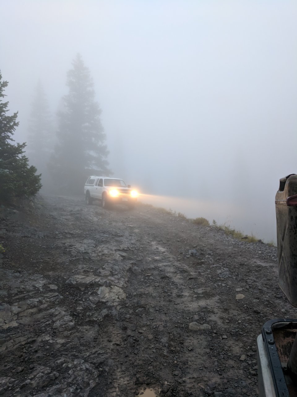

    A dense fog began to roll in:
    The fog was becoming so thick and dense that it was hard to see, plus it was getting dark so we decided to pull over and camp just off the road. We weren't sure how far away from the highway (Red Mountain Pass) we were, but we were all tired and hitting the hay seemed like the best option. We awoke the next morning to some beautiful sights and realized we were only about 1.5 miles from the highway.
    8/22/18- The last 1.5 miles of Engineer Pass and Returning Home
    Nothing more beautiful than a 1st Gen right?:
    Since we were a little behind schedule and my friend had an unexpected doctor's appointment later in the afternoon, we decided to forgo Imogene Pass and head back to Durango over Lizard Head and through Mancos. My friend's dad decided to head back the other way through Silverton as it was shorter and the Jeep was downright scary on the highway.
    Atop Lizard Head Pass on the way home:
    In the end, it was one of my more exciting off-road excursions in the truck. It was challenging in sections and not everything went to plan, but I still had loads of fun. I hope to do Imogene (and Black Bear) sometime in the near future as I ran out of time on this trip.
    Tacofire98 likes this.

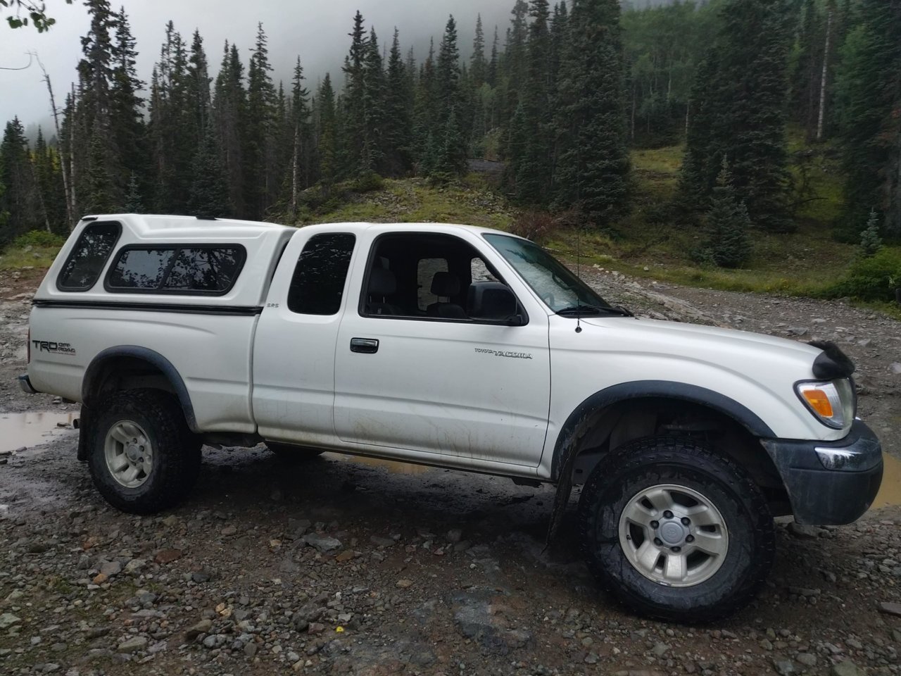

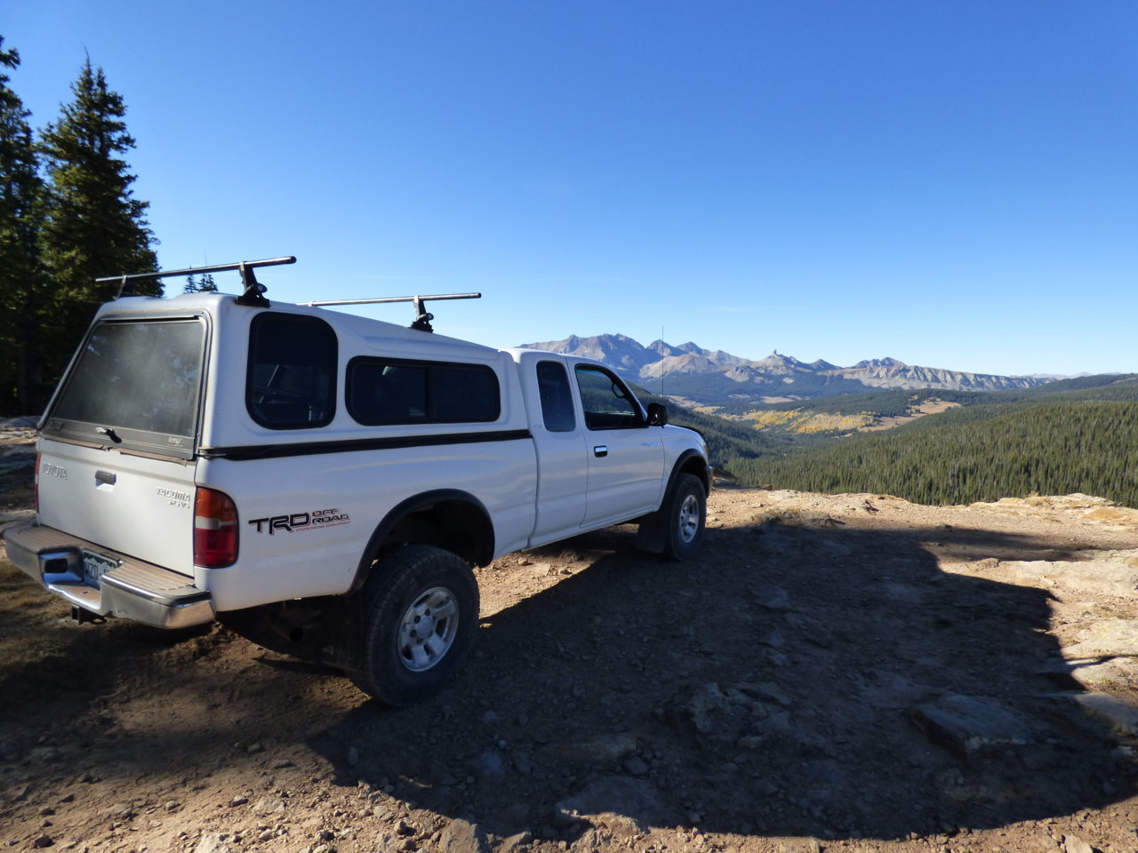

    9/21/18-9/28/18- Cascade Divide Road and Bolam Pass
    Having started back up at school, I was once again itching to get out of class and do some more 4wheeling. I decided to head up a local road one weekend that I had never been on before, Cascade Divide Road. It's another moderately rough road that really just requires some ground clearance, but it did provide some amazing photo opportunities and allowed me an escape from classes.
    On the way up:
    Got some spectacular views of the backside of Engineer Mountain:
    Unfortunately, the truck had to get in the way of the views (or was it the other way around?) :D

    10/21/18- Another quick attempt at La Plata Canyon
    Bored one weekend, I decided to drive up La Plata Canyon and see how far up I could make it. I knew there was plenty of snow up there and I probably wouldn't make it that far, but decided to try anyways.
    Ended up making up about 8 miles before I decided to turn around. The snow wasn't deep by any means, but it was really wet and slick and I kept losing traction. Took some cool photos though, so the trip was worth it.

    11/6/18- 2nd check engine light- A misfire
    One evening I walked out to the truck to run to the grocery store. Got in and it started up no problem. Then it started to idle extremely rough. I decided to stick in gear and move forward a few feet to see what would happen. The truck started to buck pretty violently, so I parked it. Then the check engine light came on. Oh shit. I knew what this was. A misfire. My roommate had a code scanner, so plugged it in and got these codes back:
    Pretty much what I expected, but now I had to figure out what was causing it. I had replaced the spark plugs a few months previous so I figured that wasn't it. My next thought was either plug wires, coils, or fuel injectors. On a hunch, I decided to replace the plug wires as they were the cheapest and easiest to replace. I ran down to my local parts store, picked some up and installed them. Fired the truck up and it ran great. Check engine light went off and all was good. Awesome! I was kind of surprised the wires went bad as quickly as they did, the PO had replaced them only about 25,000 miles ago. But I was glad it was an easy, inexpensive fix.
