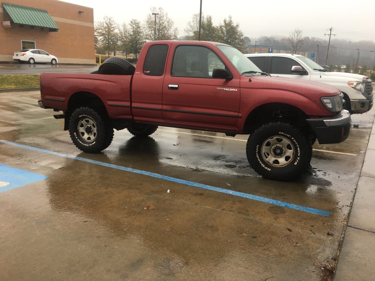

    421CAB09-E312-47D9-925B-E39759867A4E.jpg 6E7E98C6-BCD5-40A6-B978-8B071CF90592.jpg

    How'd your clearance with the new wheels? Are the tires the same 32x11.5?
    Nevermind, I saw your post in the 98-00 thread.

    I am Definitely more happy with it not rubbing! There are parts of me that wants to toy with some 235/85 R16. But for the low price I got these 32x11.50 on CL, it’s really hard to beat for now.
