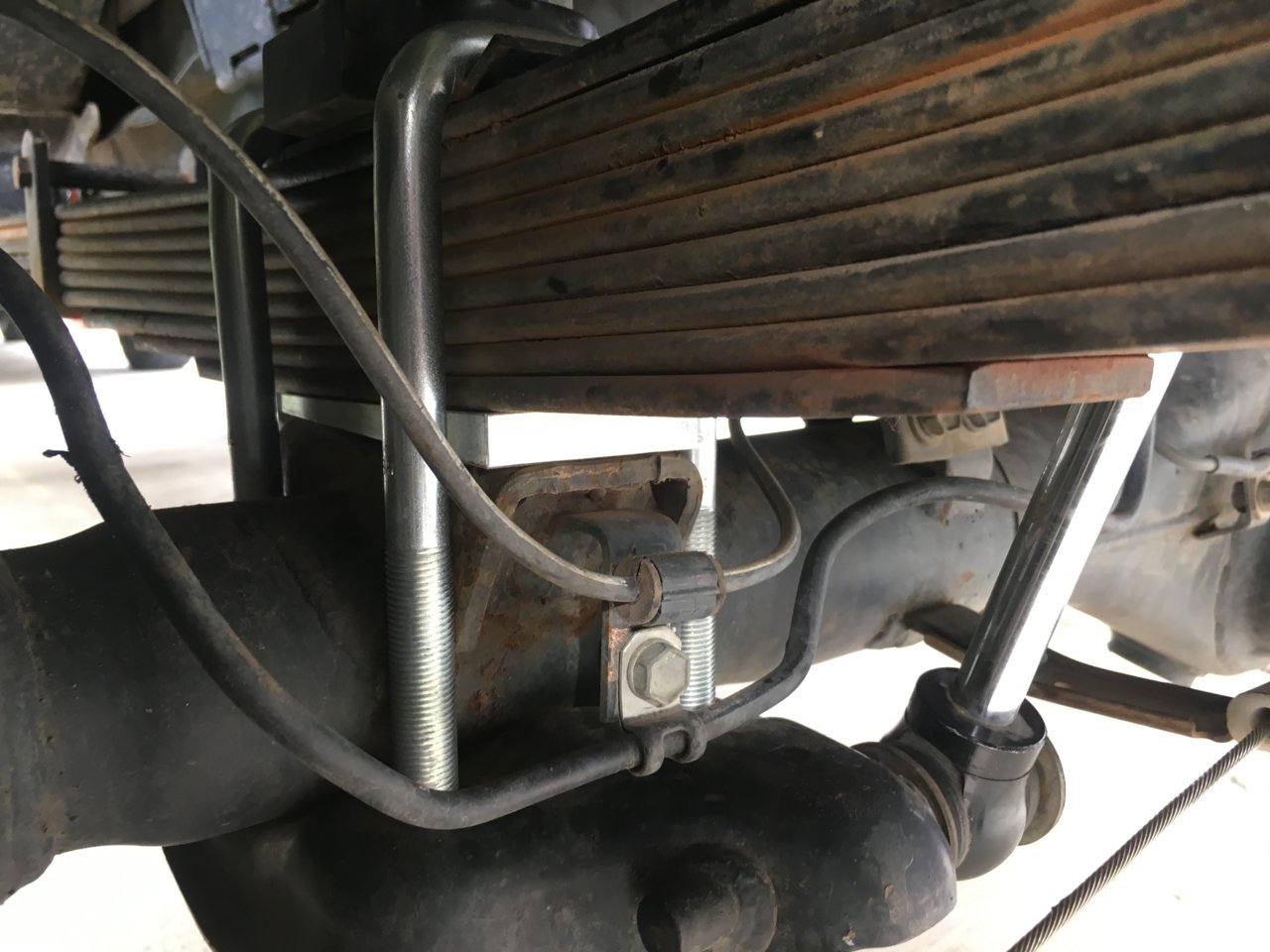

    Did a few things on the truck yesterday. Added 3 degree shims, new u bolts and OME heavy duty greasable shackles to the rear.
    E25B6DE6-9AED-478B-A54B-CFC0ECD80B6F.jpg 6485C93A-E52A-4A75-8C9E-E2C16AFDD2FC.jpg
    Also had my passenger side cv boot rip last week so I threw in a aftermarket cv while I reboot the OEM axle.

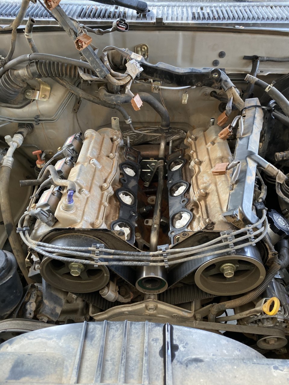

    Truck threw a P0330 code a few weeks back and a few times since then. So today I replaced my knock sensors and wiring harness. Took about 3 hours, less time then expected. 24659EEF-BD91-4AE2-AF7C-033982FBC50F.jpg
