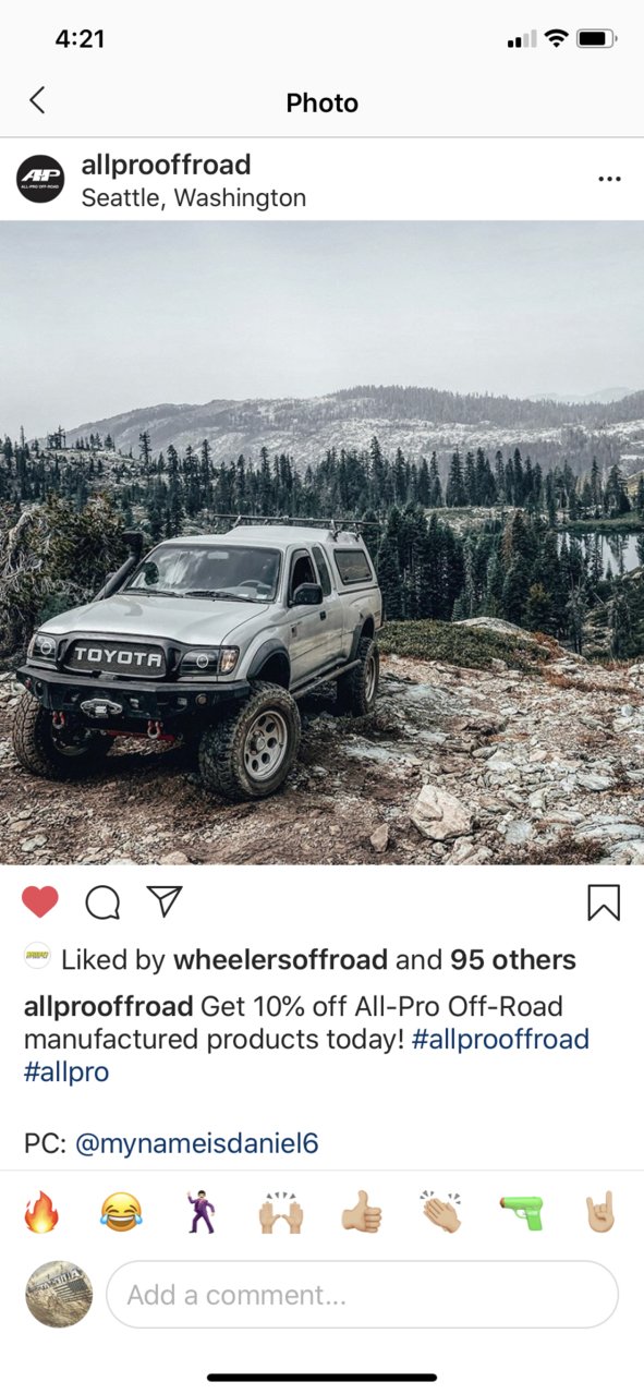

    Was able to get my truck featured on IG which I thought was pretty cool.

    Worth it, was a damn good pic you got too

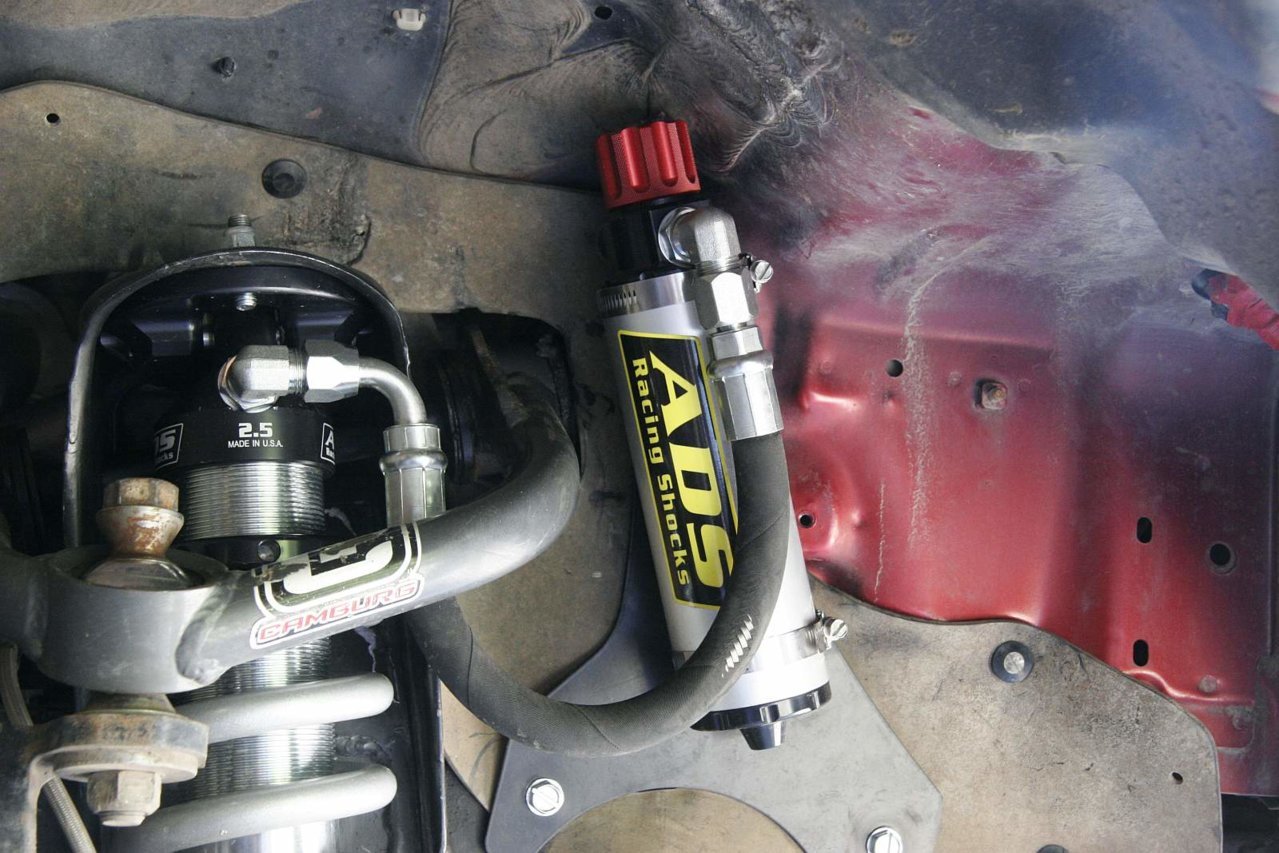

    Hey man, I’m gearing uo to buy ADS coilovers with the click compression(waiting for MCM to send me the invoice). Was wondering how you are liking yours? Has it made a big difference wheeling? What do you keep the clicker at and do you change it often?

    So far I like the performance a lot. Be aware, the resi hose is a bit exposed.
    The compression adjusters do give a lot more control but they also create the situation where the tire can rub on the hose. After install, I could see that the tire came close, but it wasn't until the first wheeling trip that the tire actually go into the hose.
    I have since changed a some things that should help with this, but I won't know for sure until the next adventure coming up in a couple of weeks.
    The comp adjusters give you 20 increments with two full revolutions of the knob and go from no adjustment to maximum compression dampening. I started at zero and the ride on the highway was really plush. Maybe a little too soft and just a bit floaty. I put about a quarter turn into it and it was better on the highway, no more floaty feeling. But then offroad it was not stiff enough, especially when the speeds were up. So I added another quarter turn and it was better and didn't compromise the highway ride. I've since added more dampening, now at 3/4 turn. This amounts to a little less than half of the total adjustment that is available.
    I came from Kings with 700# coils and the difference is huge. So much better. It is much easier to go fast because I have so much more control. Maybe too fast because I keep knocking out the front wheel alignment from hitting stuff because of the speed with.

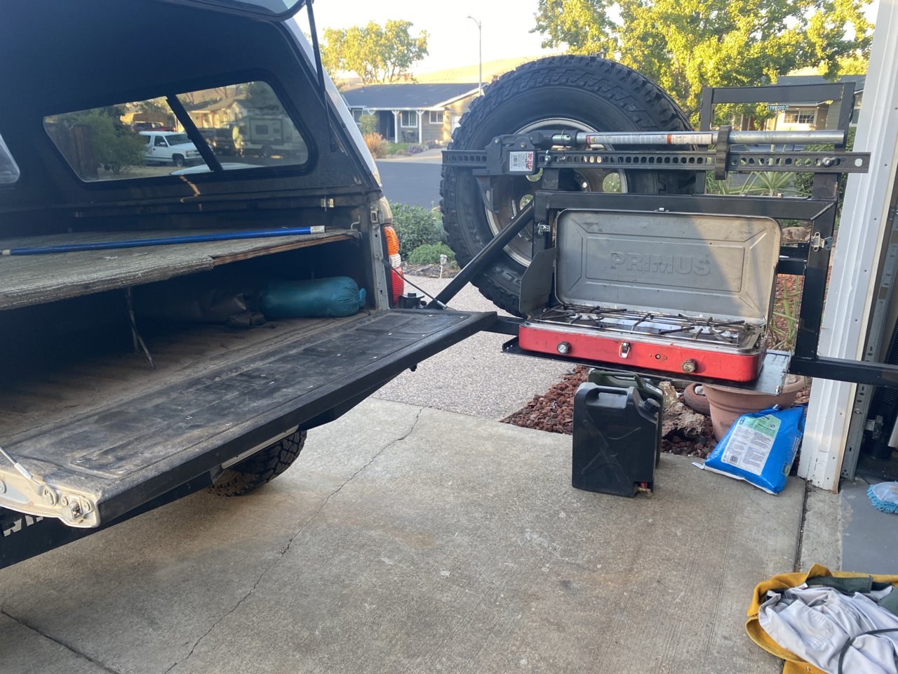

    Few goodies showed up while I was away on my trip.

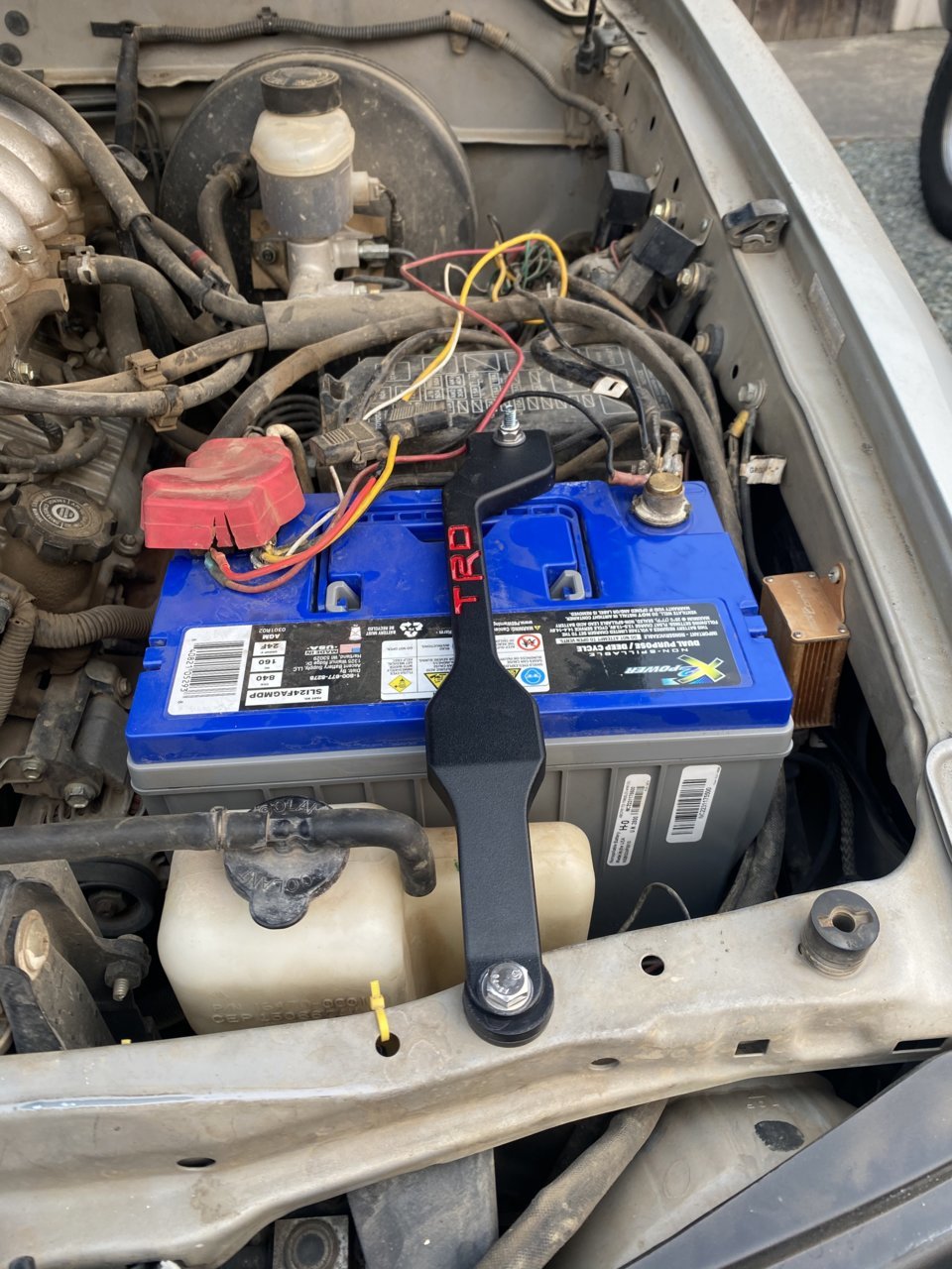

    New battery holder from @Coupe. Installed it real quick since it would be fast and not add more stuff to my bench top haha

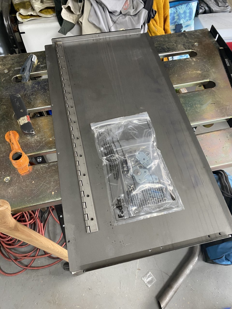

    Also my swing out table from 4xinnovation! I’ll get some paint on it this week and installed. 688CD60A-65FF-461E-8428-E6E85AB6C27B.jpg

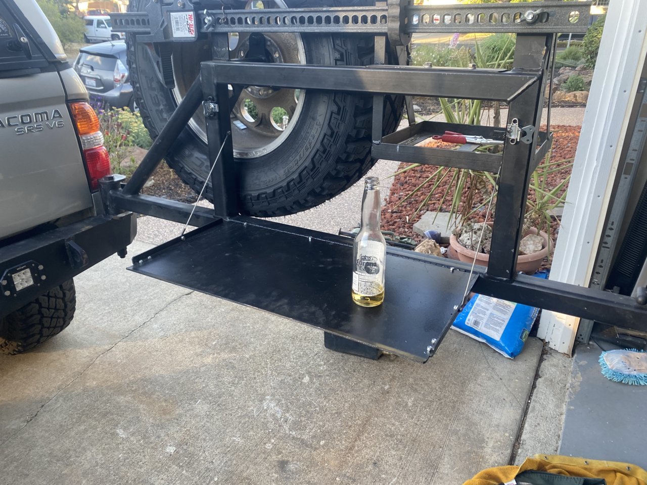

    Added a table to my swing out today, had some ups and downs during the install. Tapping holes can be exhausting lol I bought it from 4xinnovation because I couldn’t beat the price!

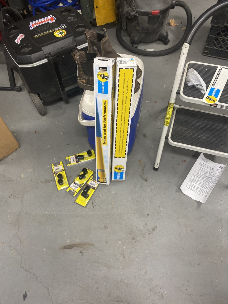

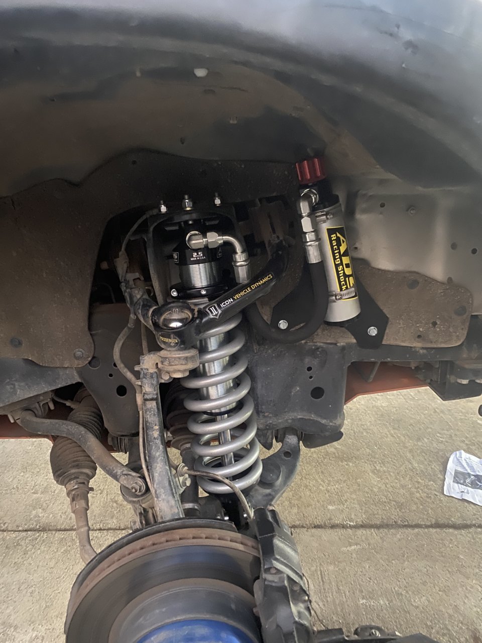

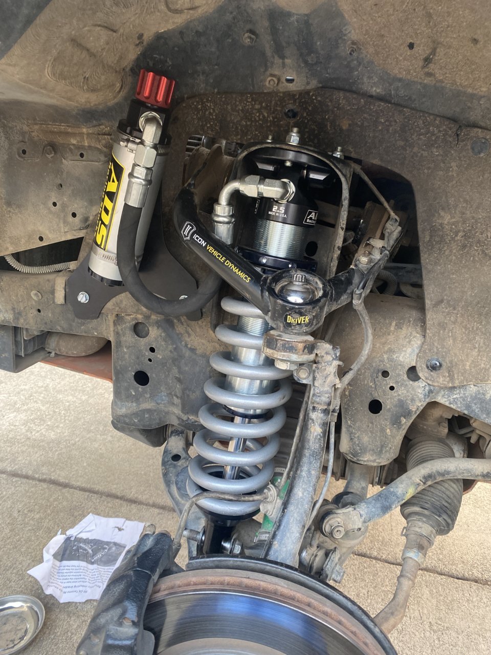

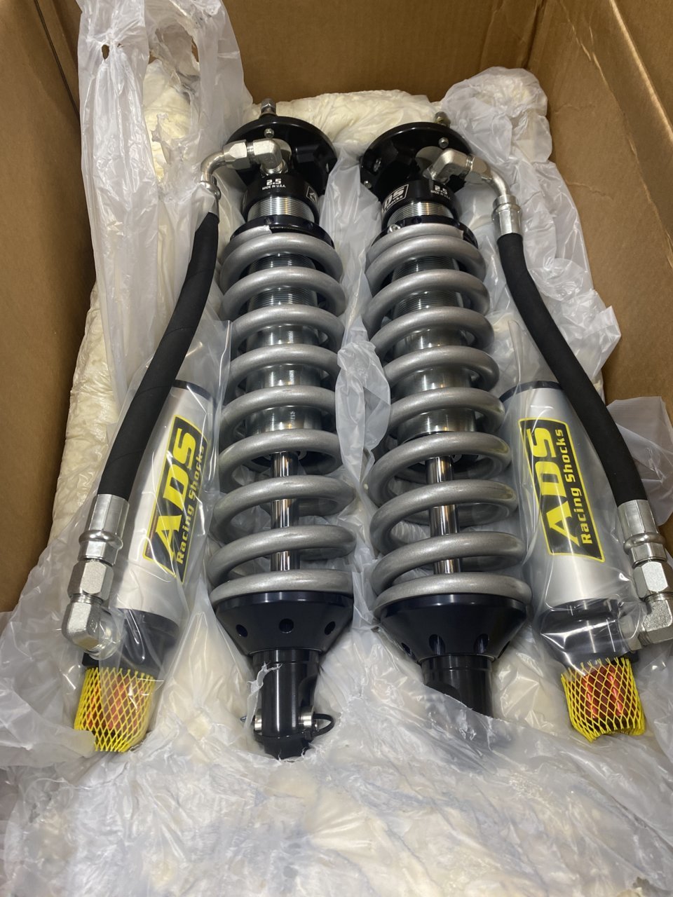

    Well my ads coilovers came in and so did the rear Bilstein 5125s. Stoked. the rear Bilstein are more of a bandaid but I’m not ready to drop a ton of money on the rear end so I figured for $200 they will hold me over until I relocate and pair the ads.

    ADS coilovers and Bilstein 5125 rear shocks were both installed today. Very excited. Have the coilovers on 6 clicks on the click comp and gave it a quick test drive, felt pretty damn good! I can already tell how much better these are going to be over the Icons. 3E1EA6A2-57C7-49D5-BE0D-DA10BEFA35FD.jpgE33D9C80-8CAF-499F-86FA-F7CCB053D7AF.jpg

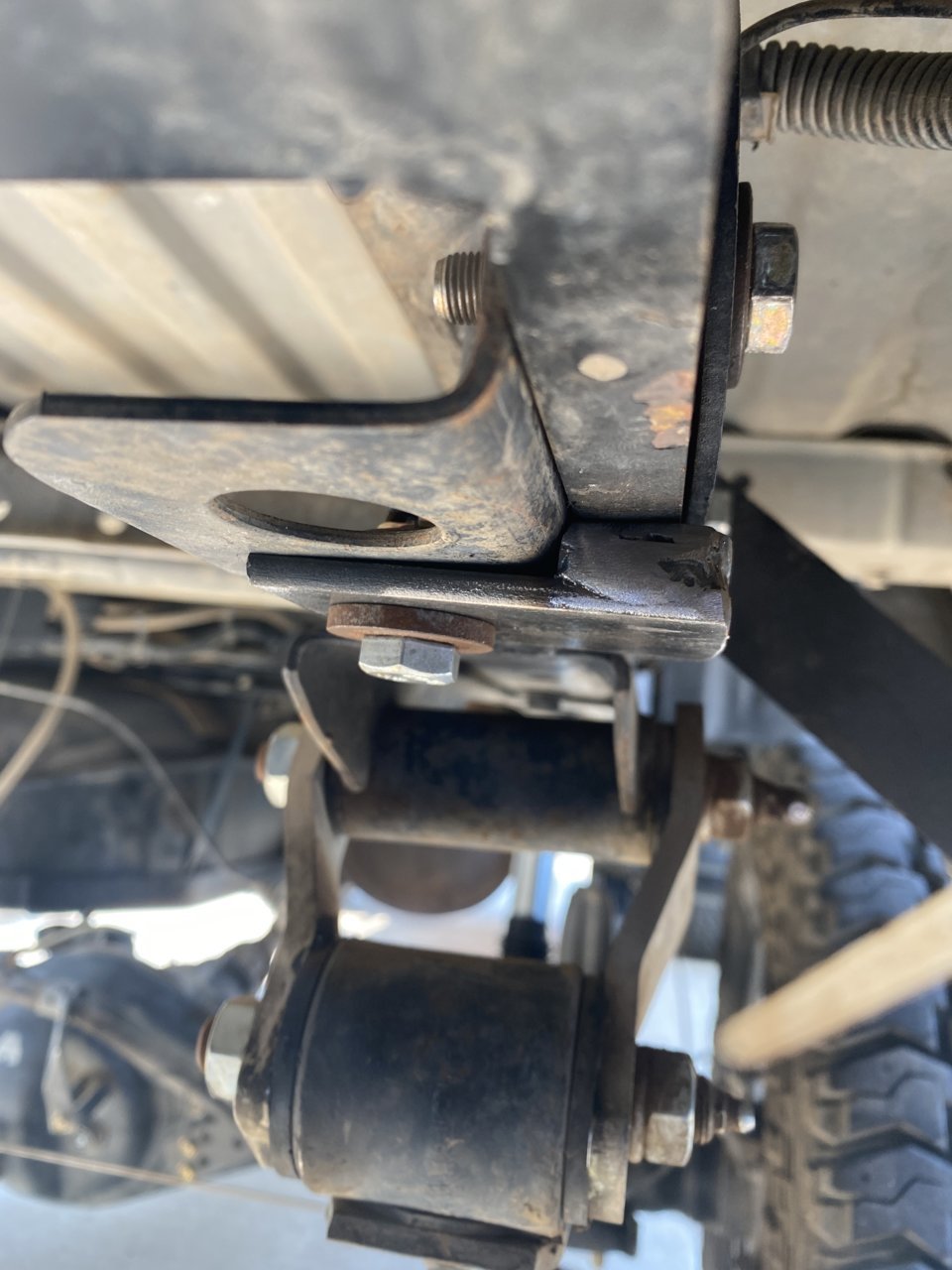

    Over the weekend I re adjusted the rear bumper to sit the right way and added in some reinforcements to keep it in place and not sag. So far so good, real test will be taking off-road and see what happens.

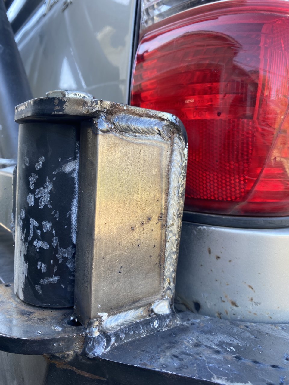

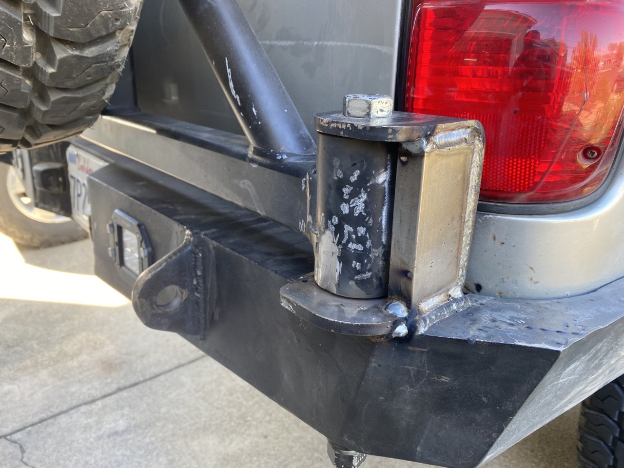

    So I took my truck out on good 4x4 trail this weekend. The new ADS coilovers felt so good! The rear Bilsteins were good too, could definitely feel the additional travel getting worked well.
    I’m still having trouble with my swing out and sagging, maybe I’m over thinking it, but I’m set on cutting off the lock and boxing the c channel and relocating the lock somewhere else. I want it to work the way it’s suppose to. I added the swing down table and I cant really use it for my stove because it’s at such an angle.

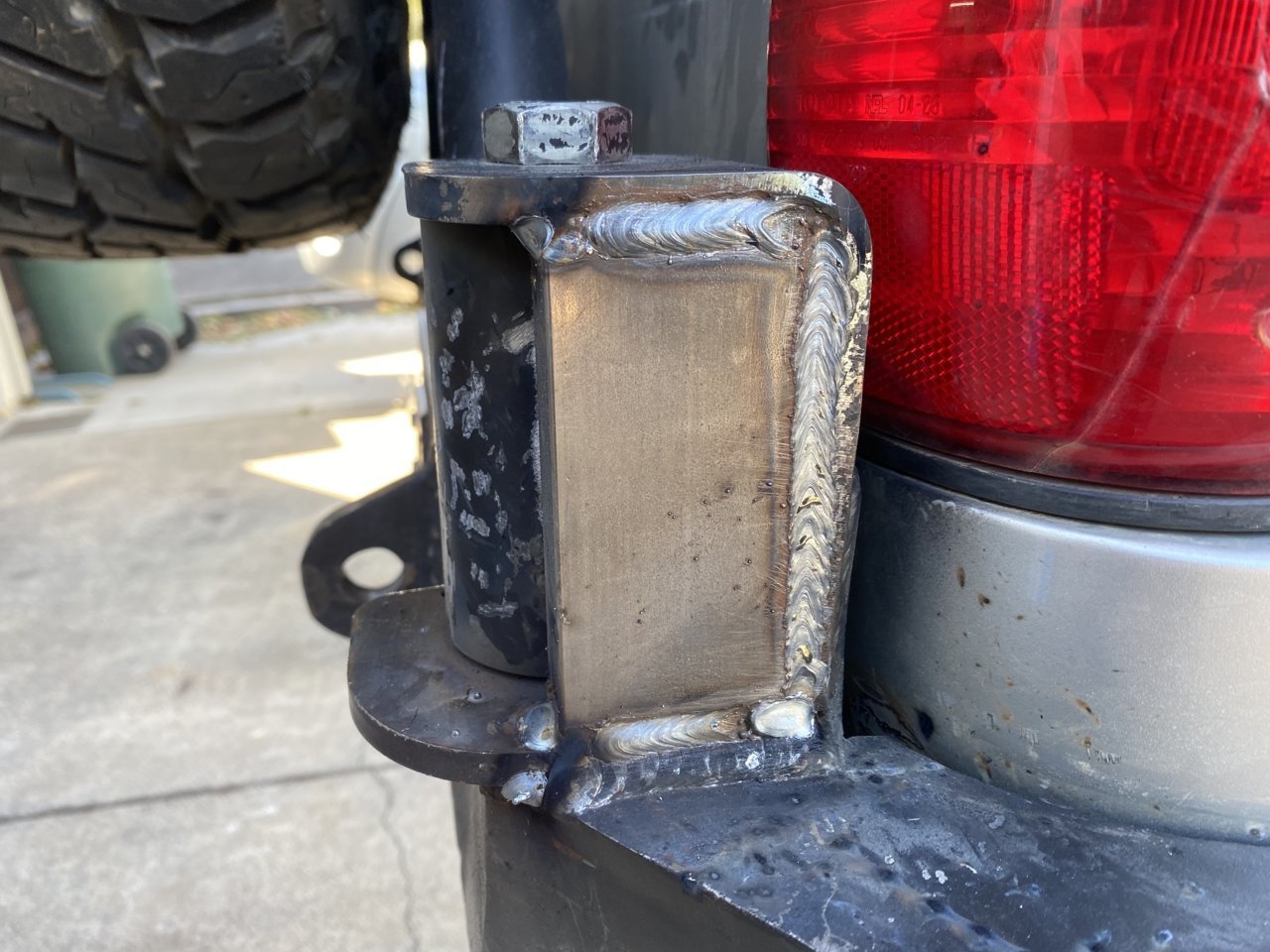

    Ok so I boxed the c channel with some beef 3/4” bar. Had to bevel the edges and heat it up with my torch before welding but ended up burning in well. I still need to figure out another locking location. 346969B6-B427-4705-8B8D-CAB0D477D464.jpg44F770B1-2749-4667-954C-58E52E8867CF.jpgFB0B9D8A-07A2-42B2-ABD1-1121302C1CF7.jpg

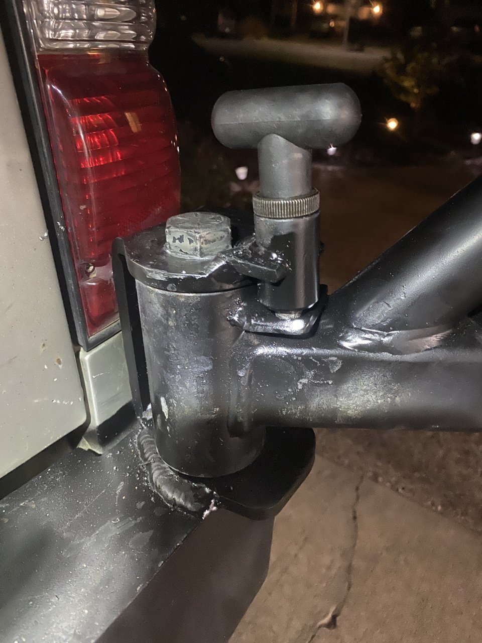

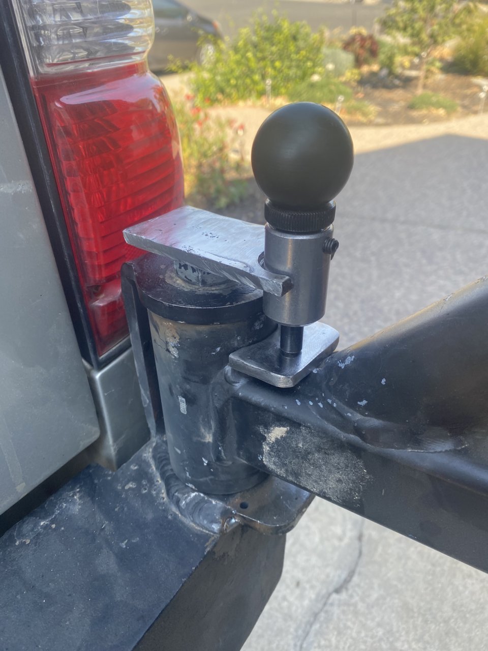

    So decided to go with this for my lock setup
    And I got the rest of the pieces cut and some tacked In place. I’ll finish it tomorrow

    CBI sliders, ADS extend travel with compression adjuster coil overs, 9” Bilstein 5125 rear shocks, Icon Tubular UCA, Alcan custom leafs, All Pro Apex bumper and skids, NWTI rear diy bumper, 295/70/17 Cooper St Maxxs and nitro 4.88s.

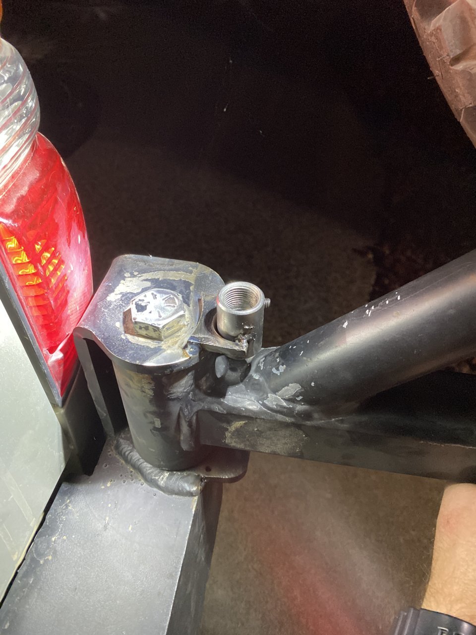

    Finished up my lock for my swing out, happy with the way it turned out and how it it works. Not the prettiest thing but no worries about that.B3E09E91-406F-43EC-A8E8-F23BFA8FEF05.jpg
