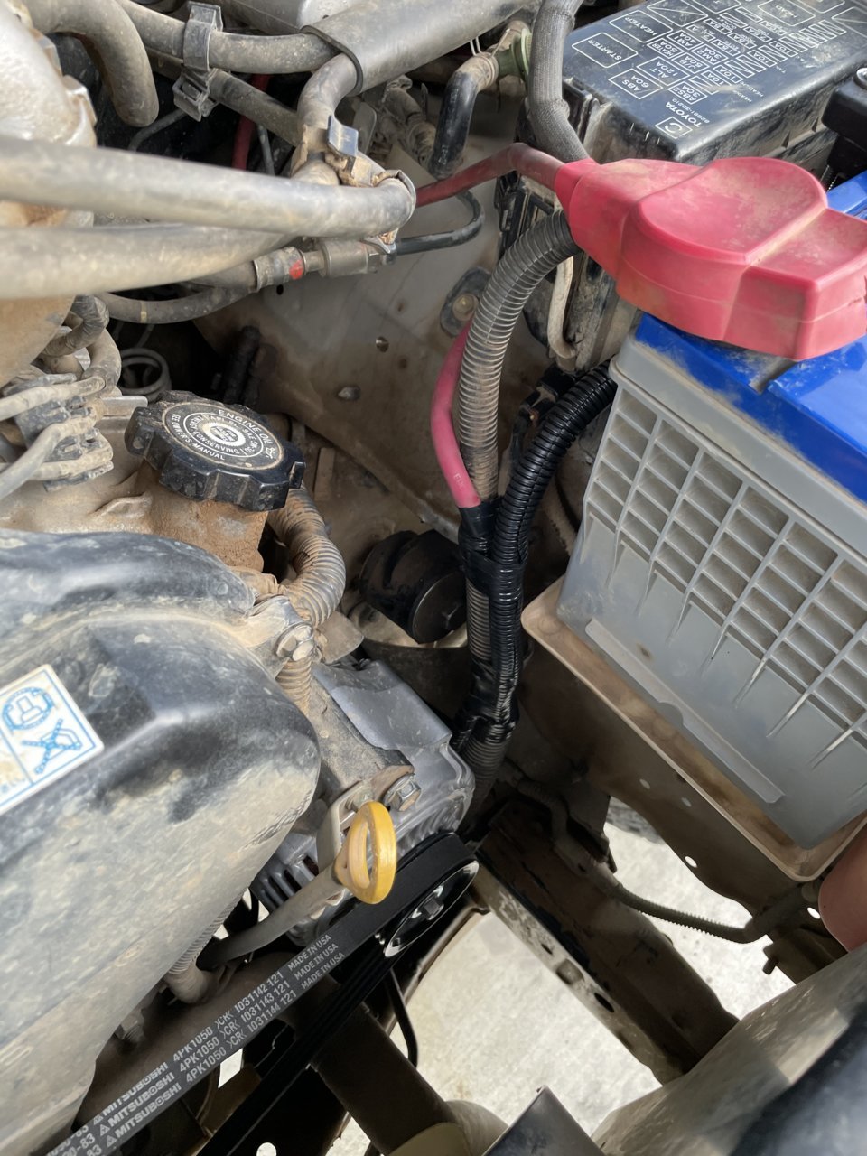

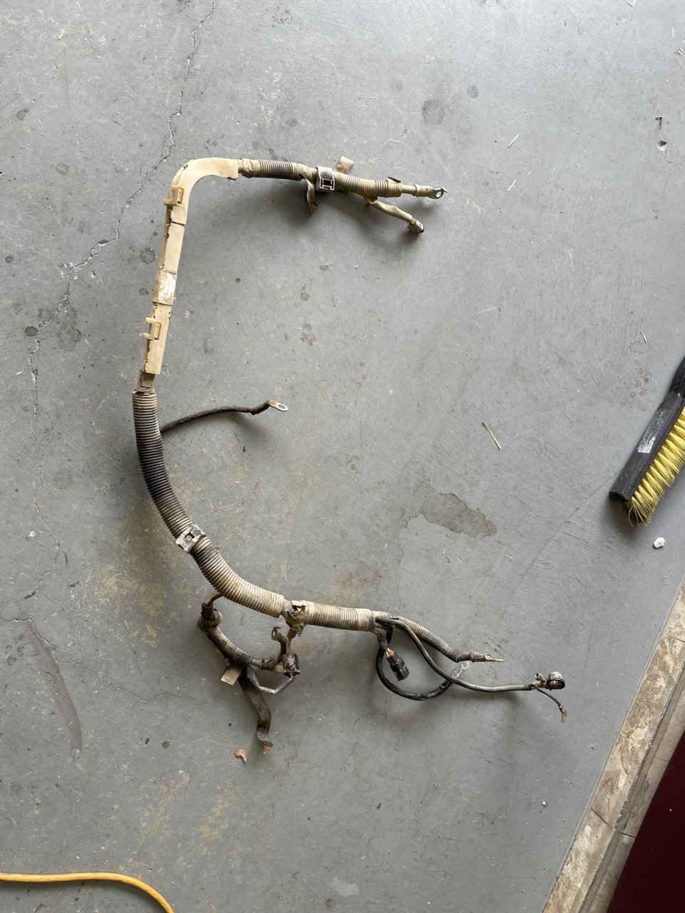

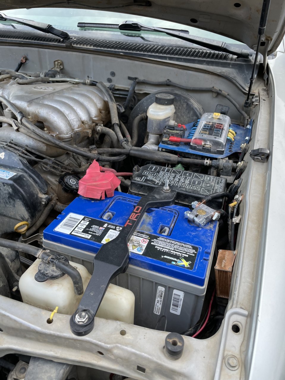

    So after so more digging I made some modifications to the Big 3 wiring based on suggestions, and wanted to document my final configurations here as I found it hard to find them.
    I ended up moving the 2 gauge wire from the fuse block directly to the positive battery terminal, there is no inline fuse the terminal it originally ran to is left empty( the fuse can be removed). Additionally, I need to grab some more 2 gauge end connectors and I’ll add one more ground from the negative terminal to the bolt at the alternator. And that’s what I’ll call complete of the “big 3” upgrade.
    Final look:
    • 2 gauge from alternator to positive battery terminal
    • 2 gauge from factory ground location on the block to negative terminal
    • 2 gauge from chassis(fender) to negative terminal
    • 2 gauge ground strap from back of block to firewall
    • (Pending) 2 gauge from negative terminal to block (alternator bolt)

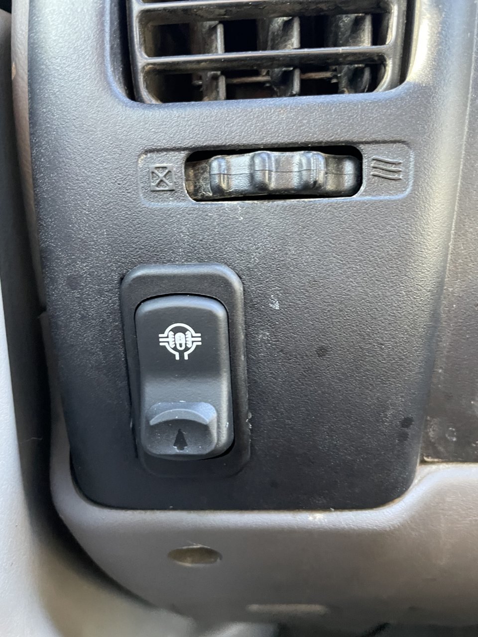

    Truck is officially double locked. Had a Eaton Elocker installed. I ended up pushing my ECT switch behind the dash because I never use it and installed the switch there.

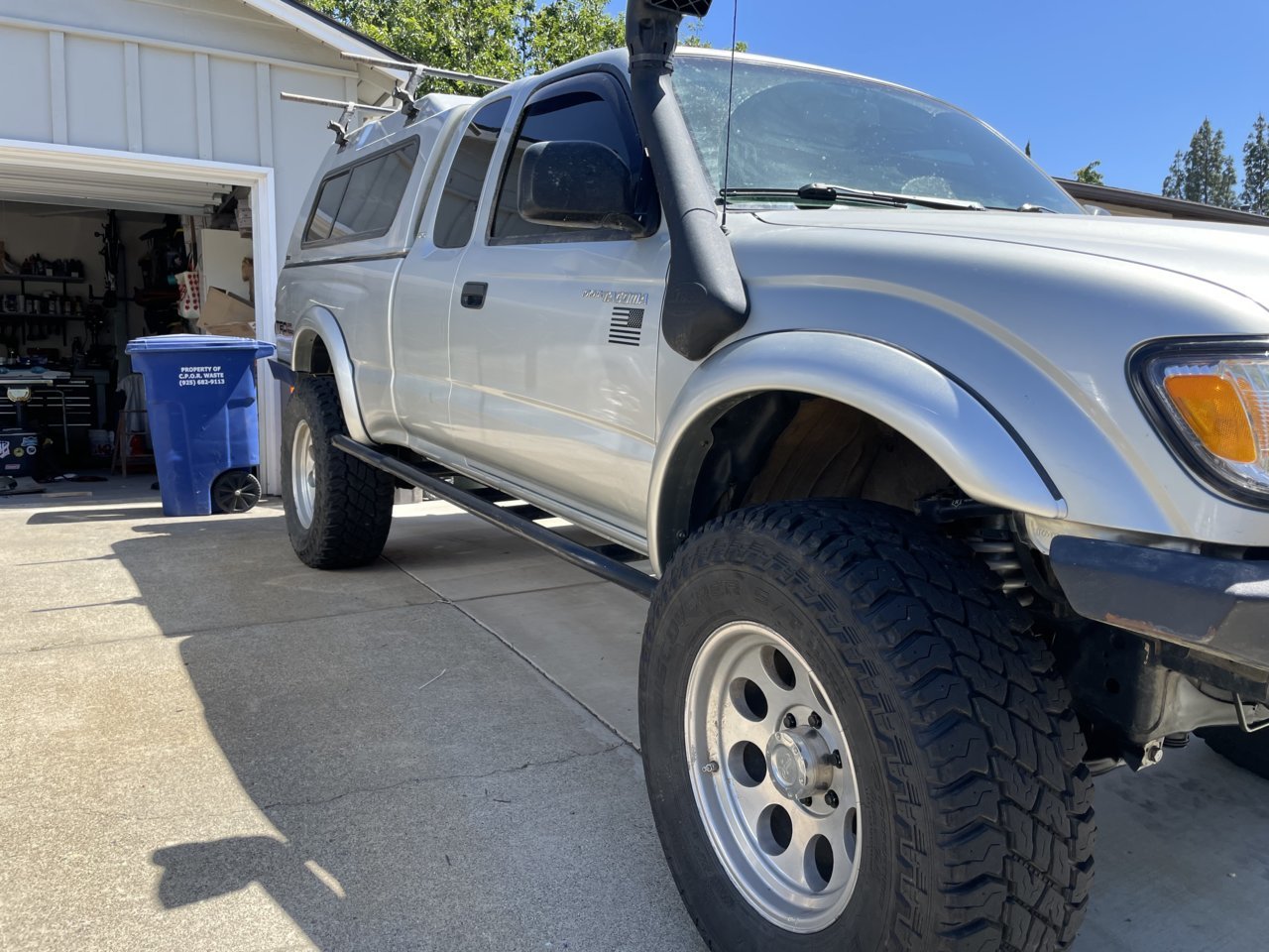

    Paint matched my fenders, it was a bit of a process and I’m not sure how well they will hold up. I’m hoping they hang in for a year or two. I’ll probably go to bush wackers next. 89D67E66-9C9C-4B34-B08C-1135F6070258.jpg

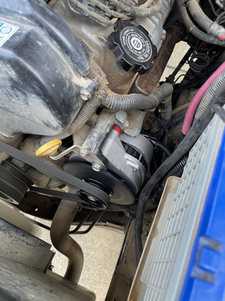

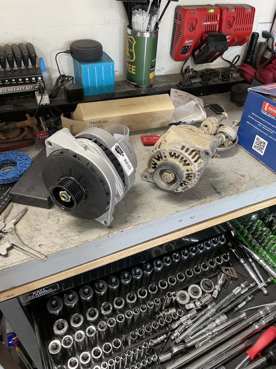

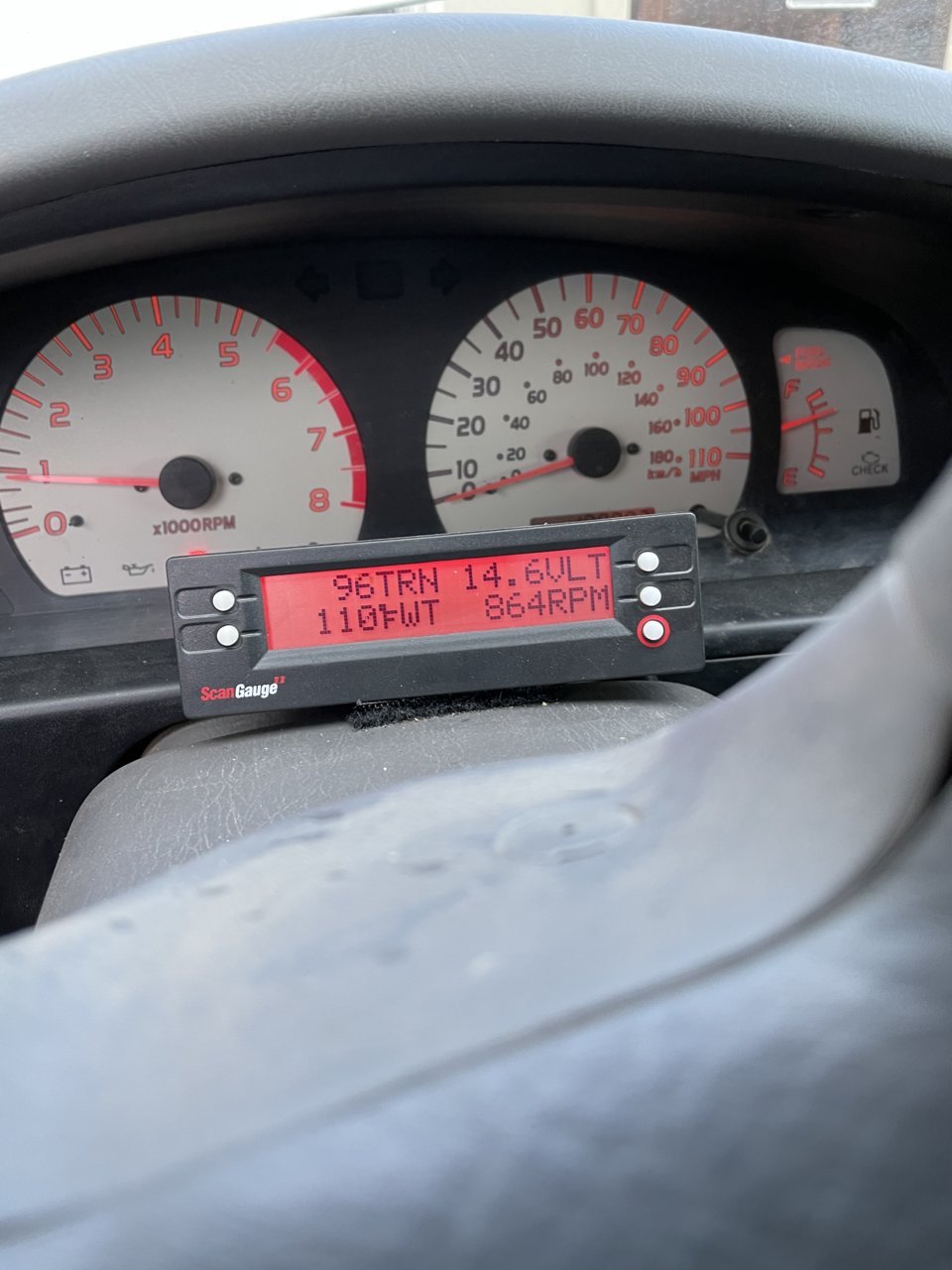

    Alright, out with the Denso 105 (going to a buddy that is running a regular battery) and in with the CS144 alternator. Runs at about 14.4 at idle and 14.7 driving I think the AGM battery will like those number more.
    Wasn’t super happy with the charging voltage I was getting from the 105 which pushed me to go this route.

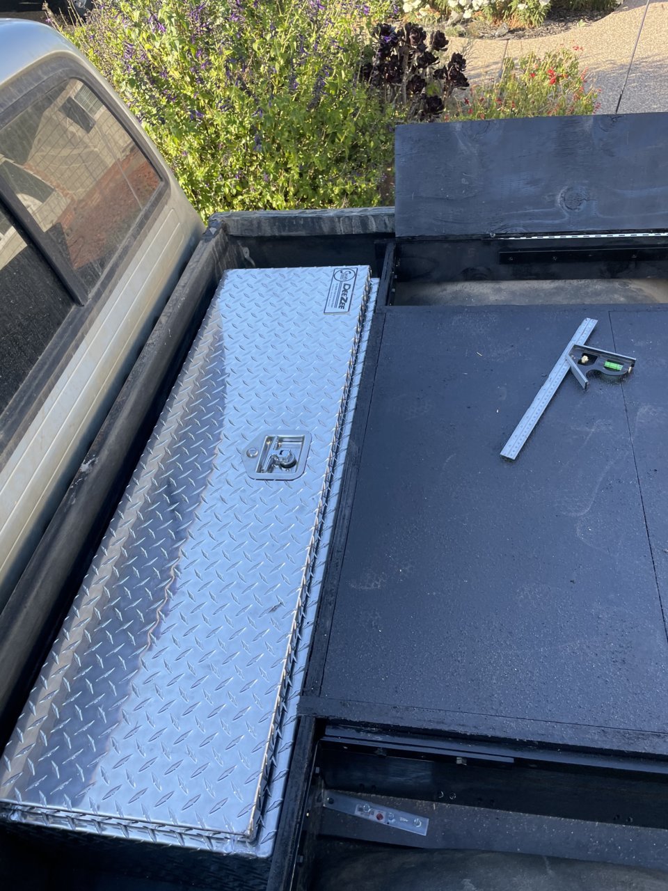

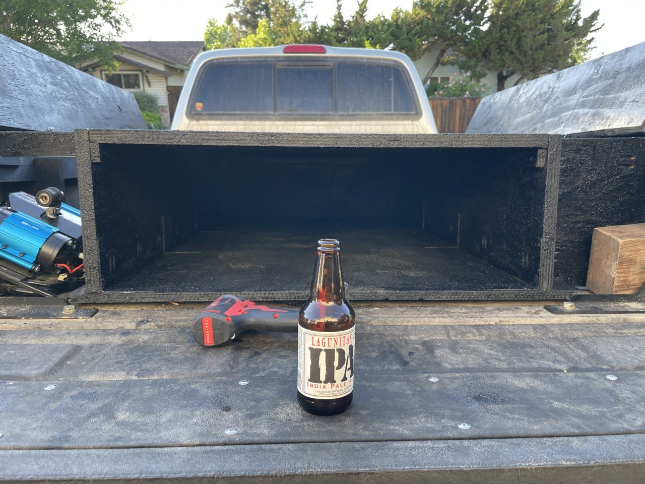

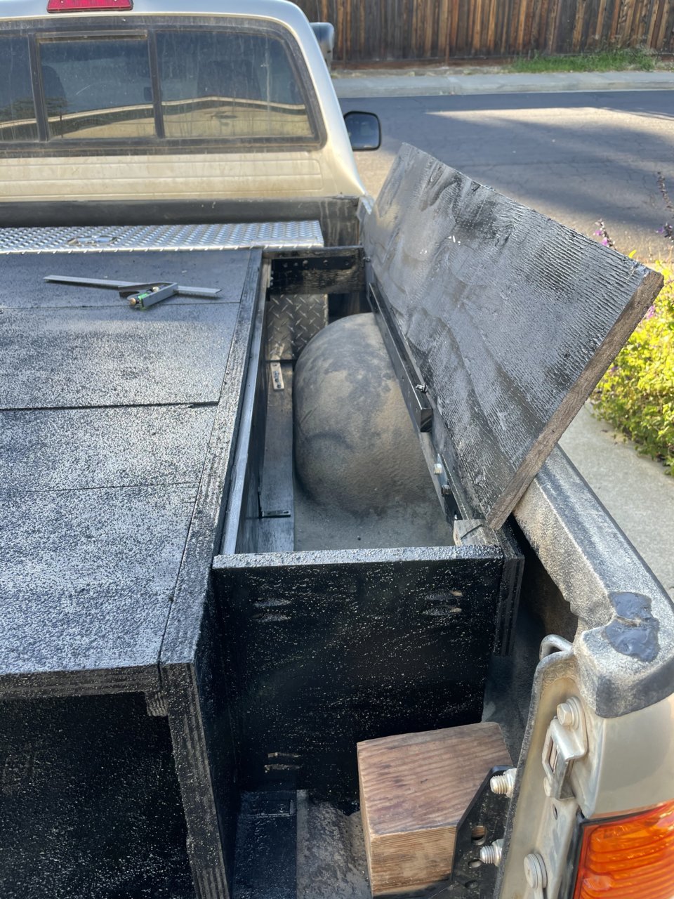

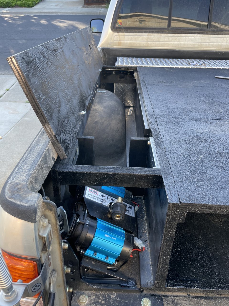

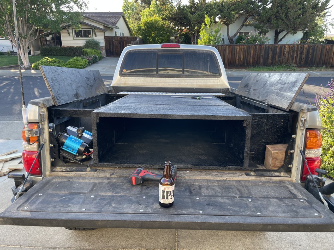

    Finished my new platform build. Stoked to make something a little more useable. The goal was to make it work with or without the camper shell because I’ve been wanting to pull the camper shell off for the summer\wheeling season. So I found an aluminum truck box to push toward the cab, so I can lock up my tools/spare parts/chainsaw and then built a box for the rest of the bed to match the height.5B4D2AE3-29B3-4481-8B7D-FB4A4A15C4AD.jpg CE644160-244D-471D-9AB6-515654F31A4A.jpg 3E1B451E-5CFA-4532-9C9A-458B83C603BD.jpg 9EAD26D1-285A-4C0D-B31F-5A04C14C5238.jpg 9B00411B-871C-4842-966C-582E9863C4A9.jpg

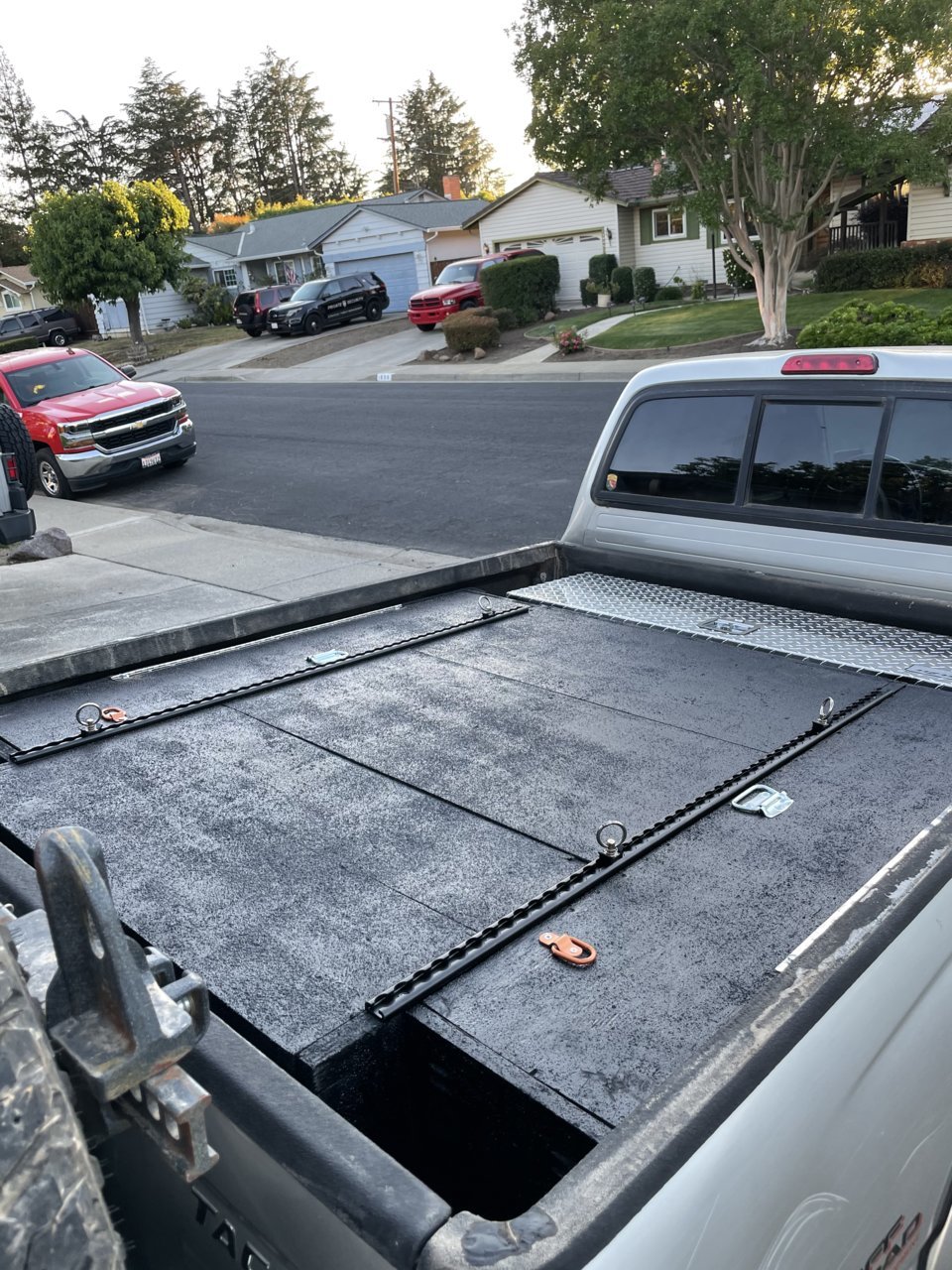

    Finished adding handles to the doors and L track as tie down locations. F63D8CEE-6599-41B9-94E8-0D1DBD93F5A5.jpg

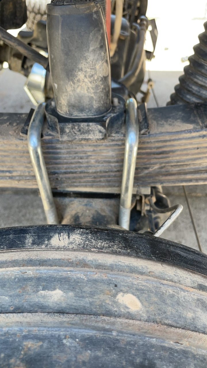

    Also installed All Pro rear axle relocation plates to shift my axle forward. After the alcans it was sitting about an inch back and I have been neglecting to fix it. D6C6CCDA-37C1-4489-97E7-CEBB46ADF09B.jpg
