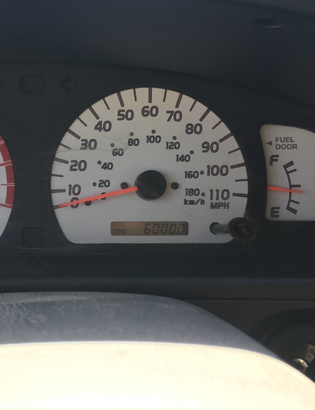

    Hit 60k today. Need to finish the 60k service with new diff, tranny and transfer case fluids. Hopefully this Sunday I can get to it.

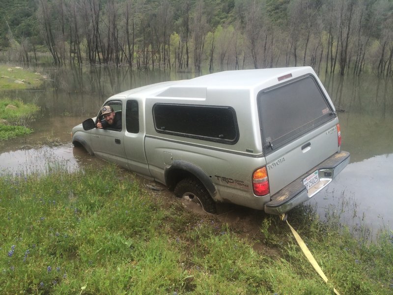

    Took my truck out for a small wheeling and camping trip this weekend and it became apparent to me how important recovery gear is! Lol
    I was wheeling around in veery shallow water heading toward a little hillclimb back out to the main fire road when my front end dropped pretty deep. I stopped, put my locker on and reversed back and my back tires just sank deep in the mud. It went from light wheeling to completely stuck in seconds. I had 1 tow strap that was just long enough to give me a pull from the rear but not the front. My buddies ford was just spinning his wheels as was I. Lucky a guy down the way had a longer strap and pulled me out from the front.
    What I learned. Bring recovery gear. I need more recovery points(new bumpers!). A winch would have so nice. Stay the hell out of water.

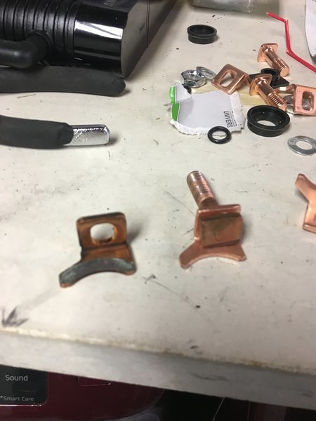

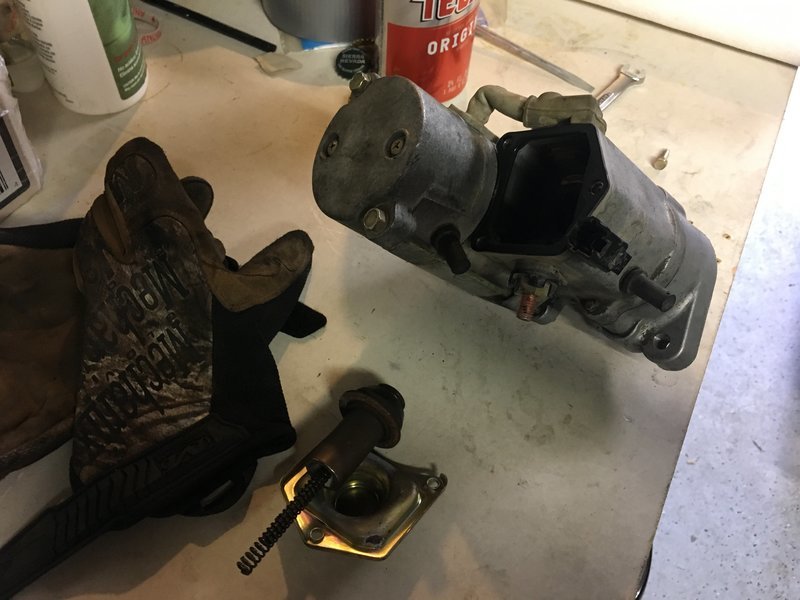

    Pulled the starter last night and replaced the contacts, wasn't too hard of a job. Took about an hour or so. Truck was lagging to start, I'd turn the key and hold it and it would about 5 seconds to start turning over. Now it fires right up and only cost 25 for the rebuild kit. IMG_6165.jpgIMG_6169.jpg

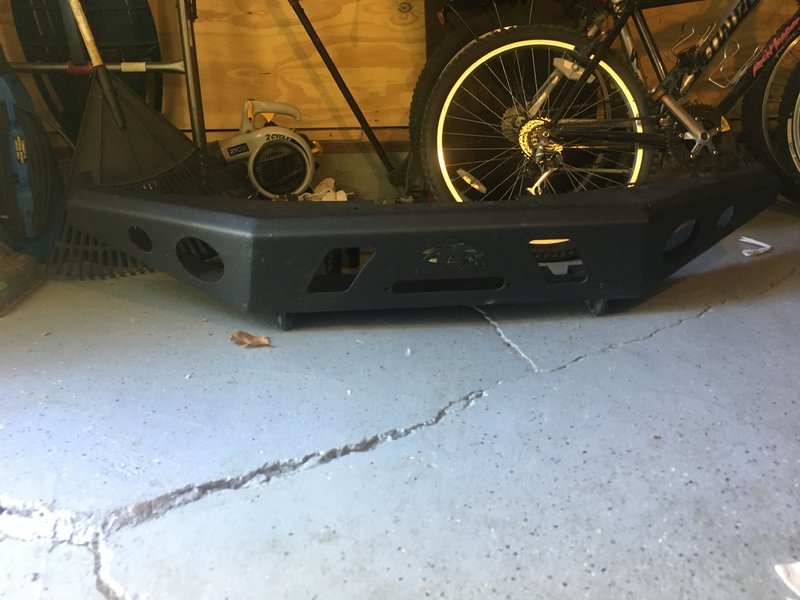

    IMG_6248.jpg Well picked this up this weekend. All Pro Apex. Now I need to get to making some skids, get 4" fog lights and obtaining a winch.
