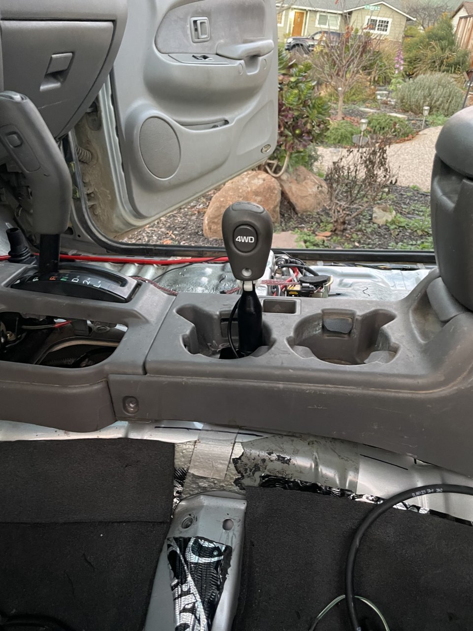

    She’s in there! Got everything done besides the t case shifter. Got a plan for it so it should be quick.

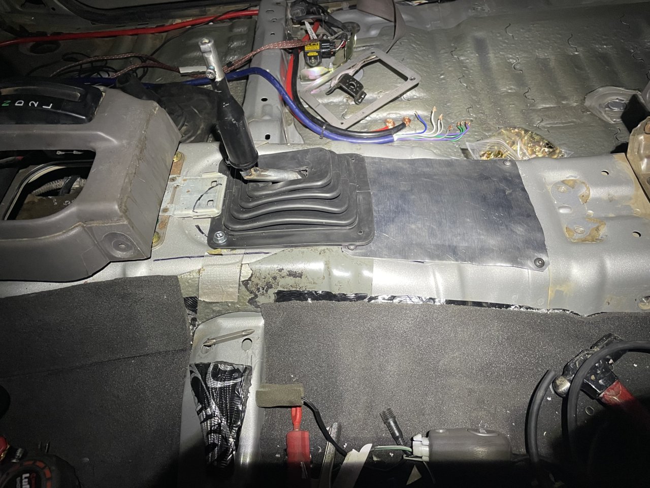

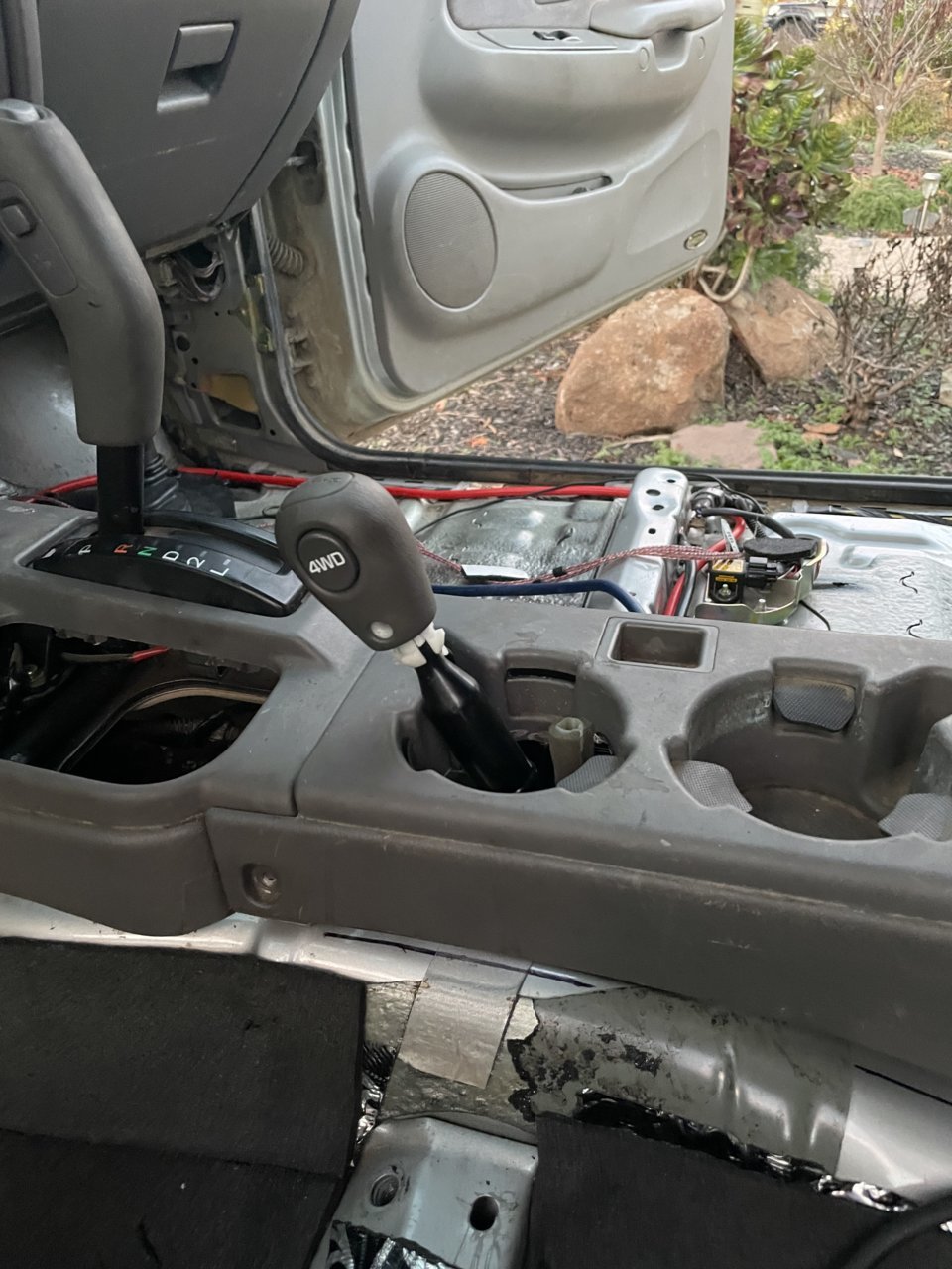

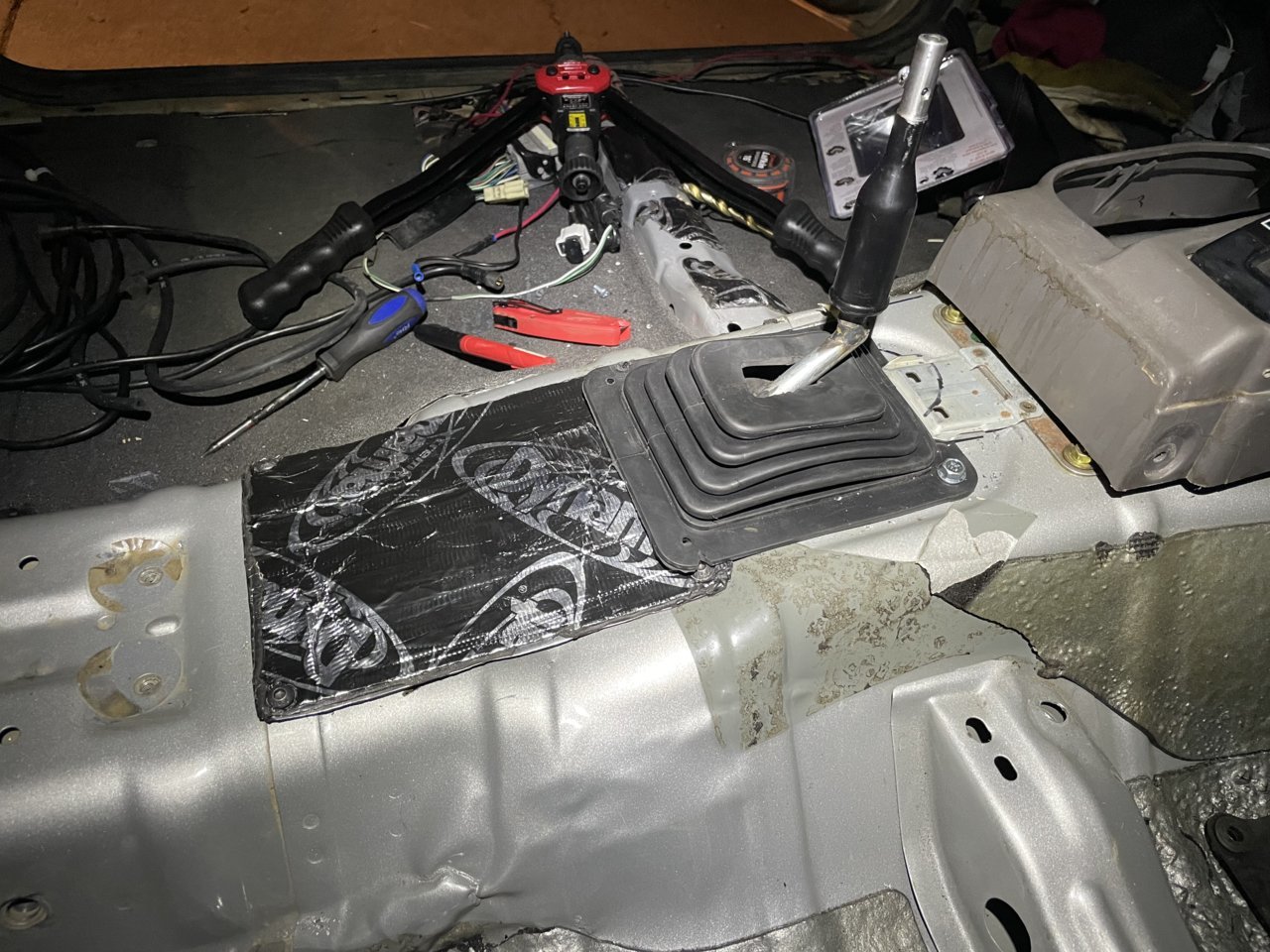

    Didn’t get much done today. Needed a bit of a break. Did get the transfer case shifter fit and made an aluminum cover for the tunnel. Then double sided it with dynamat.13509AA4-2CFC-4DCE-ABBF-7842EB371DCF.jpg F18F67AD-1028-4381-A933-4F45335CC7E4.jpg 20BA3823-0FEB-4FC2-8DB3-3834A3E33535.jpg 4B1887DC-BE53-4347-9F2A-B6089CDD4E35.jpg

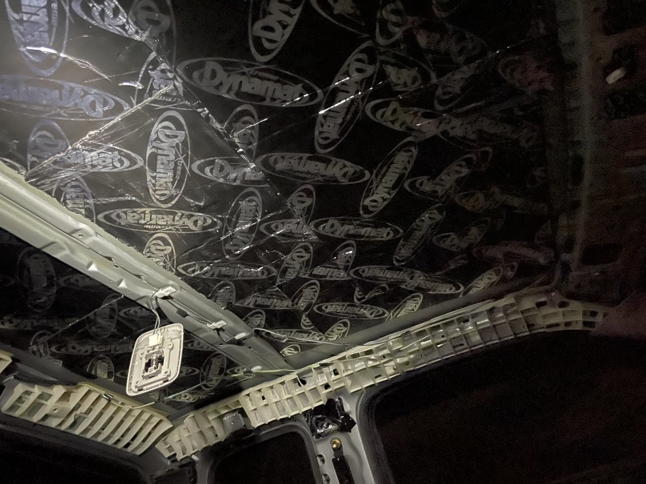

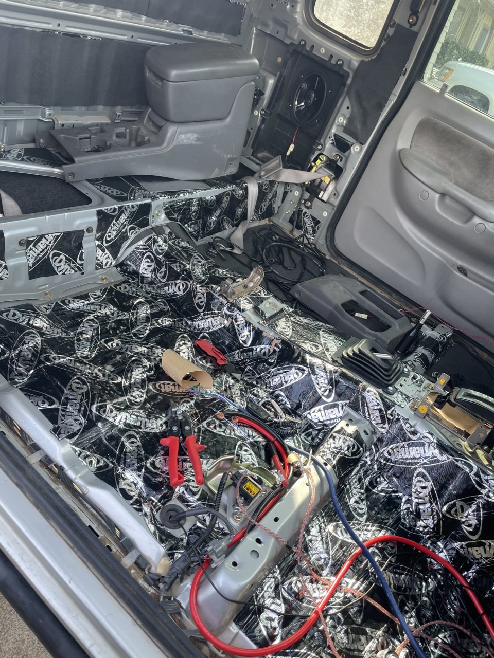

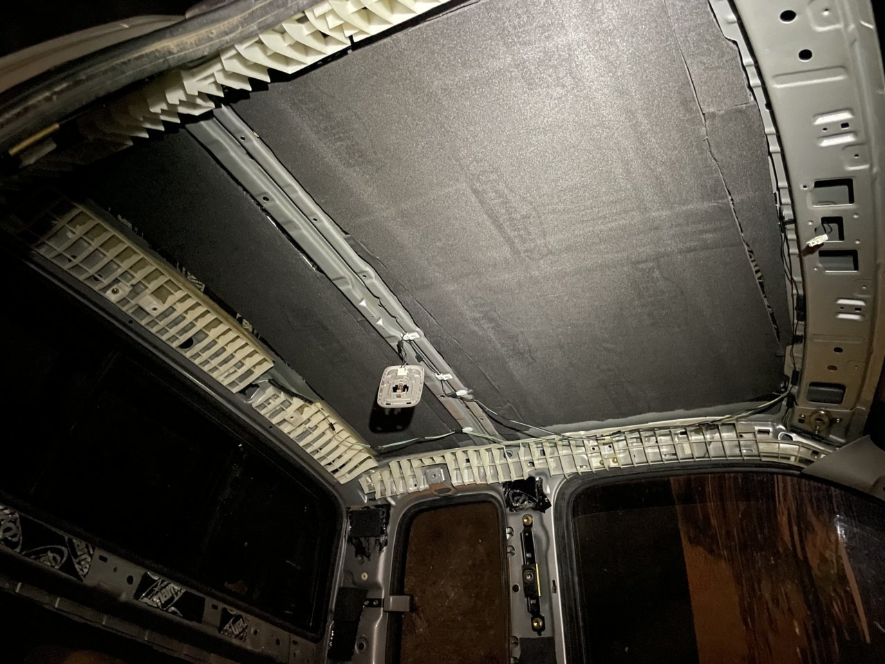

    Todays progress update:
    • Got the passenger side dynamat down
    • Pulled the headliner
    • Dynamat And linered the roof
    • Drank 3 beers
    *note:dynamat doesn’t stick well when it’s cold. Had to start the truck and let the heater run for a good 20 mins.
