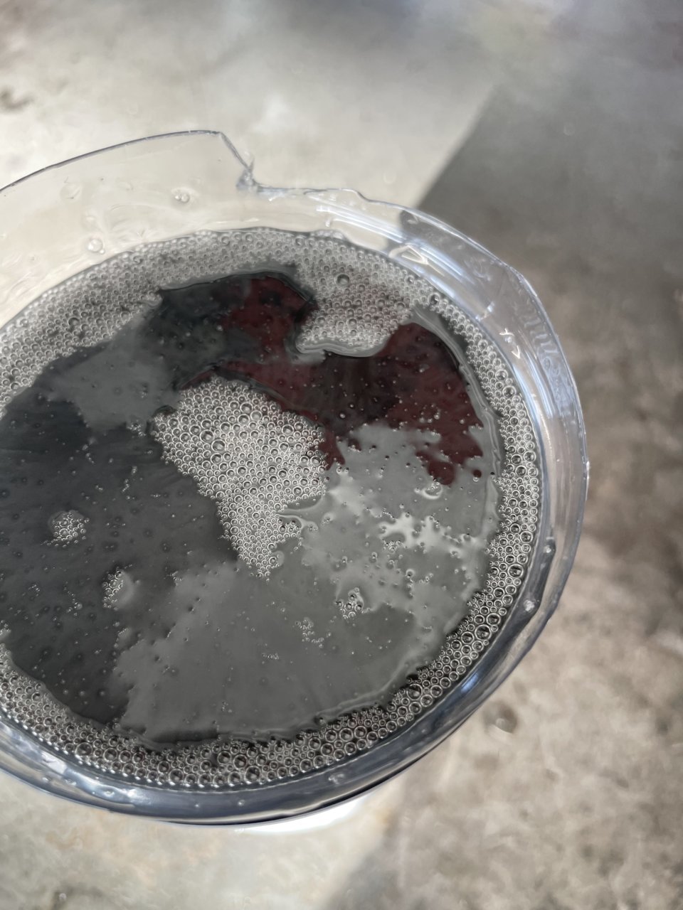

    Took the truck out and found some snow last weekend and was able to use some 4wd. I played around in the 4.7 box as much as I could. Figured this would help me do a break in fluid change. D56F6335-DFE6-42F6-860C-182F56E9D364.jpg
    fluid came out almost silver, dragged a magnet through it and came up with nothing. Both plugs had nothing on it. So that’s a success. Put some new fluid in it and she’s now on a 6 month interval. See ya in September. A71B652E-5D74-4F73-AAA5-7F320DB88857.jpg

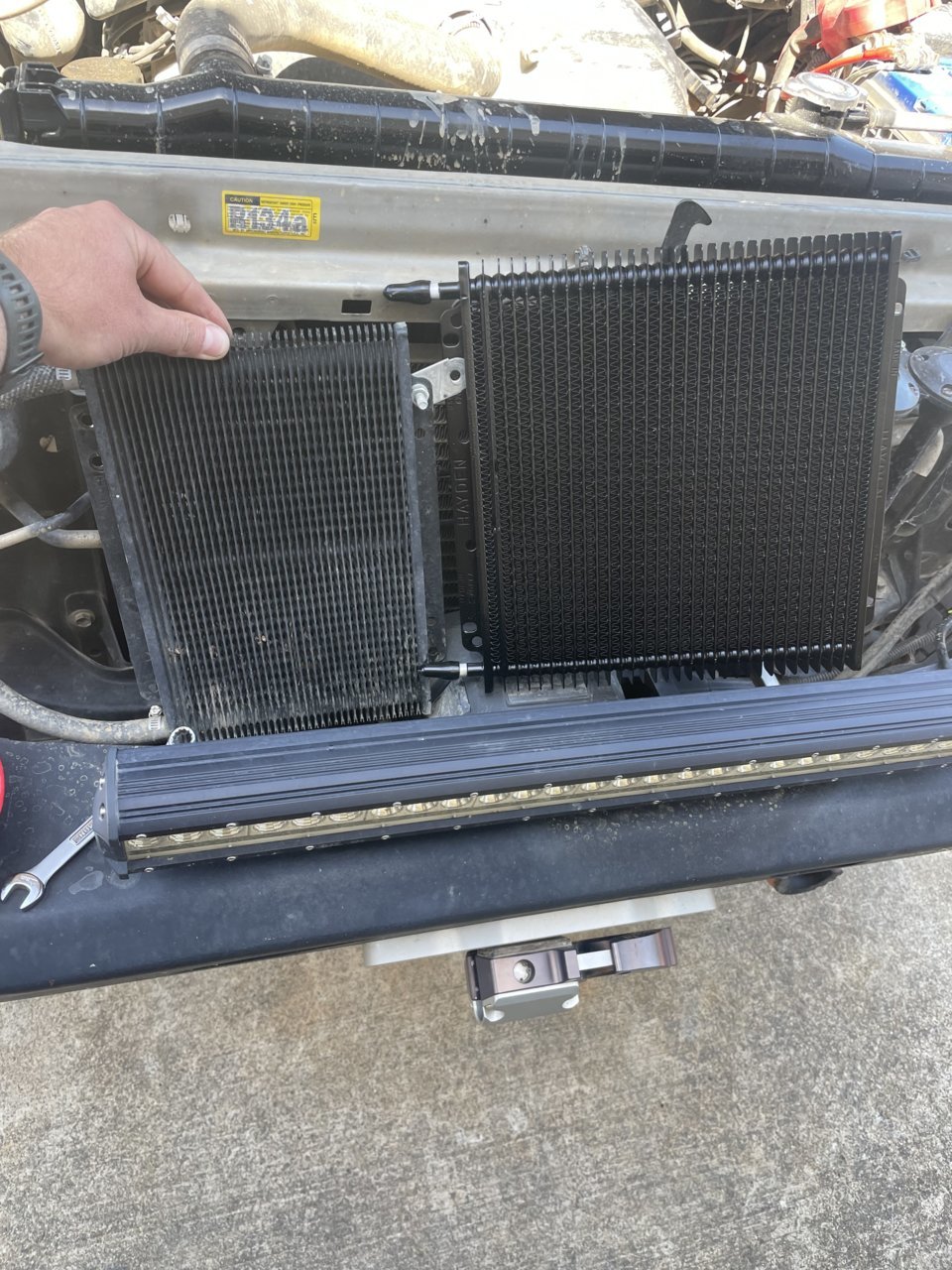

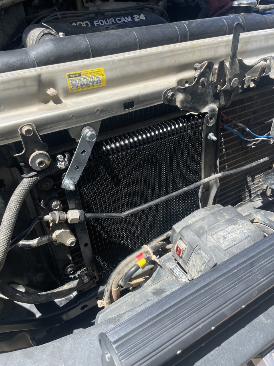

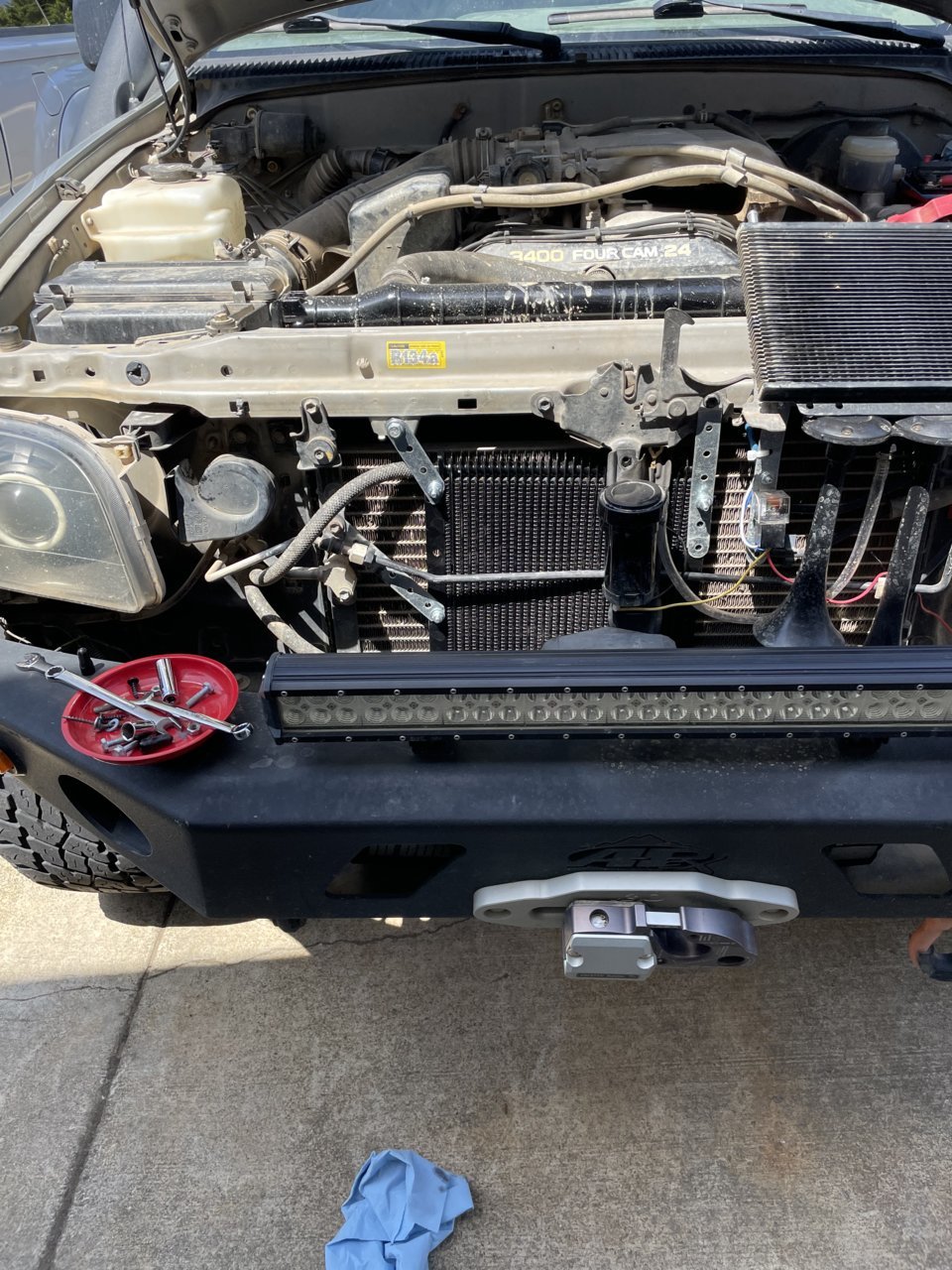

    Got my Hayden 699 trans cooler installed.
    Here’s a side by side on the size difference.

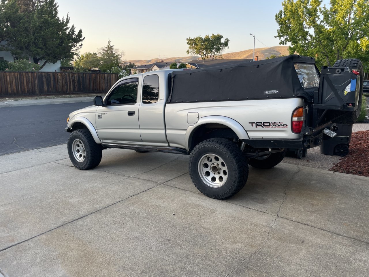

    Got my high top camper off and the soft topper installed. Pretty stoked on it. Had to make some adjustments to my platform to allow the topper to swing but other than that no issues. 6C992632-7A05-4652-A74F-C2D931DEC07A.jpg

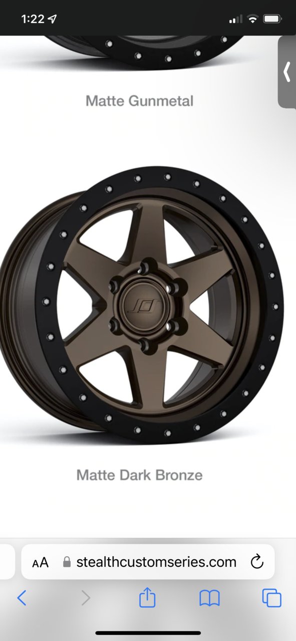

    Finally bought some new wheels. I’ve wanted to do it for some time to get rid of my wheel spacers. Especially with the idea that I’d like to move to 35” tire next. That being said I ended up with SCS BR6 17”x9” -38mm BS in matte bronze. I pick them up on Wednesday! Super stoked. All (5) were blems so I was able to save some coin there. Now what tire do I wrap them with?

    You looking for MT or AT?

    I’m looking for MT, looking at 315/70/17, 35x11.5 (which would be nitro trail grapplers) or 35x12.5 which seems to have the most optiona

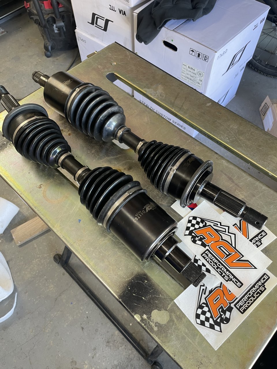

    Installed my RCVs! Other than the c clips being complete garbage, it was smooth. It didn’t want to seat, First c clip broke and the second bent. This was pretty disappointing for being “ the strongest axles” anyway, Pulled the clips off my spare set of OEM axles and it all went together no problem.

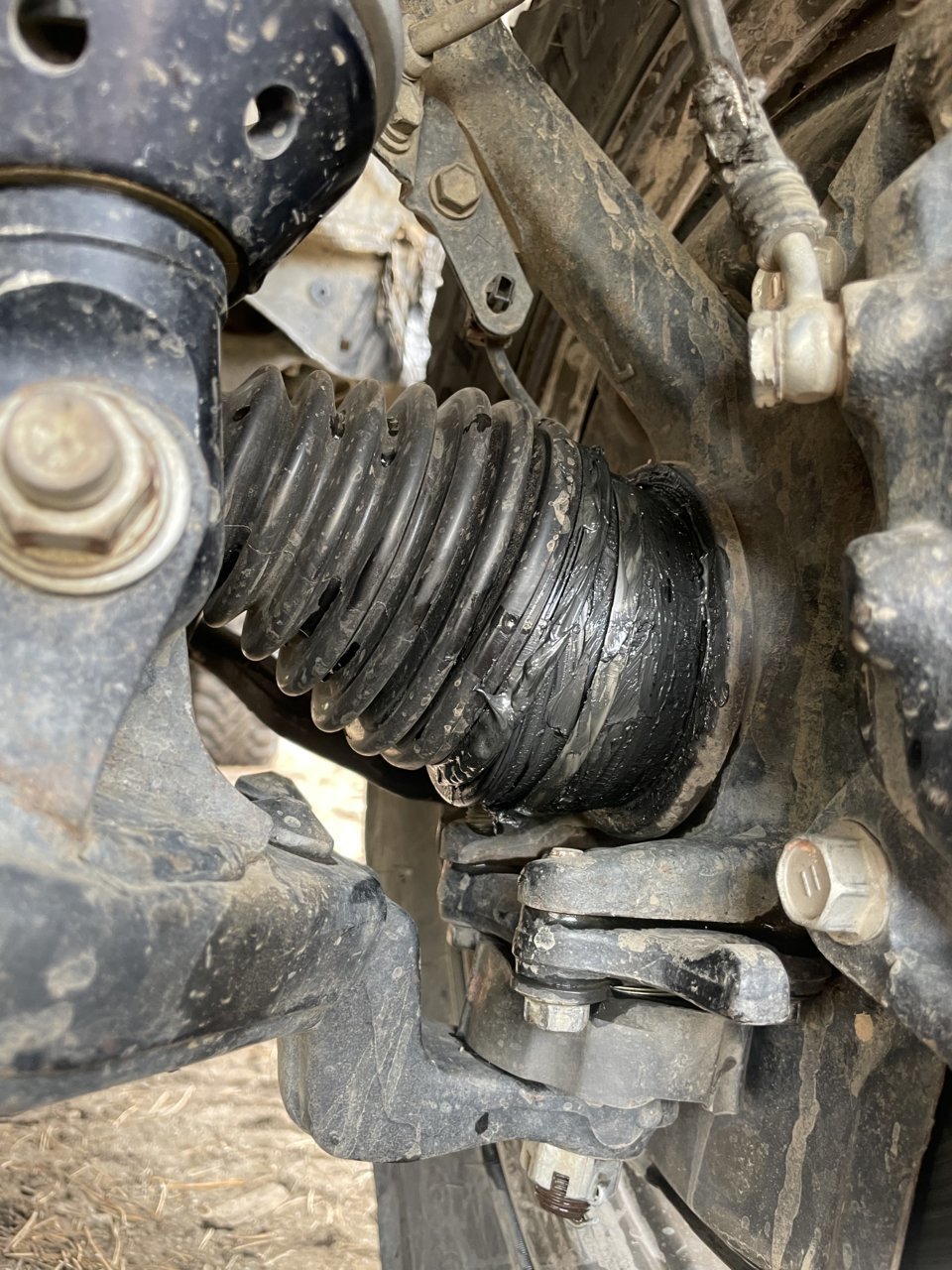

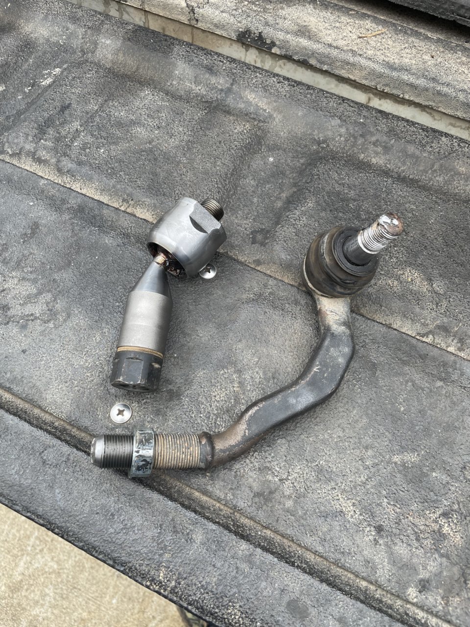

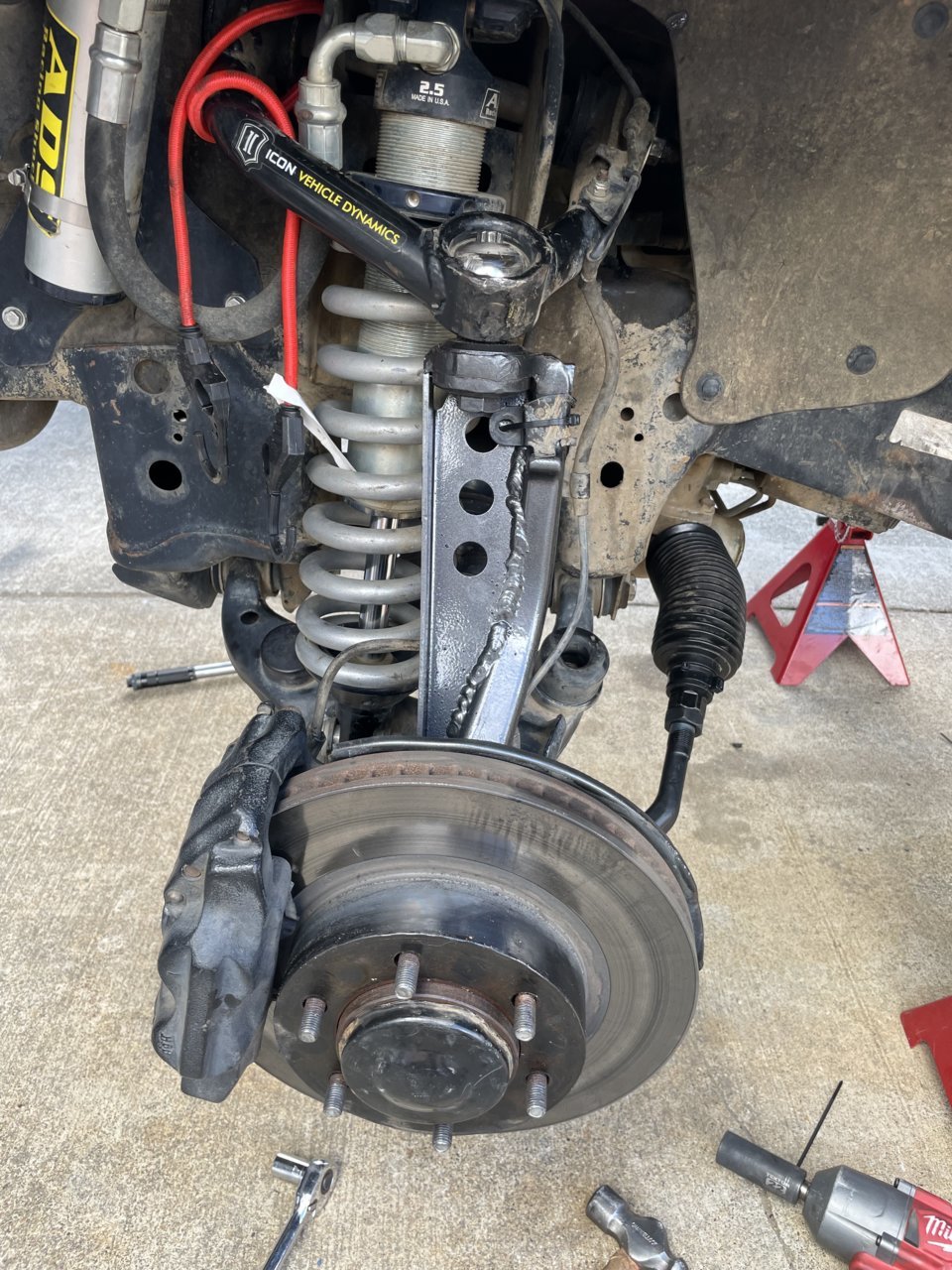

    On the rubicon I bent my inner and out tie rods. Got those on order. As well as another new set for spares. Also some new lower ball joints.
    my boot clamp on my RCVs popped off mid trail. That pissed me off! Currently being help on with a zip tie.
    and lastly I got some TC spindle gussets in. So once my tie rods so up. I think I will be pulling the spindle and welding that in. And then replacing the tie rods and Lower ball joints on re assembly.

    Truck got new inner/outer tie rods, lower ball joints and TC spindle gussets. And re clamped the RCV outer. E136E832-1FC1-4E96-8DE6-EBFA2ACE0A9E.jpg
