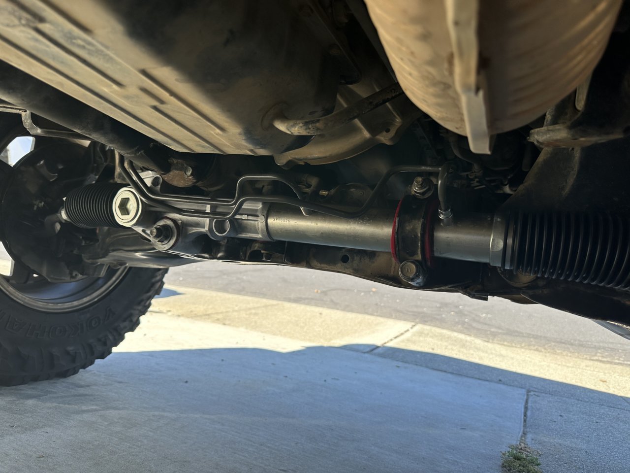

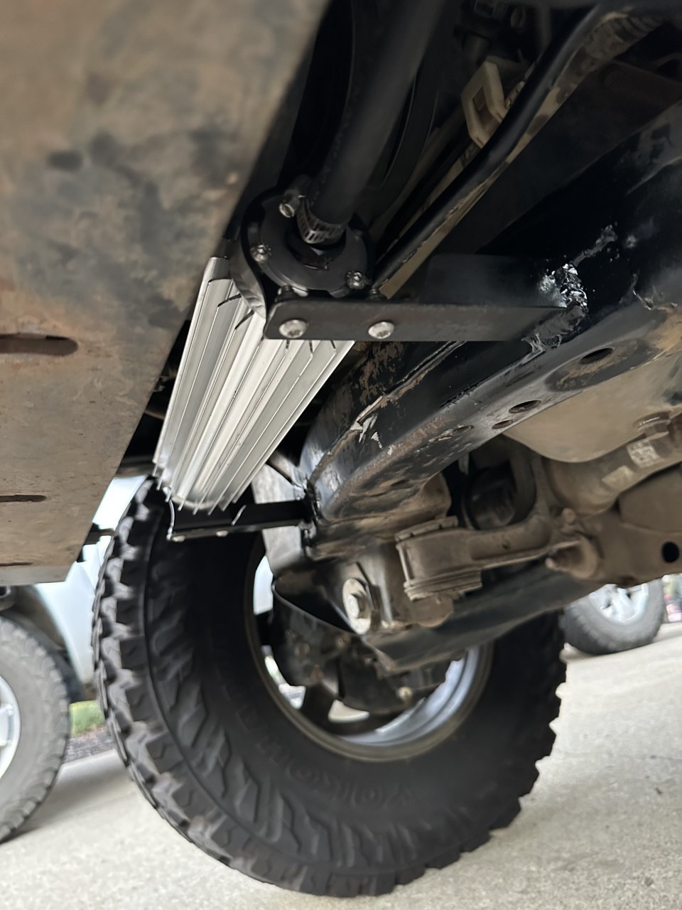

    Truck got a new steering rack and power steering cooler. I will be looking to maintain the fluid better moving forward. I would occasionally suction the fluid out and put new fluid in but that’s really not good enough. The fluid was pretty brownish. So I’ll be monitoring more and doing flushes more often to treat the system better.

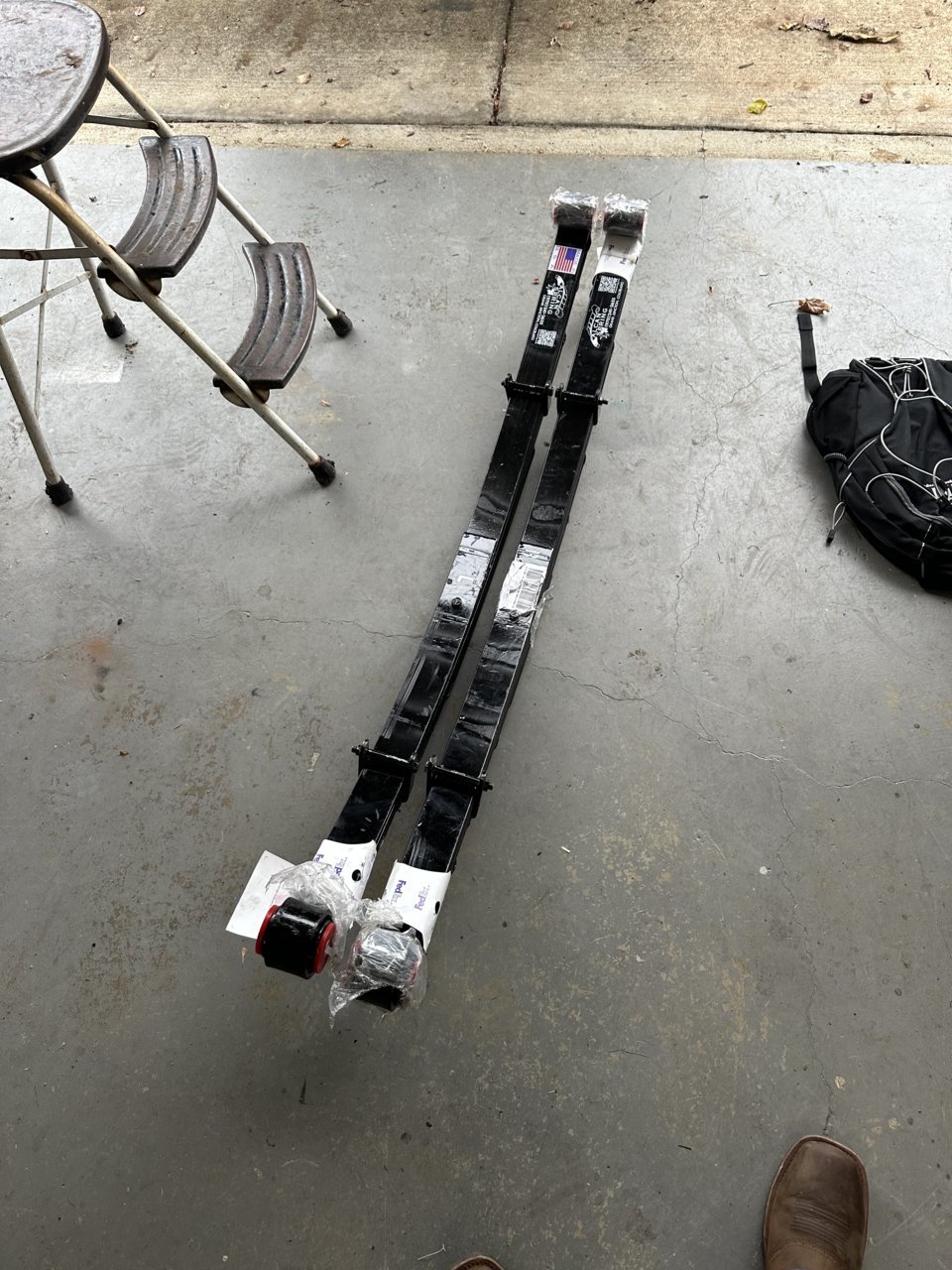

    Actually that’s not true, my leafs were sagging and under rated for the weight of my truck. So I ordered a new pair of Alcans rated for 1100 over stock with a 3” lift.

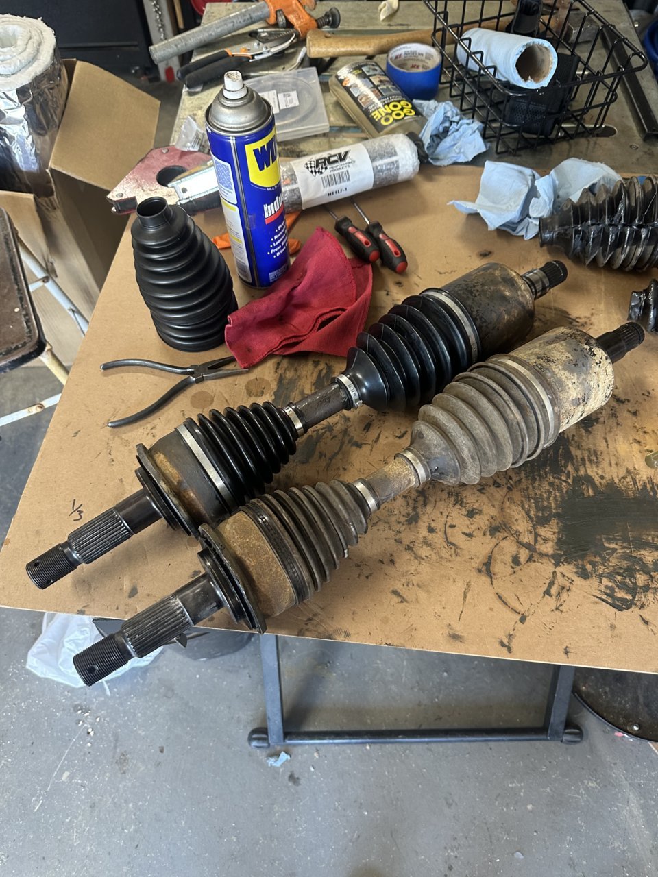

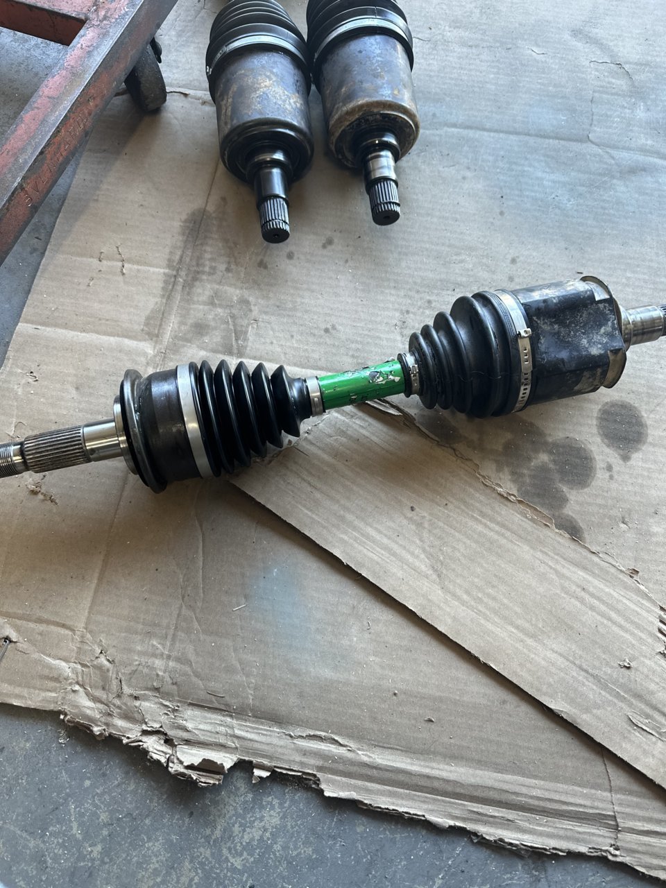

    Rebooted and regreased one of my RCVs on my lunch. I was having a click in the front end while I was in 4wd. Swapped my oem cvs in and it fixed the problem. I had both the outer boot straps break on the RCVs right after I got them last year and I just re strapped it but apparently that wasn’t a good enough fix. There still seemed to be a good amount of grease but either way I’m hoping this fixes the problem. CB79BF44-2753-458A-81F0-034A0114DDDC.jpg

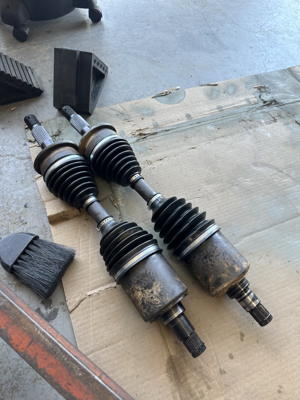

    Rebuilt my other rcv, and rebooted another spare I had laying around. 5CE64E15-9732-42FB-BD2E-98CA4F85D79D.jpgB27B1D32-7DDB-4336-93BC-C4FEA857AC1F.jpg
    my plan is to swap one rcv back in at a time to make sure that rebooting has corrected the clicking I was getting. Time will tell.

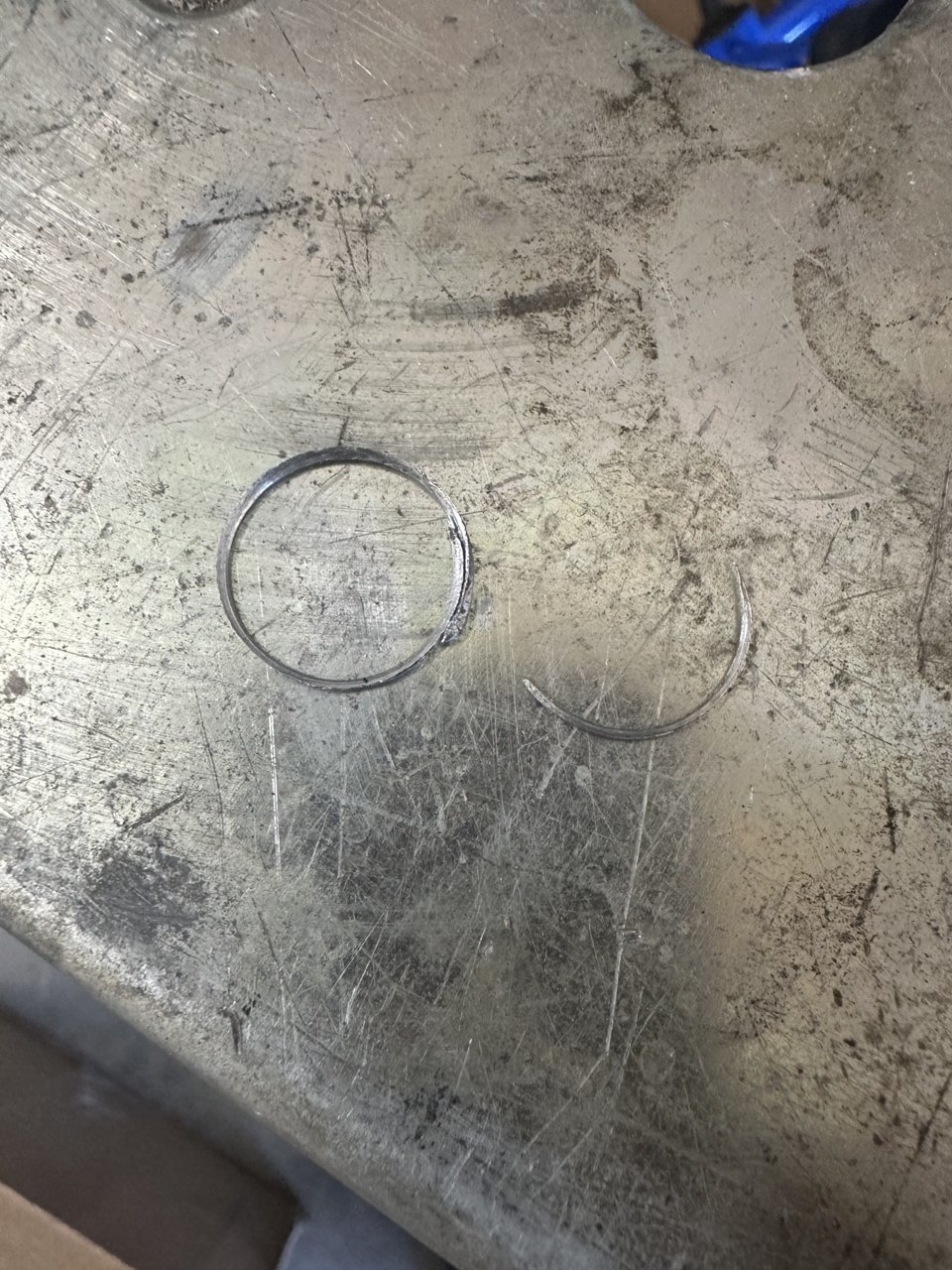

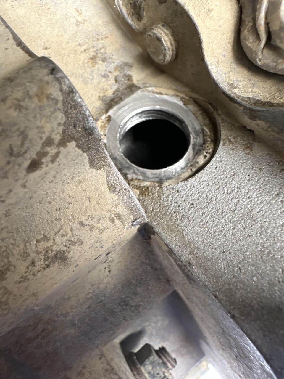

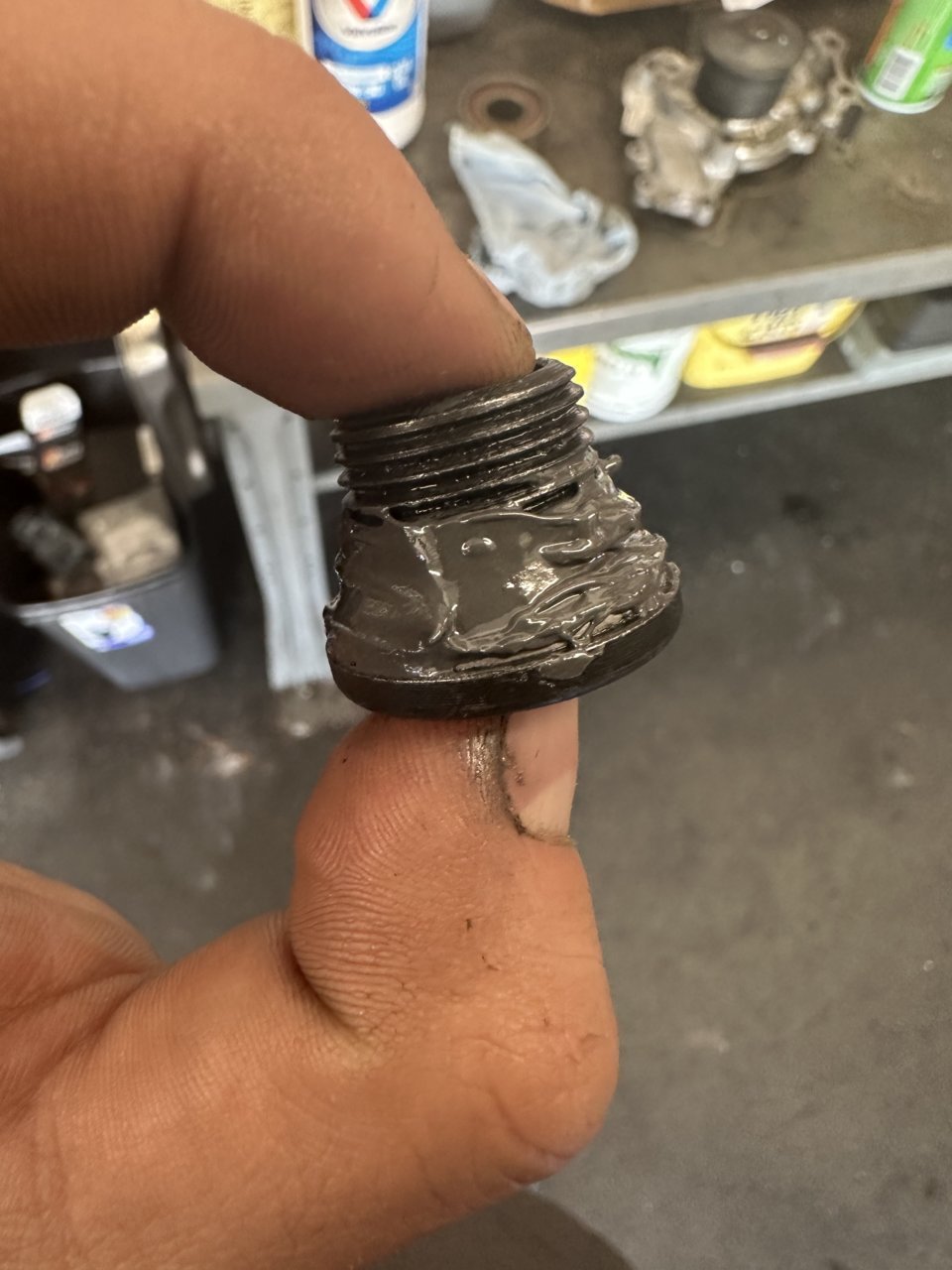

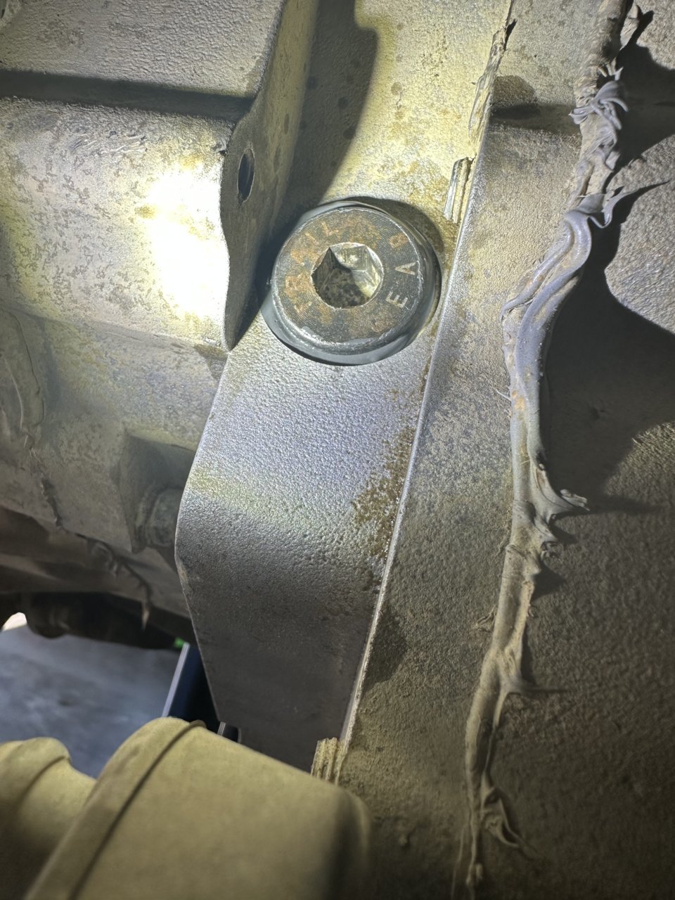

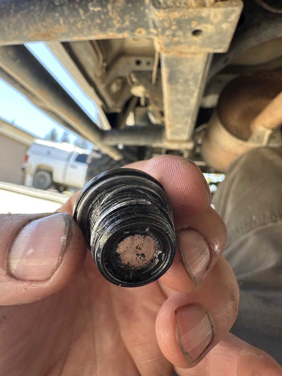

    Another interesting problem that came up, drained my crawl box and filled it and when I was going to reinstall the fill plug, it literally stripped the threads out. It never got tight. Not sure what to do I called TG and they said “I’ve never seen that happen before” but quickly suggested plugging it and filling from the top. Long story short the plug got jb welded in place and I’ll be filling from the top. A little frustrating.

    Well at least it was the fill port! I stripped out a rear axle drain plug and basically did the same thing you did.
